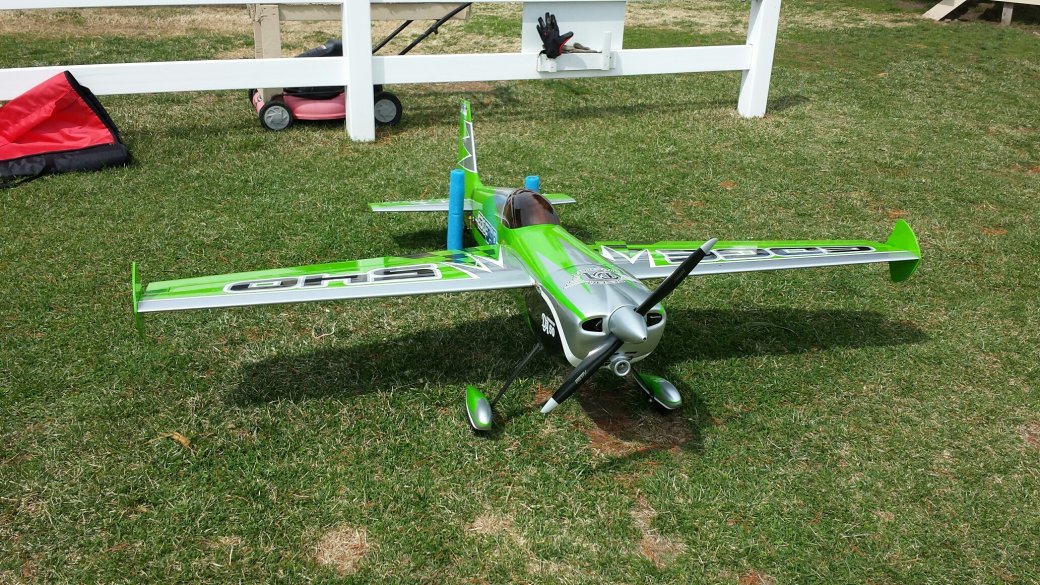

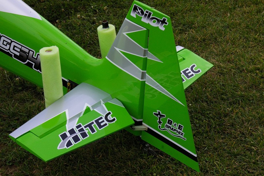

Back to the topic at hand. We use pieces of conduit driven into the ground that receive removable pieces of conduit padded with pool noodles. For larger airplanes like 40% you can space them farther apart and use them on the wings. Very easy to use and very secure.

It's simple and secure and it doesn't interfere with grass cutting at all. I would love to have them on a concrete pad, that would really be nice.
We store the conduit / pool noodles on racks on the fence line. You can see them in this pic. It also find it makes a convenient place for my glove. ;)
This reminds me that I need to change out the pool noodles again. Their life expectancy is less than a year out in the weather.
