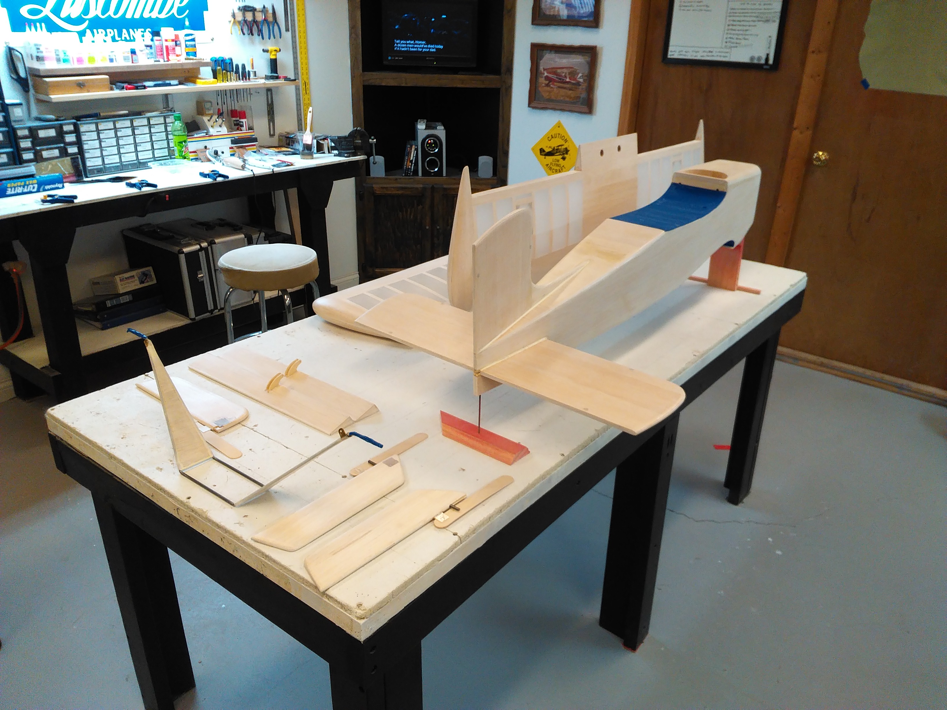

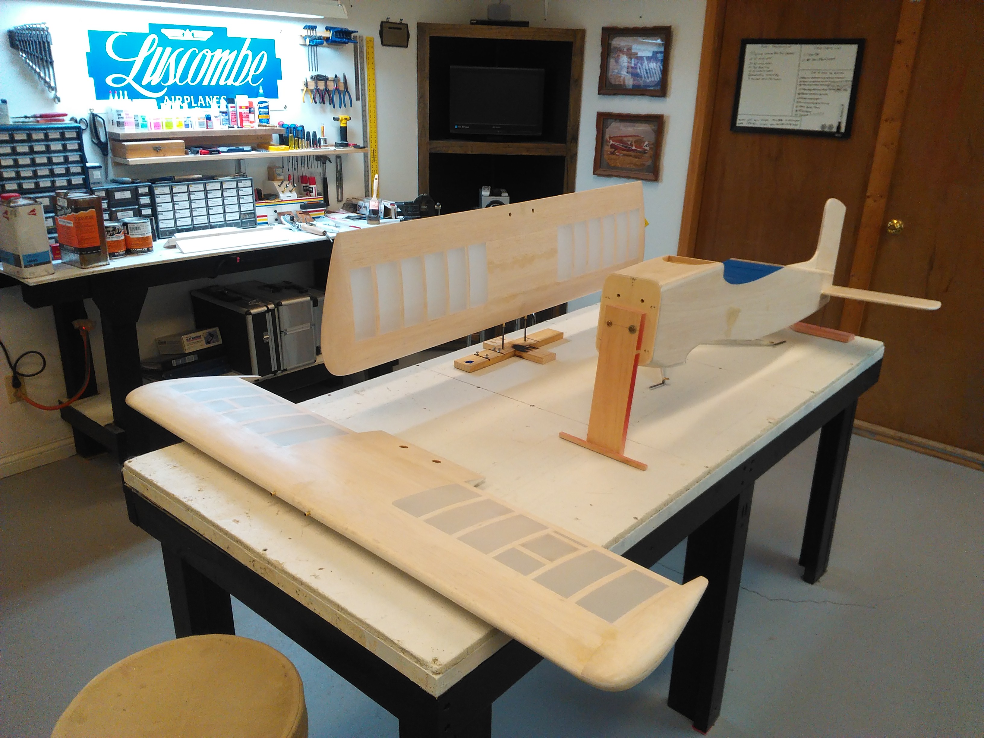

She's all covered and has a brush coat of Nitrate and a brush coat of Butyrate.
One thing I'm doing different with the Kanary is I'm going to spray the last 4 fill coats of Butyrate instead of brushing. The Krier looks great but if you look at it close you can see slight brush marks even through the clear.
I want the cover job on my next project to be as close to perfect as I can get it (as I'm thinking I might compete with it) so the Kanary has turned into a bit of a test bed for things I want to try.
So anyway I spent this evening making holders and tomorrow I'll start spraying clear Butyrate. I'll be spraying color before you know it!!
