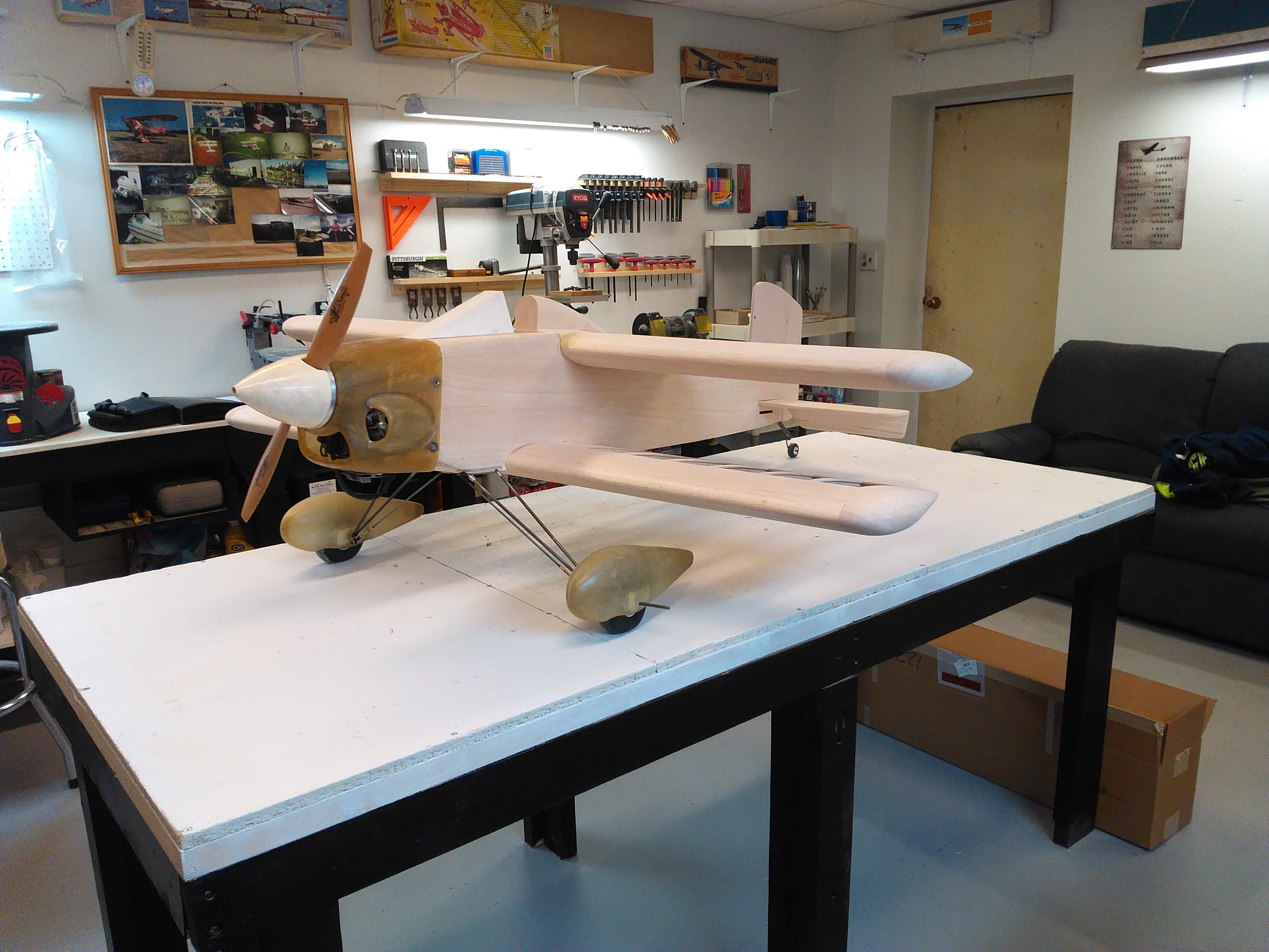

Sweet... I have to admit I had all but forgot about this. I can't think that no one was interested. Probably just sidetracked with their own numerous projects. Well, that is my story anyway. LOL. And by golly I am sticking to it.It didn't seem as though many people were interested in this build and I let the thread slip some![]()

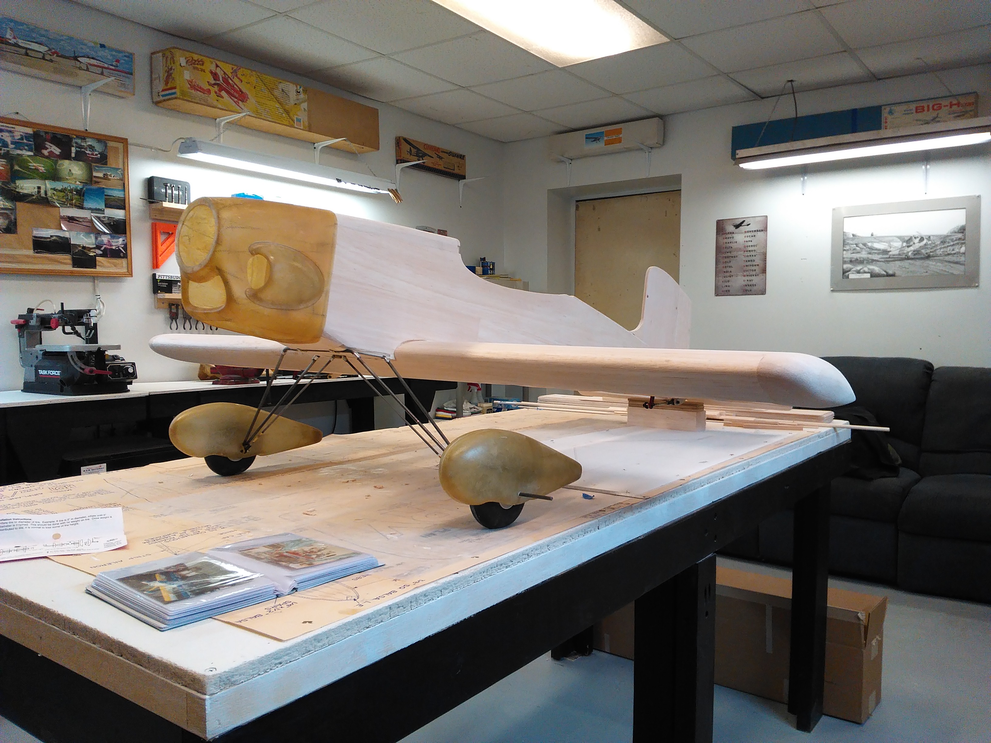

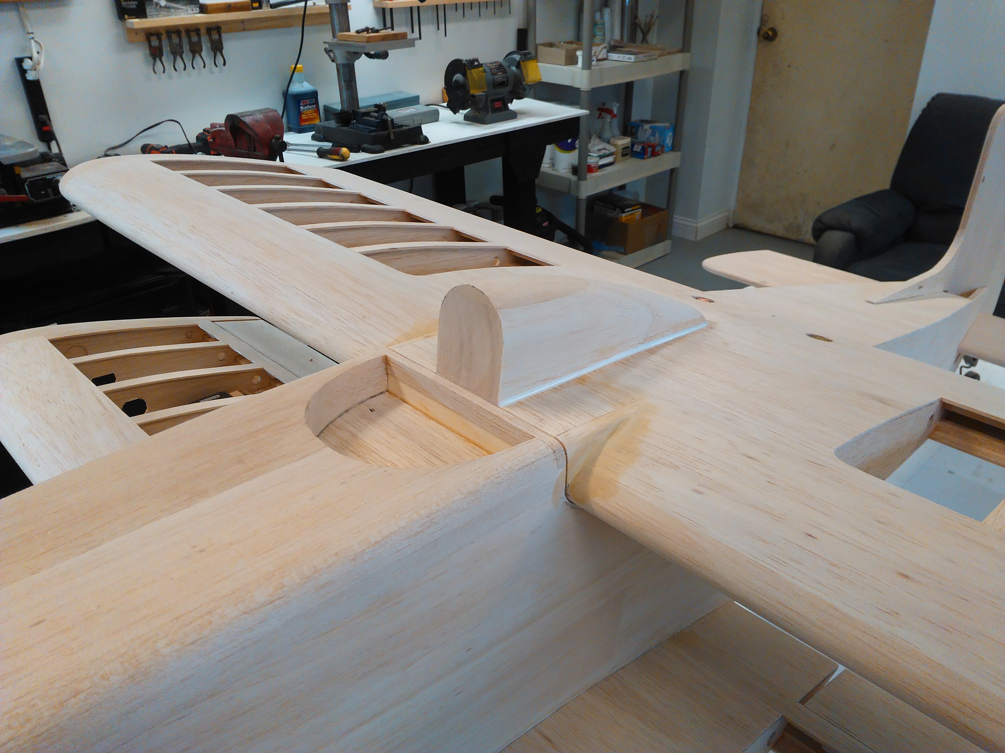

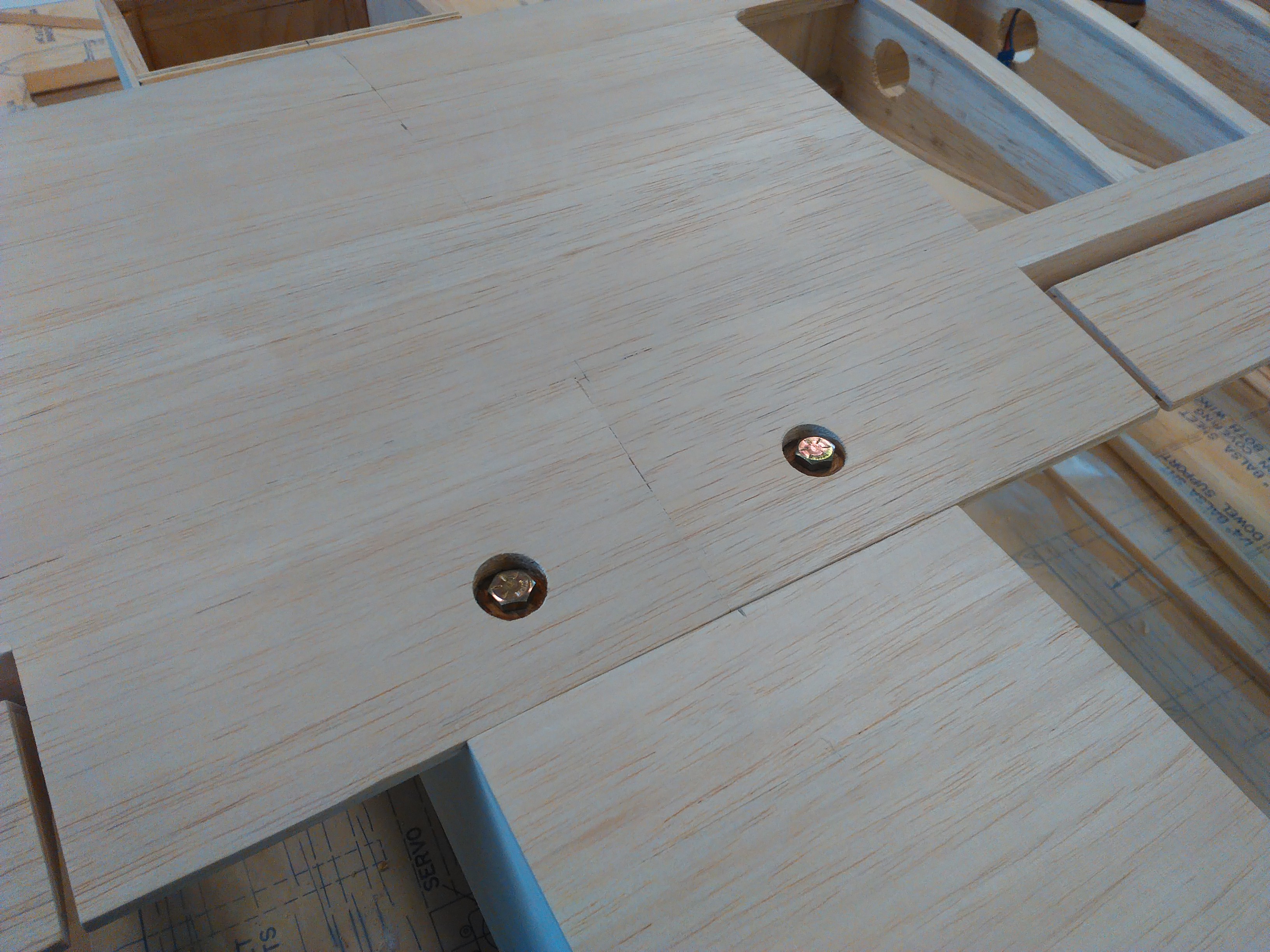

Ah yeah....I figured that was the method to your madness. LOL. Pretty much agree with you as for the size of the bolt head. The more area you can cover, the better. Nice stuff you build there.Lol, yea the strength of a steel 1/4-20 bolt is overkill, heck I've seen full scales that have wing bolts that are 1/4-28 lol.
The steel ones are just in there for now because with the brass inserts I put in the wing block the steel ones can be screwed in with my fingers.
I like to use 1/4-20 bolts for wing mounts because of the size of the head of the bolt mostly. It spreads the load out over a larger area (even larger if you use a washer or if the nylon bolt has a flange).
Also, I like to use steel bolts if it goes into tapped wood. I have noticed there is less of a chance of buggering up the threads in the wood if I use steel. If I put a brass insert in the wing block (like here) I use nylon so they don't vibrate loose.
