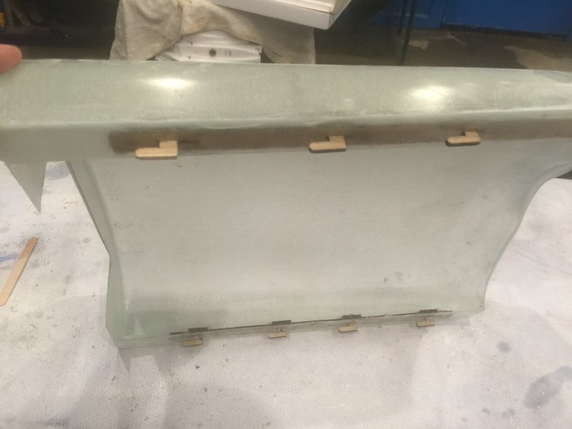

for the past few days, I have been working on the cowl locking mechanism, which, is genius! Tony @WoodisGood did a great job designing this.
basically, there are 4 "rails" with 4 slots in each rail. Then there are 8 tabs, 4 for the right side and 4 for the left side.
The upper cowl has the tabs, and once you engage them into the lower cowl tab holes, you press down and then push back, and it locks in place.
once this is glued into place, I then got some west epoxy resin, and fiberglass tape, and reinforced this.

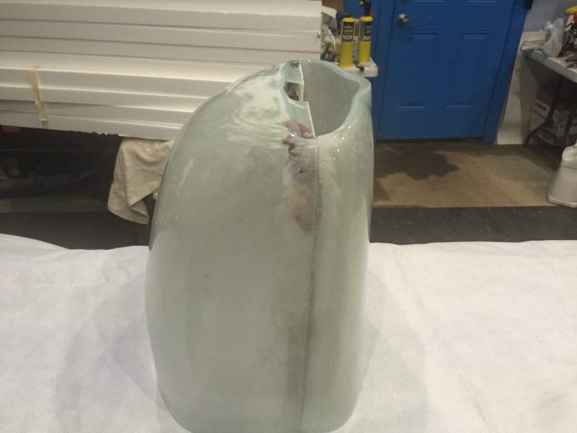

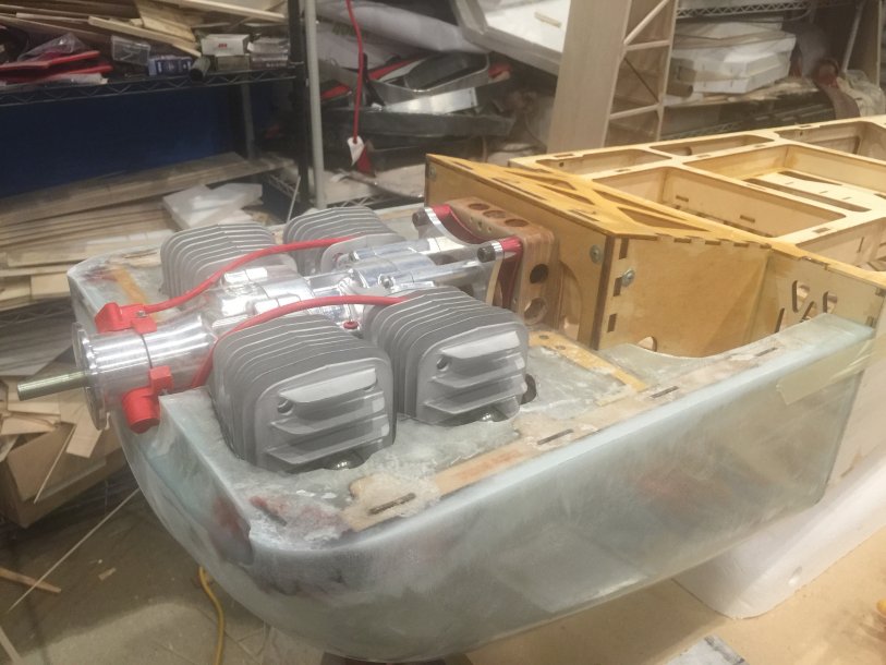

here is a trial fitting of it to the fuselage....

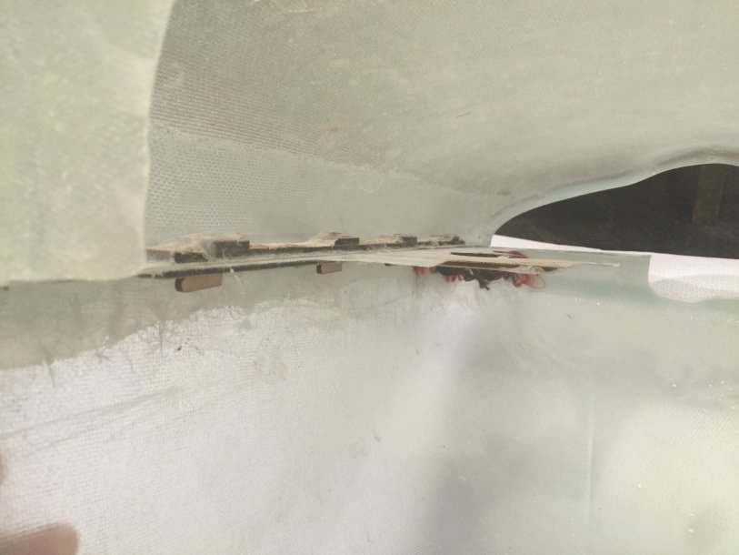

as you can see, the bottom cowl got some areas reinforced with plywood/popsicle stick, and fiberglass tape and epoxy resin.

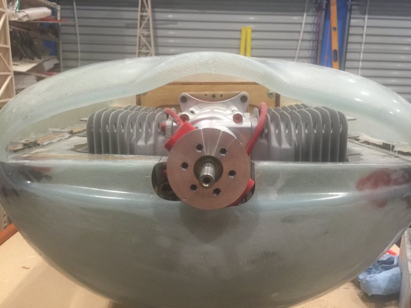

Here is the front view, with the top cowl mounted and engaged. The baffling is not complete yet....

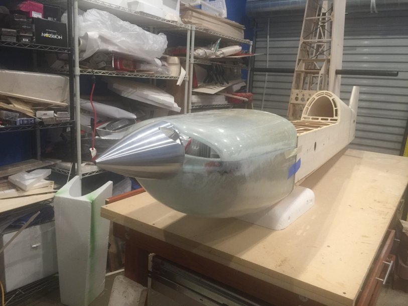

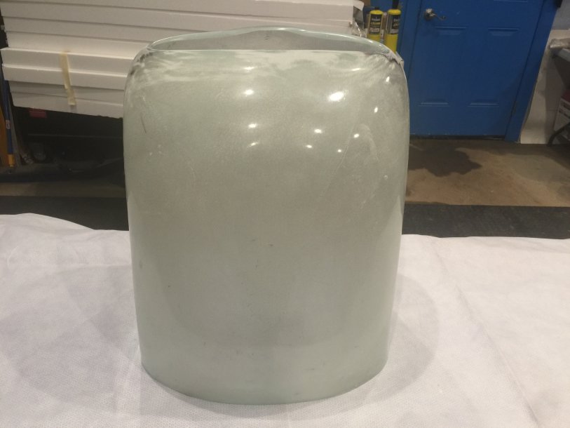

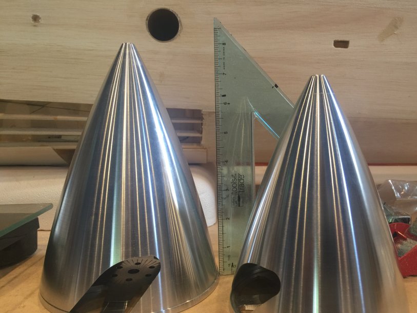

an idea with the spinner on....

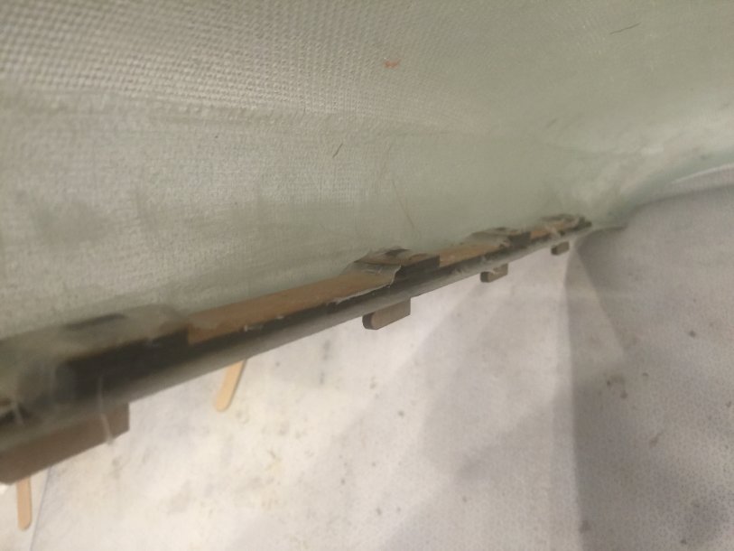

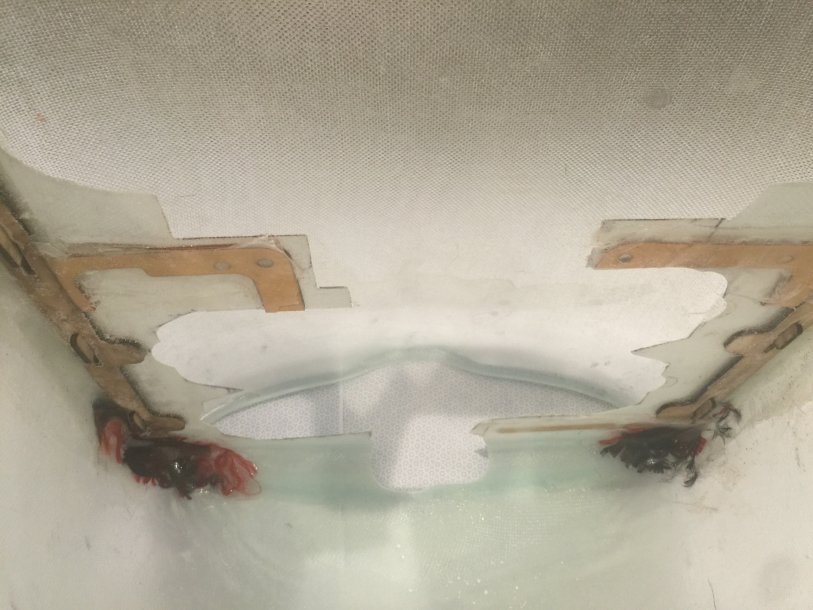

another view of the reinforcement.....

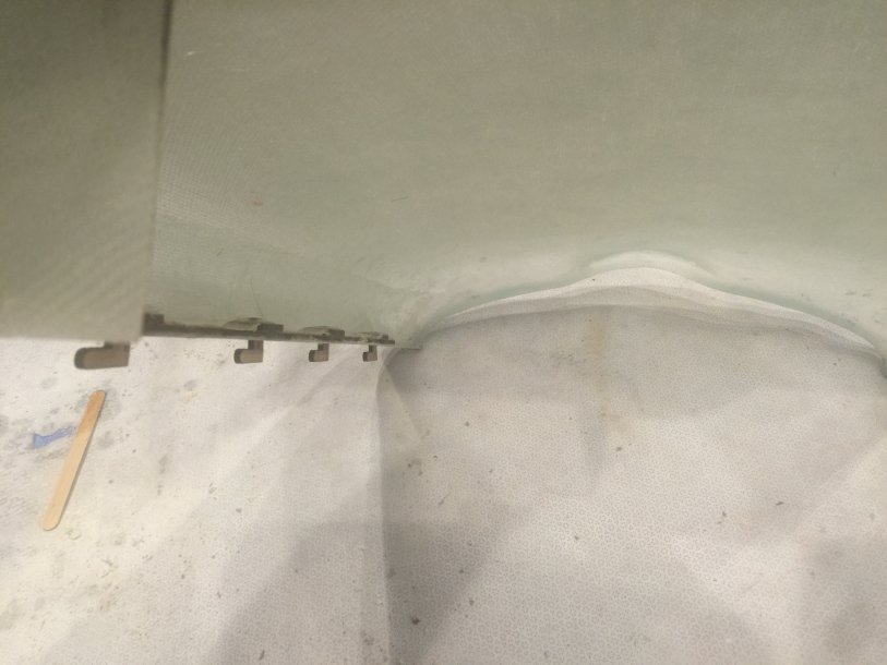

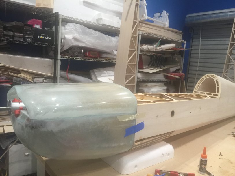

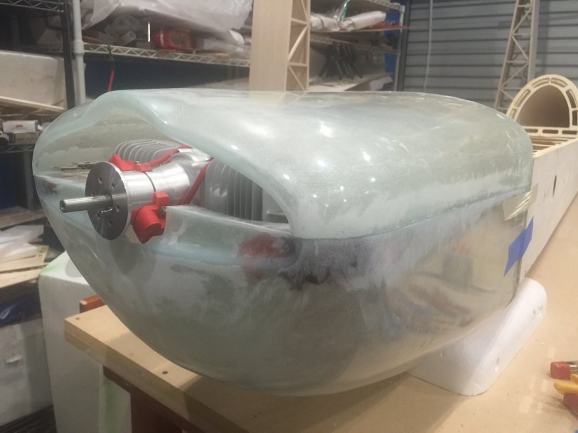

View attachment 54989 View attachment 54990

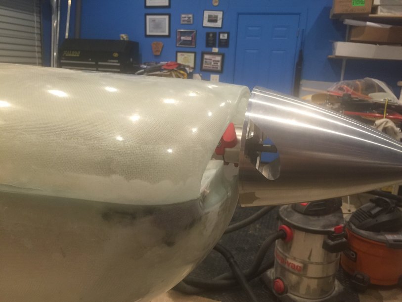

View attachment 54991 View attachment 54992

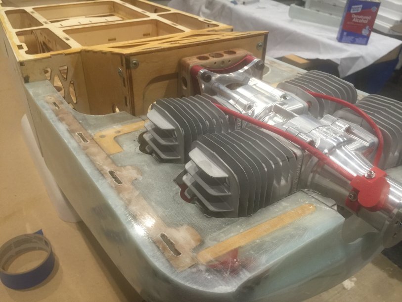

View attachment 54993 View attachment 54994
