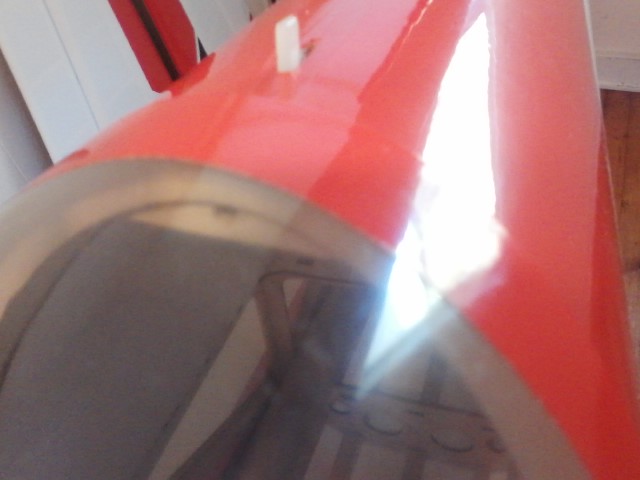

My Pilot Extra 330sc 78" is "Officially" an electric version now :too-cool:. Hatch removal a snap now:rolleyes:.

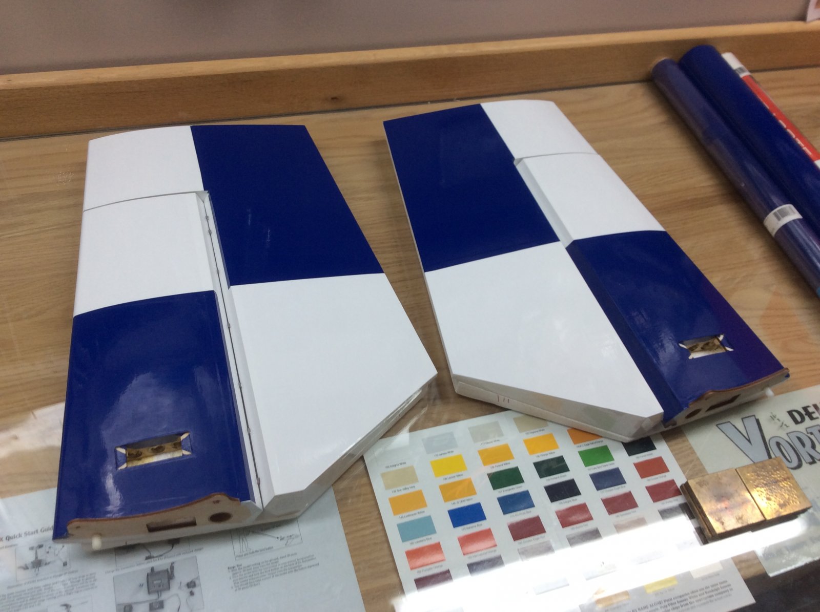

Got the stabilizer's done took a lot longer than I had anticipated. But end up looking good the top is just white do not know what to do jet. Thinking of copying the original design done for the ViperSt but with orange whit and blue. I do not know if I should do the wings next or the fuselage. What would you gentleman do.
