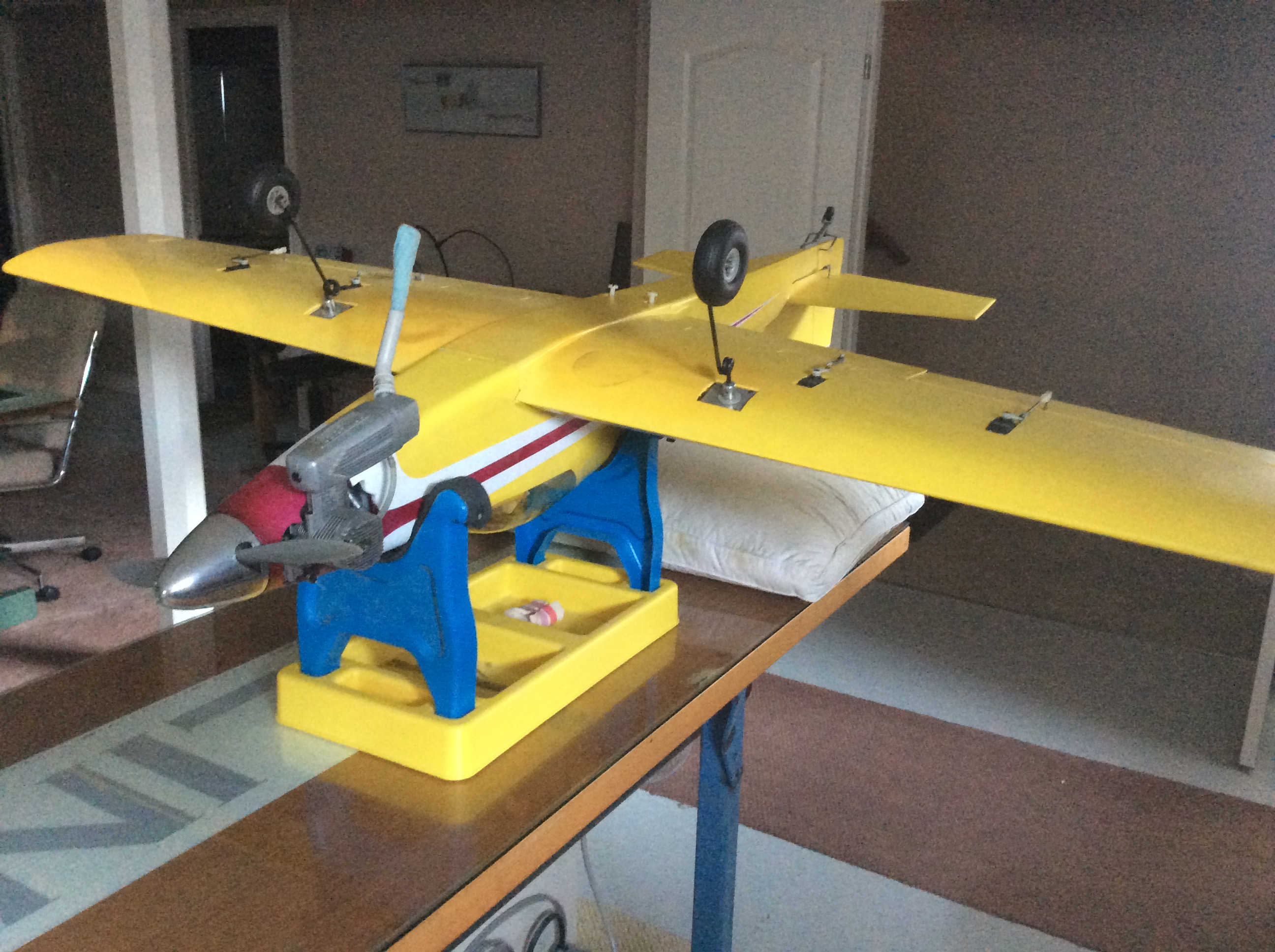

Ok another day at the field and not flying because of the wind. So on my way home I had a thought I need something that can fly under these conditions. So hopefully this solution will do the trick or at least let me know if I am going in the right direction. I had built a scratch built plane in 1994 it was a copy of an UltraSport with some changes. Going pull all the radio gear and install the best and fastest servos and very good 3 Axis gyro and set it up with very high gain. Or as high as the plane can tolerate. Will see how will this works.

Hopefully I can get the engine running today. It is OS75 so it should have enough power to push through the wind. Once I get the engine running properly will take it out on a calm day and test fly it and set all the trims and get it flying straight and true. Then I guess get the gyro installed and start playing with it and see how it works and after that start flying in some wind.

Yes it will be the test the plane is built like a tank compared to days planes and heavy. I think that will be an advantage. When I remember back when I was still flying it it flew like a pattern plane, fast and penetrated the air well. Like I said time will tell. If it works I will get to do a lot more flying.

Well the OS 75 runs and it runs good. Had to put a new #8 plug in then everything was good. Man OS built some really good engines in its day. Idles good good transition and top end up 11250Rpm love it. Can’t wait to get out to the field and fly it again.

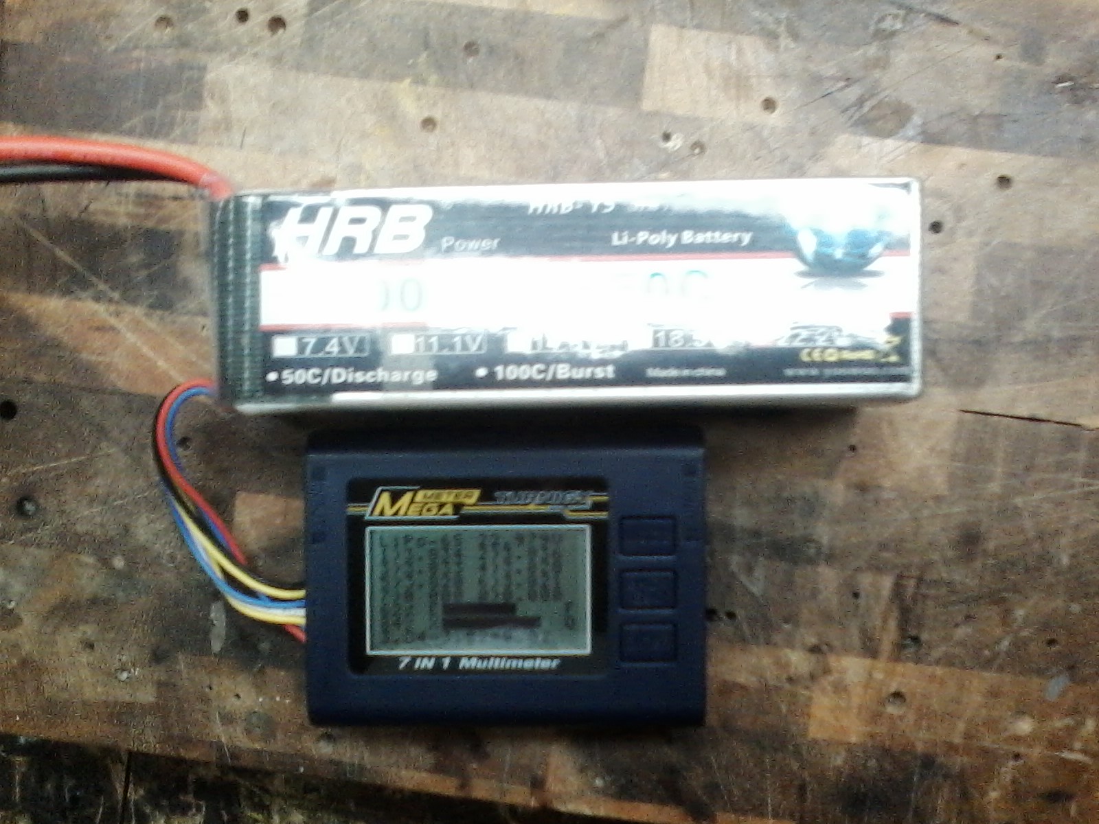

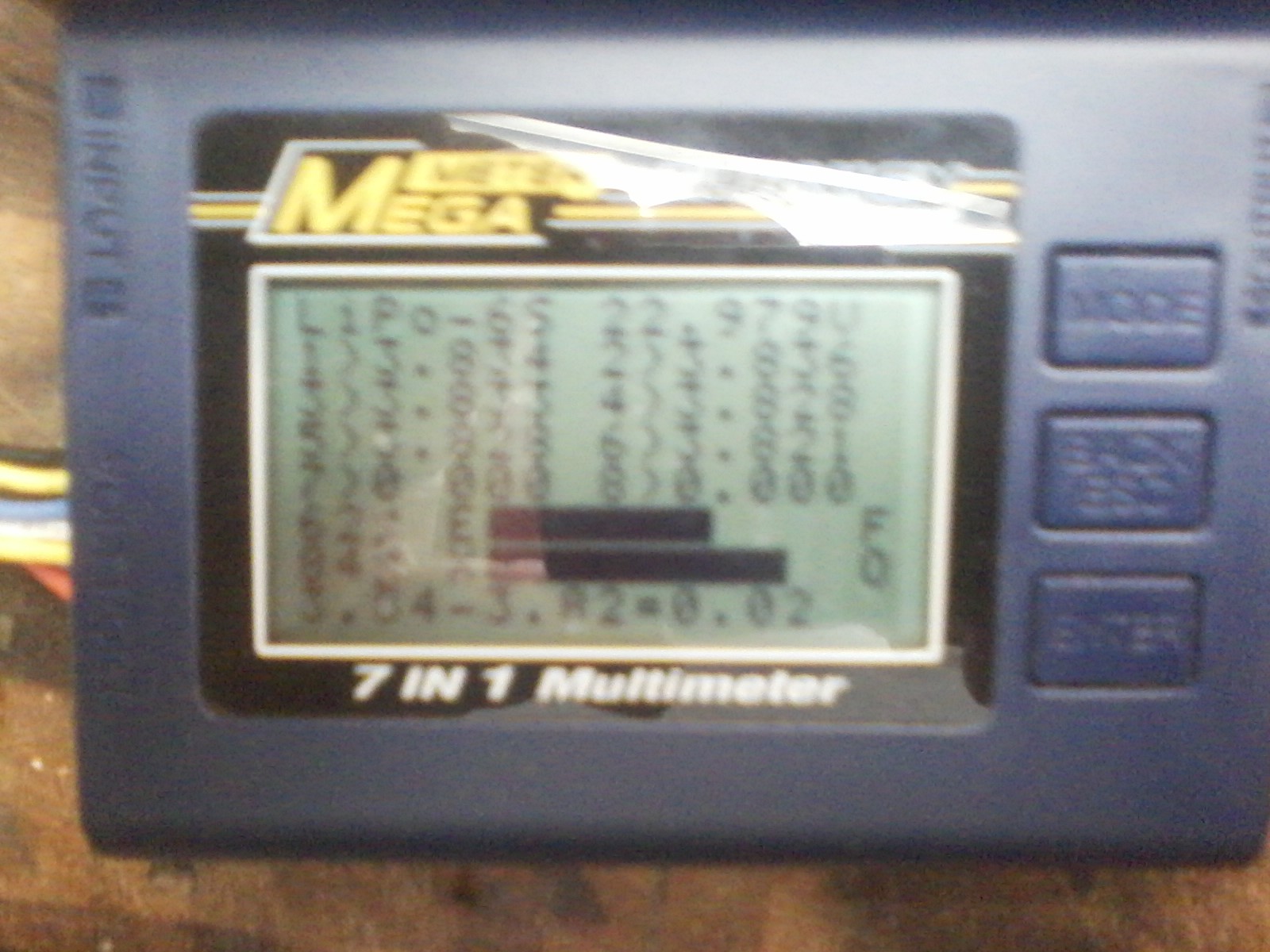

lol.....Have 4 cycles on each batt. They stay a bit warm after a flight but not hot. I should bring my infrared gun and see what the temp is. Just holding the pack feels like very warm water to the hand so 110 degrees or so. I just cruised around my last flight and had three HS bursts (touch and go's) and was in the air for a full 5 minutes and had 62% of the pack left! The HS is not that bad either for a 50C pack.
A 70C pack I think would put it over 120mph. Would love to try the new generation Graphene's @70C but pretty pricy. These HRB's seem to do nicely however with this EDF. Watched the vids on these HRB's and the I/R seems high but should come down as they break in. We will see......

How and when are you measuring your IR. Got a good meter a about a month ago and it has been a real learning experience. Not much info out there about it and the few people that seam to talk a lot about it are not knowledgeable on the subject. One thing that I have learnt is to take the readings at the same state of charge and the temperature at room level, otherwise it will be all over the map and nothing makes sense. So what I have been doing is when I get home I will charge the batteries to storage charge and then let then sit for a while and then take the readings. These numbers are repeatable and a lot more consistent, and they seem to be trending. One thing after having this meter I also have PL8 charger that gives a IR reading while it is charging it’s ok but just something to look at they are way off when you trying to set a baseline, and change throughout the charge and the rate of charge.
One question there is a way to calculate the C rating of pac with IR numbers been trying to find this info but have not been successful do you know how to do this by any chance if not where look for it.
I have an I/R meter built in to the multi meter I have. Don't use it much because it will only read a 2S pack ( or 7.4 volts). I need to make an adaptor for 3S and higher packs that will limit voltage to 7.4 volts. The I/R is accumulative across all cells but read across the first cell in the pack. So reading a 6S pack with it (using adaptor) is not getting a true reading across all cells in the pack. Only the first two. So I need an I/R meter myself lol. Your PL-8 charger should calculate the c rating using I/R??? http://www.jj604.com/LiPoTool/
