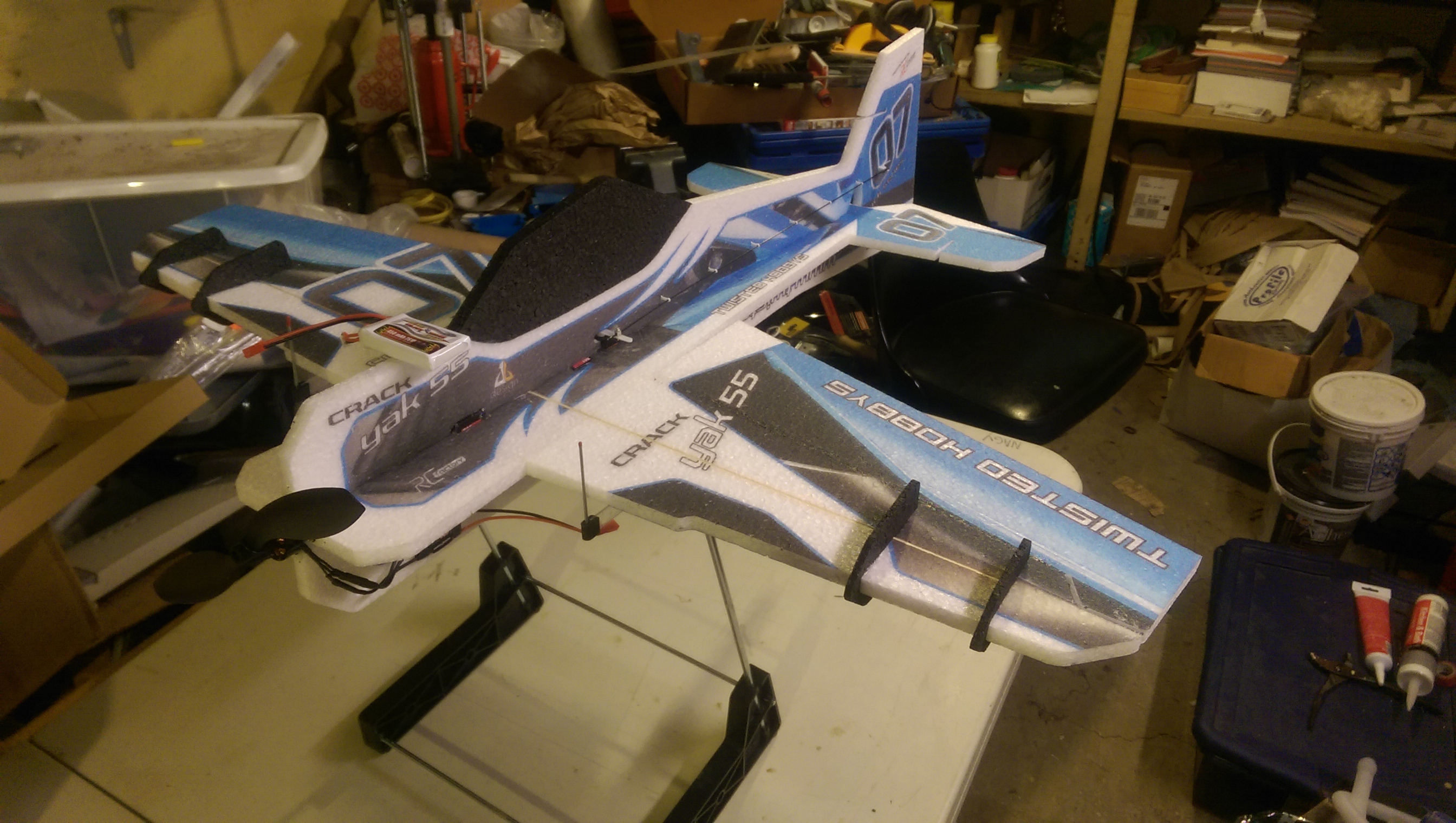

alawson999
Think I will be ready for a first flight tommorrow.
Just need to tidy up some wires and do the blenderm/welders re-ibforcements on the hinge lines.
alawson999
Maiden flight today successful.
How successful?
Felt good enough to do a knife edge loop on flight #1. ;-)
As always with a new plane, lots of trimming and tuning yet to go, but lots of fun straight away.
Built with standard components and the carbon fiber upgrade. Only deviation was the control linkages - those tiny things made me crazy, so I used Dubro 2-56 clevis and ball link method that served me well in the past.
One question - on all my other TH airframes, once I determine best battery location, I use the "thru hole" method, backed up with a small velcro strap. Same plan OK with the 39" airframe? Seems like lateral balance would be better ...

Congrats on the maiden! The 39" CY is a really good flying plane. I don't have one but my buddy does, I found it to compare favorably with the Telink 43" planes.

FWIW, I have my 850mah pack longways in a thru-fuse slot over the wing. The batt is centered just aft of the spar by about 1/2".. but all batts differ in shape... Flying a TP 850 that's pretty high output.... Nice plane! :thumbup:
