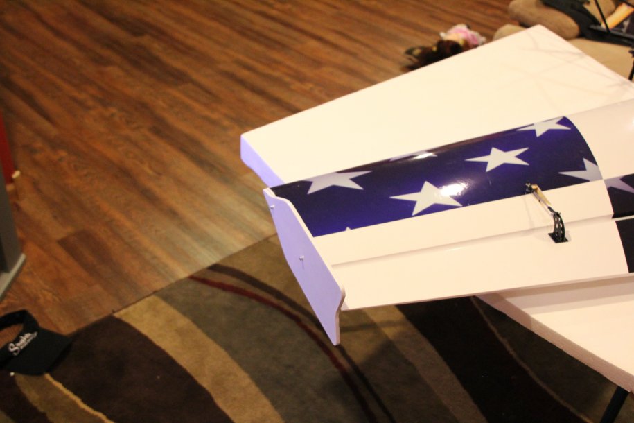

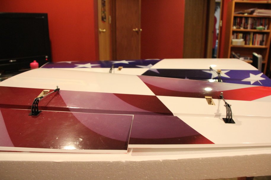

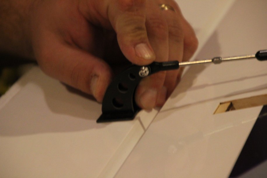

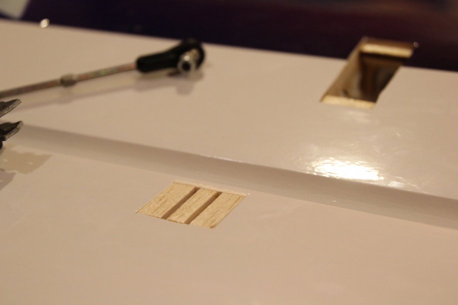

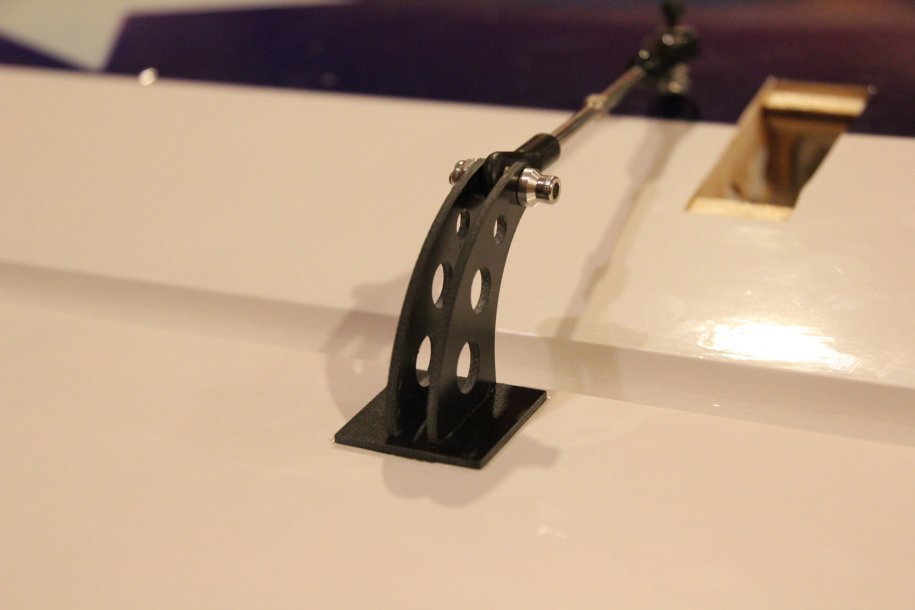

Installing the control horns. Place them so the hole is directly over the hinge line and cut the covering. Use epoxy to install. I install a ball link to keep them straight and in the correct position.

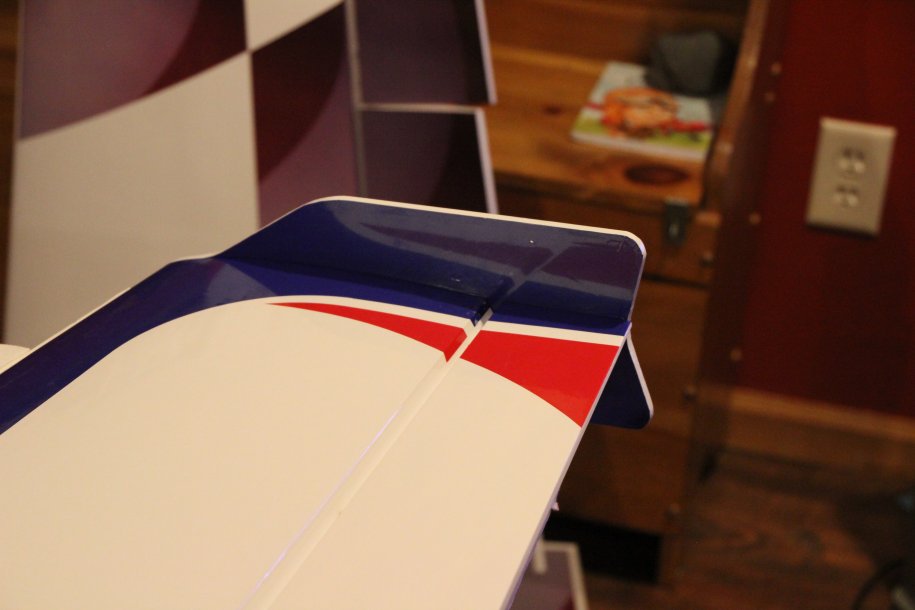

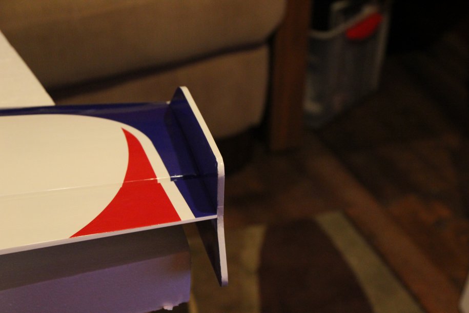

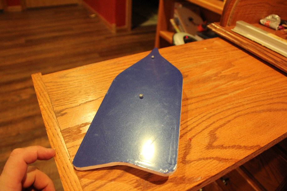

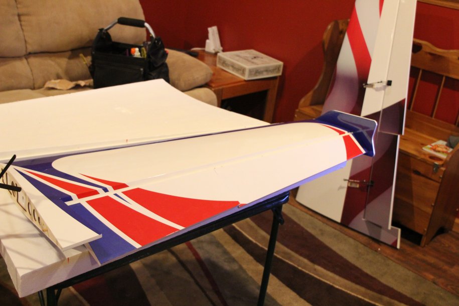

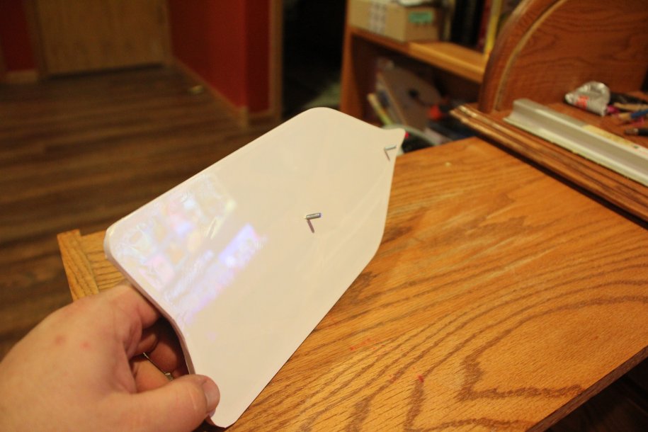

I was able to get the SFG's covered tonight. I did blue on the inside and white on the outside. The end of the wing is blue and that is why the blue is on one side. I like it to match and not be such a harsh transition

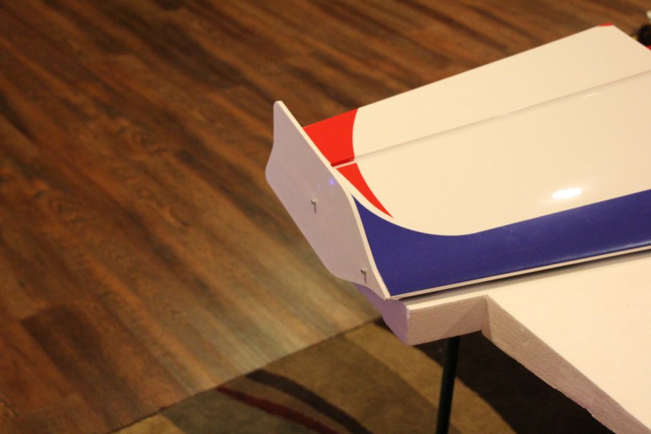

I drilled and tapped the wingtips for the SFG's, but don't have any foam safe CA left so I will get some tomorrow. Also need some more bonded washers. I will use bonded washers for spacers also, so there will be a gap where the pic shows none.
