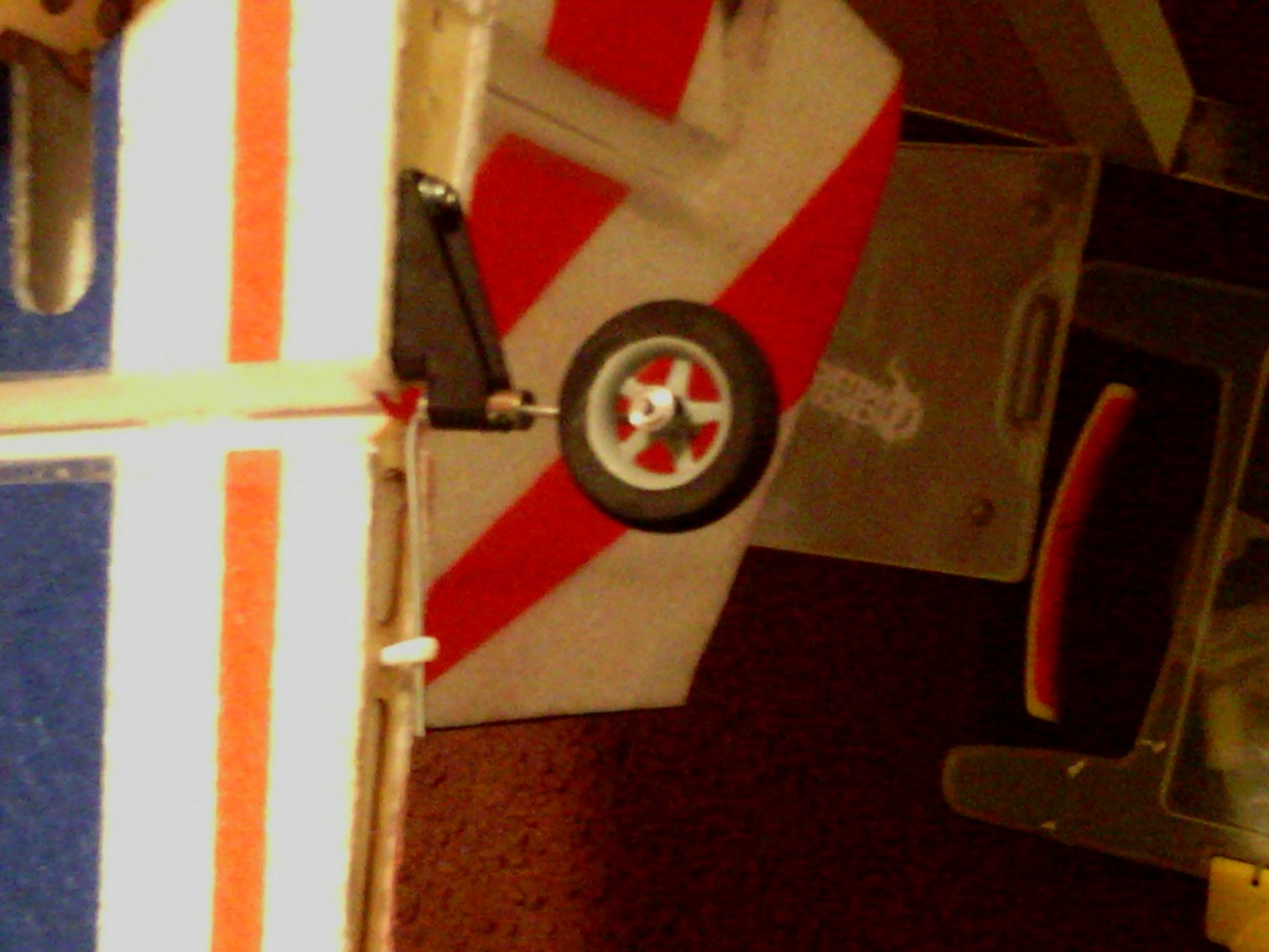

there was only 3 things i didnt like about the wattaplane slick, LG bolts, wing bolts and tail wheel. well i broke my tail wheel assembly yesterday, actually wasnt even on a landing. i was holding the tail up with my hand and the wind knocked it out of my hand, the tail feel to the ground and the gear broke. so i made my own out of a dubro gear and an EF wheel. should work out pretty decent.

ha yea, its the only thing i had laying around. would have like to went alil lighter i have a CF tail wheel that needs some repair that ill probably use.

oh , yea, you guys that have one, you need to rig up a different tail wheel. i was thinking about changing out the one i fixed up yesterday but after this evening its gonna stay on. no rudder drag'n on harrier landings, or even scale landings.

I changed my tail wheel also, it had the tail sitting too low for harrier landings. My buddy had a tail wheel from a hanger 9 extra laying around that I used. Simple setup, Aluminum bracket, bent music wire and a nice fat 1" wheel. didn't change the cg at all.
