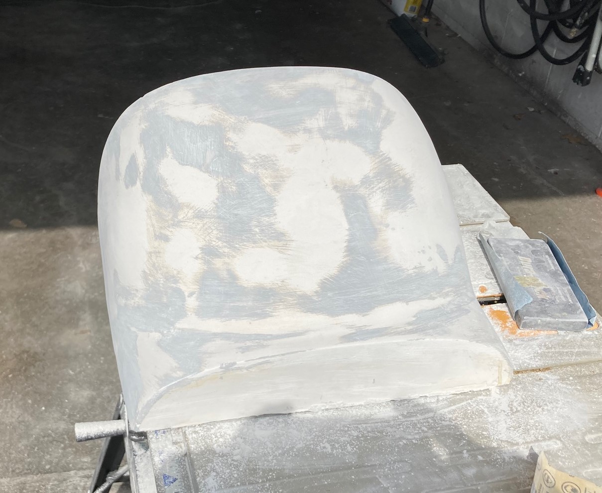

What parts are you looking for? The fiberglass part or windows or both? The fiberglass part is far from perfect and it will take a few prime and sand sessions. You can see in the photo the shinny and darker spots are low, I quickly block sanded to see just how it looked. As far as the windows I have a sheet of .040" PETG the would be good for the windshield and was planning to use the same for the sides glass and another canopy for my One Design. I'm fairly sure that .030" would work just fine for sides so if you want the windows as well I would buy a sheet of .030" now. My vacuum form size is 24" x 32" so I can get 6 pulls out of a 4' x 8' sheet, the sheet would give me 2 sets of side windows and 2 mistakes or prototypes.
