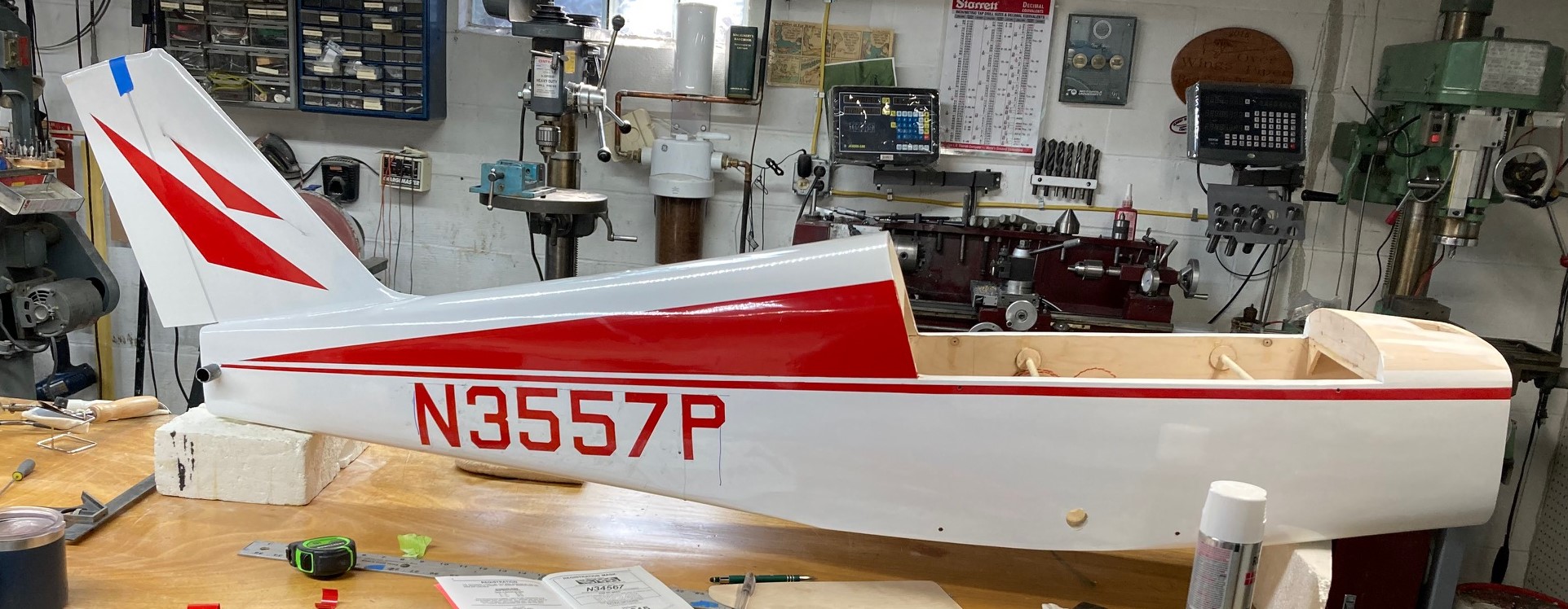

Looks like both of those planes hit the tail skid, the small photo has damage. I may add the a tail skid to mine. Here are a few views that may help in the redesign if decide to go forward. My build is more standoff scale and will hopefully become an everyday flyer.
As far as the engine size my intent was to over power so it will fly at a low power and give a scale like exhaust note, or that is the plan. My previous plane was overpowered and the throttle was set to 60% open at full throttle, even though it was 2 stroke it did sound good in the air. Pretty sure this one will sound better.

The former itself was found on E-Bay of all places. I hadn't noticed the bent skid. Looks to me it had been used as a tie down and the wind tried to swing the tail. Not a good practice. That owner probably let the wind bang the control surfaces back and forth too.

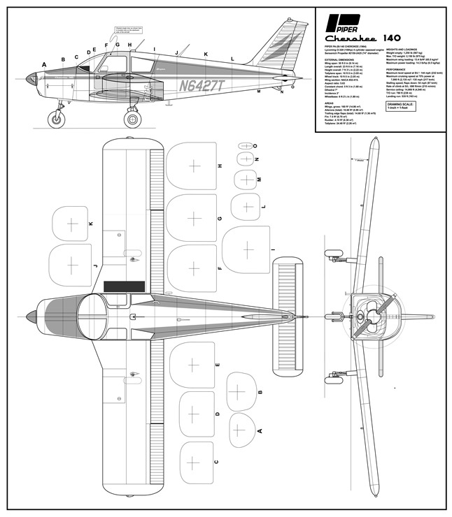

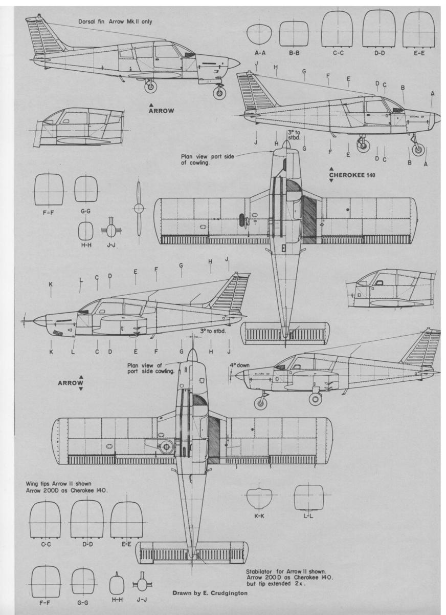

I have both 3 views. The first I have in vector and have been able to get blow ups of it to the same scale as the WH plans. However, notice how it shows straight sides on all the formers? That's not right. The sides behind the cabin are slightly curved. The WH plans have the right idea but I think they have too much. Especially the cabin sides as they are flatter than the rest. Yeah! I've turned real anal about this project.
The second 3 view is more accurate with the sides. But the problem is blowing it up to a decent size without having lines a foot wide. I've not yet mastered the computer skills required to correct this. And at 69 years of age I doubt I ever will.

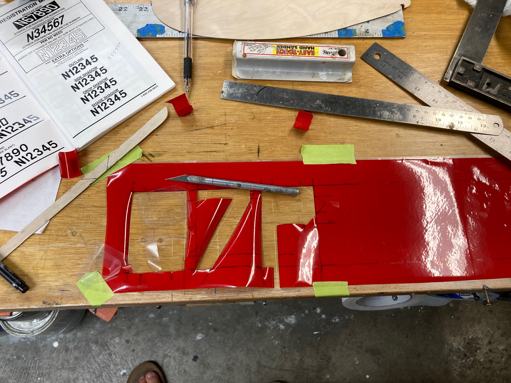

Ordered graphics from Aerographics, they make logos for full scale planes and can reduce the size for our models. The white Piper logo will go on behind the rear window and the chrome Cherokee 140 logo will go on the cowl after painting, might put it on before the clear coat. If you are doing a scale build check them out. This is the third plane that I used them on.

How did you find a vector drawing? Another question, where did you find the info on the info on the original model?
The drawing I found on line somehow. I may have the url but will have to look for it. Basically some guy drew it up and put it out there for free. However on his drawing all the sides are straight. Still, once printed it makes a decent reference.
The info? I contacted WH directly and they put me in touch with the guy who built the prototype, the one you see in the pictures. He gave me all the info.
