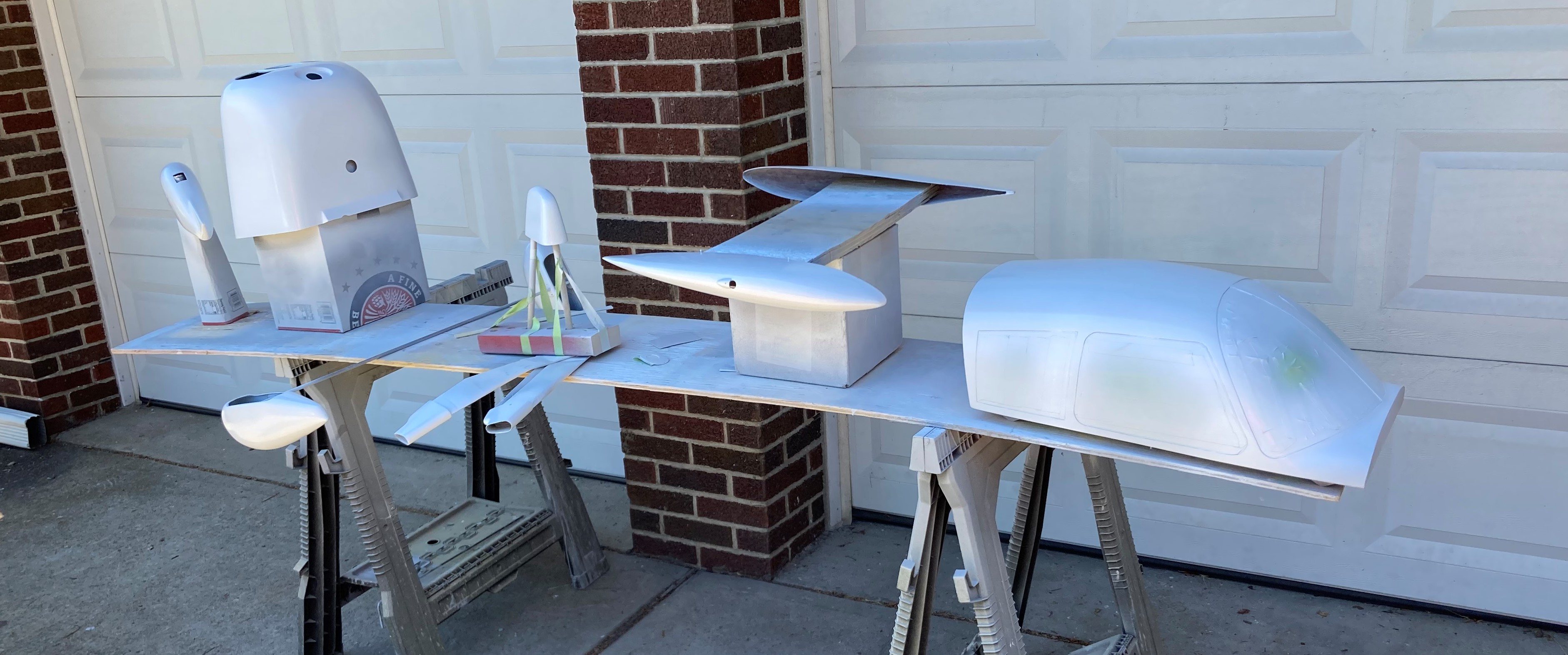

Finally got to the point where the defects in the primed surfaces were getting had to see ,added guide coat. Hopefully one more bout with the primer. Might take a trip to the autobody store today. Need white base and clear coat, have the red base already.

Wet sanded the parts with 400 yesterday and dusted on a coat of white epoxy primer. Going out flying this morning with a friend and depending when I get home I may get the white base color on.

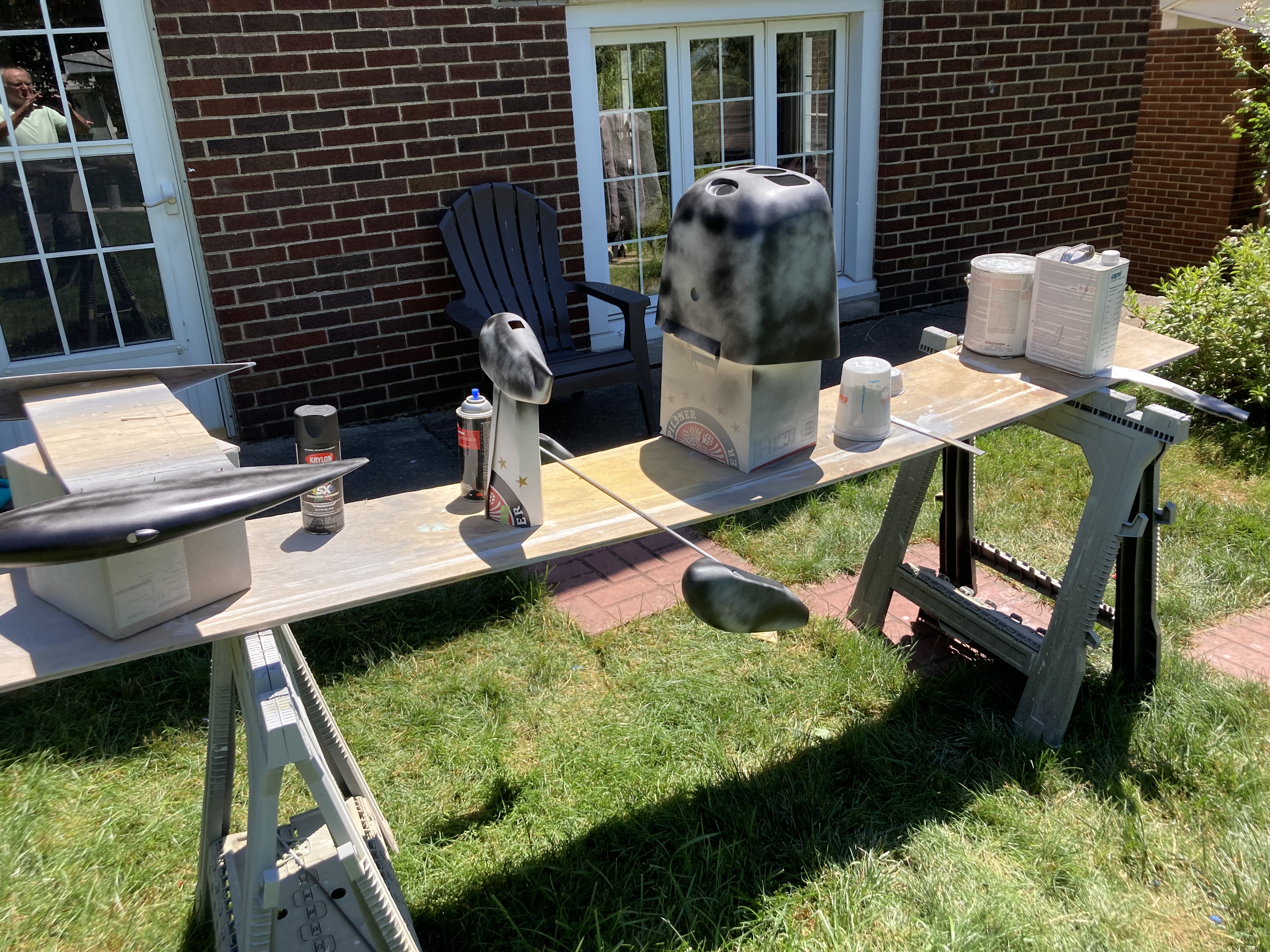

Got home around noon and went to work. Scuffed the primer with 600 and put the white base down. If all goes well tomorrow I'll mask and paint the Missile Red trim. While looking at the product sheet for the base coat noticed that it is optional to put the same hardener in the base color as the clear coat, sounded like a look thing to do since it may take a day or two to complete the masking.
