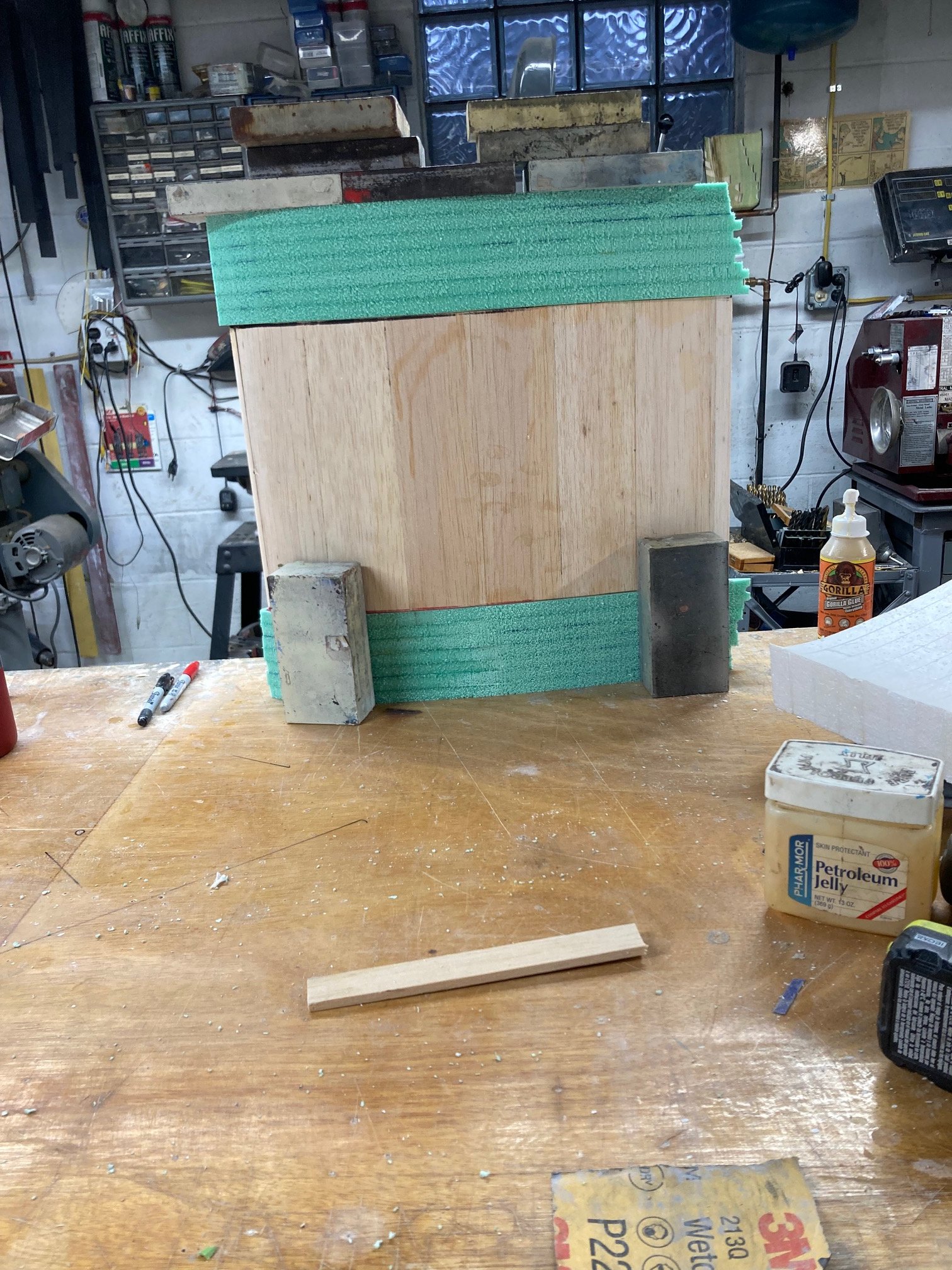

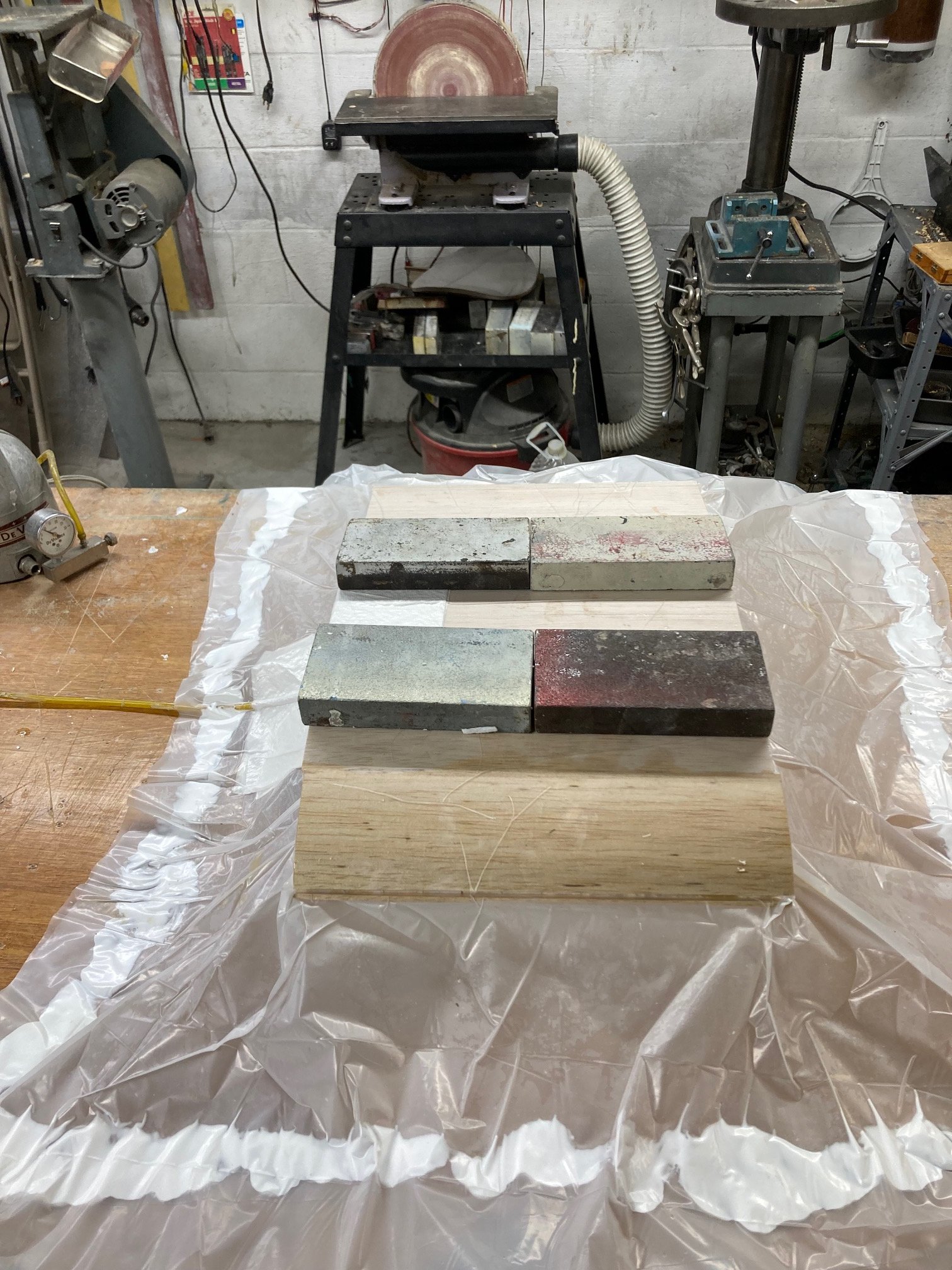

I think I'm done with the hot wire bow for a while. Cut a 12" section of the wing tip profile to make molds for the wing tips. Planning to use foam to fashion the plugs, too much balsa would be wasted. On the flip side my pile of heavy 1/8" balsa sheet is getting smaller, kind of happy, too heavy to use for building and too cheap to throw it away!

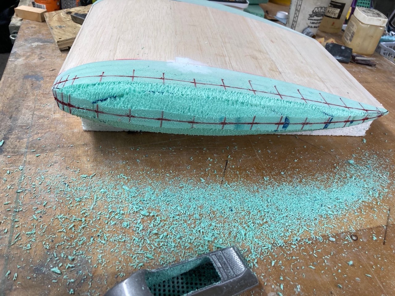

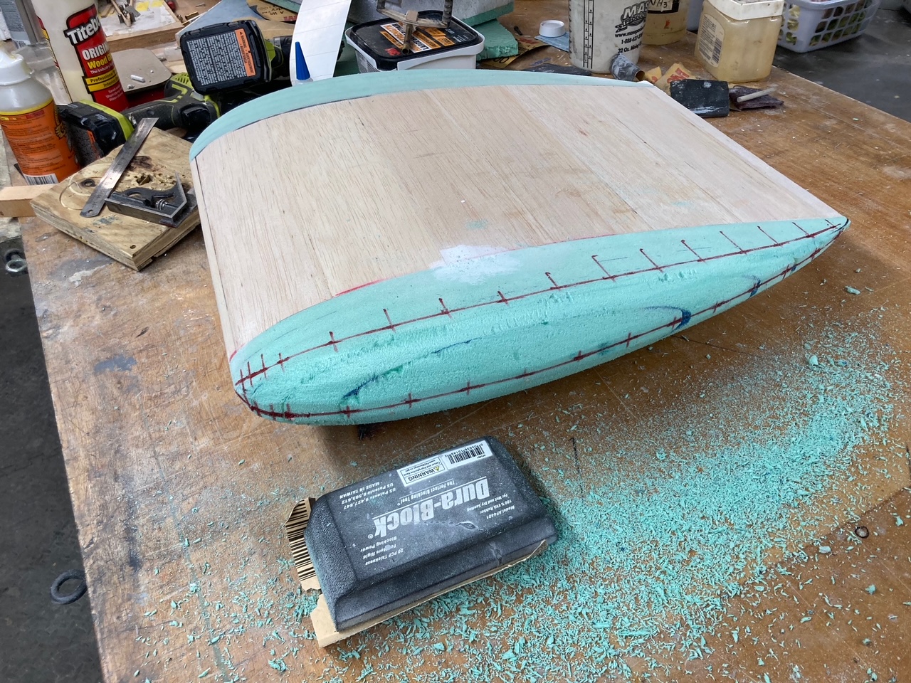

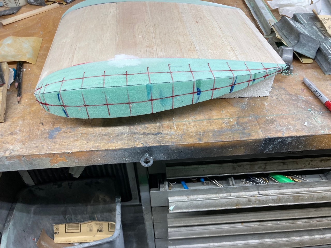

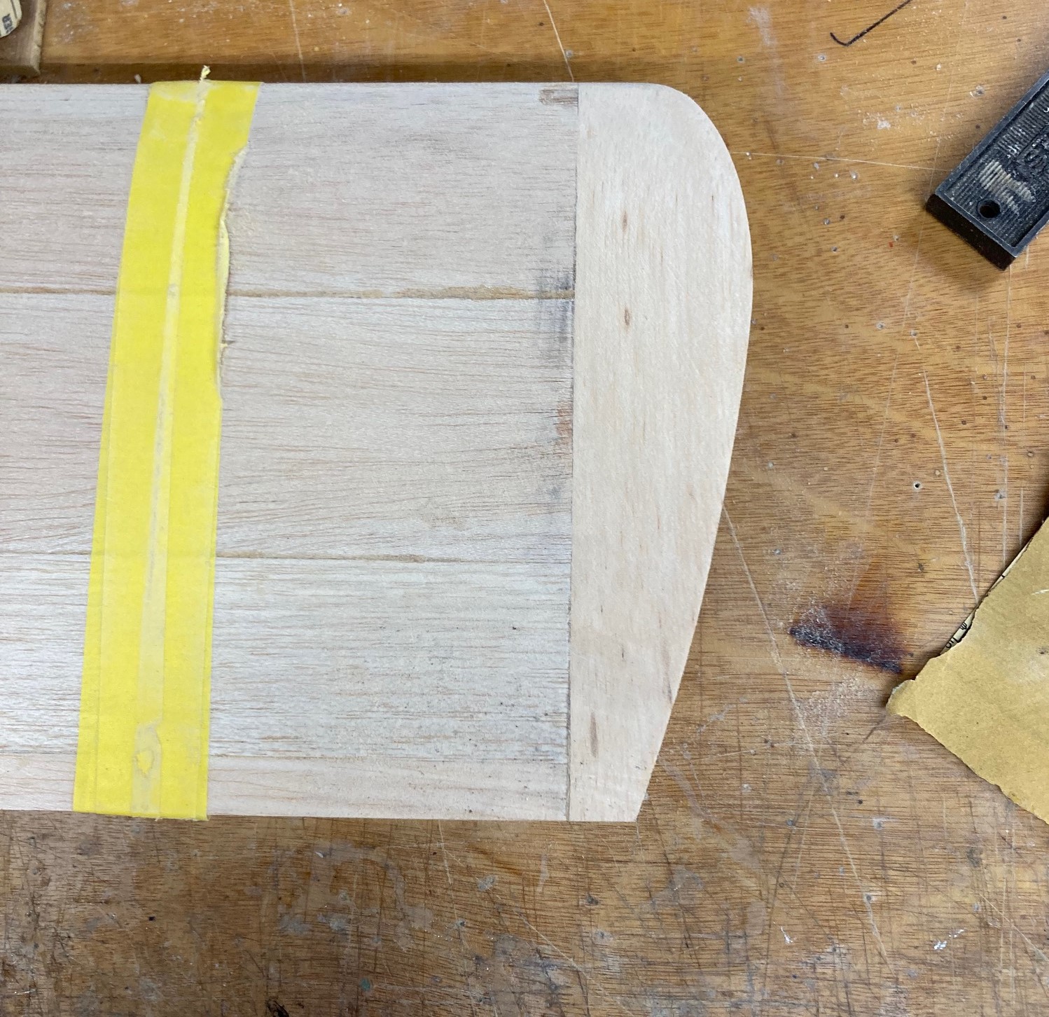

Wing Tips, not shoes!
First the foam blanks are rough cut to the airfoil shape and glued onto the short wing section. The wing tip curvature was copied off the three and laid out, a template was made so that both sides are nearly identical. Then the foam was sanded down to the balsa sheeting. Then stations are laid out and the centerline of the tip was plotted, half the thickness is also laid out on the top and bottom. A Stanley Surform takes the bulk off quickly, then sanded with 60, 80 , and finally 220. The dents and hole are then filled and will be ready to glass.
