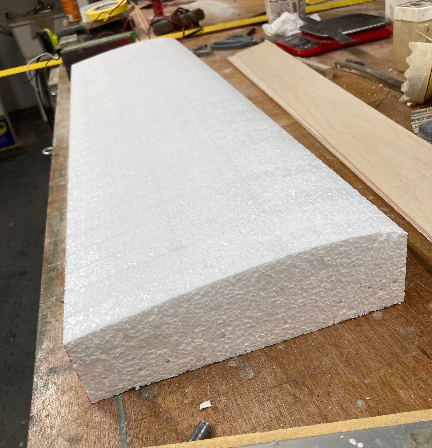

Pulled the tail cone out of the mold, fits great. Working on the plug for the rudder Got a block of EPS glued up for the stabalator plug. For over thirty years been cutting foam with .025 steel MIG wire, for whatever reason I decided to try nichrome wire. got 100' of 26 and 28 gage to try, it's about half of the diameter so I'm thinking it may cut easier since it's melting less foam. Hope my power supply is up to the task since it has more resistance. It is getting harder to find EPS foam in my area, must be an EPA thing?

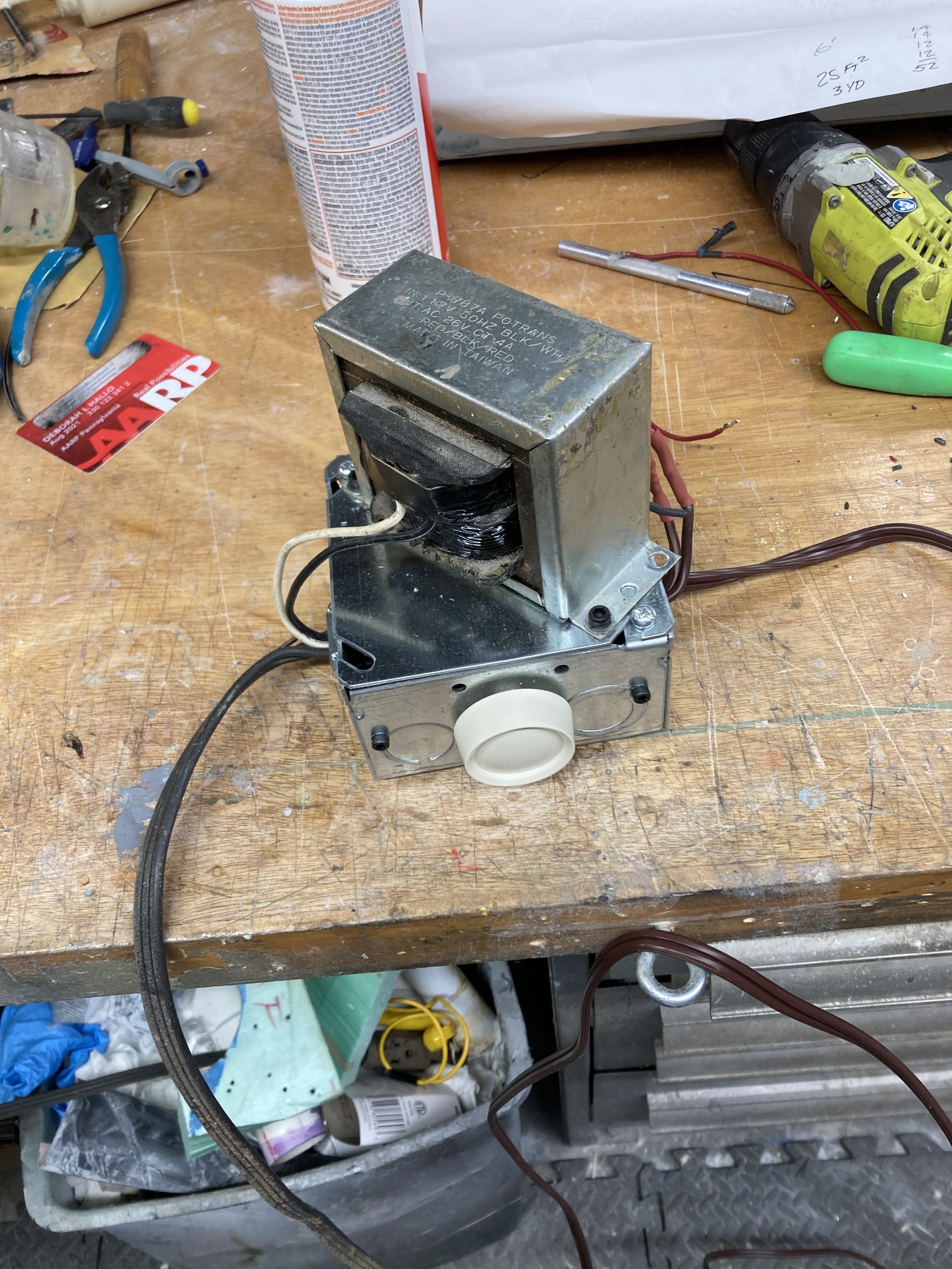

So start with the 28 gage nichrome wire with my existing power supply, a low voltage lighting transformer. Doesn't even feel hot. Next try the 26 gage, barely warm. Test voltage and learn it is 12 VAC, now what? Then I remember somewhere I have a transformer that was salvaged from onboard boat charger, 26 VAC. Hook it up and seems OK, maybe a little hot. Cut the foam great with less effort than my previous cuttings. Plan to mount the transformer on an electrical box with dimmer the control the temperature.

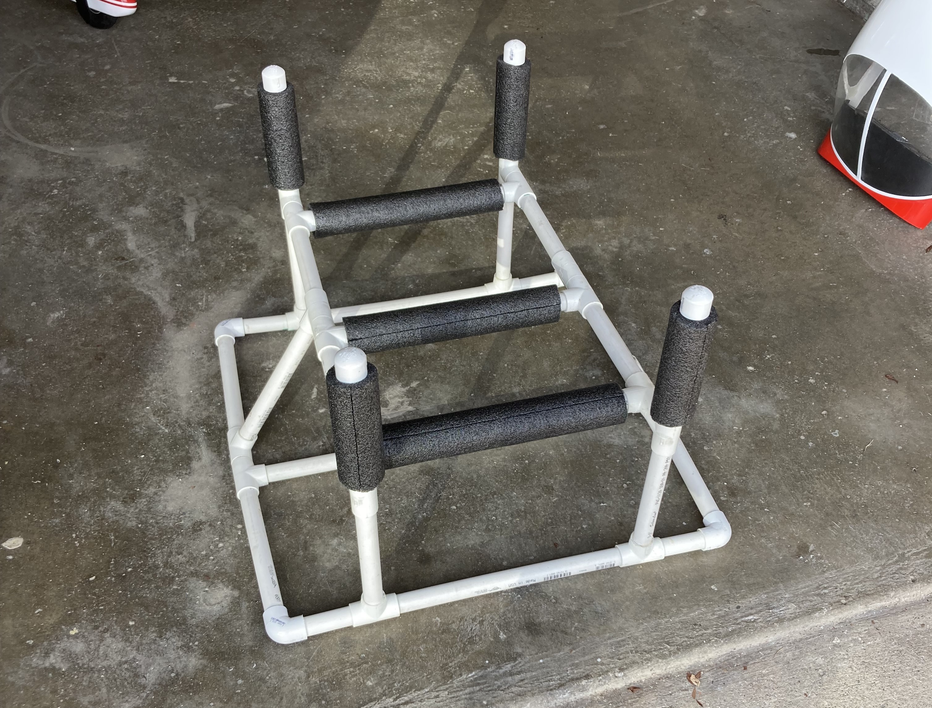

One of the clubs I belong is having an informal get together on Friday, I plan to take the Cherokee fuselage for show and tell. Thankfully I saved the shipping cradle.Started estimating the mold cost today, looking at about $400 in materials, not sure what the shipping is on a 5 gallon bucket of resin will be?

Mounted the transformer and hooked up a dimmer switch. Can control the current between 1 and 2 1/2 amps. I think 2 amps may be a good setting.

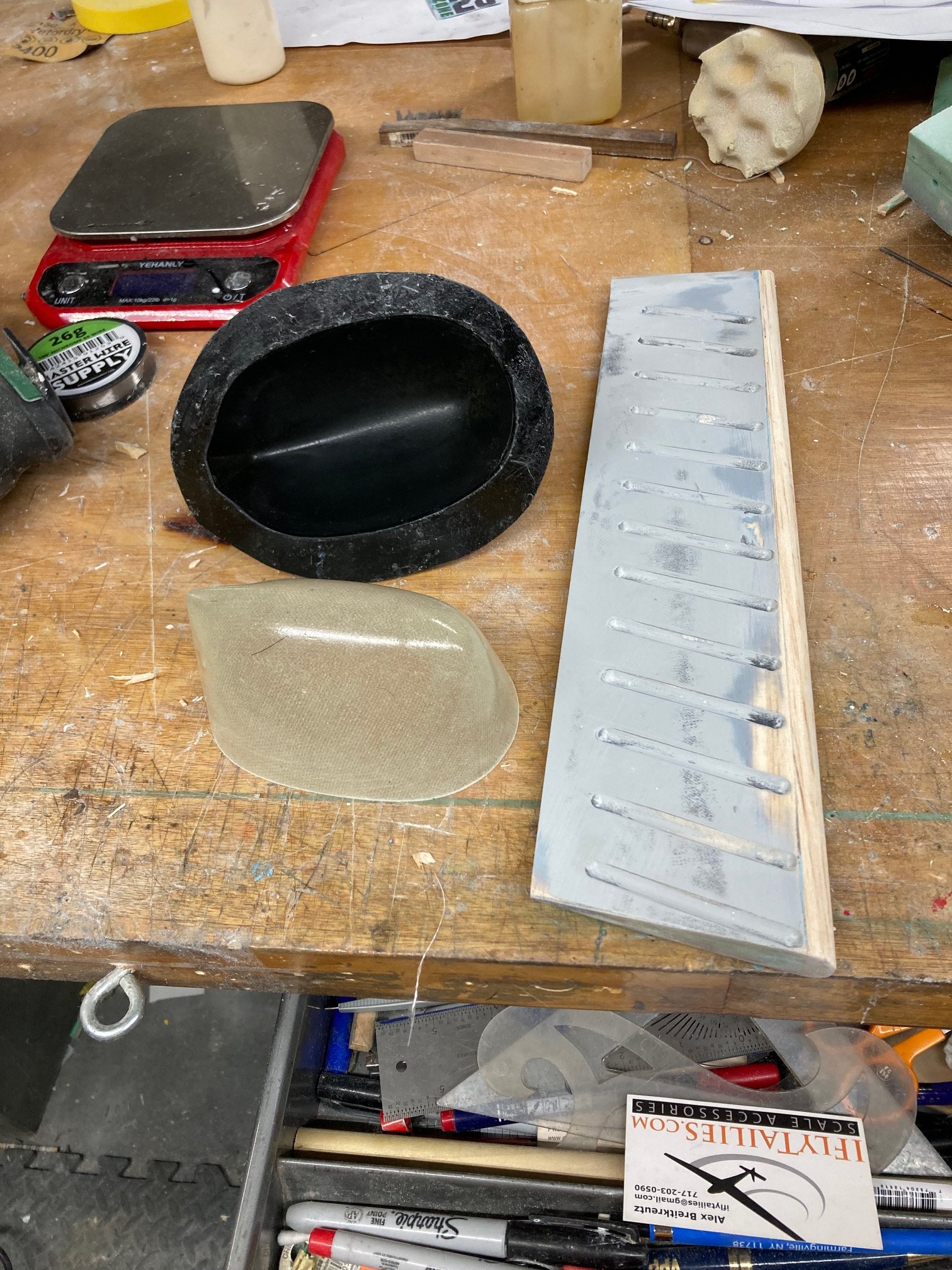

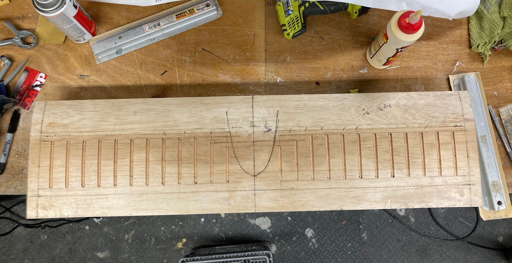

The corrugations went much smoother on the stabalator. I think that all the wood was about the same density so it seemed to cut better. Rather than harden with CA I decided the paint the grooves thin epoxy. We'll see how things play out.
