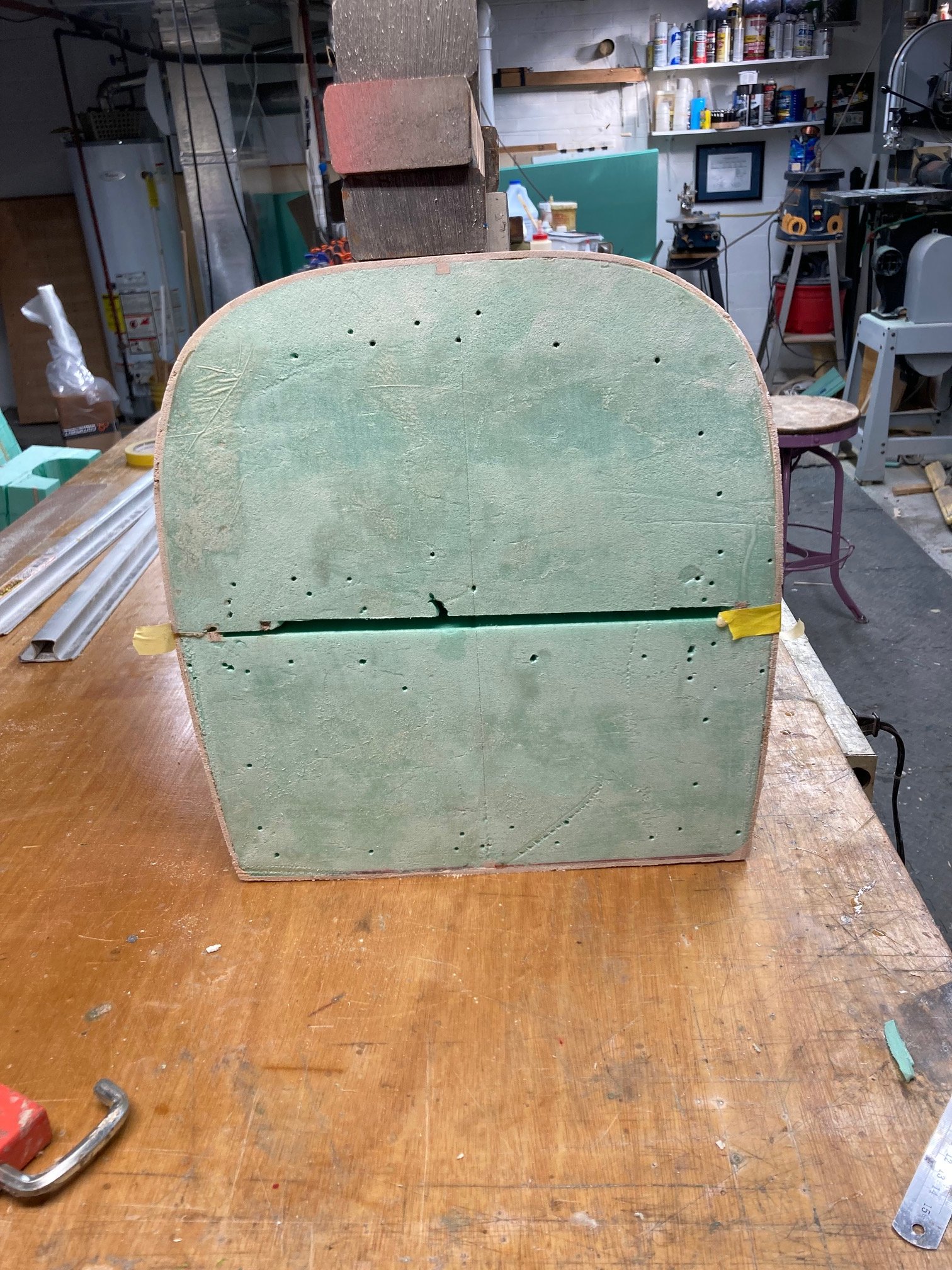

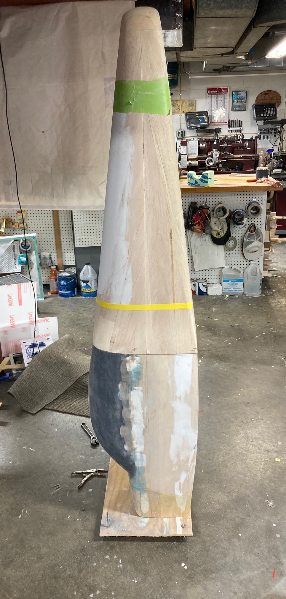

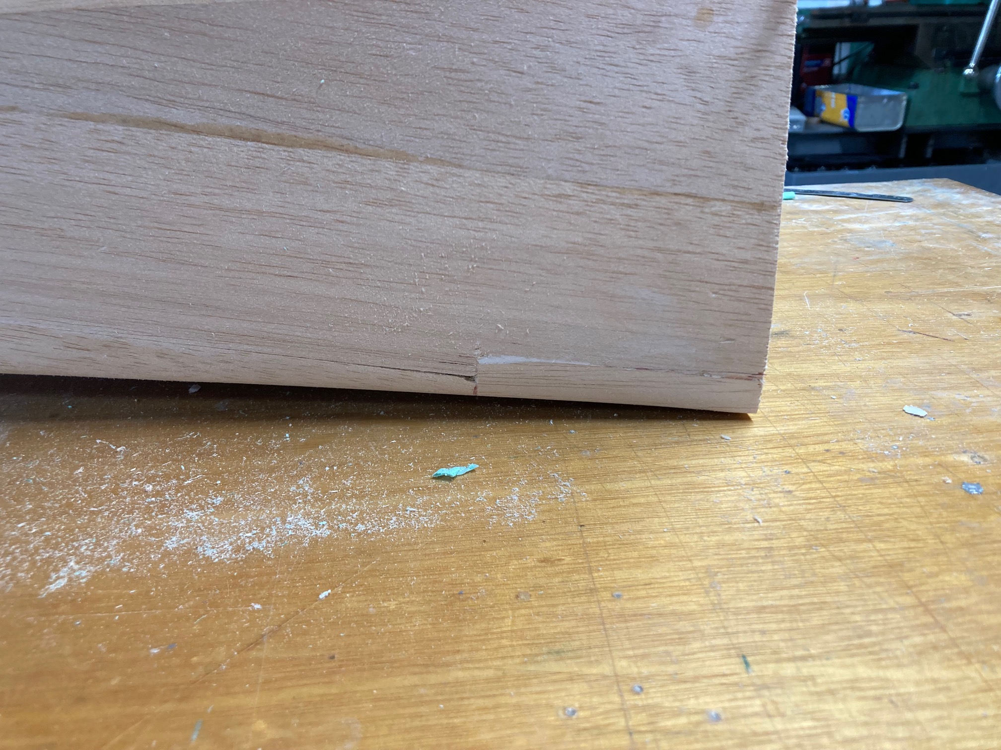

Vacuumed the bottom half skin on yesterday and jointed the halves this morning. For the bottom corner where the is a 90 degree bend rather than attempting to bend the wood I left it a little short and glued a piece of 3/4" tri stock and sanded to shape, it worked out well. Next the front half and back half will get married.

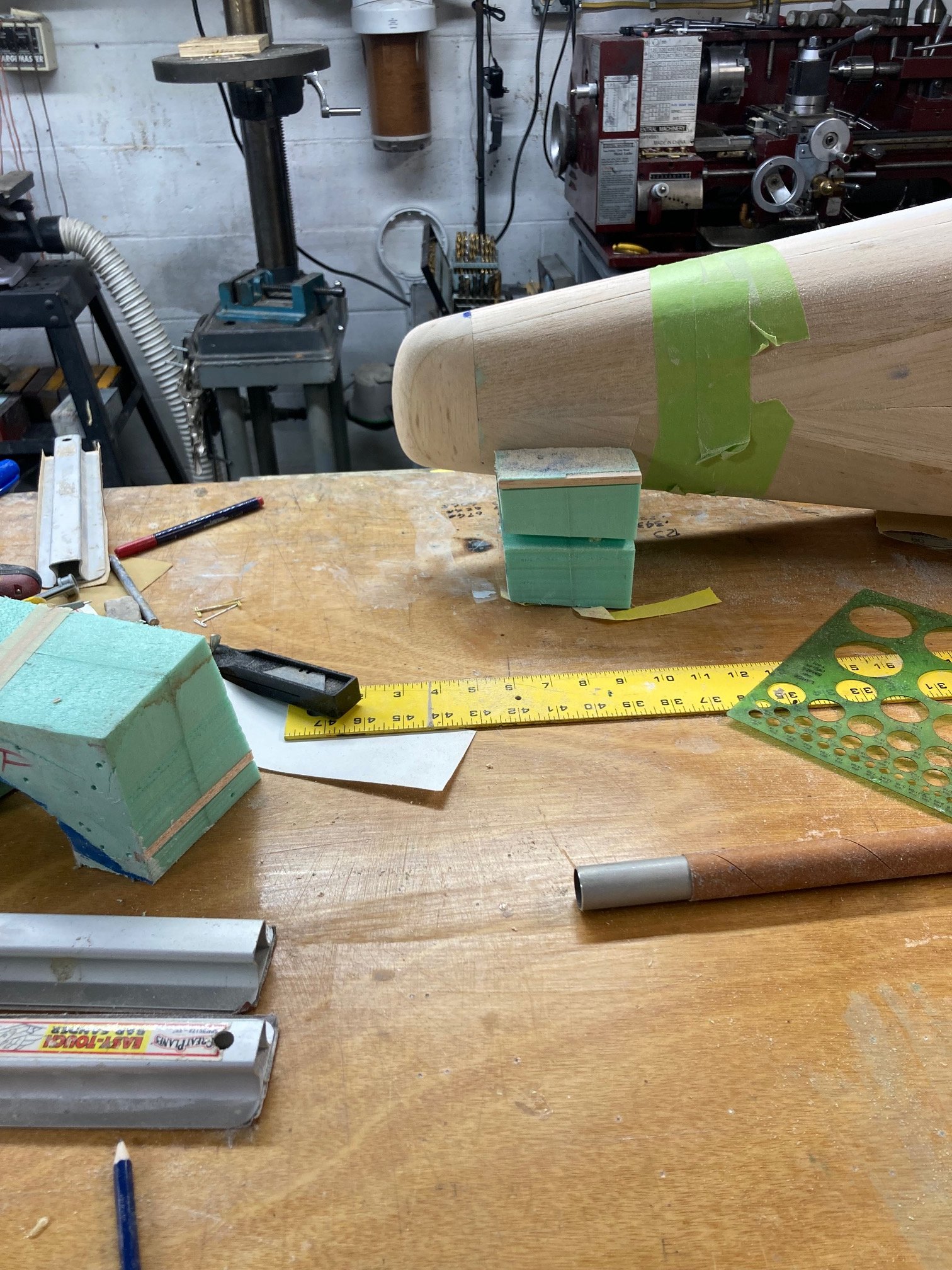

Started studying the shape of tail cone, it is quite a bit different than the previous Cherokee. Once the halves are joined a tail cone plug will be formed. Will need to install the vertical fin and rudder to finalize the feature on the tail cone.

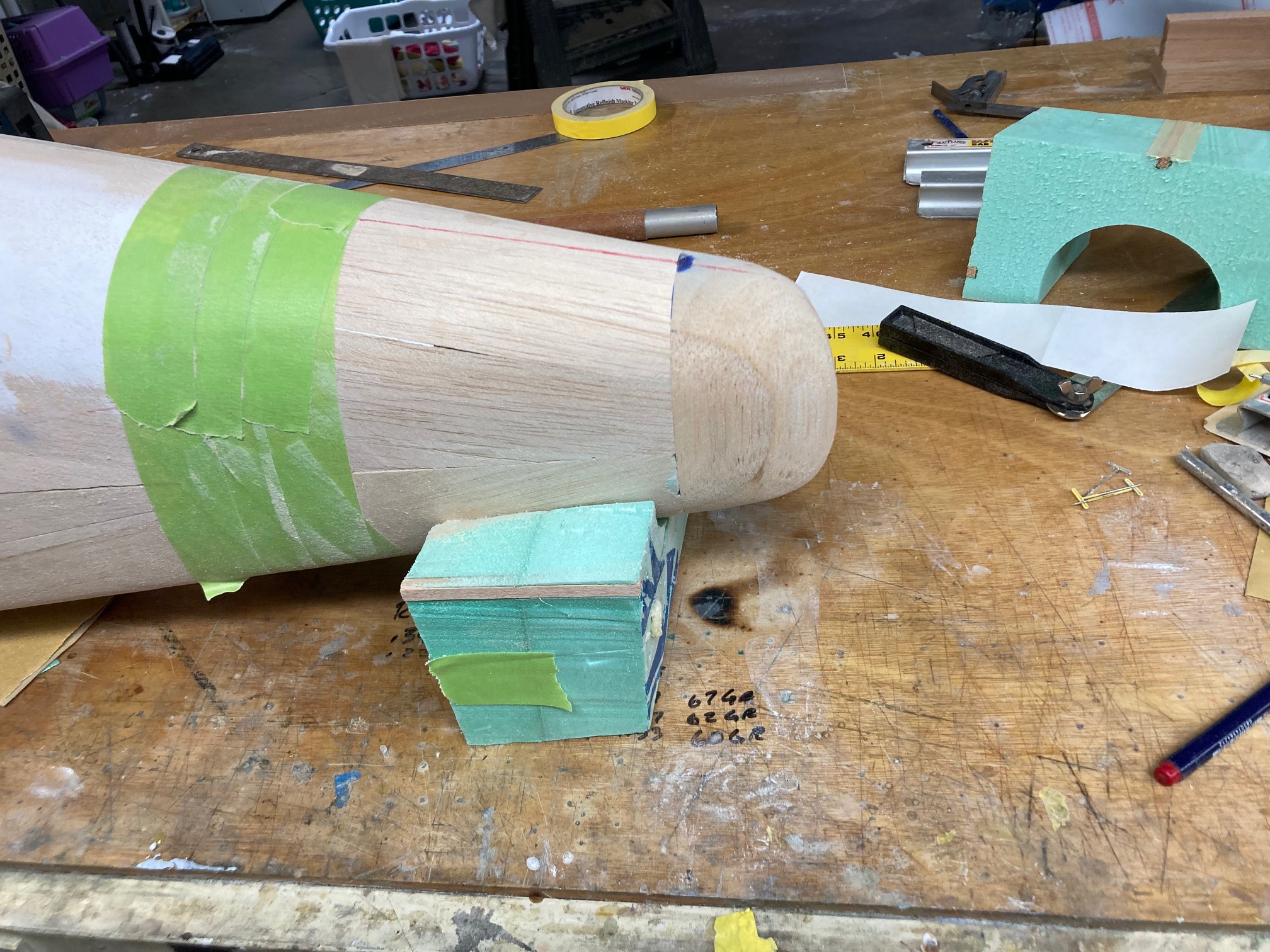

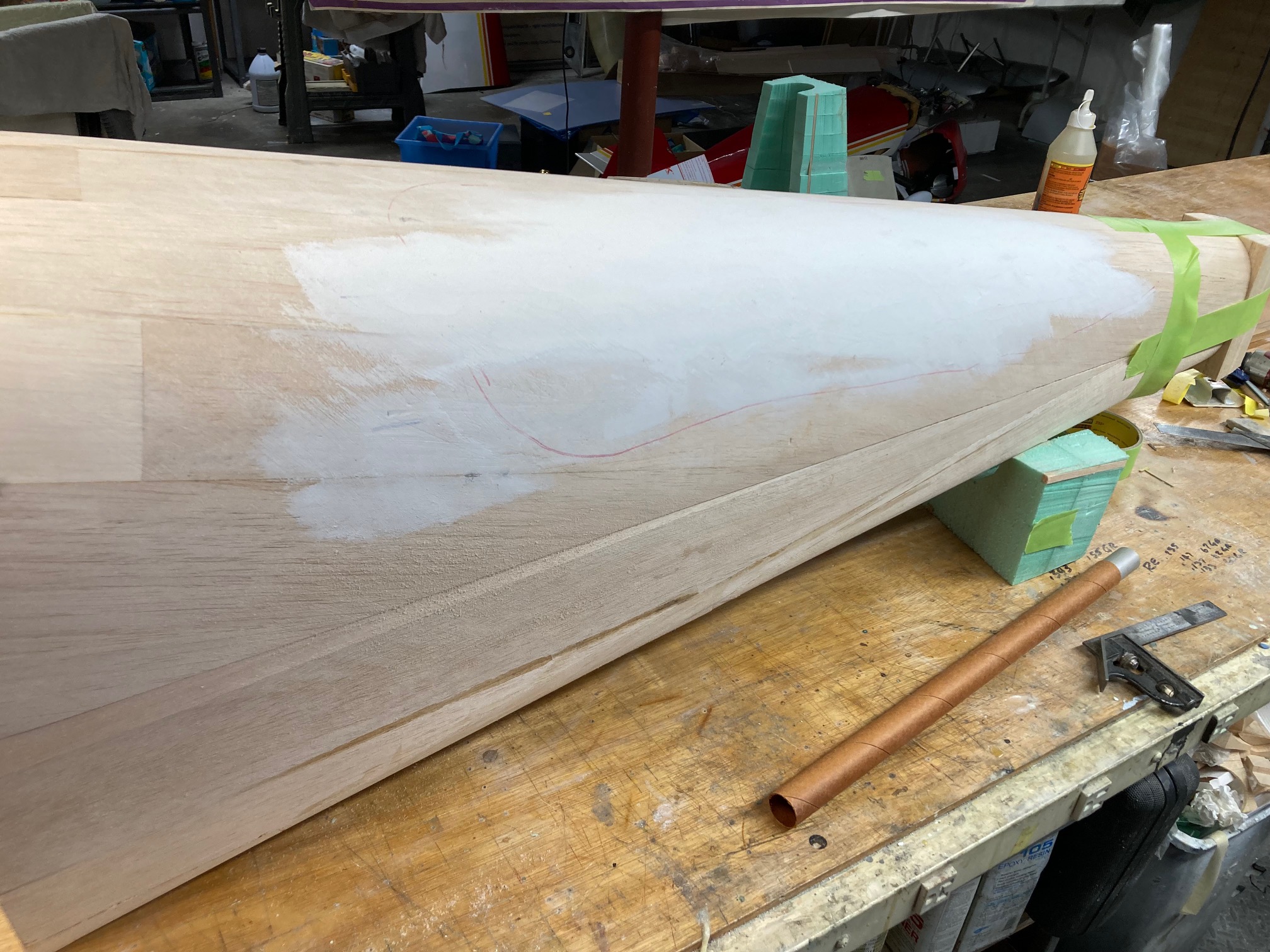

Glued up a balsa block and rough sawed to shape, it is tack glued into position. Noticed a wallowed area on the top of the fuselage while sitting down the shape. This was caused by the wire bowing while coming over the top of the templates and turning down. Next time I cut a turtle deck, I will cut vertically down at the centerline and cut each side separately. Took a couple of coats of filler to get it filled in. No big deal because it is getting covered with epoxy and glass.

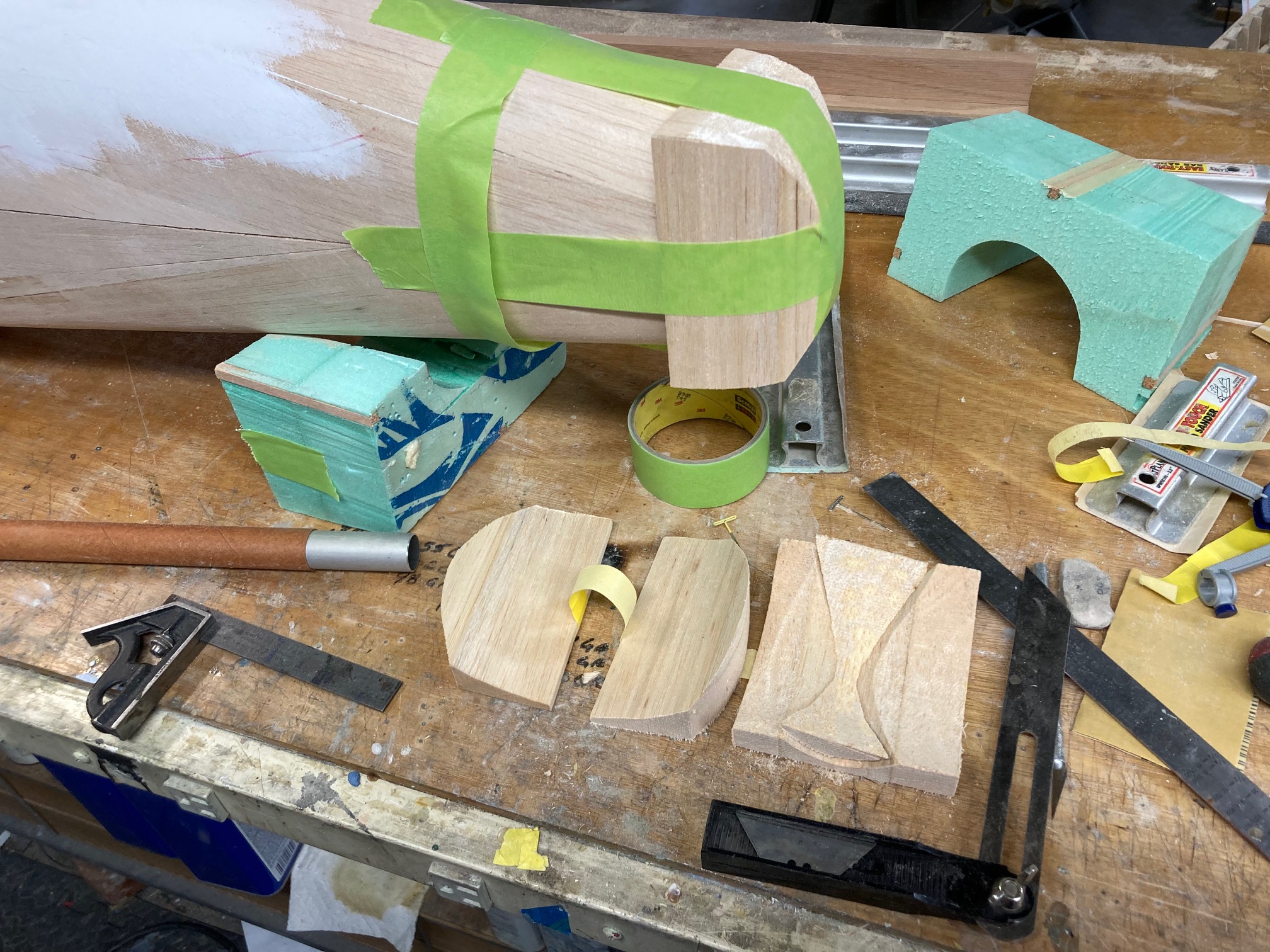

The tail cone tack glue has cured so the block got roughed in with 80 grit. The tail cone is a little shorter than the actual full scale to accommodate the stabalator wing tube hinge system. Can't go any further until the rudder is cut and installed so that will be the next move. I'm planning to have the vertical fin as part of the layup. Thinking about adding the corrugations to vertical fin well.

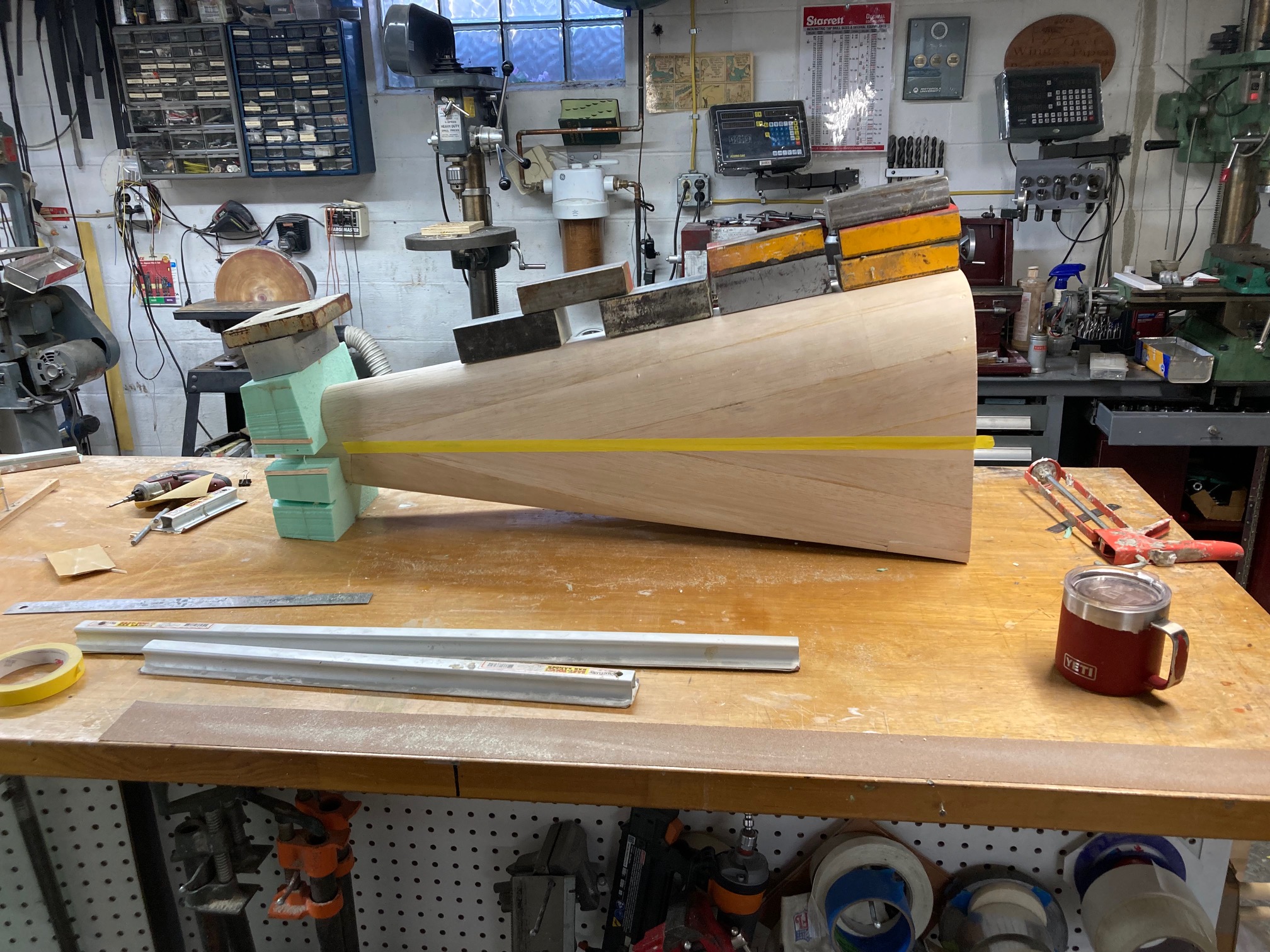

Married the front and back this morning. Since there's not a flat and level spot in my house had to make a jacking plate to get the bottom level and plumb. Have a like filling and sanding to do to blend the joint. Glued up the foam for the rudder and make templates in Compufoil. Will print these today.

Nice work on the leveling plate. Must be an uneven floor as you almost ran out of threads on the front right corner.
