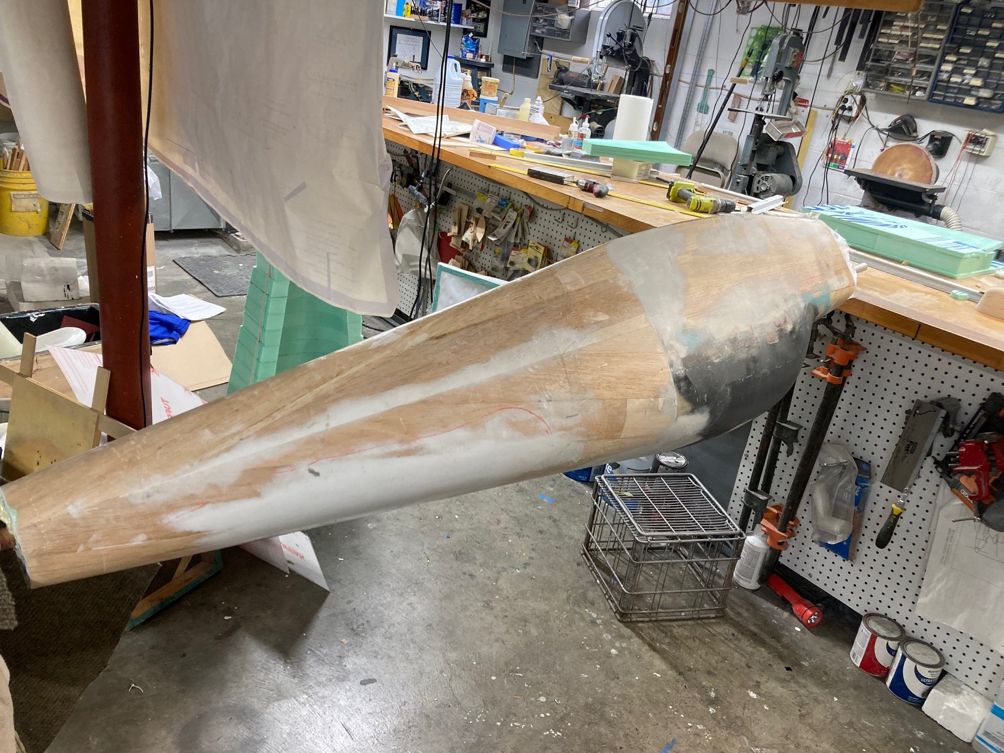

Put the first wrap of 2 ounce glass cloth on the fuselage, after a day or two this will get sanded and second layer installed. Working with 24 hour cure hardener so it takes a while to fully harden to where the sandpaper will not clog. Started working on the rudder. Once the rudder is installed I may be at the point where I'm waiting for warmer weather to prime and paint

Ok just asking and not questioning, 2oz cloth it surprised me when I read a second layer of 2 oz cloth. I have covered a few planes 3/4 oz but never believed it was enough just good for painting. But have glassed a plane will 1 1/2 oz cloth and believed it to be sufficient. Just trying to understand the reasoning for 2 layers.

This is a plug so weight is of no concern. Looking for enough glass so there's no worry of sanding through and provide a little strength while block sanding. At least that's what's my thought process is.

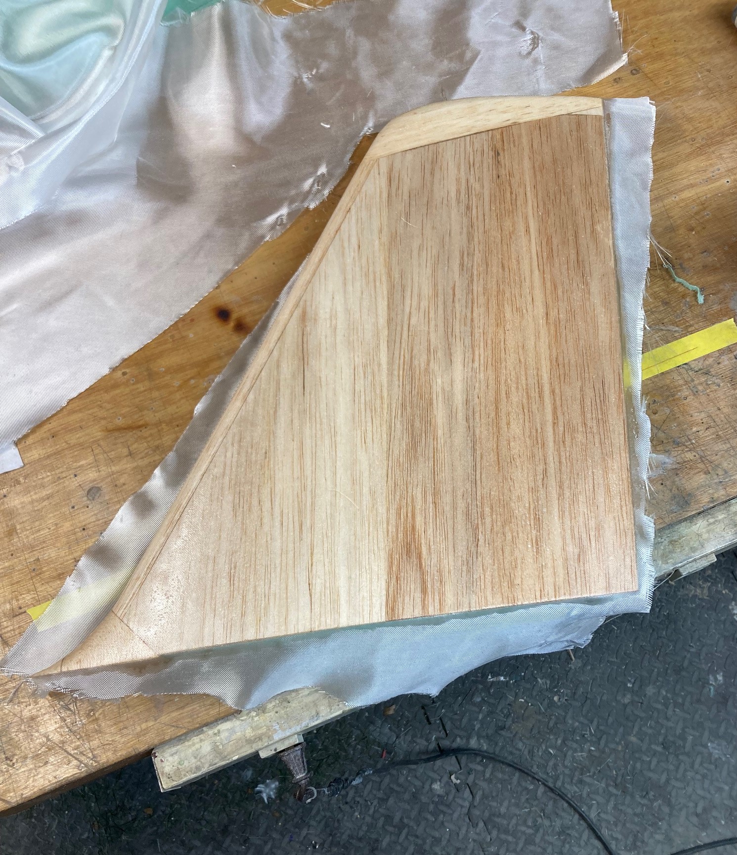

Added the leading edge, tip and the curved section at the bottom of the fin, one side is glassed. Used excess resin and allowed it to soak it to harden the balsa for cutting in the corrugations. Hopefully that works.

This was the first time I did the dorsal off the fuselage, it was much easier to sand to shape rather than on the fuselage. You may want to try it on your future builds. Sanding the dorsal area and hinging are two of my least favorite tasks.
