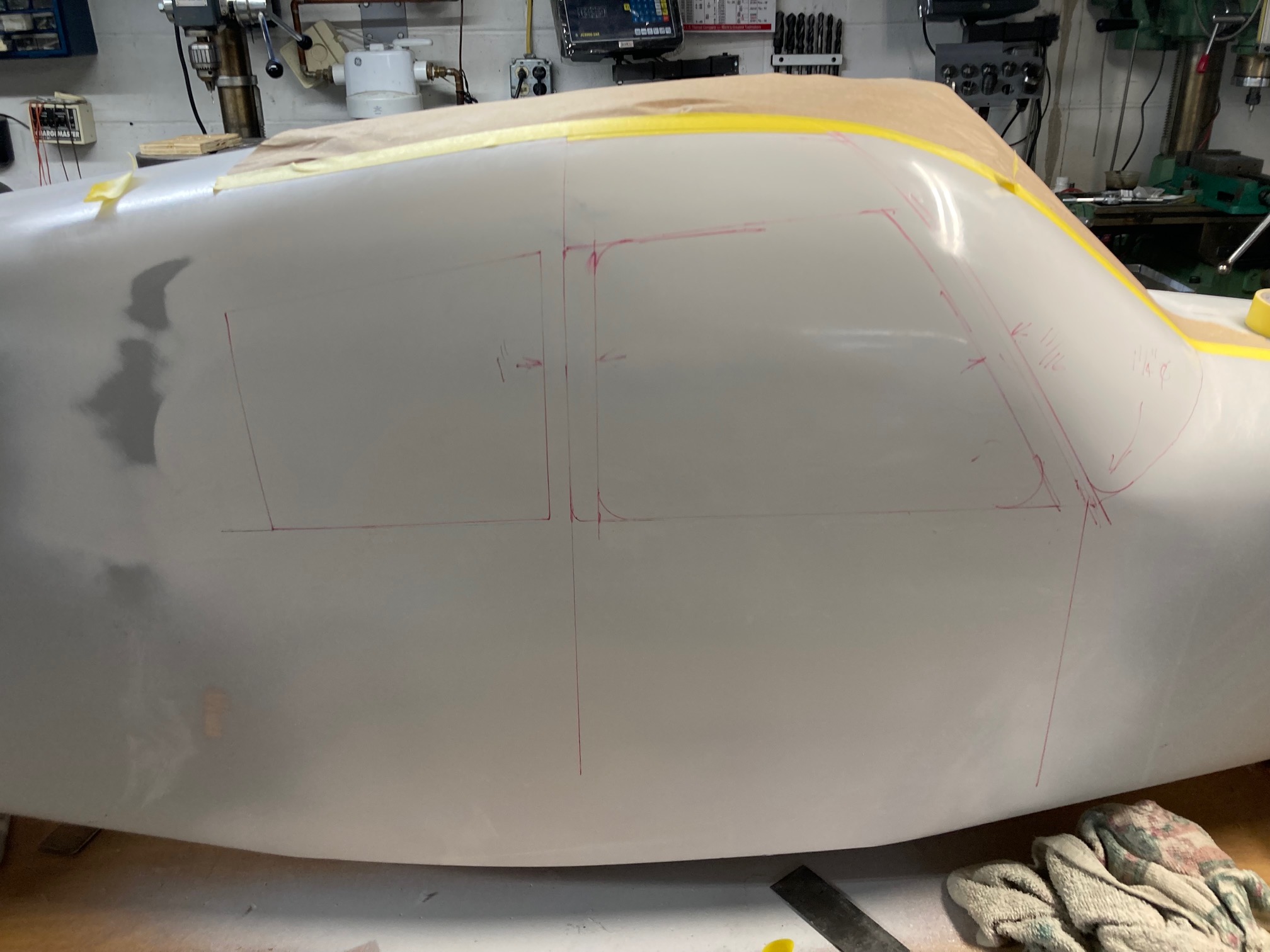

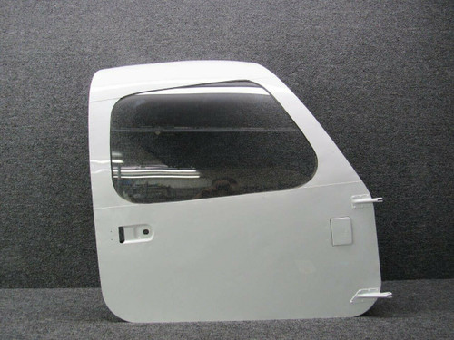

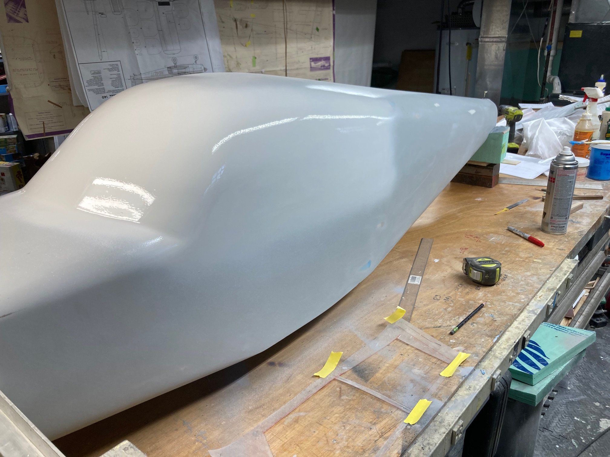

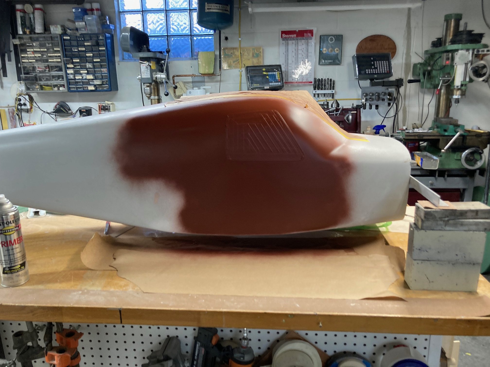

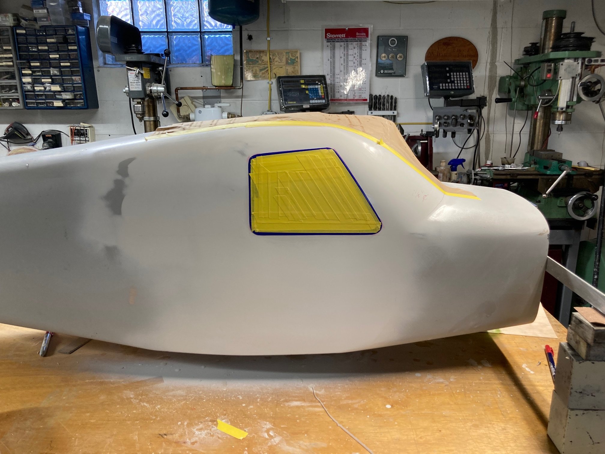

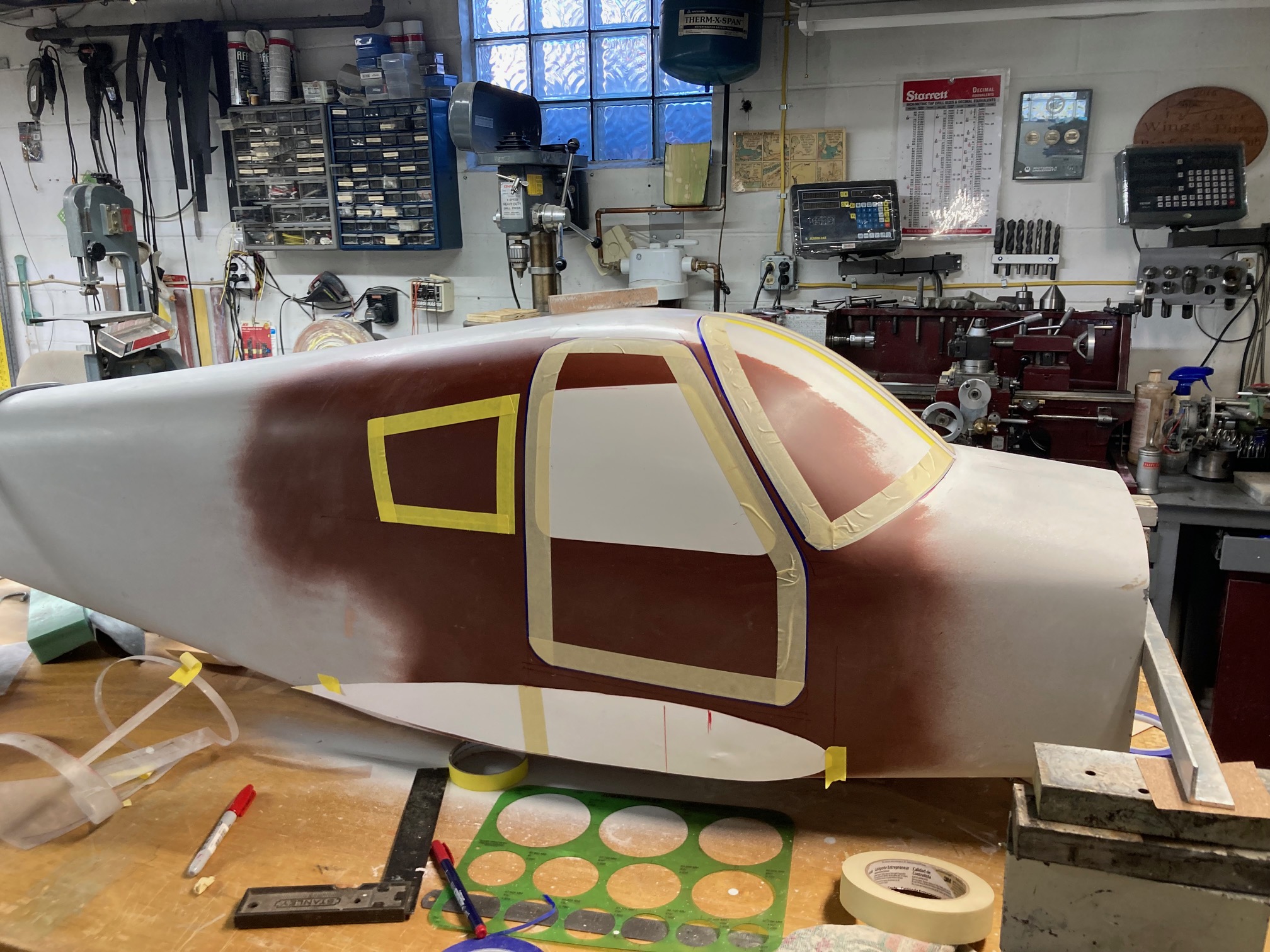

Completed wet sanding with 220, just a few spots need filler, the final primer coats will take care of the other low spots. Laying out for the windows and vertical fin. The windows will be cast into the plug along with the right side door. With this in mind, these areas will be masked off before the final primer coat. The bottom of the windows are parallel to the line of thrust so that will help setting up the fuselage after it comes out of the mold. Been studying photos of the doors.

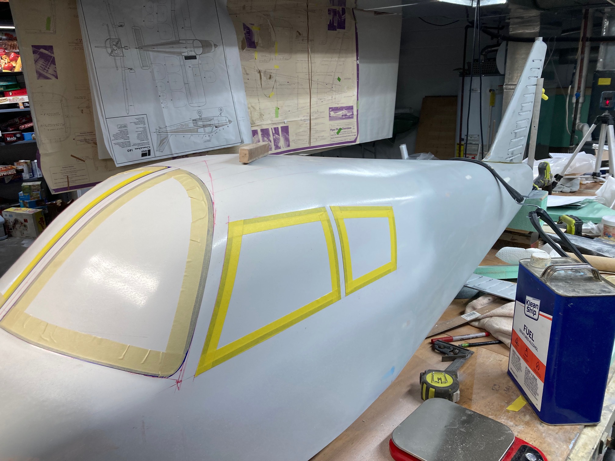

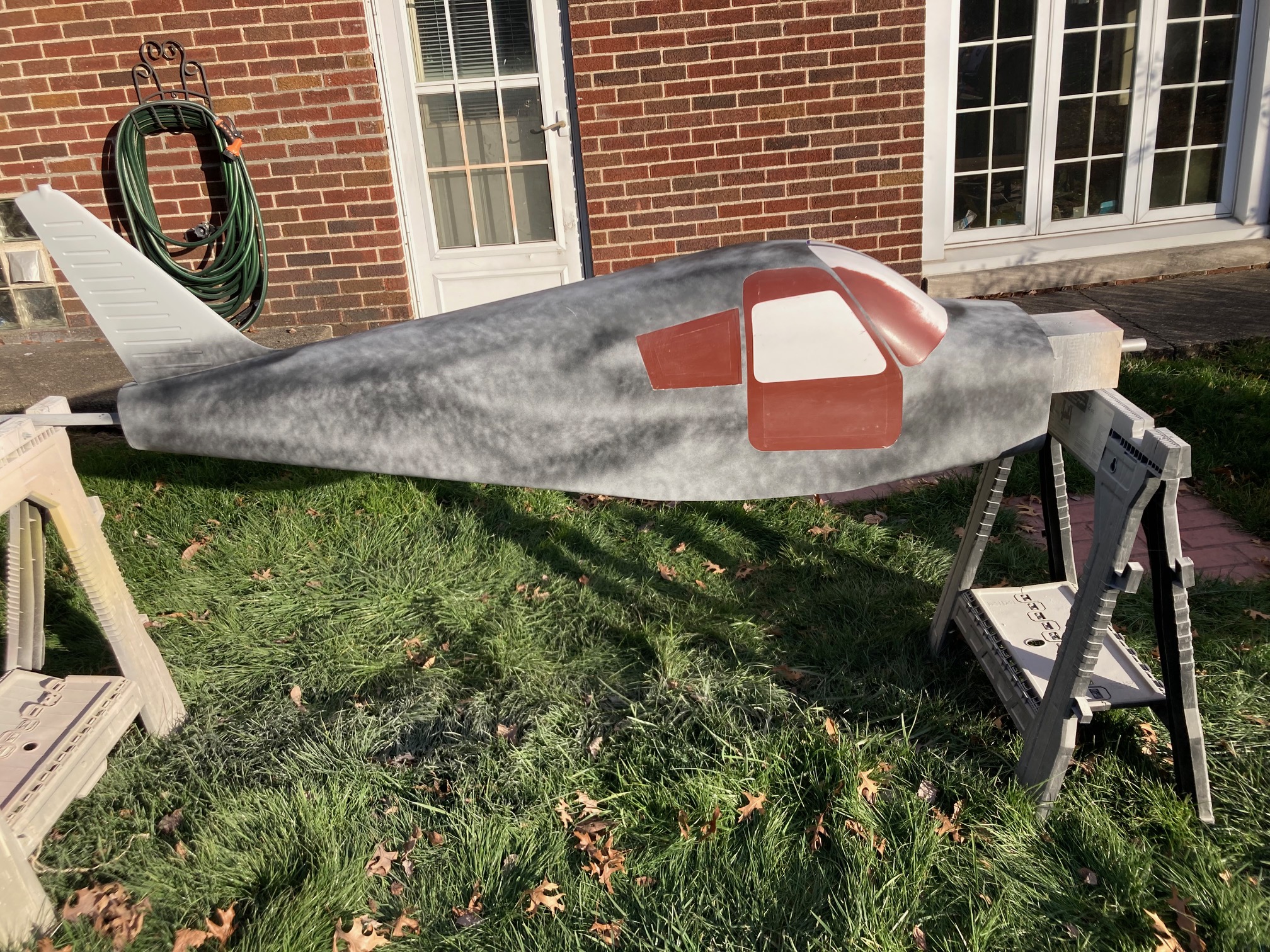

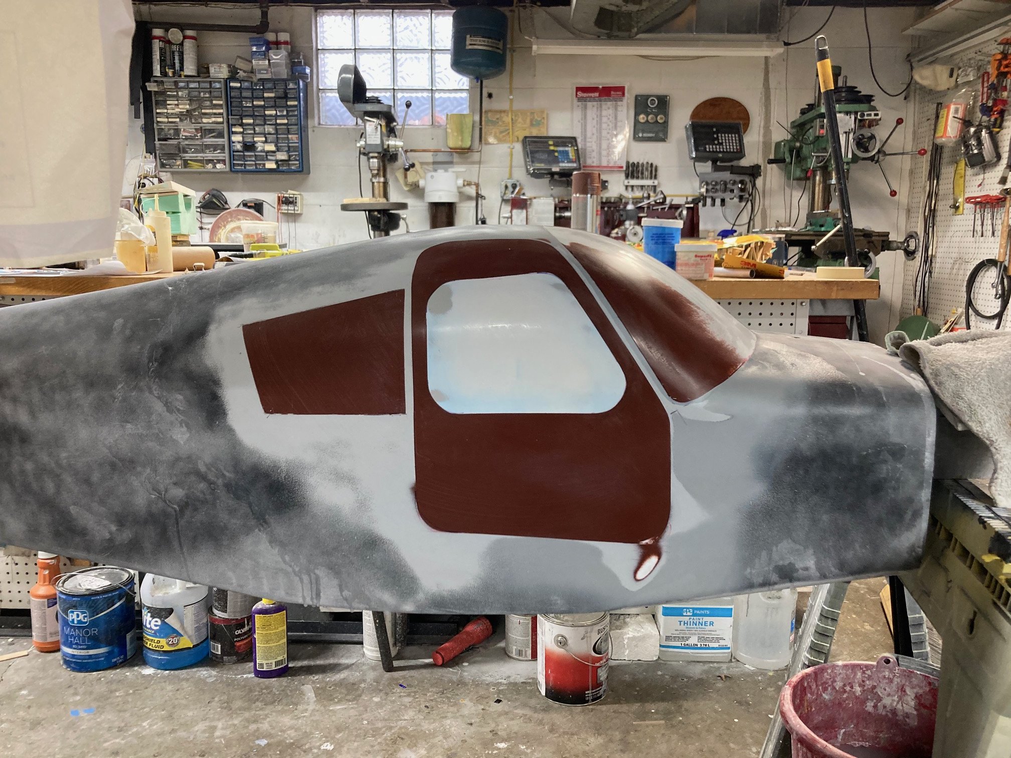

Used a template made from the plans and several photos to lay out the windows and doorway. Then the window for the door was masked off and the adjacent area was primed. Weather forecast for Saturday is 55 f, hope to get the final coats of primer on.

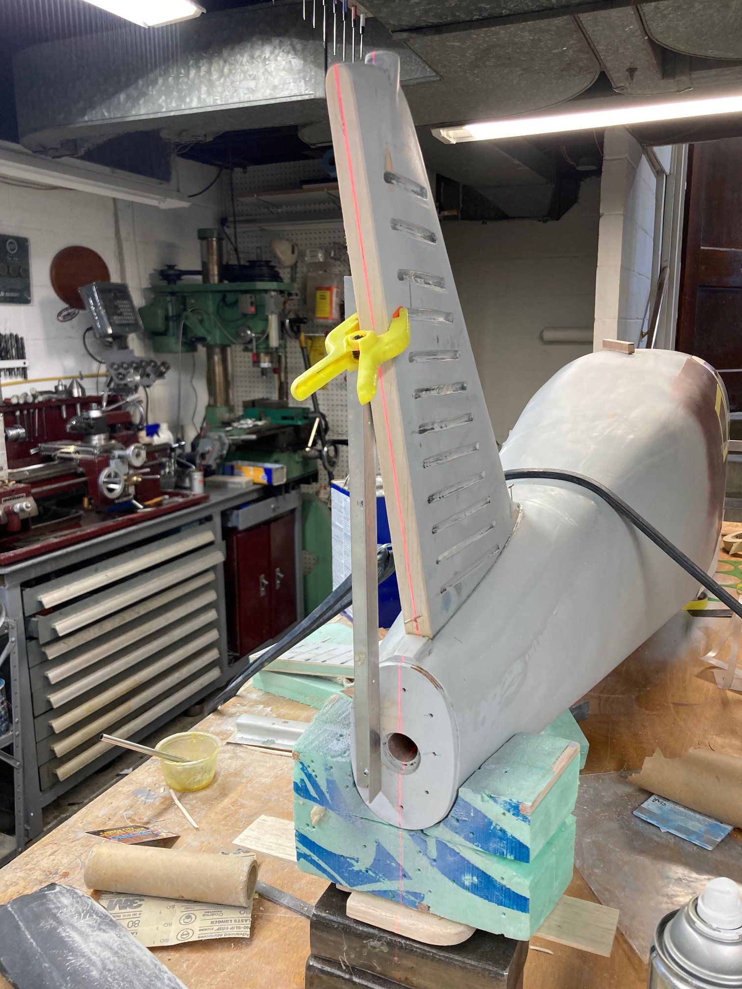

Got the vertical fin on and the remaining windows and door laid out. Used fast cure West Systems epoxy so hopefully later to day I can fill the joint around the fin with SuperFil. The door is an odd shape for sure and I spent a lot of time studying photos and the small three view that I have.
Prime tomorrow.

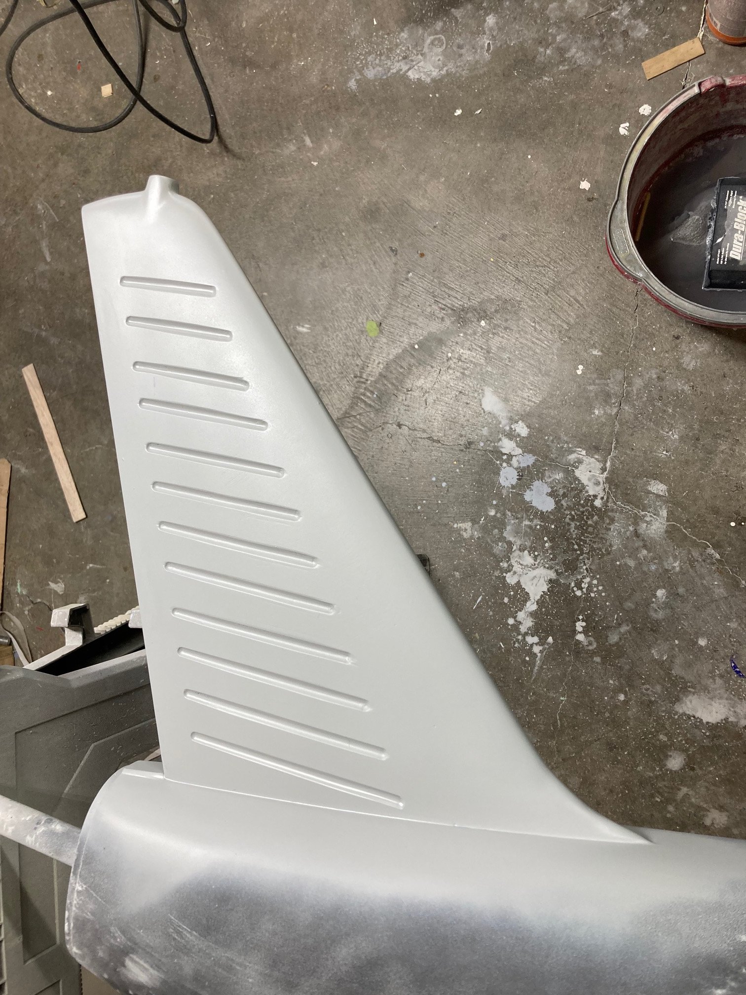

Didn't care for the door so made a few changes to the radius on the window and bottom of door. Working on the corrugations on the vertical fin. On several of the ends the router bit must have whipped a bit making an odd shaped end point. Now that several coats of primer are on the fin, the grooves are smaller than the 5/16" router bit groove so I'm using a 1/4" dowel as a sanding buck. To repair the ends, a radius was put and the end of a short piece of 1/4" aluminum round bar, this was coated with Vasoline, a dollop on SuperFil placed in the groove and the aluminum rod was pushed against end of the groove until it stopped, this was left in place until the SuperFil cured, this was sanded flush after cured. I tried several methods but works the best. The corrugations are far from perfect but good enough. Have a few layers of glass on the tail cone mold. Working is several areas along with stripping the fabric off the Champ wings, what a pain that is removing all the screws.
