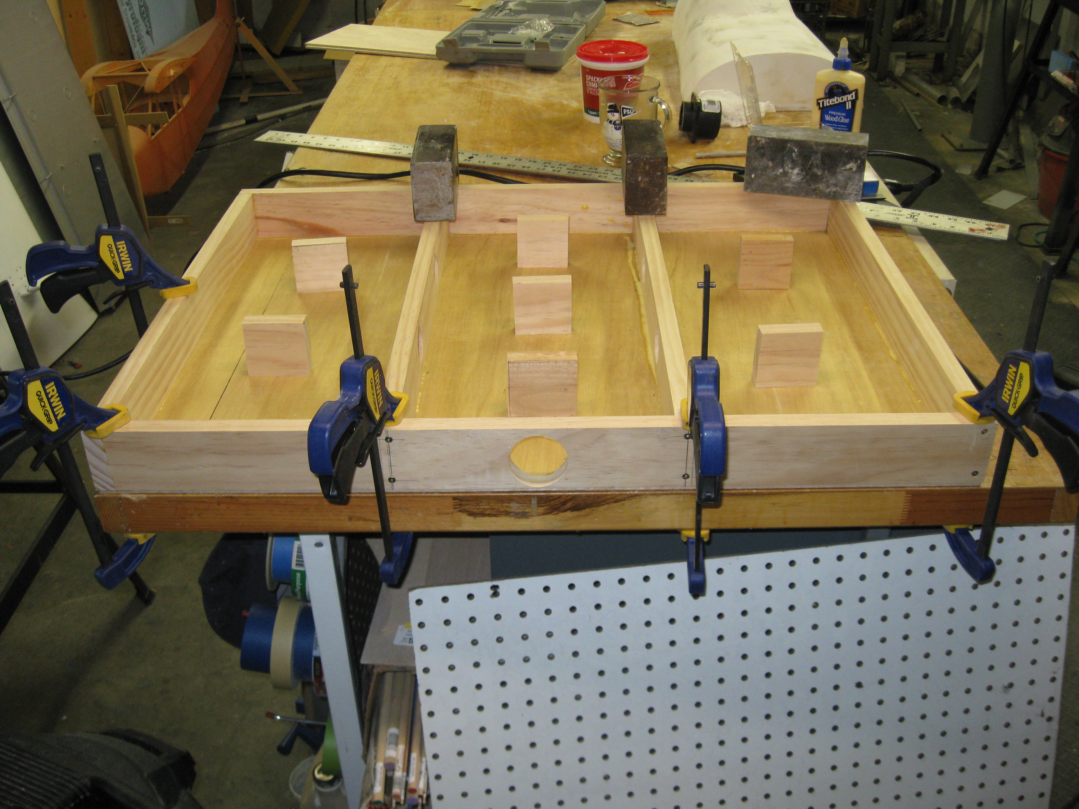

All the equipment is home made. Here is the vacuum table, 1/4" plywood bottom, 1 x 3 sides and the peg board top, two shop vac's are connected in series to the table.

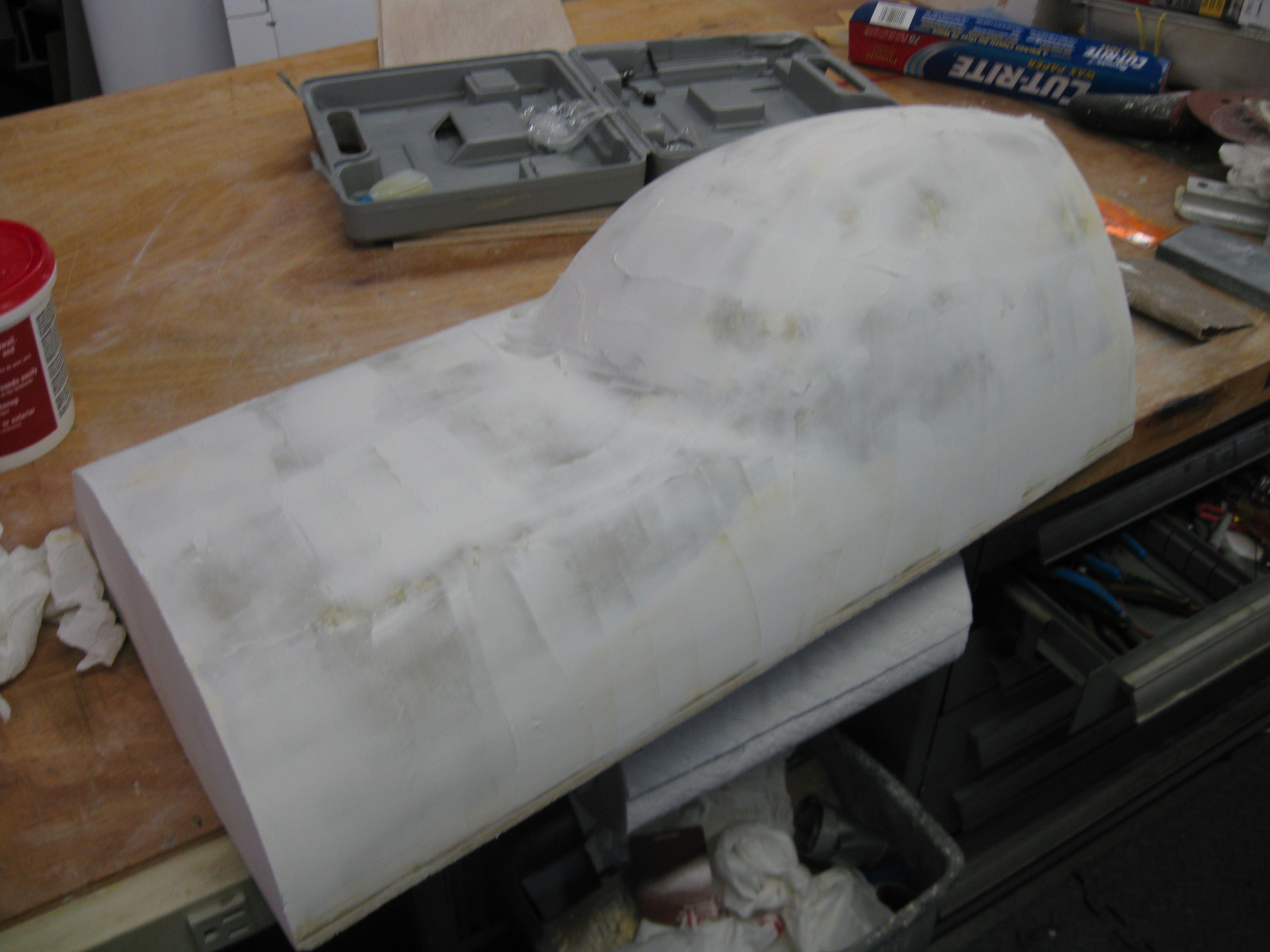

You need a buck to form the sheet over, this need to substantial, in my case I made the buck from a less than perfect canopy, this is going on a Bob Godfrey One Design that you may have seen in the back round of the Champ photos. The canopy was fitted in a wood support and filled with Ultracal 30 plaster, then glassed and sanded. The plastic blanks are 24" x 32", get six from a 4 x 8 sheet to give you an idea of the size.

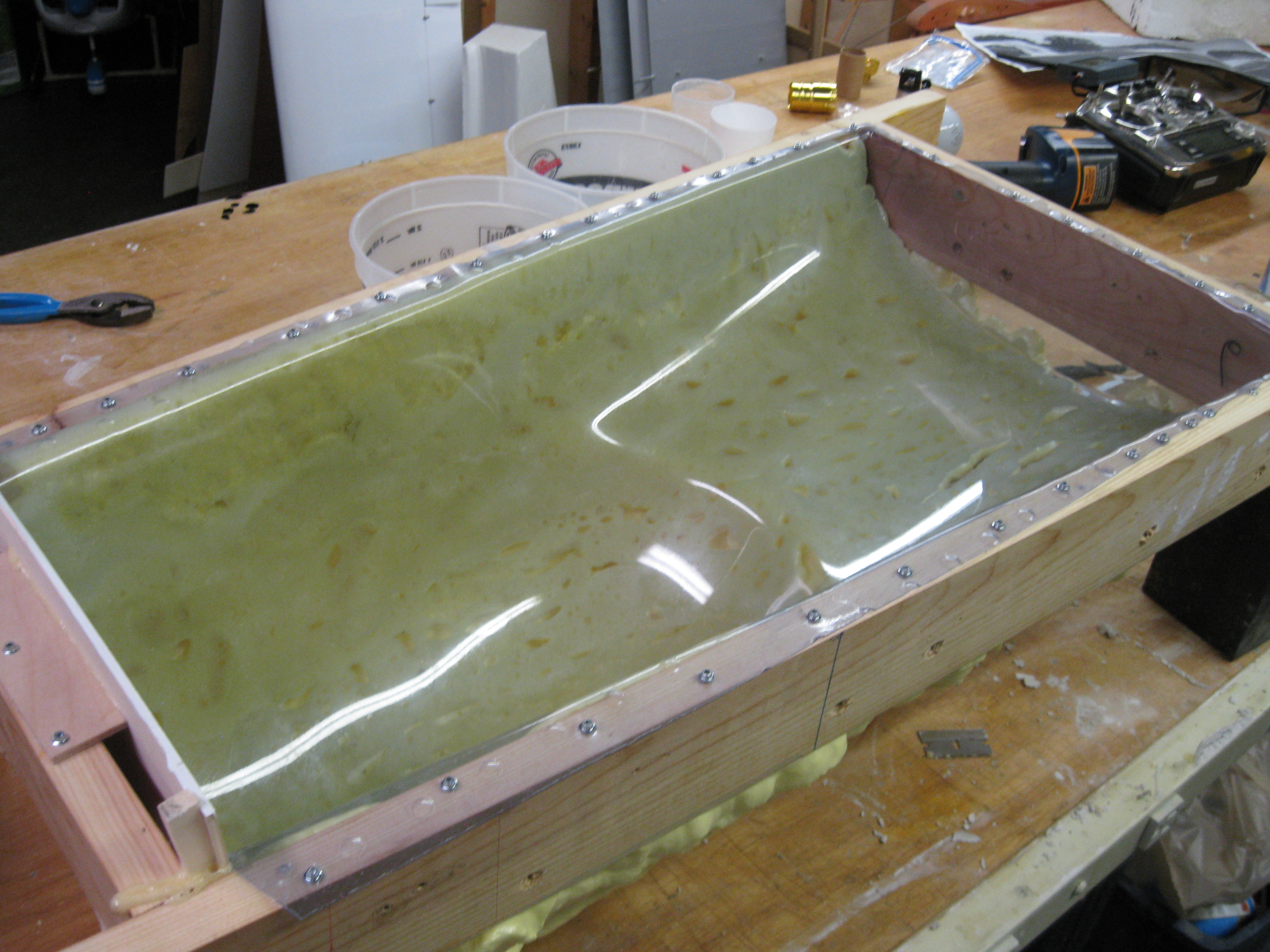

Keep looking at the second picture not sure I am getting it. Is that a failed attempt and the material split off the end.

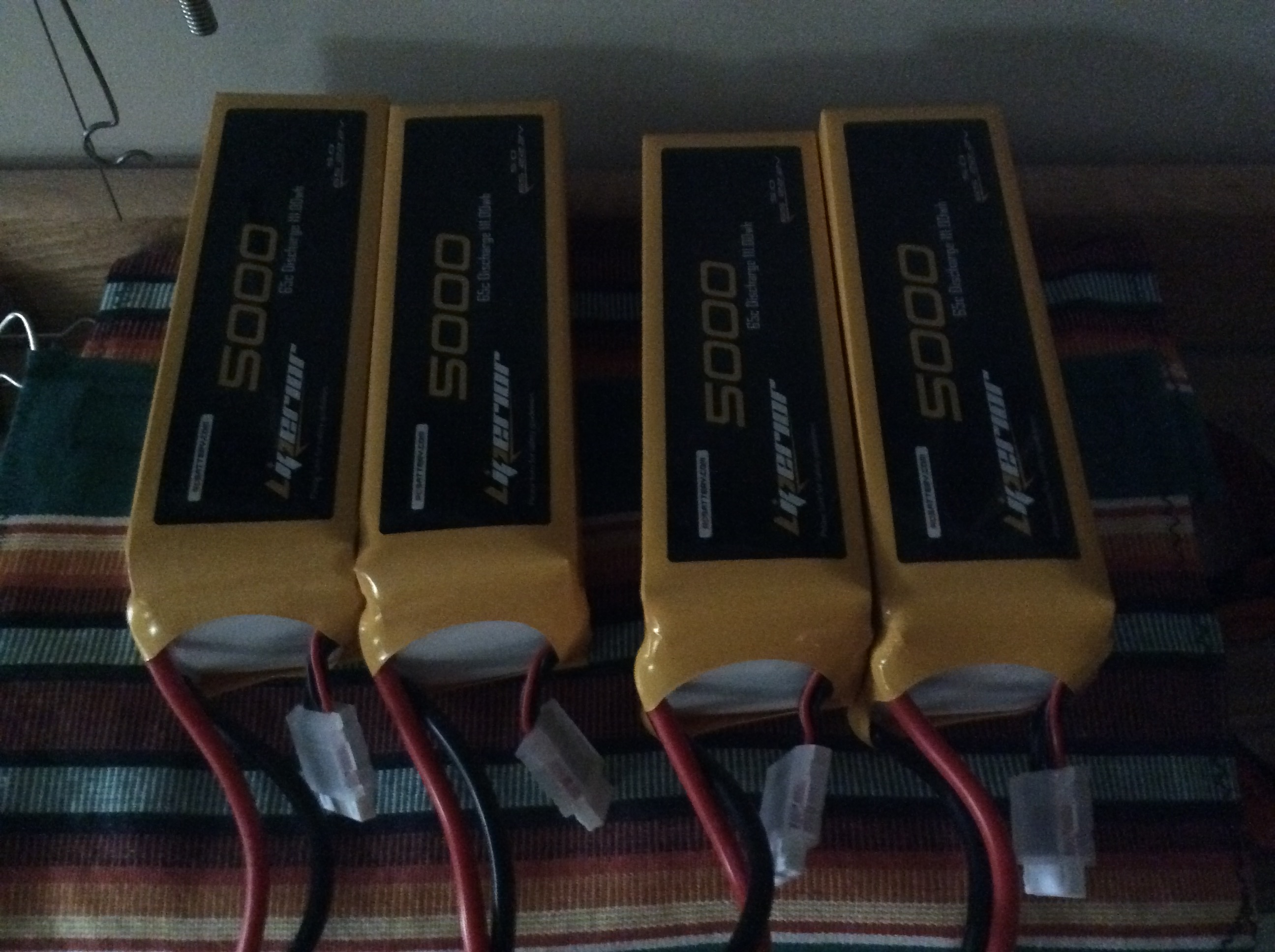

Really doing well with the postman the batteries showed up now that was quick. They look good but the balance leads are way to short really doe not like the length. Will be doing some testing on them tomorrow to see how good they really are. Will see how they compare to the 75c graphene batteries. Should prove interesting. Did a lot of research before they were perched so let’s see how good they really are.
