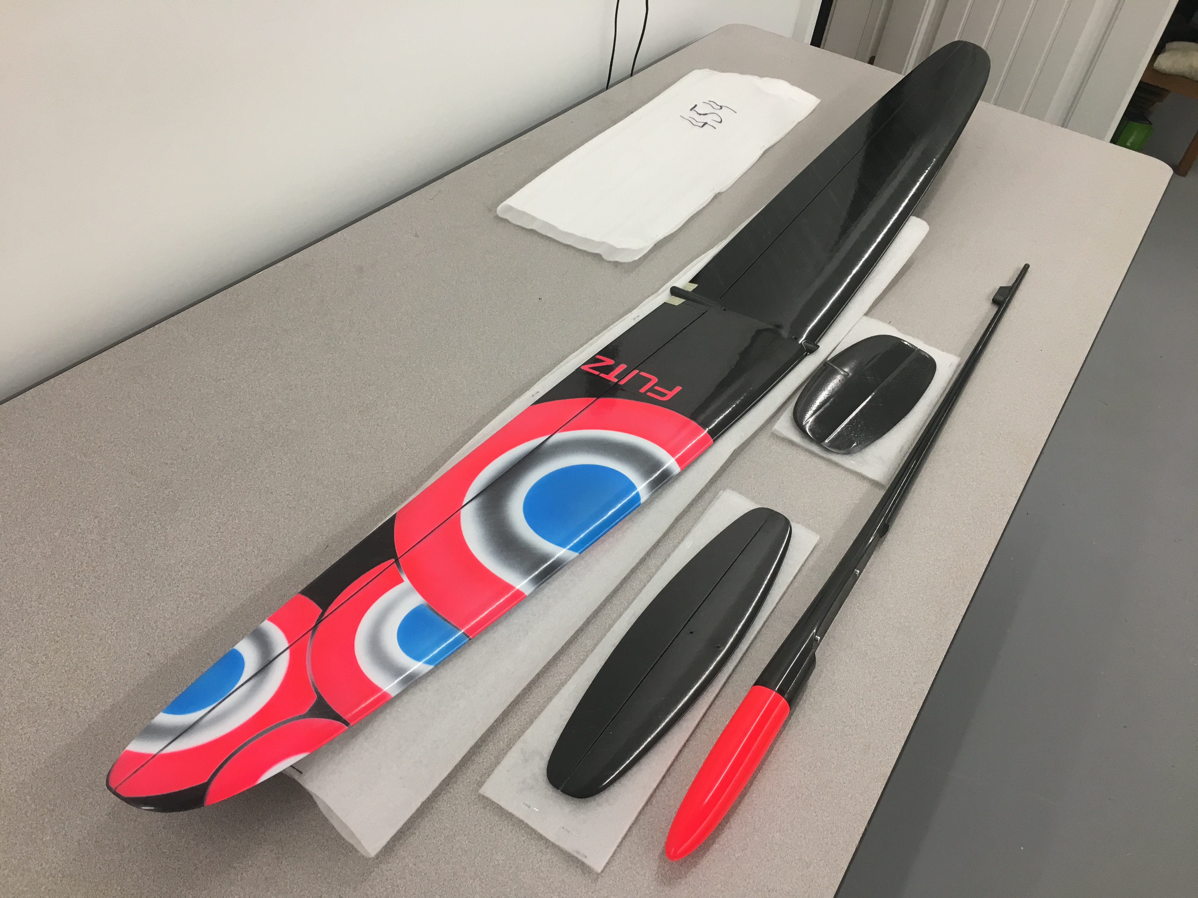

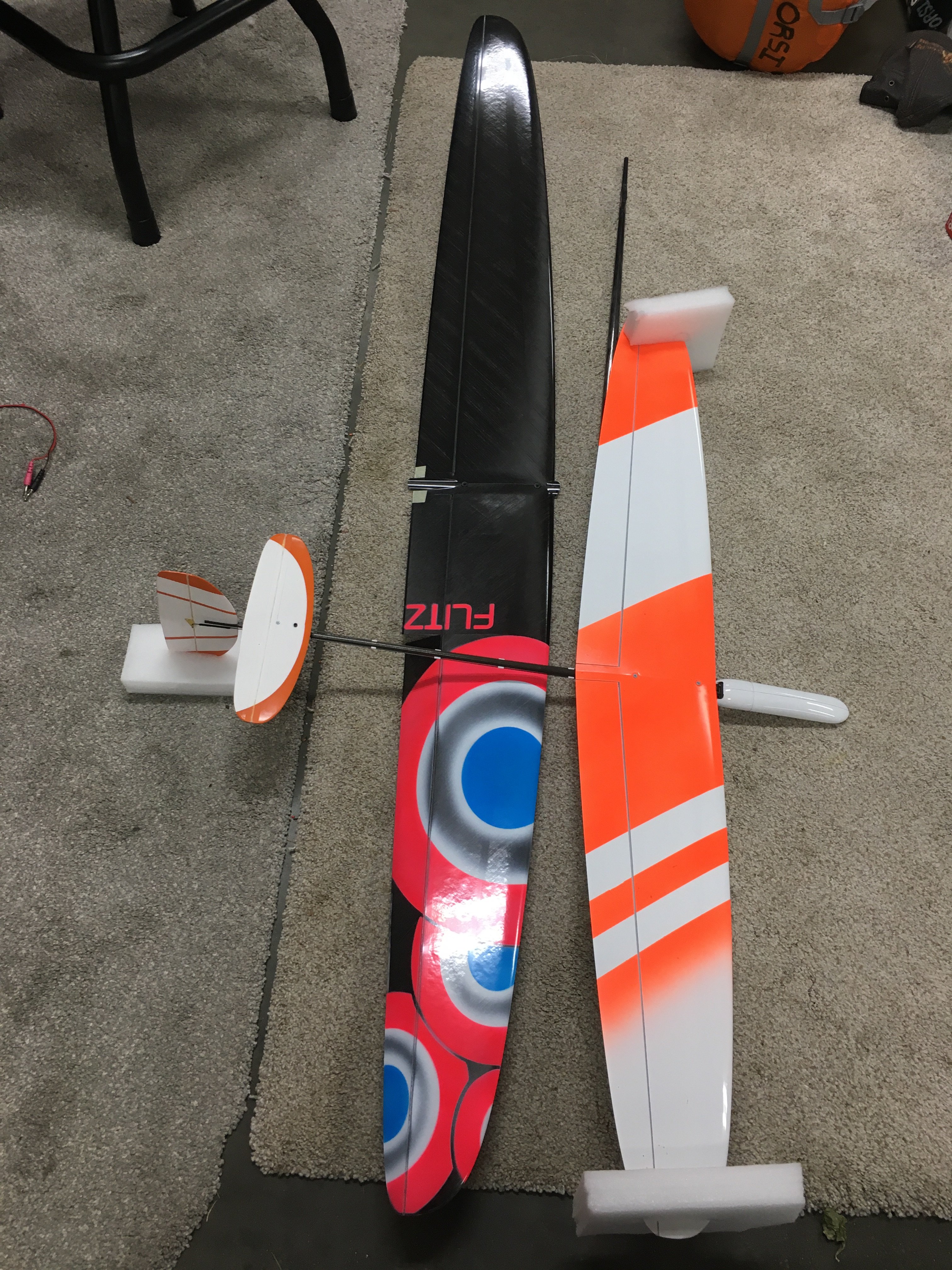

Finally a dream come true. A real 1.5m DLG Flitz2, Oleg on R C Groups gave me a deal on his last one in stock that I couldn’t pass up. Also found put that he designed the Falcon DLG...pretty neat! @BalsaDust I’m joining you in the Flitz club!
I’m going to call this one captain America!
here is the wing next to my mini dart.

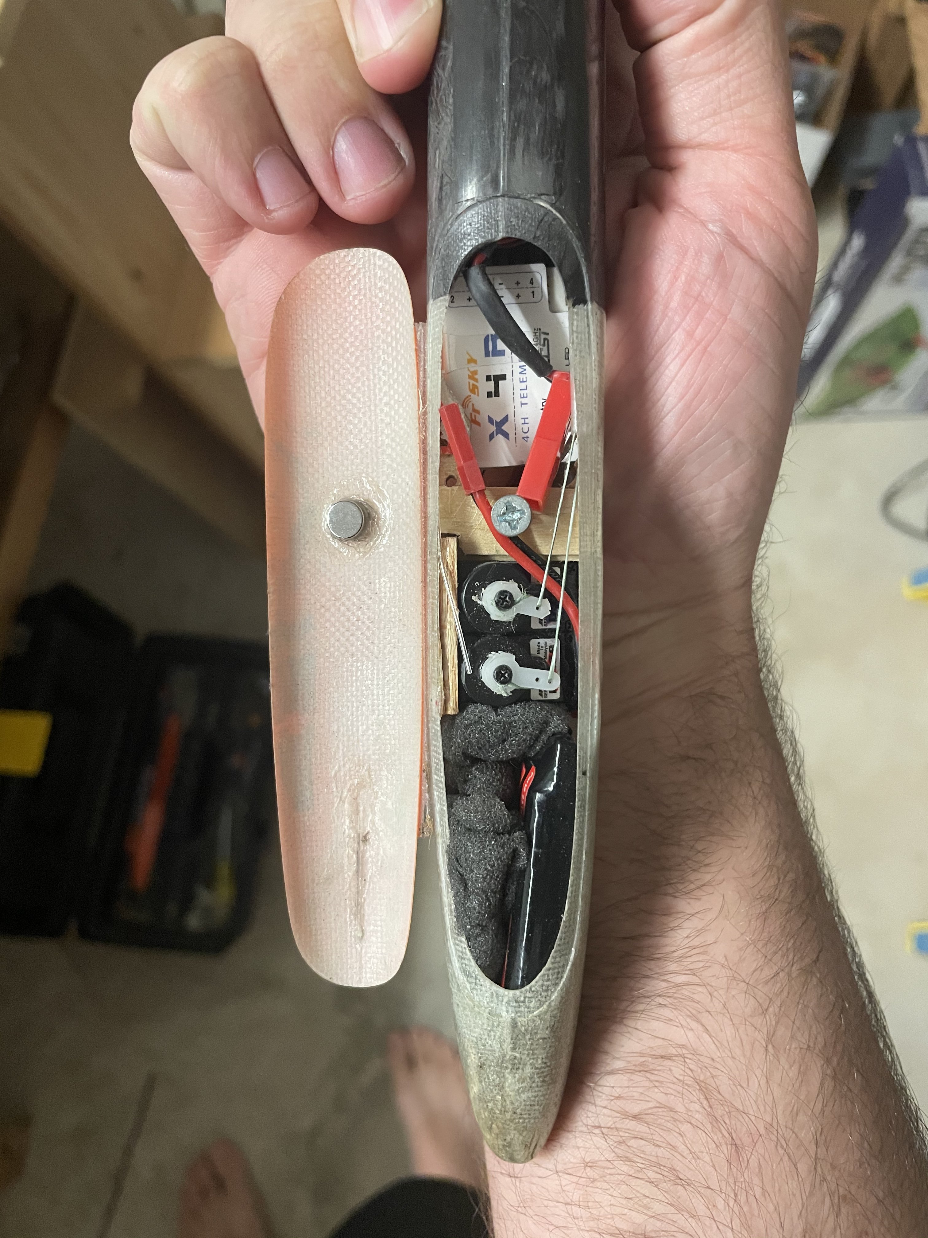

Not sure on power source yet. Got a pic of inside the pod for me? Curious how yours was set up. I’m undecided on the layout.

I will try to get a picture for you when I get home from work this afternoon. I do not care for the way the layout is in mine but I bought it used so I get what I get. mine has older JR servos in it and I have thought about ripping it all out and upgrading to a set of KST X08's I have laying around. I will also try to get my buddy to send me a picture of the pod on his Flitz 2 as his is setup nice and I believe he has MKS servos in one of his two.

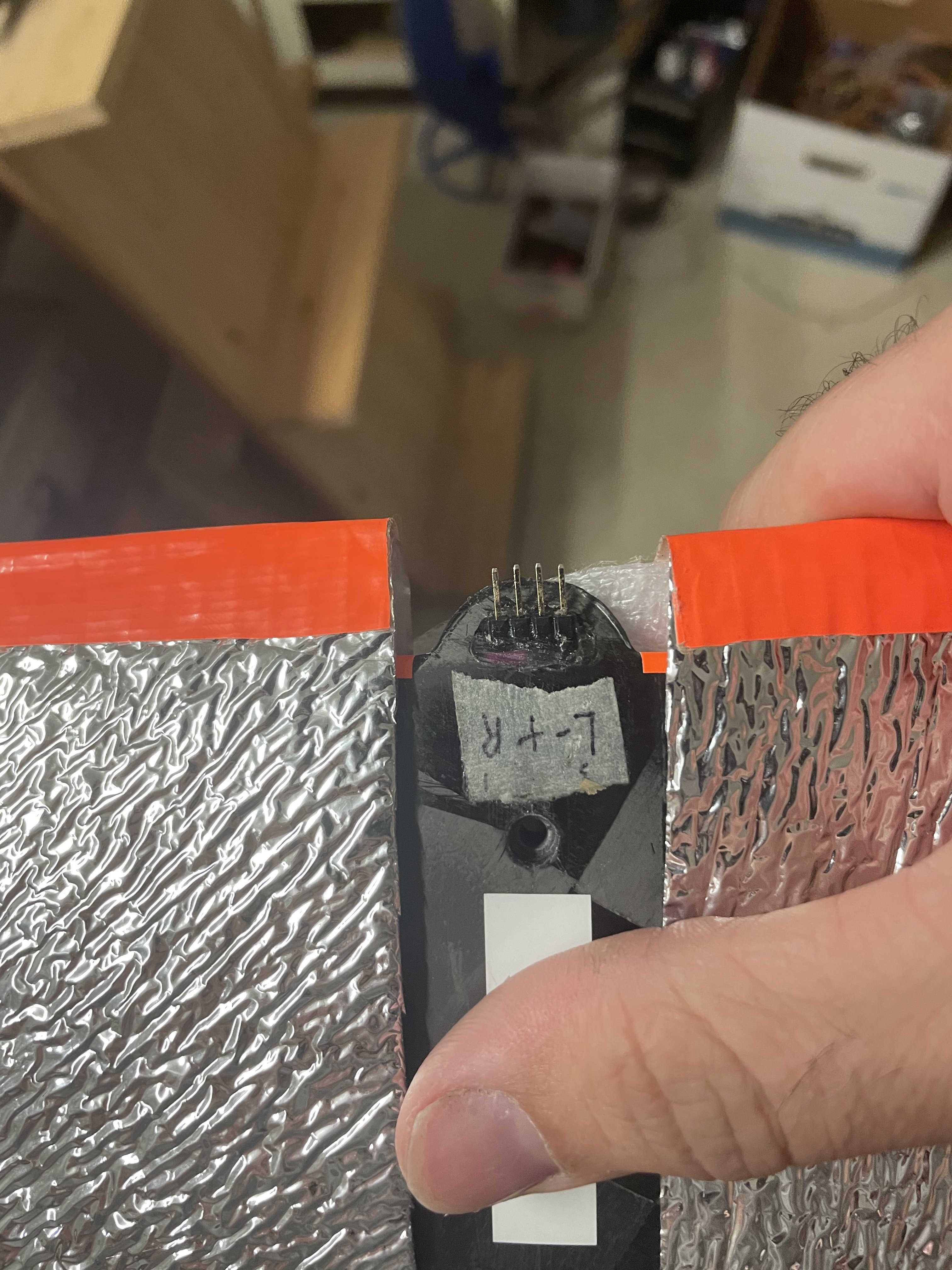

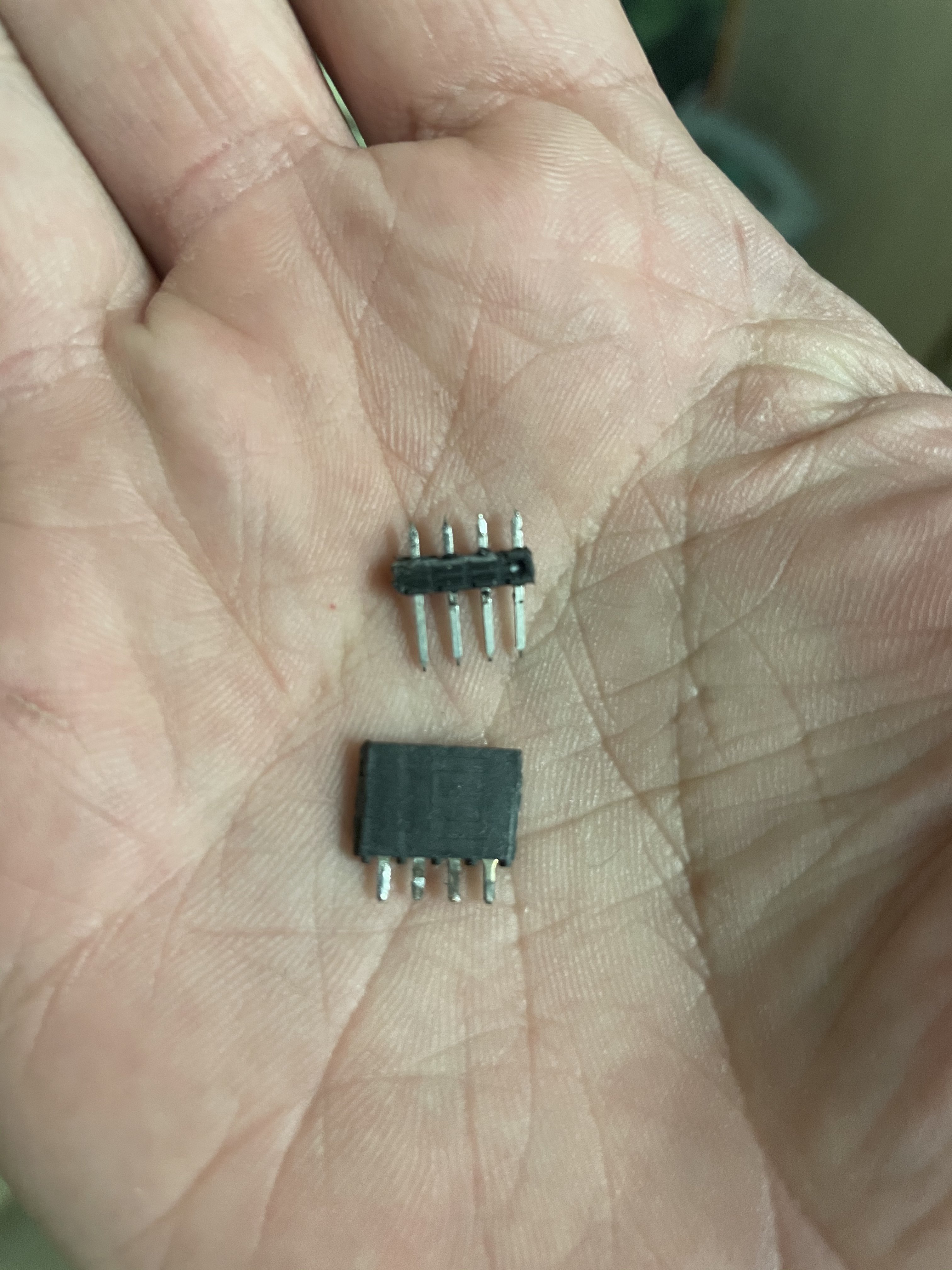

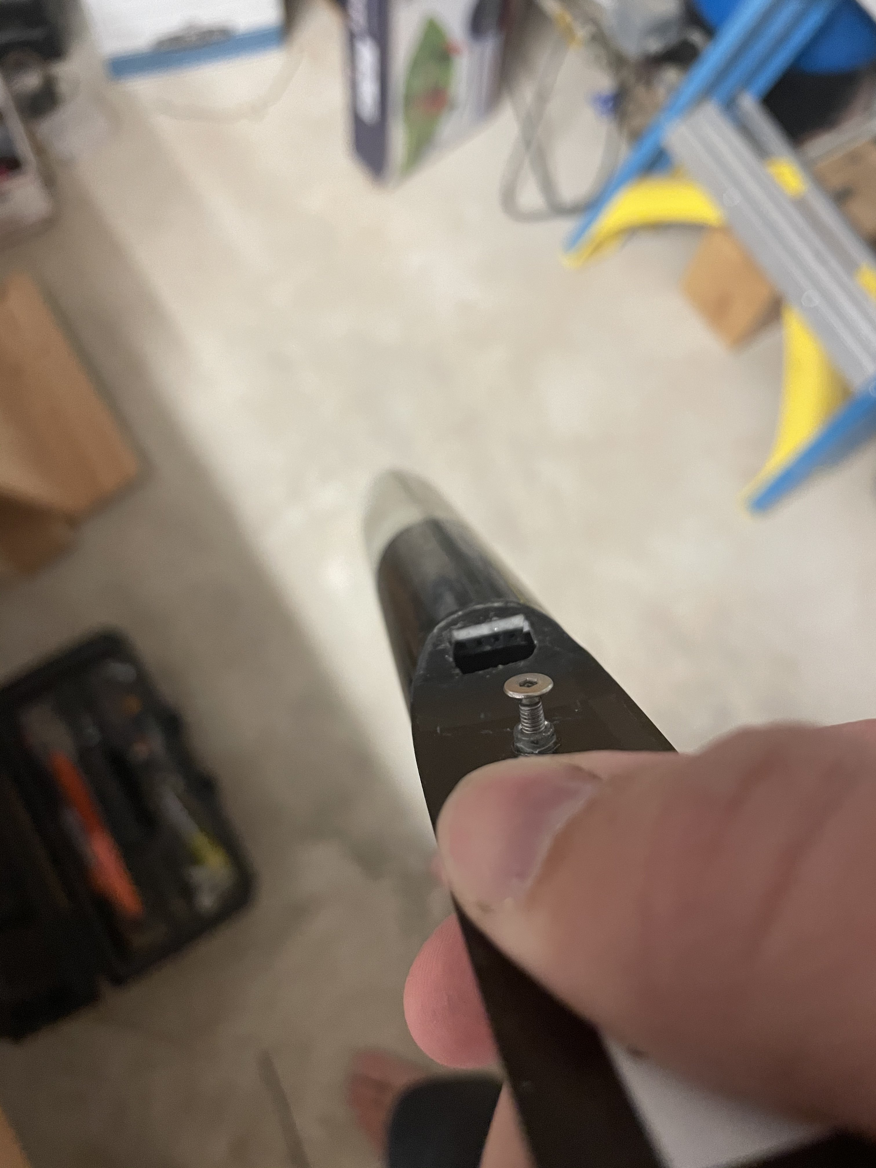

Here is my pod setup. Servos are turned sideways and angled a little bit and personally I hate it. When I redo it I plan to design and print a tray to go in it and mount them side by side with lines going down opposite sides. Also I recommend doing a pinned setup for the wing servos. Makes transport so much easier. If you don’t have any of these plugs I would be happy to send one out to you. I salvaged a bunch off of old components at work so they have some old solder on them but still work. If you need clarification on it I can draw up a diagram of how it’s setup.
AKNick

nice, thanks. There really isn’t a perfect world when it comes to DLG pods. Always crammed. What power source are you using?
I have a 1S gum stick style battery stuffed in the nose. Can't remember the mah rating off hand but it works well. I have seen many using 2S in DLG's now and I dont see the need. the servos are plenty strong and for the tiny movements the surfaces make I dont see the need for the extra speed it gains you.
