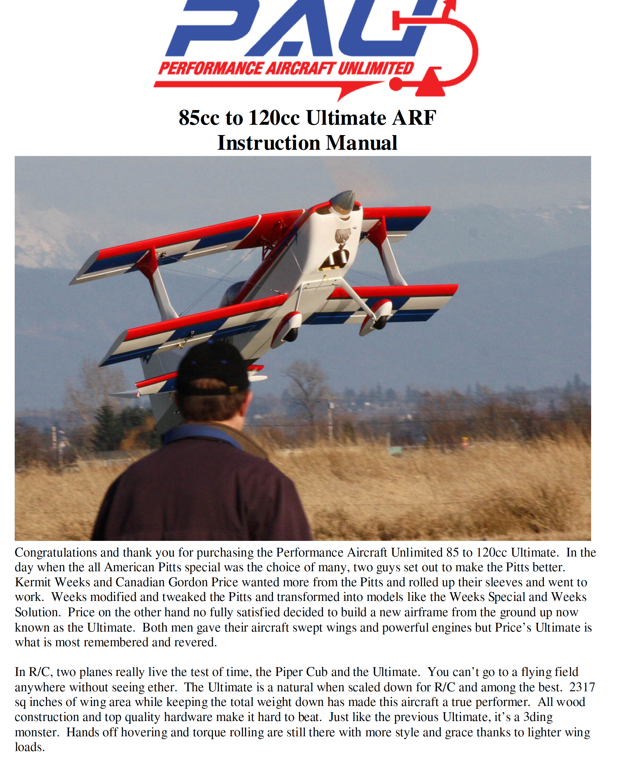

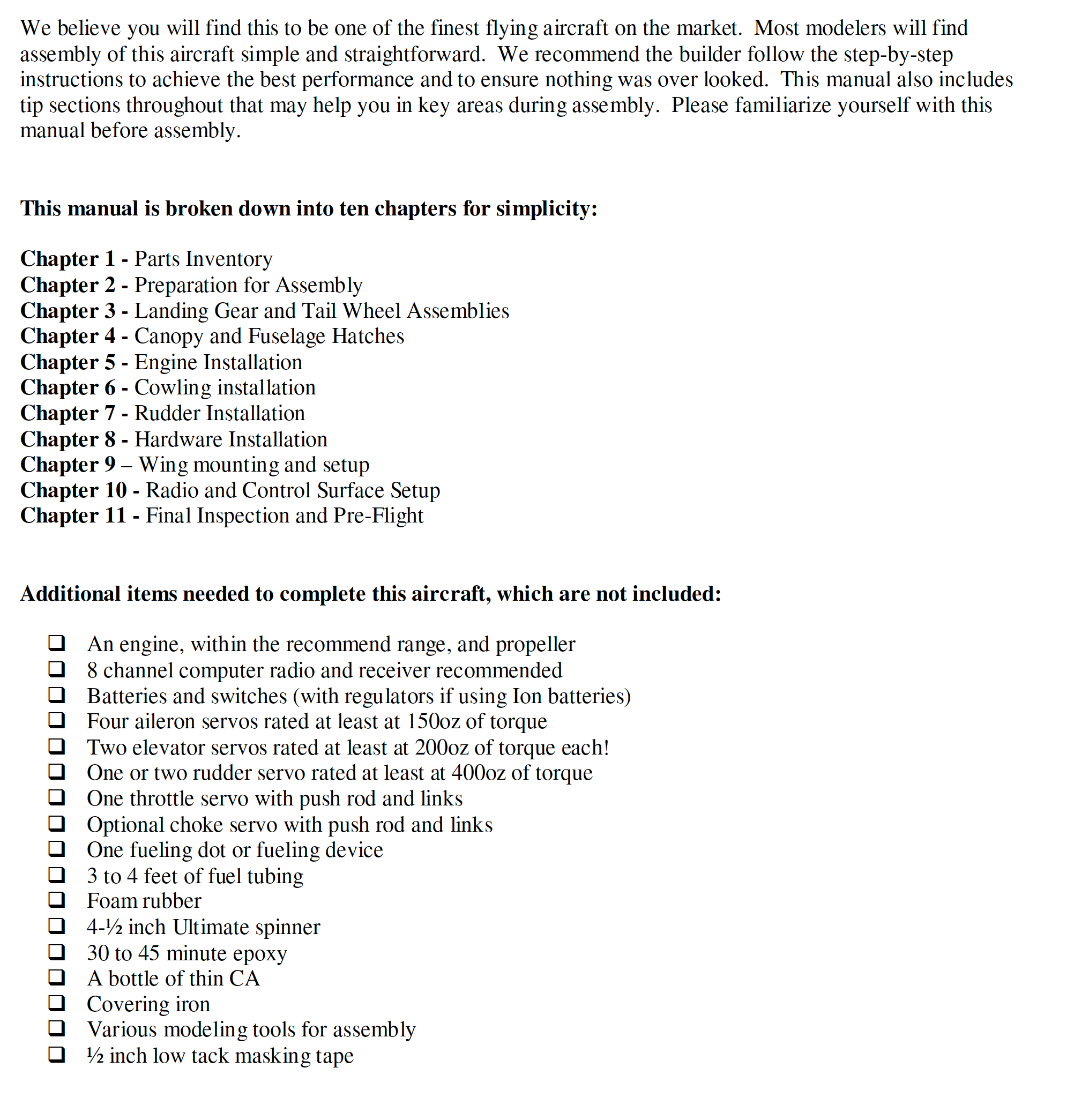

So here the PAU Ulitmate 120 set one servo , suggest minimum 400 oz output
Remember that Areoworks plans were design when high output servo weren't available, food for thought , sometimes you have to think outside the box they have given you.
View attachment 108946 View attachment 108947 View attachment 108947
The PAU 120cc Ultimate manual states 1 or 2 servos rated at least at 400oz of torque.
Look guy's, I get I could probably get away with just two and depending on balance I may pull one back out. But until then I will follow the manufacturer's recommendations.

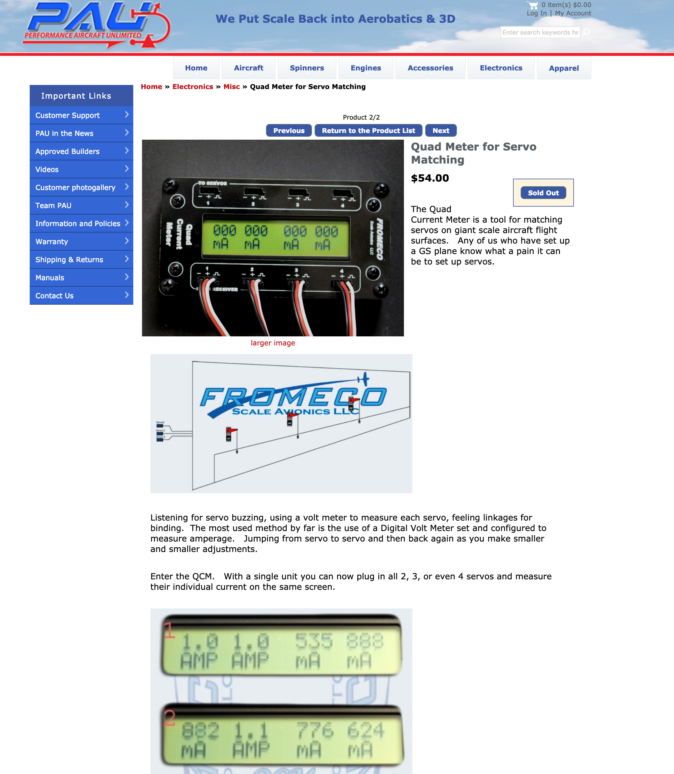

Love this meter. Best and most sure fire way to maximize true servo balancing.
