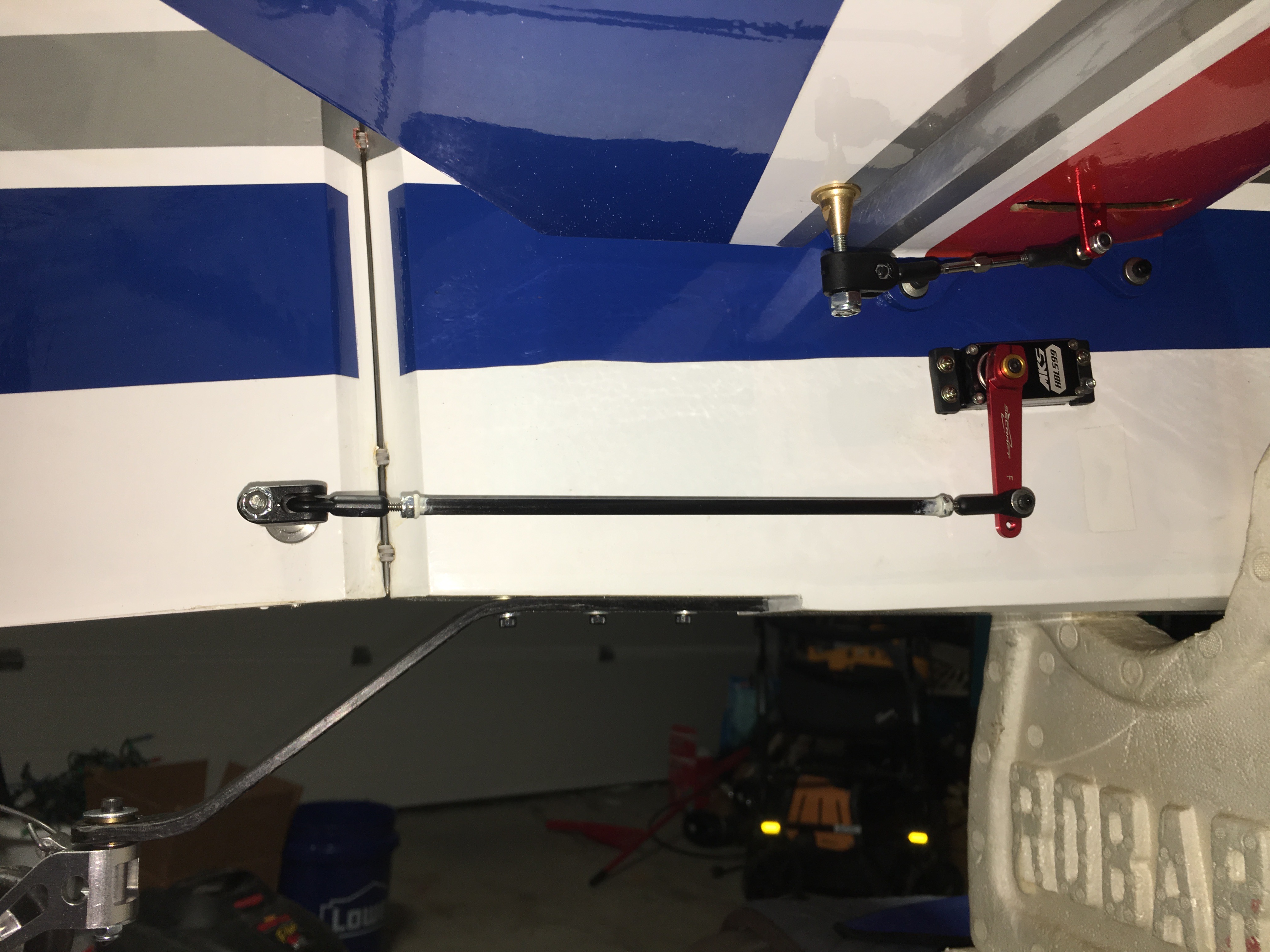

Just would like to know when connecting 1200 or something like that to a rudder how is done and what is the hardware used it has to be more than a 3mm bolt and nut on one side. A picture would be nice. Thanks.

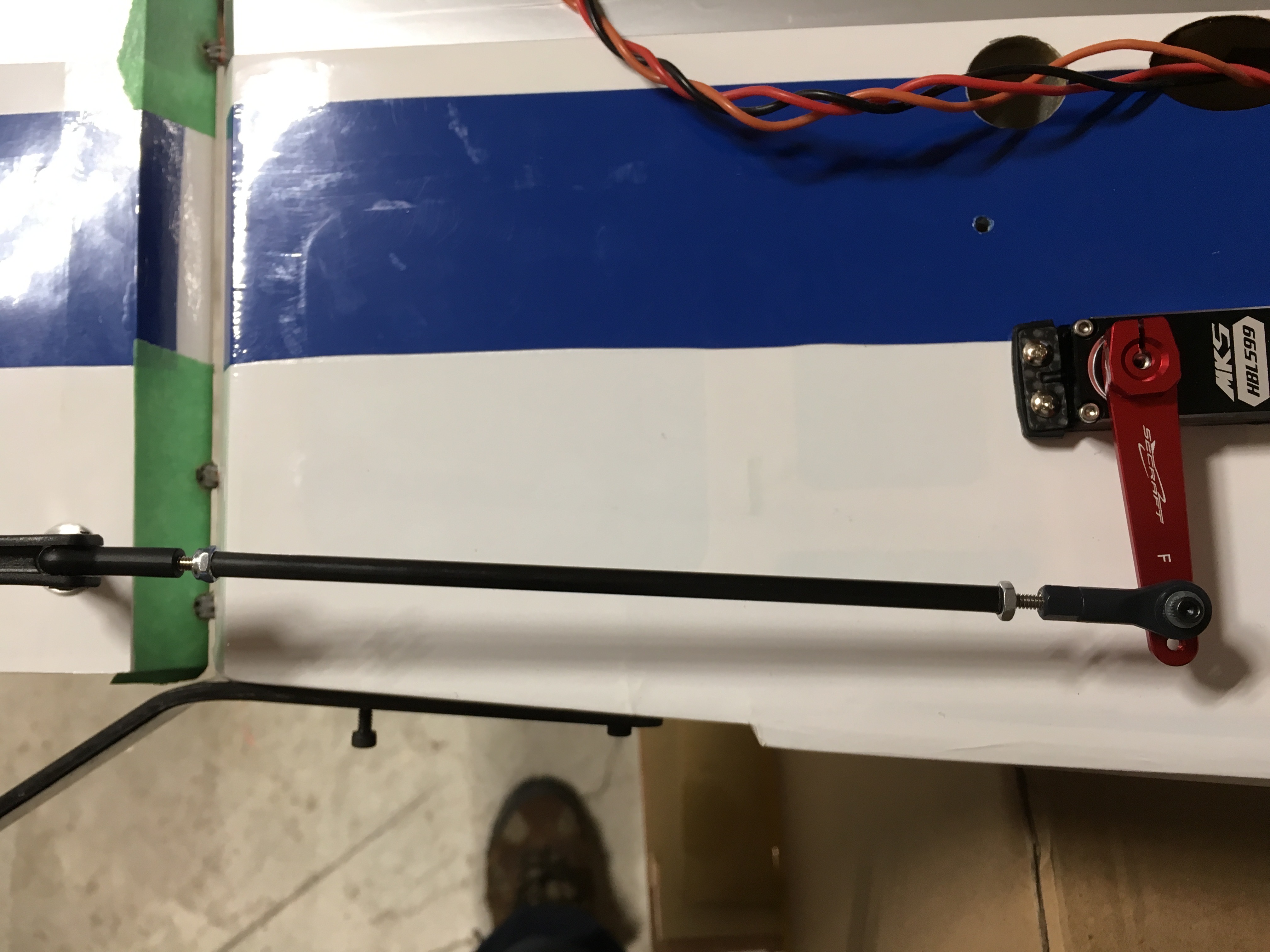

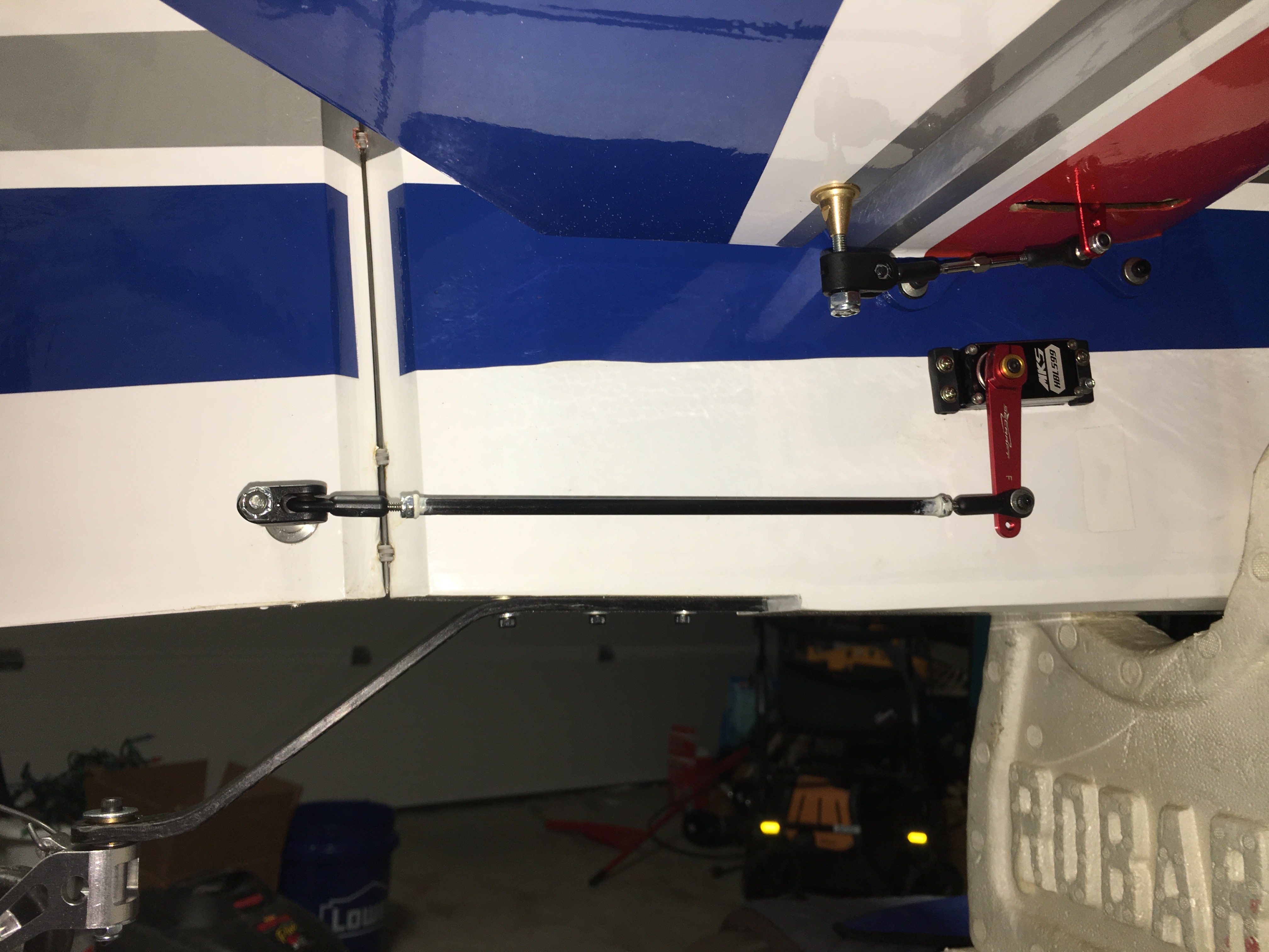

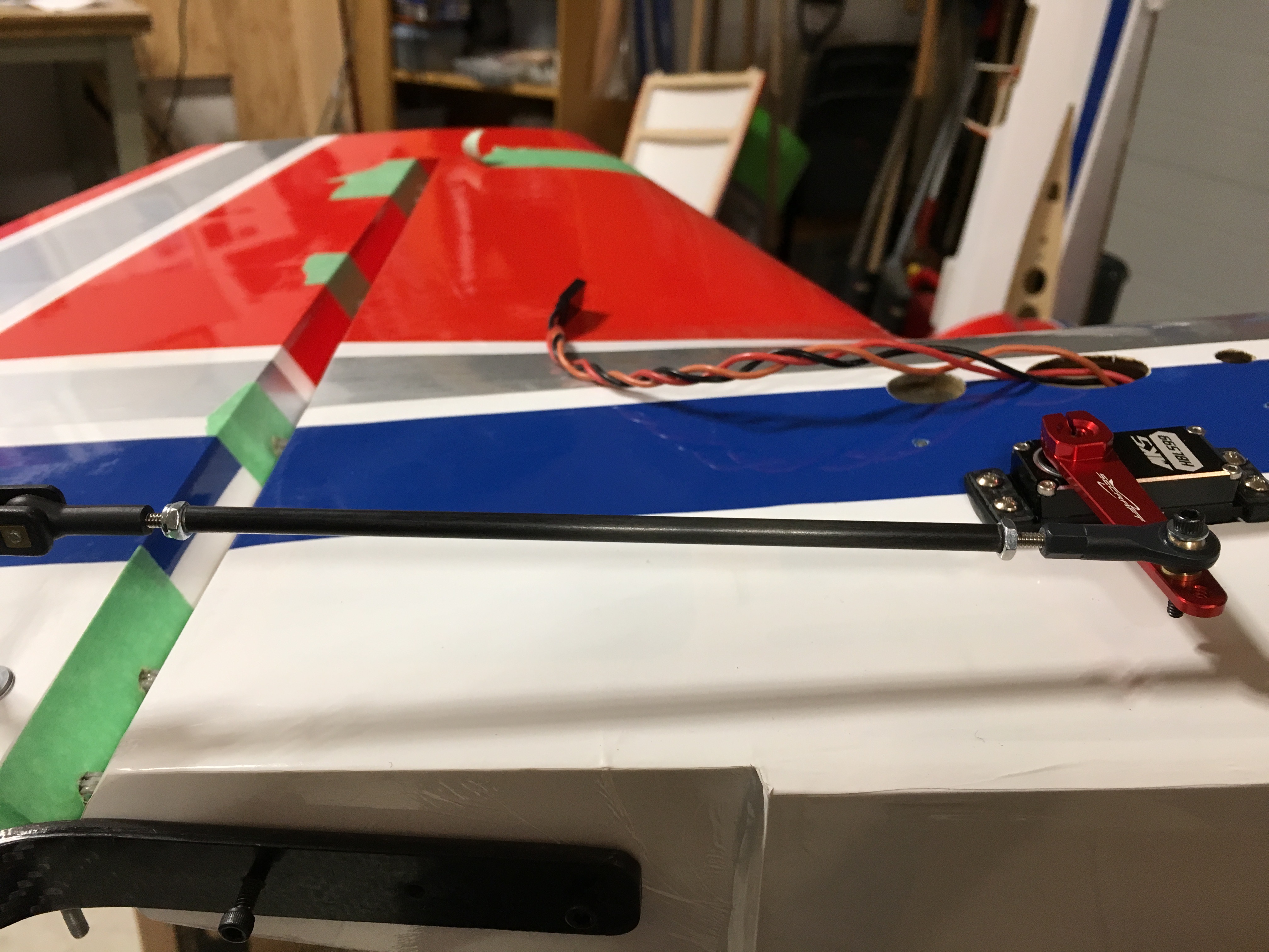

Here's the setup I'm using 4-40 threaded rod with a carbon fiber sleeve hysol eypoxy with to fiber lock nuts holding it together . No flex just positive input to the rudder .

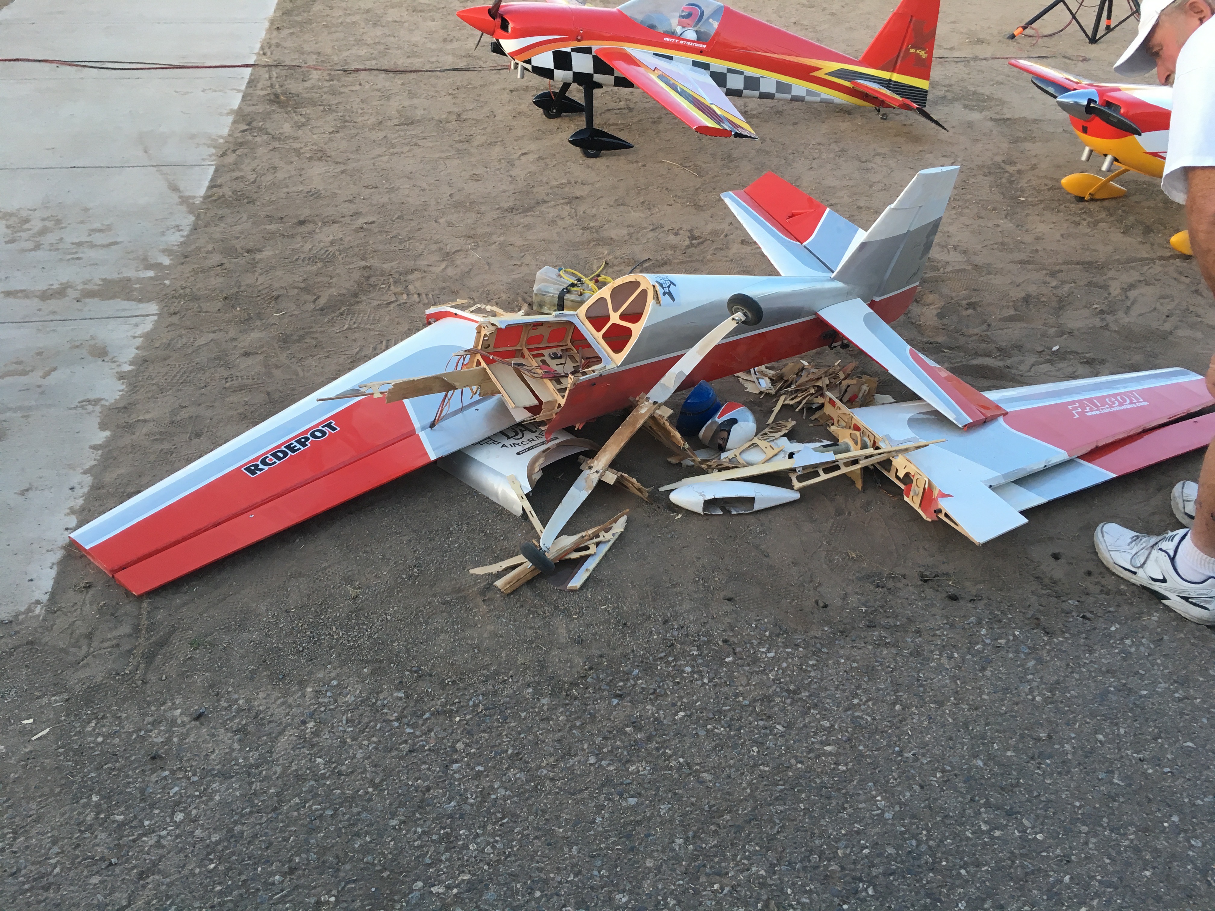

The last photo is the result of when equipment fails from TAS 2017 during freestyle :eek:

Snoops, don't know about other guys, but I use Hangar 9 or Sullivan HD hardware. Use primarily good quality servo arms like MPI or SWB. Many out there worth looking at. As for setup, pretty basic really. I have done pull/pull on rudders. I really don't like them because you are relying on a cable that can stretch to "PULL" your rudder to one side or the other. With a push/pull, (my preference) with the titanium hard link turnbuckles, you not only are pulling on one side of the control horn, you are also pushing with the same force on the other side of the control horn. Equal pressure minimizes stress and therefor reduces risk of something failing. Also, I have found that a push/pull system is actually stronger and maintains more of the grunt force the servos are exerting. With pull/pull, you are losing a bit of the torque because you lose it through the cable. You would be surprised at just how much force it takes to break a 3mm bolt. There is no doubt in my mind that you will rip your control horns out of your control surface before you will break a 3mm bolt. Ask me how I know this. LOL. When possible, (which I will 99% of the time drill out the control horns to accept a 4 mil bolt) I use 4mm just for the extra safety margin. Its that anal thing.
I don't have any photos at present, but would be happy to get some and post them for you. Remember, your setup is "ONLY" as strong as your weakest link.

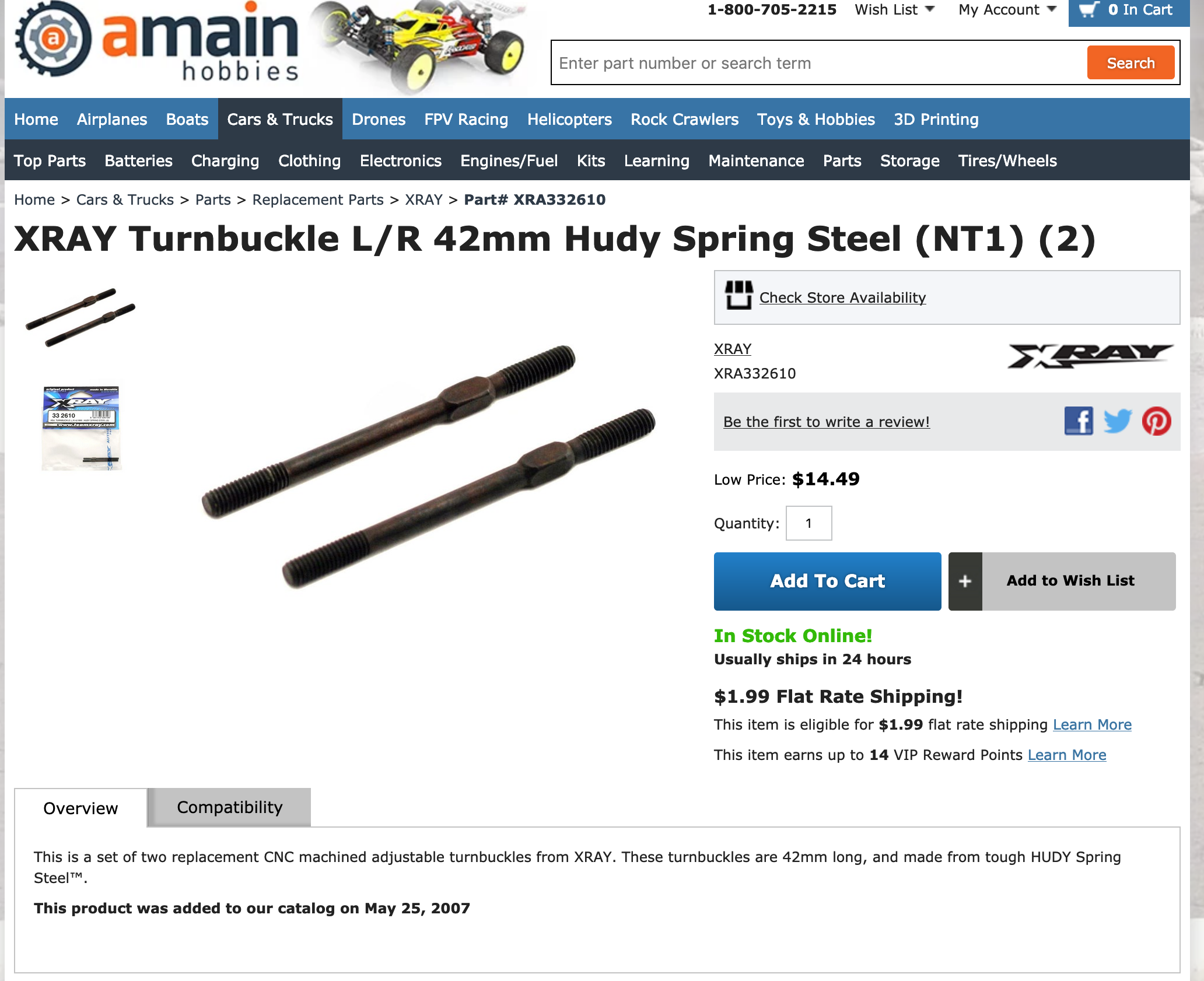

Talk with a few pilots in the South central district and a couple of them have had issues with the 4-40 Titanium hanger 9 and SWB turn barrels bending . It happened on the ailerons that were bent from flying the 40 % Carden , Kam Aero and J-Tec planes . Remember they are pushing 38-40 lbs of weight .
How he resolved was going to a spring steel strength turnbuckle 3mm from of all place the RC car's , yes RC cars has alot of sizes of fit just about and issue it seems.
If you look(goggle tensile strength) of titanium and high tempered steel you will see the difference , since the adjustment he hasn't had any issues in the linkage . Yes the weakest link
