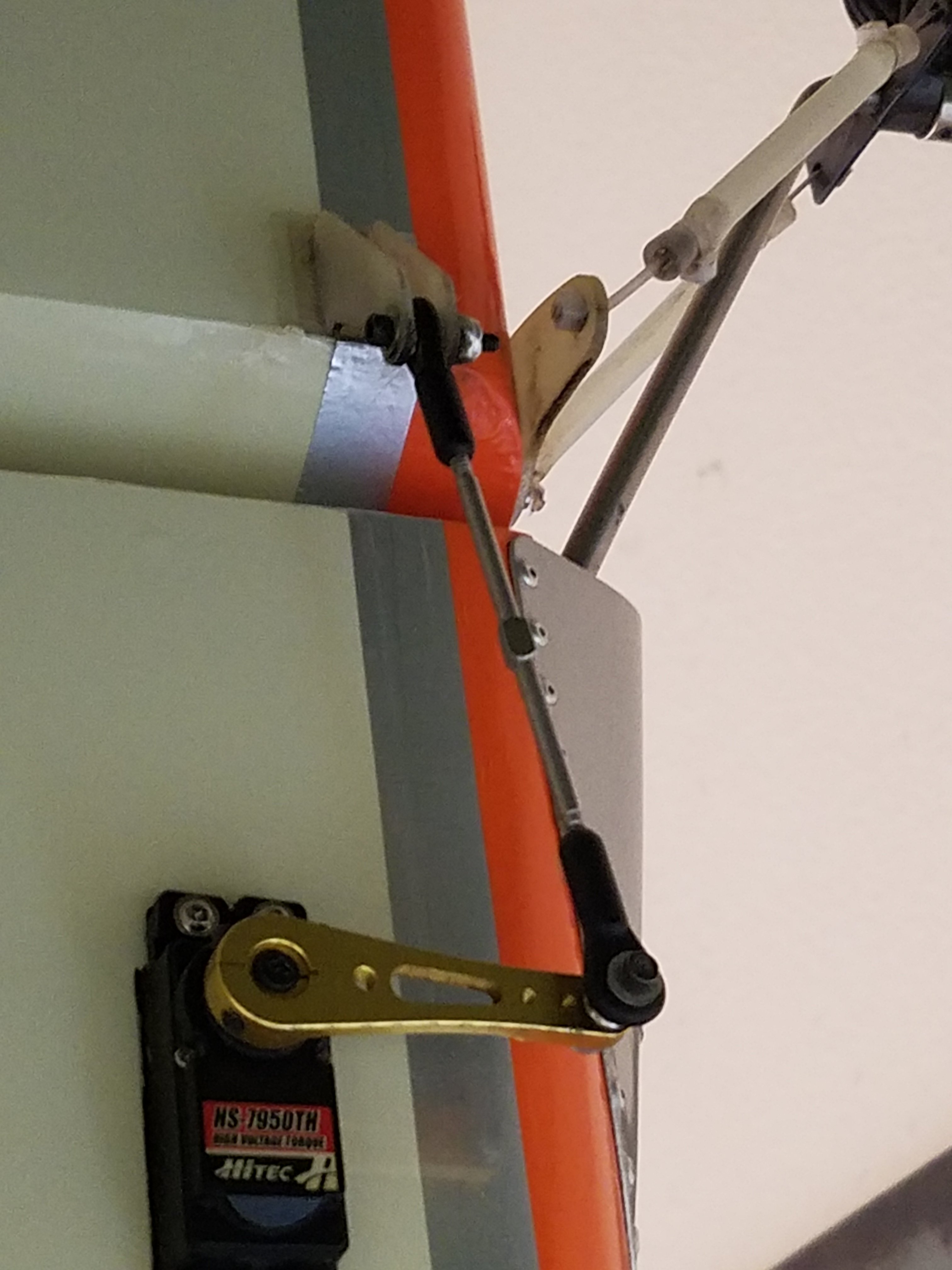

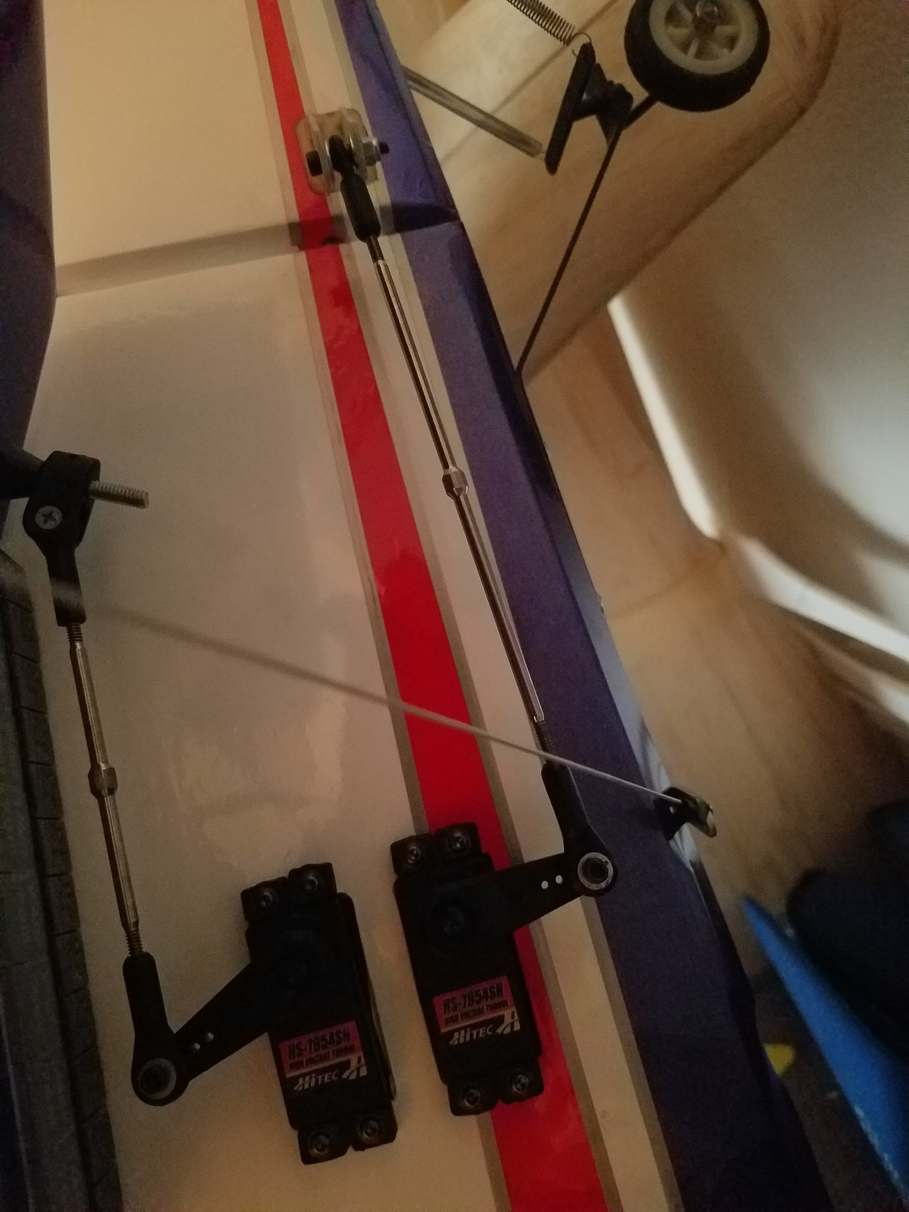

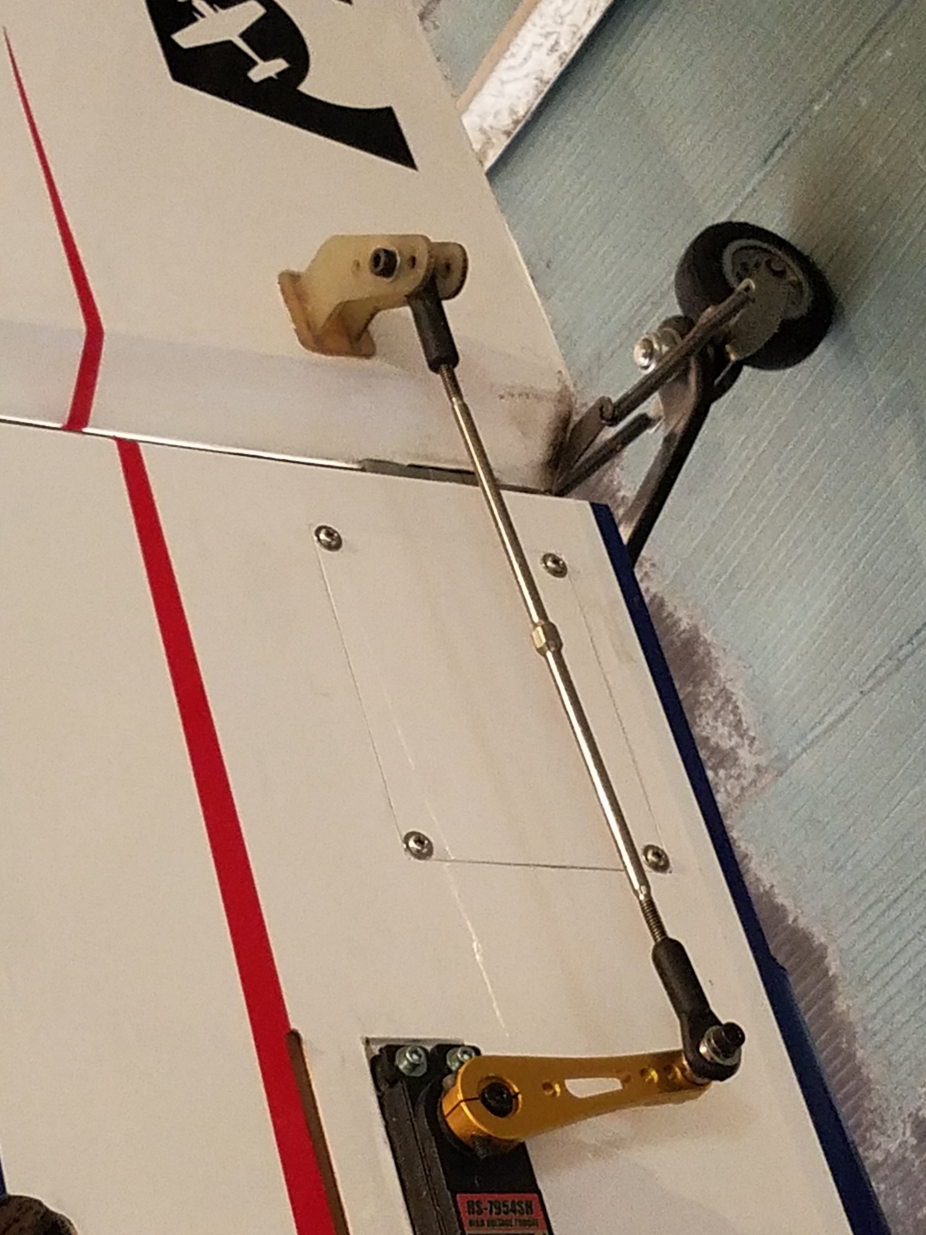

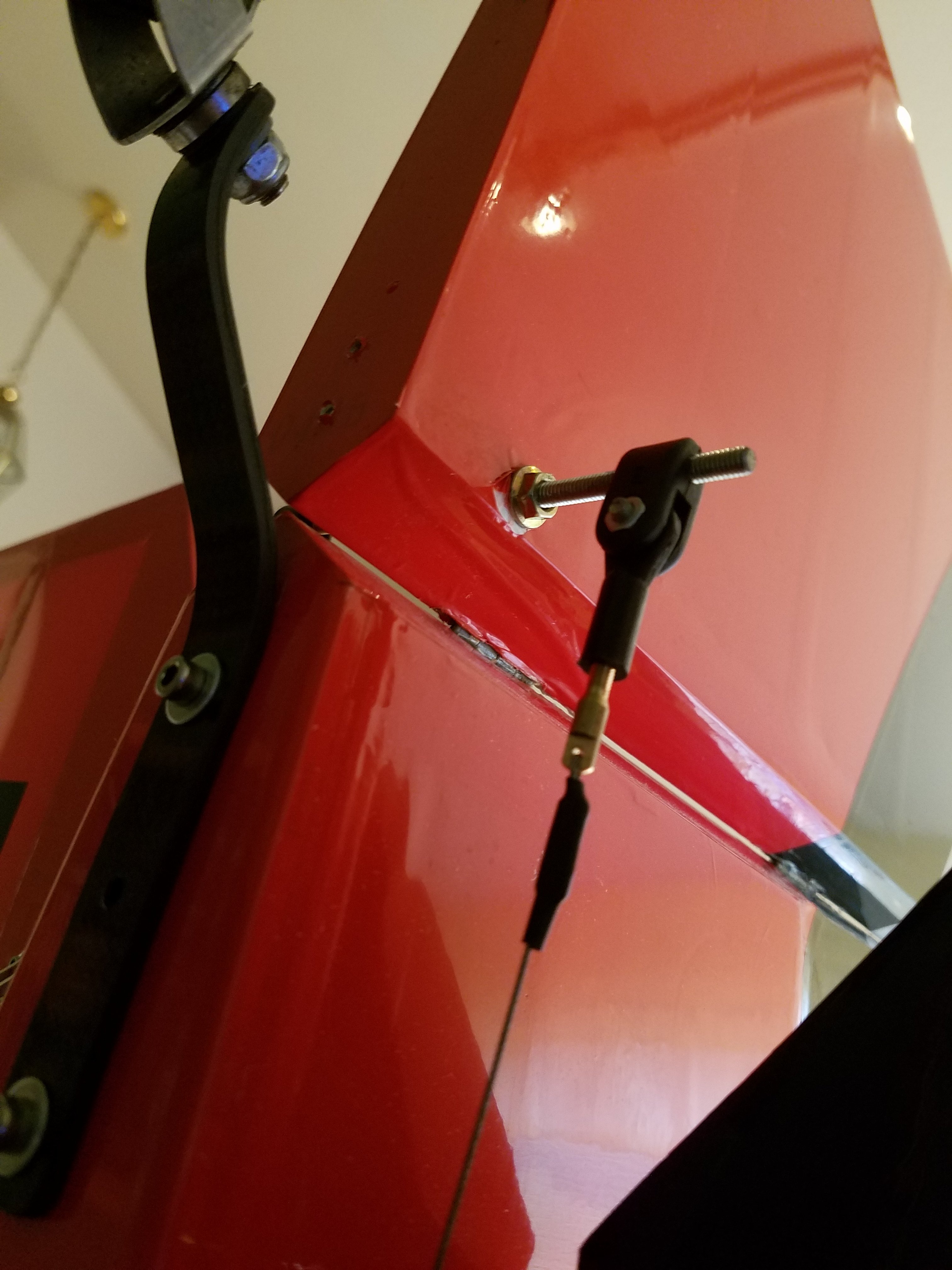

Just would like to know when connecting 1200 or something like that to a rudder how is done and what is the hardware used it has to be more than a 3mm bolt and nut on one side. A picture would be nice. Thanks.
As promised Snoops, a few photos of my rudder connections. I'll try to keep the photos in order.

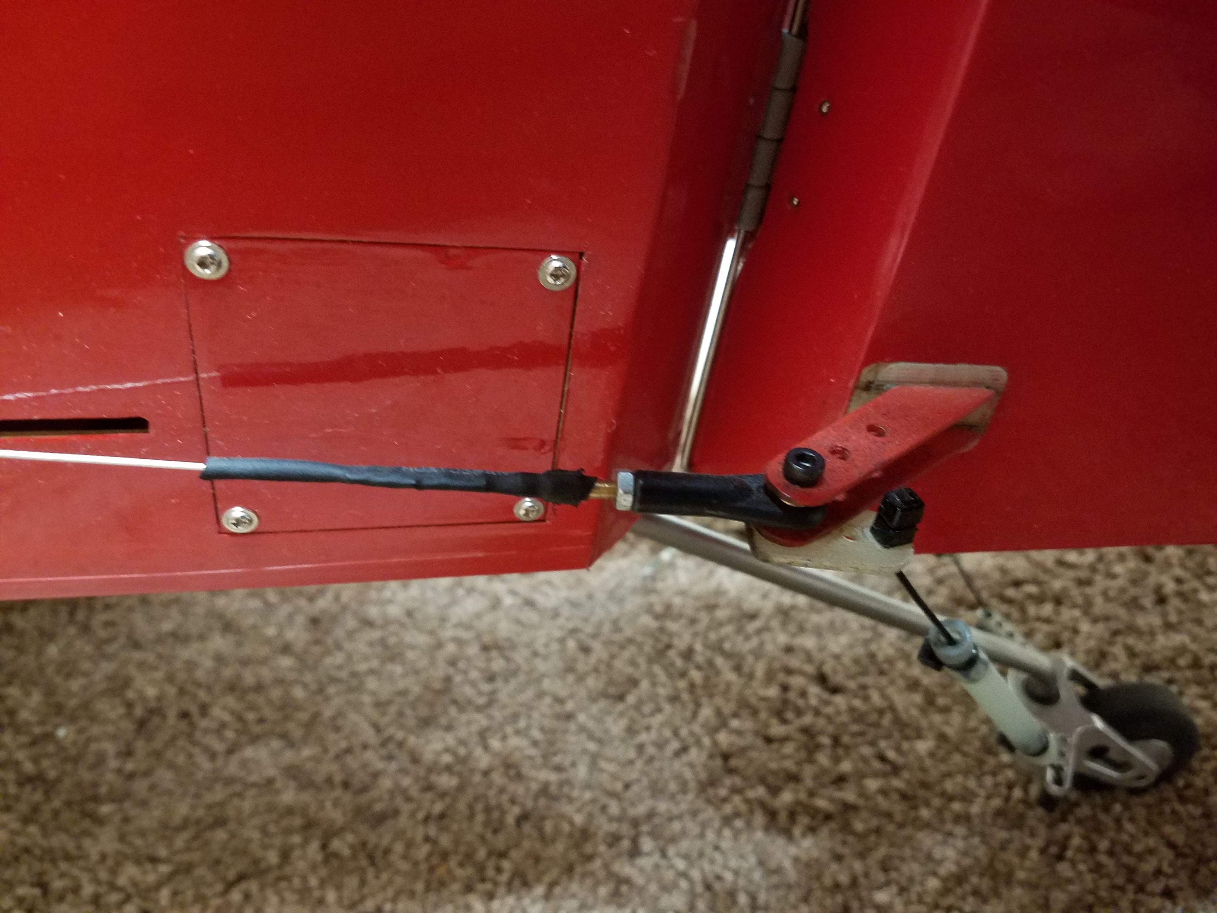

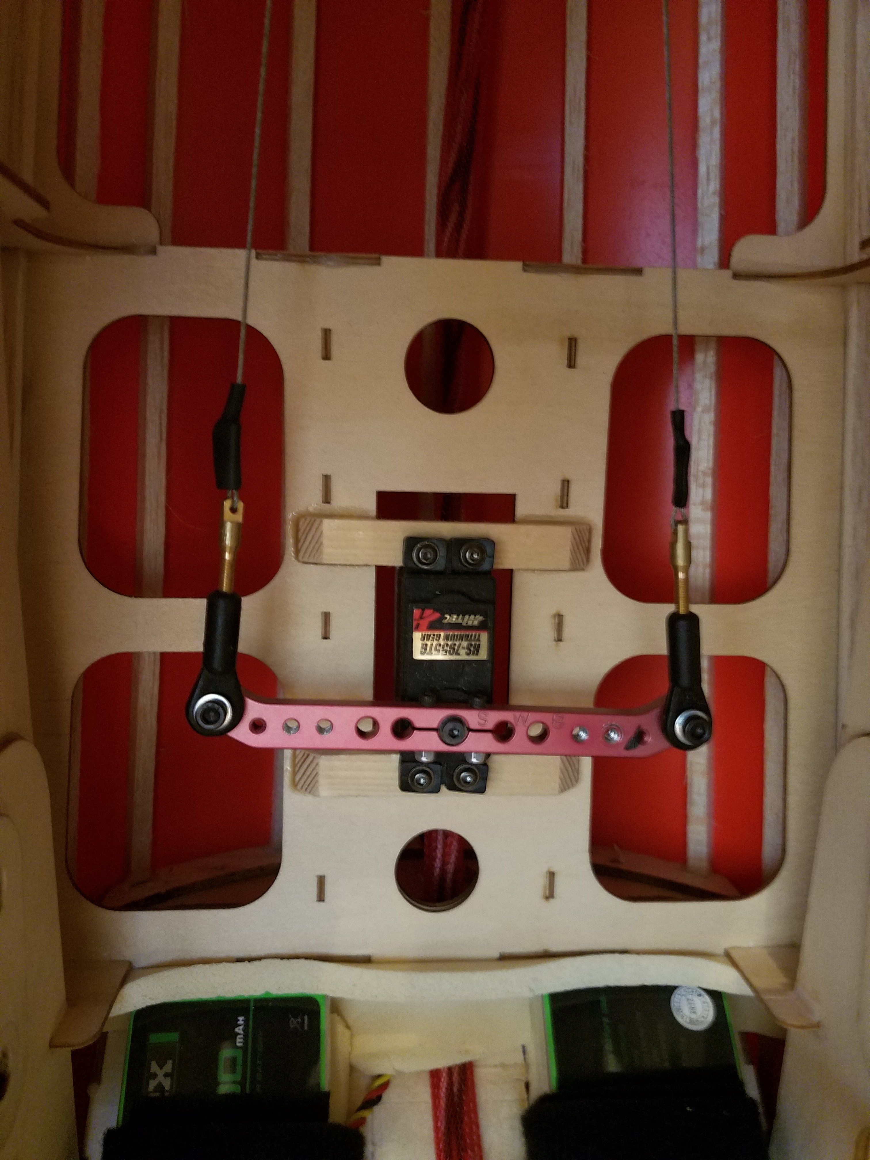

First is pull/pull on my 33% Yak. One 403 ounce Hitec 7955. (Sorry if the photos are not horizontally arranged. I really just want you to stand on your head. Lol)

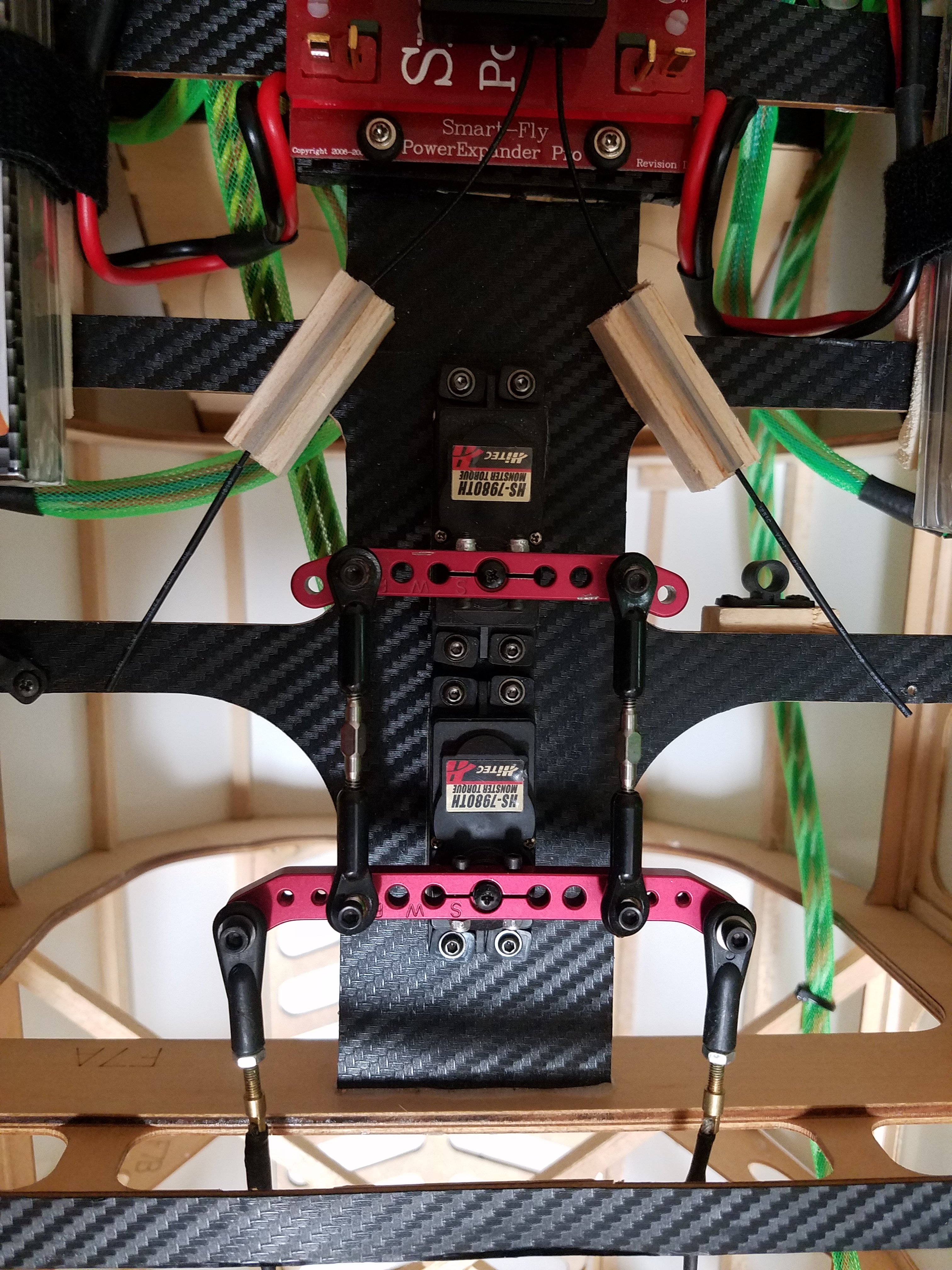

Second is push/pull arrangement on my Pilot Edge. Hitec 7954's.

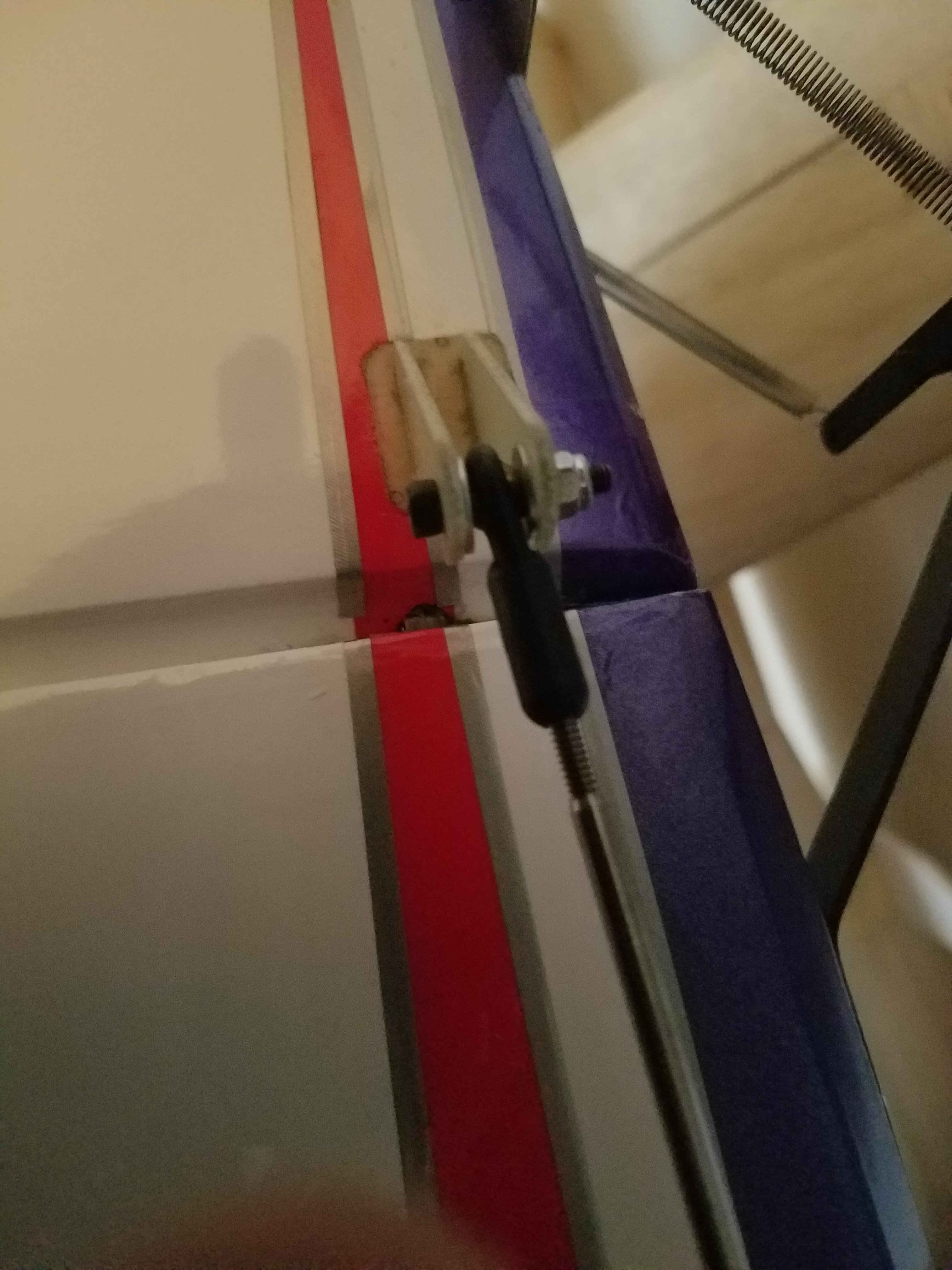

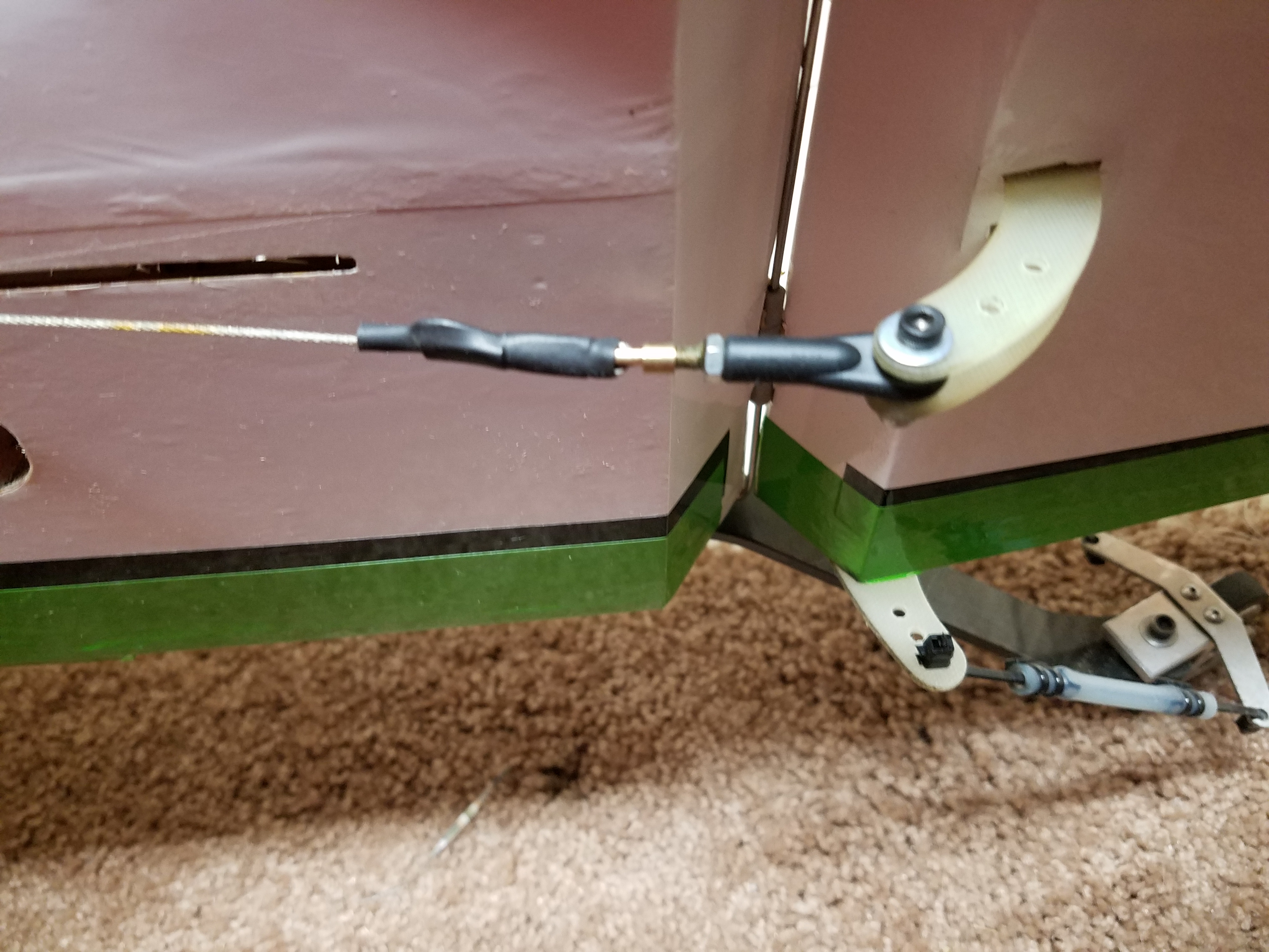

Next is pull/pull on my Pilot 40% 330. Hitec 7980 x 2.

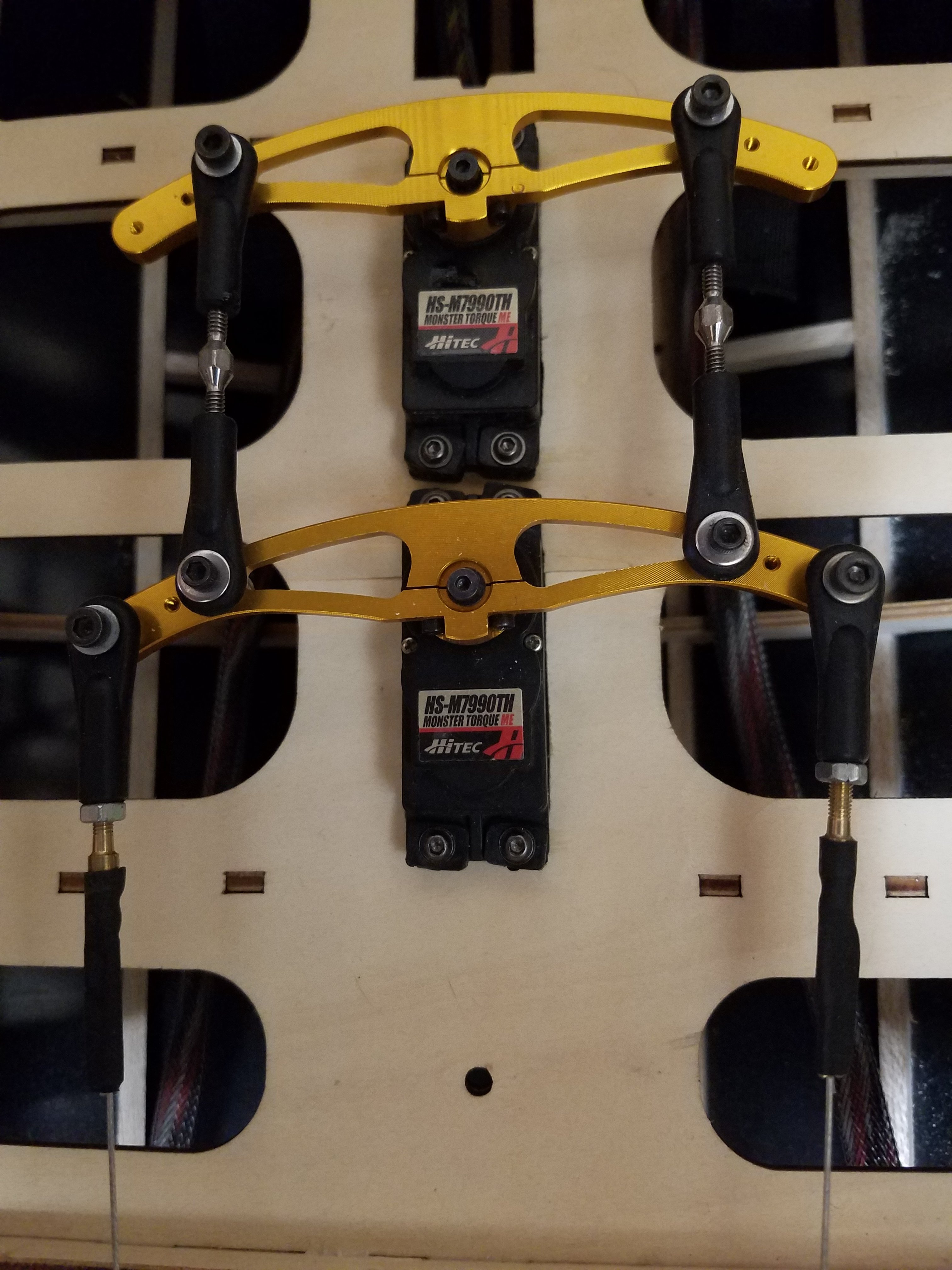

Next is pull/pull on my Behemoth Yak. Hitec 7990 x 2. Huge rudder, more than enough torque. Better be with the magnetic encoder and 611 ounces each.

Oh yeah, almost forgot the H9 Sukhoi. HS7950 x 2, (486 ounces each) push/pull configuration.
As for hardware, all basic HD whether pull/pull or push/pull configuration.
Hope the photos help you out.
