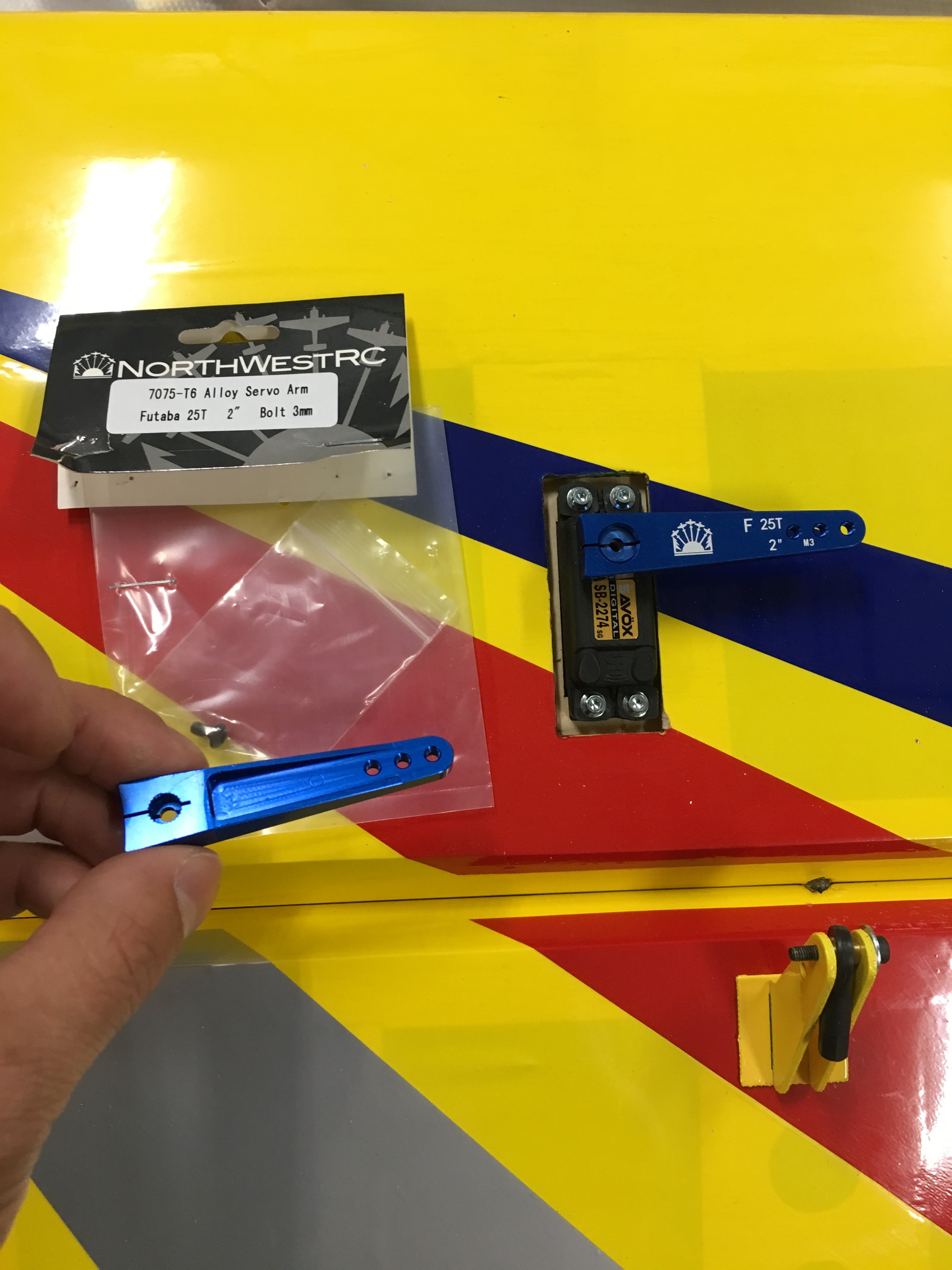

2” arms on the wings from NWRC in a pretty blue.

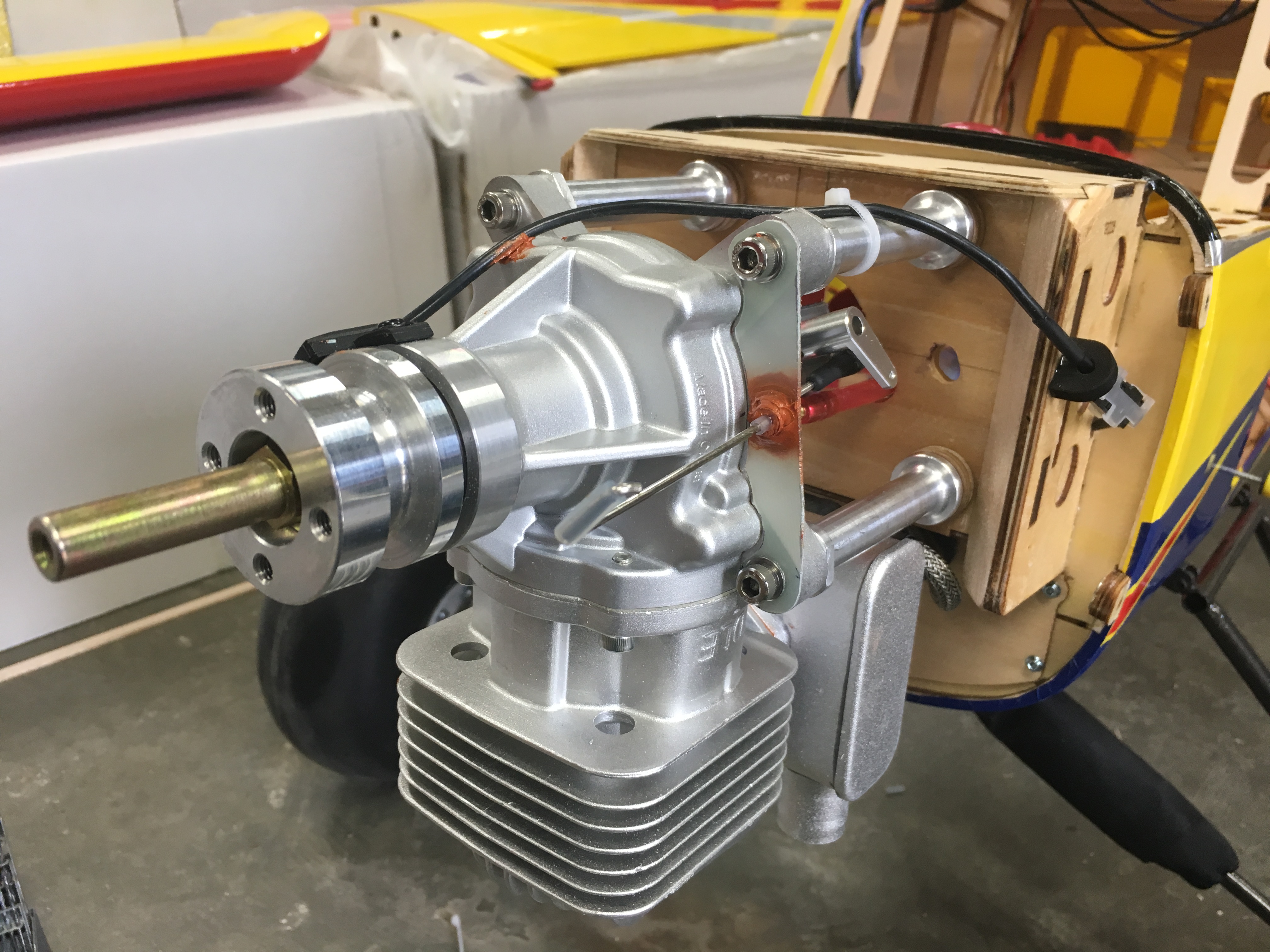

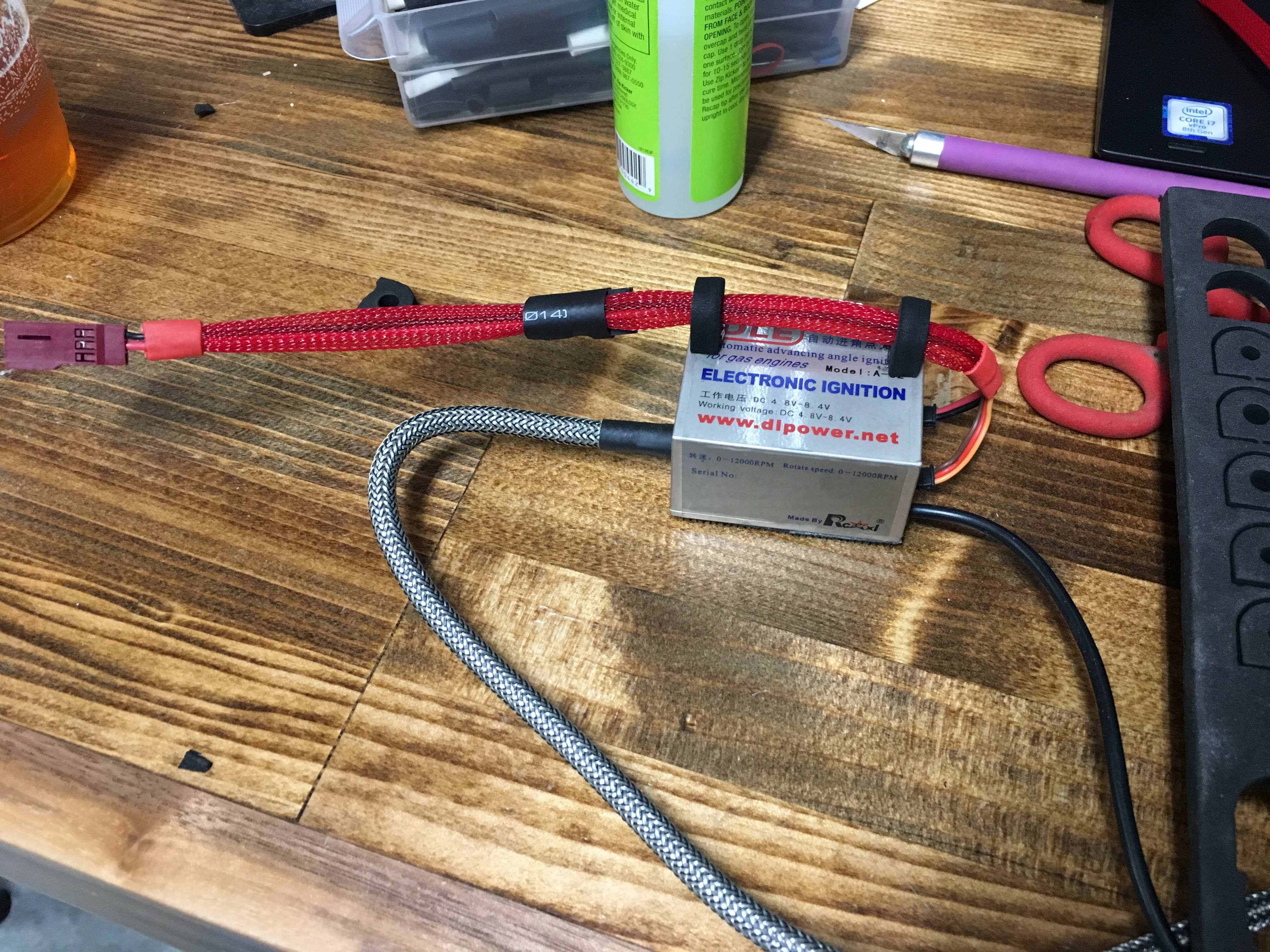

Found a good way to support the wires on the ignition.

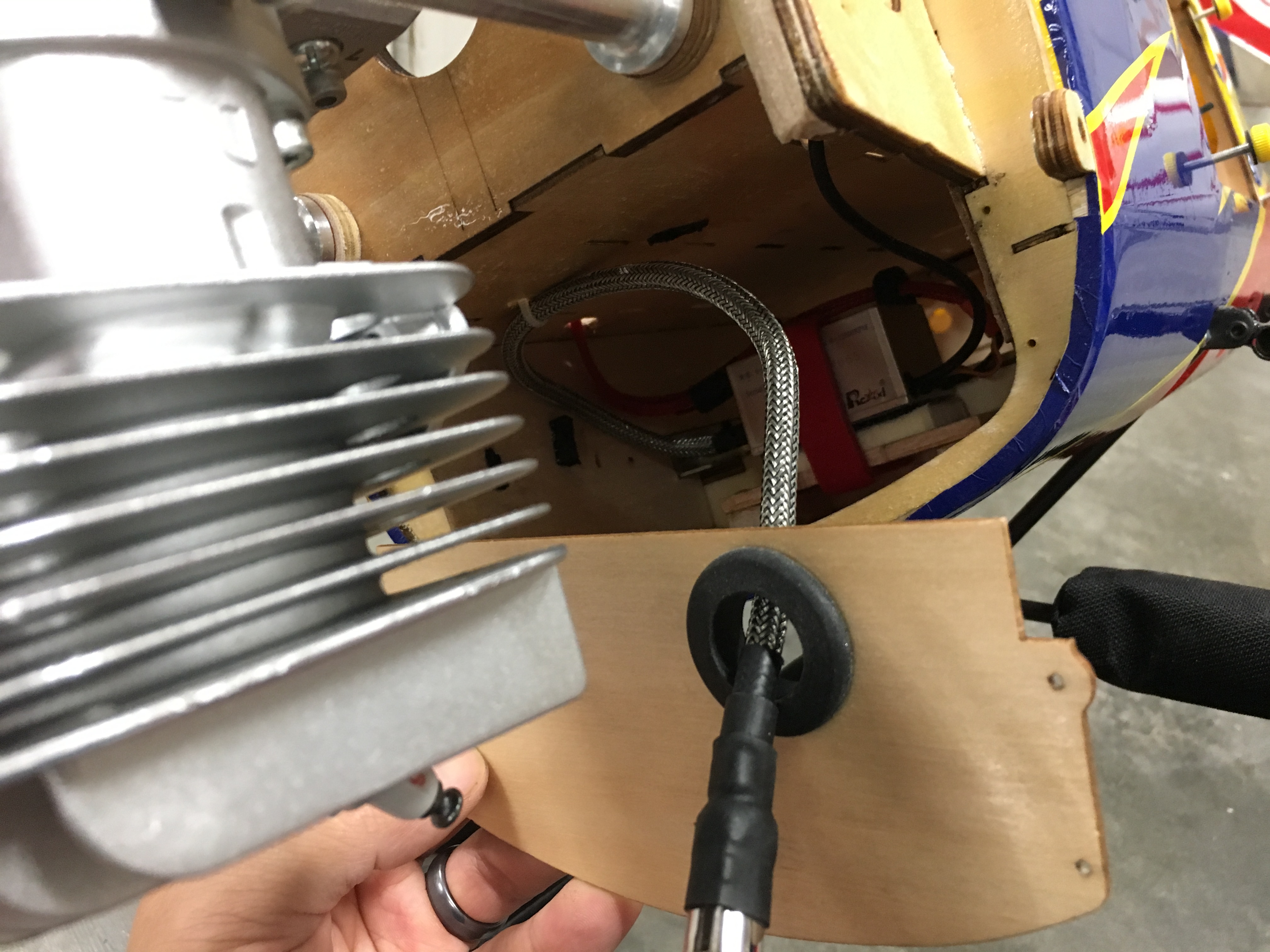

Added a grommet in the tunnel cover, ignition power on the right side through the floorboard and the hall sensor wire on the left and through the engine box.

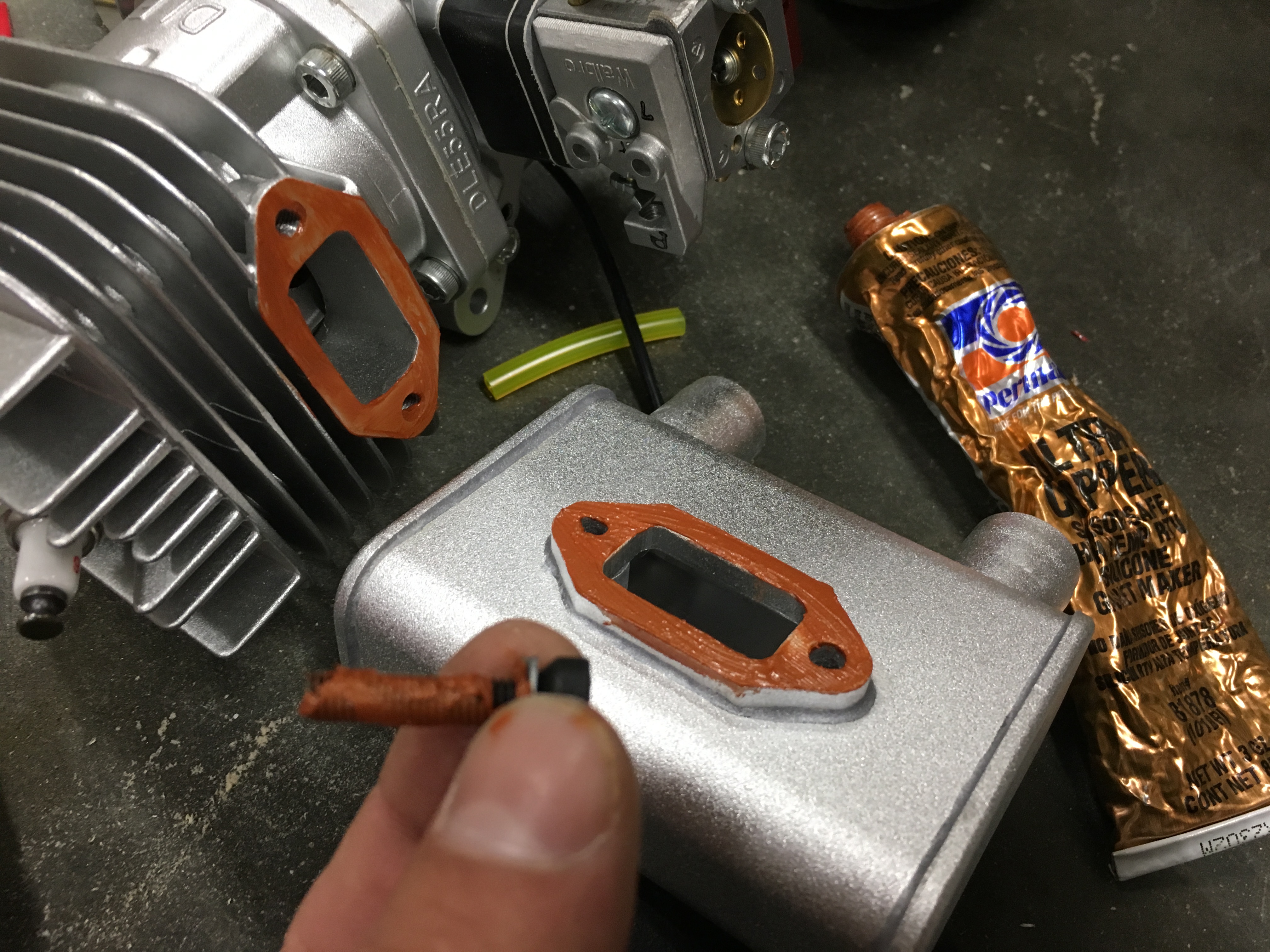

A little copper ultra for the muffler and beat into submission with some nordlocks.

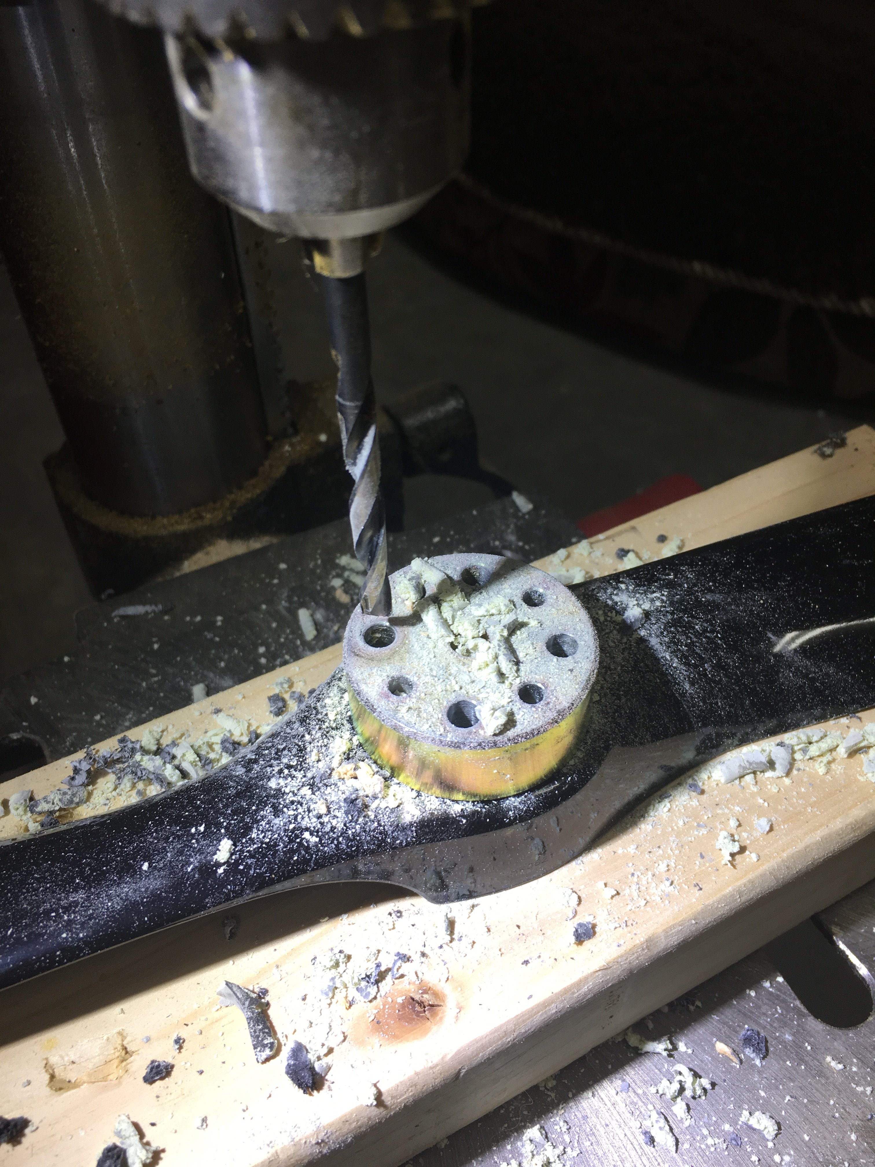

Nothing like drilling a new prop....
Falcon 23x8, DA drill fixture and a drill press.

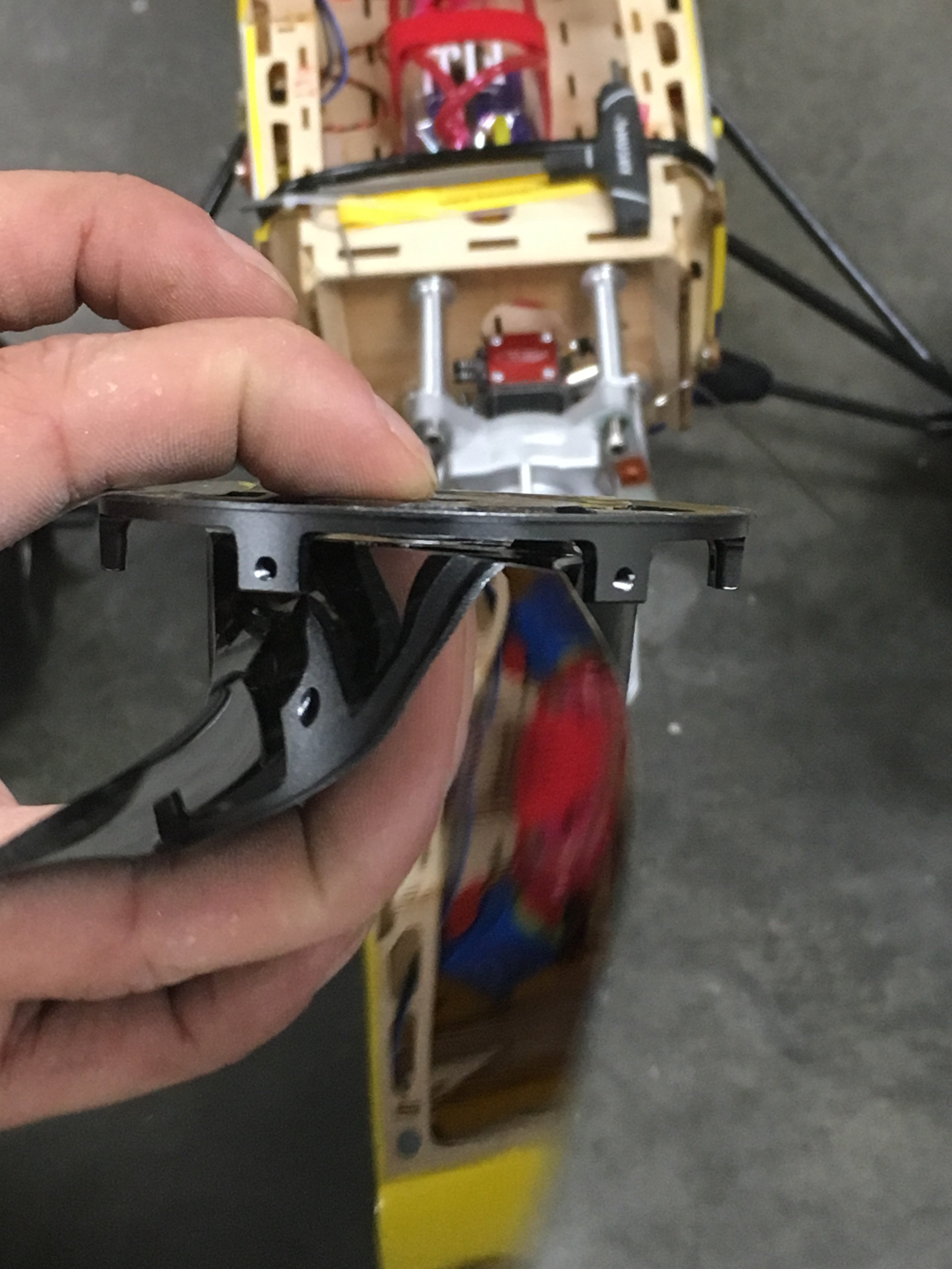

We’ll shoot.... no way this pretty falcon spinner is fitting this falcon prop. Darn.

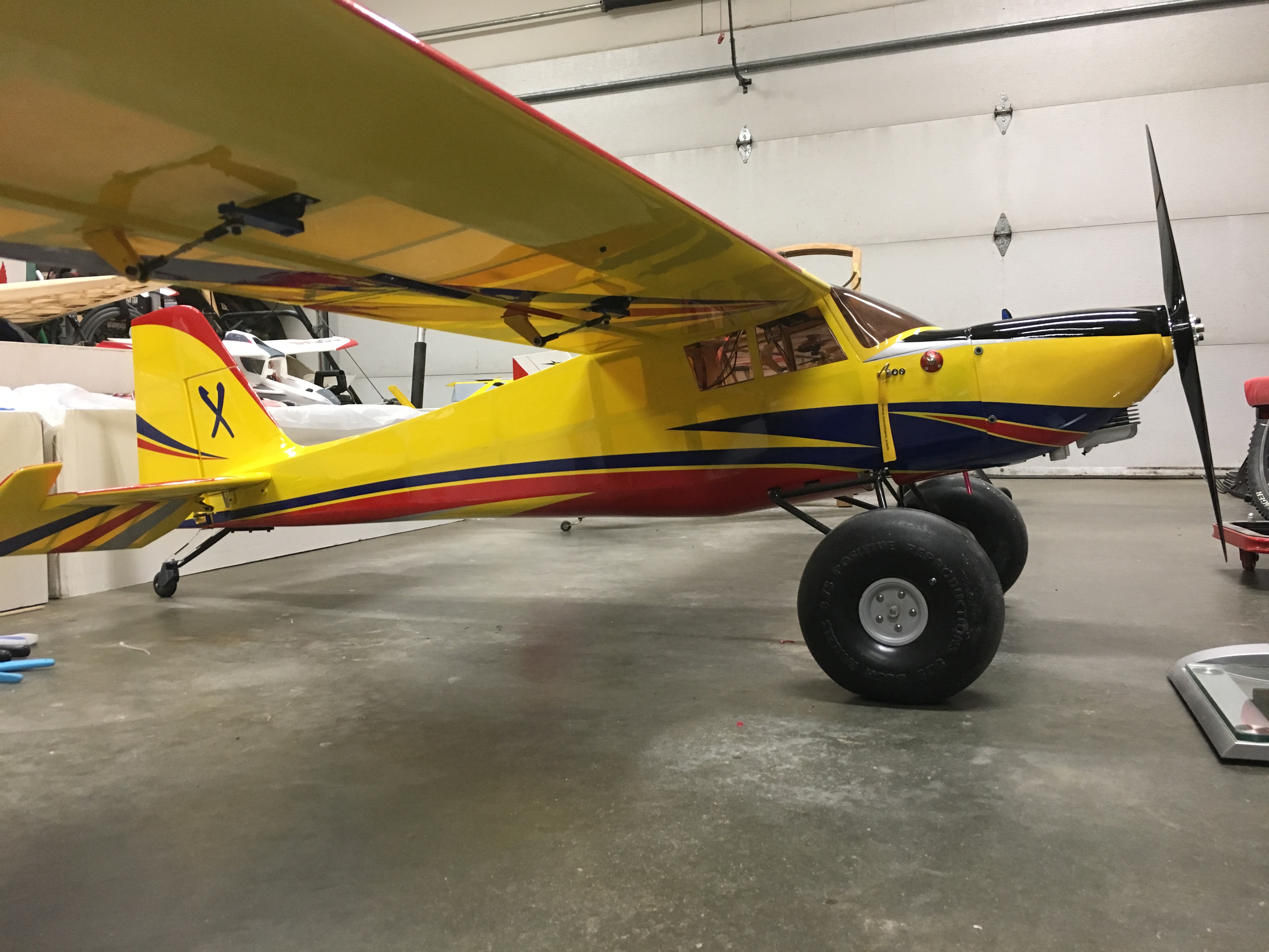

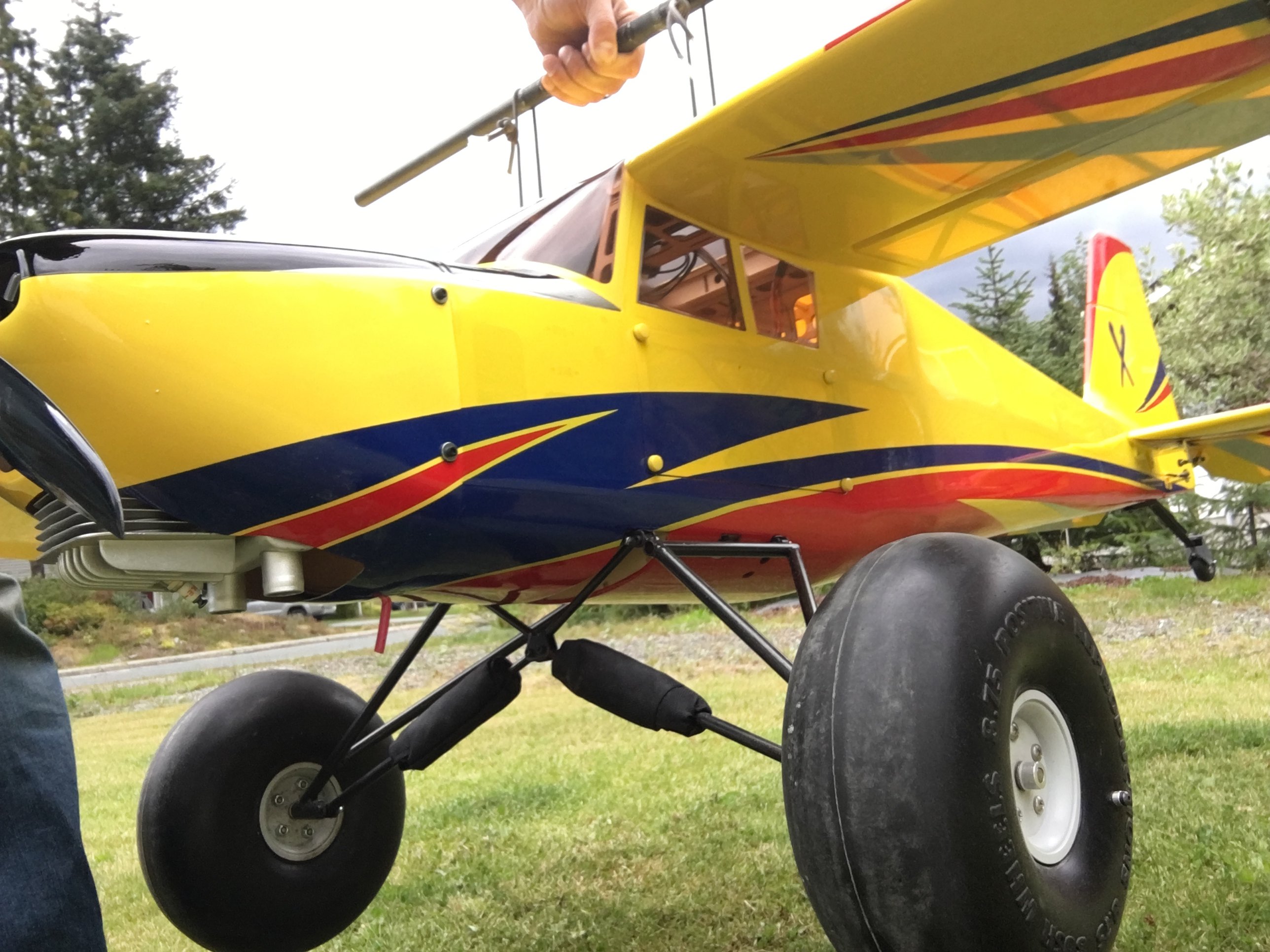

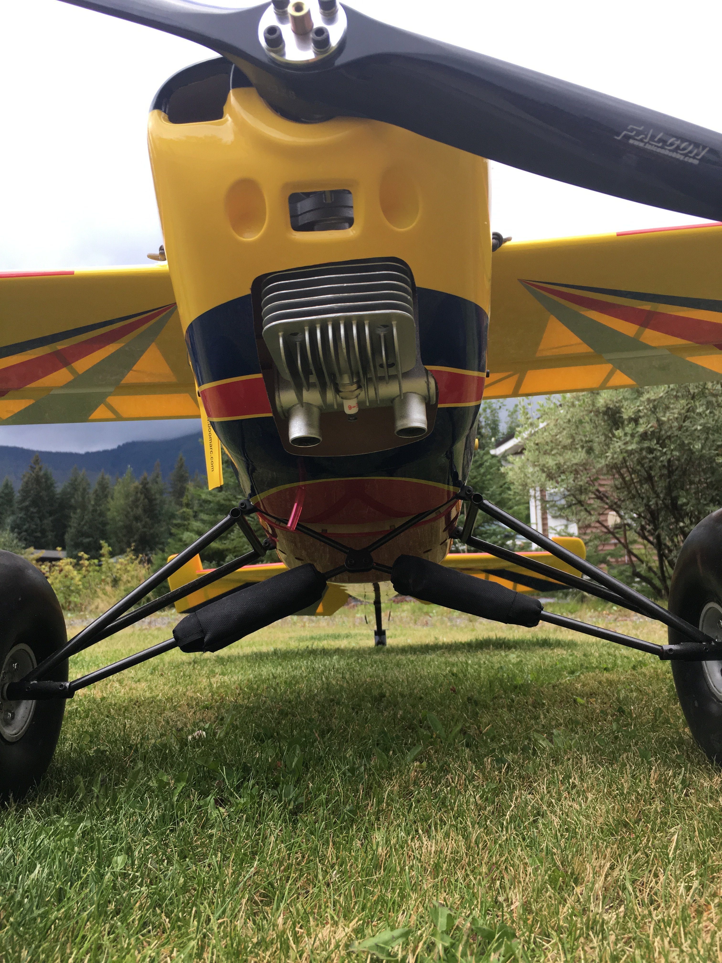

So this was the best time to check the CG, and check the weight. My calculations put this beast at 19.6lbs. Horizon says it’s 17-19, but with the optional gear and bush tires I’m really liking this number! Knowing this is without fuel and some wires.
To my surprise it balances almost perfectly on the tube as it is now! Which is about 4” back from the leading edge and is recommended for STOL flying.
Looking good not much more to do. Really like the colour scheme and it looks like quite a big plane. Your CG came out pretty close for you looks like no dead weight will be required.
What happened to the spinner.

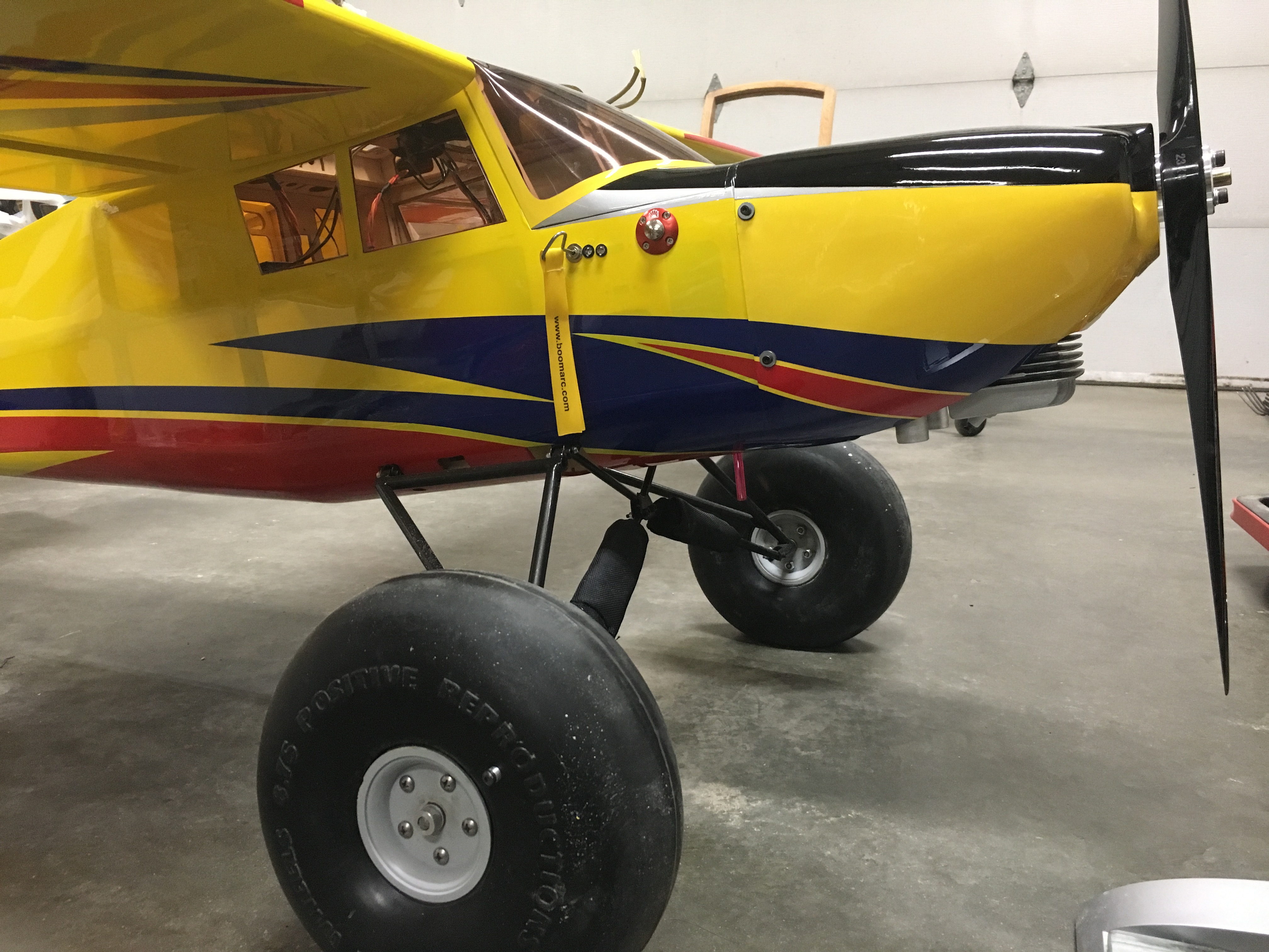

Looked at the wheels that came with the kit not impressed will have to find something else. Little better quality and look better.
