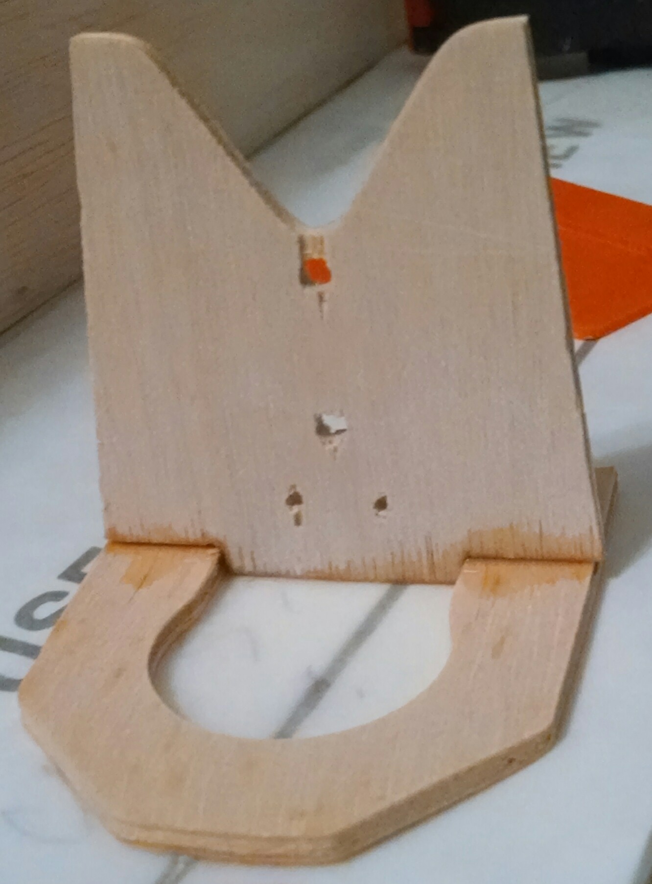

Tail wheel assembly plywood pieces glued together. Next up,some soldering...
