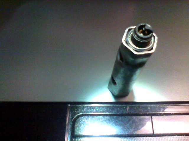

Just for FYI to all.....I have been running the 6volt version of the EME ignition with a 2 cell lipo for two years now and it does produce a noticeably hotter spark resulting in a 100 or so rpm gain. Engine runs a tad hotter too but not to the extent that any richening would be required. Kinda like lighting a fire with a torch instead of a match. Here is a pic of the plug after 2 years service with higher ignition input voltage....
Ok don't wanna stink up Rob's thread, but tell me if there are differences in ignitions. I've got em use only on such and such engine (DLE 85 use only, DLE 20 use only, and so on) I'm running 4.8V on 2 planes, even though they say up to 6V, seen several of the first gen. DLE igni. burnt up, but after reading your post Kelly, I think an upgrade to 6V is in order.
