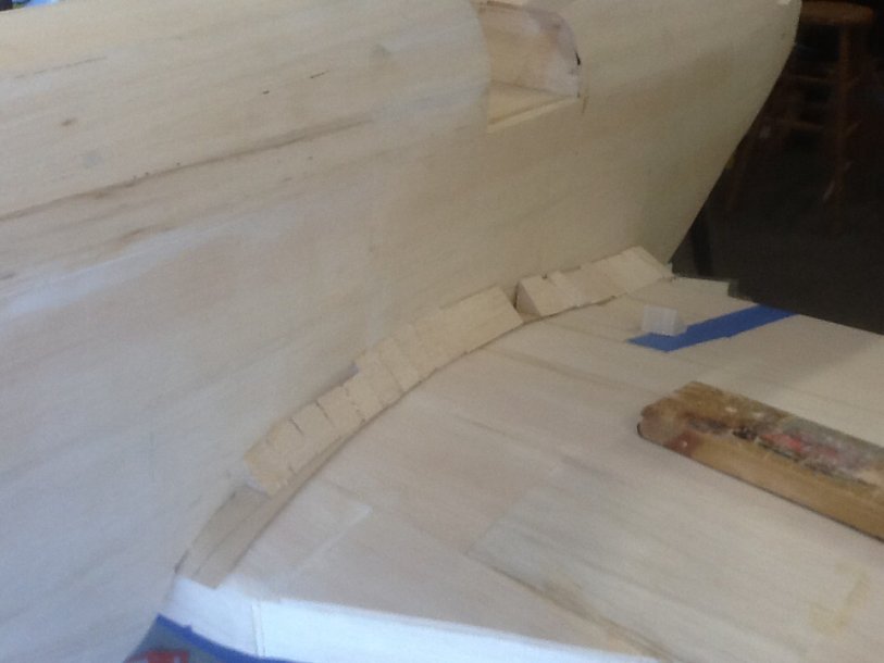

I cut and dry fit 25 pieces of triangle stock. Some of it was cut from a 1 x 3 balsa plank.
Red Raider
Finished the fillets and they turned out ok. For those of you who remember some of the older kits from the late 70's and 80's (before laser cutting was even thought of) there was a lot of "carve and cut to shape". Well, I guess that I'm stuck with that mentality. I piled wood onto the plywood base and cut and sanded and cut and sanded and then pookied it until I wa reasonably happy with it. I'll post some pics tomorrow after I have a chance to clean it up a little more.

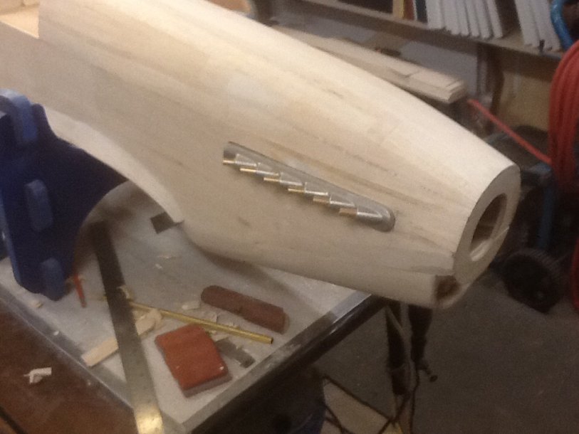

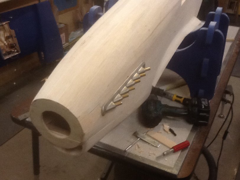

A friend of mine came into possession of an old fiberclassics P-51 that had a J'Tec "scale" exhaust system on it. He bought a Keleo system, and gave me the old stuff. I couldn't make it work the way it was originally designed, so I did a little work, drilled it out and hammered in some brass tubing. A little more work and I think it'll look pretty good. As a plus, even though they won't actually be hooked to the engine exhaust, they will provide quite a bit of outlet area for hot air that might otherwise cause a problem with heating.

That was my plan. I even bought some gas line to hook it up, but I just don't see a way to make this work. The outlets on the muffler are larger than the inlet on the exhaust. I haven't given up yet, but this plane just wasn't designed with that in mind. I'd have to cut significantly into the plywood inner walls that are very much part of the support for the firewall, and I'm afraid that I would compromise the structural integrity of the front of the plane.
