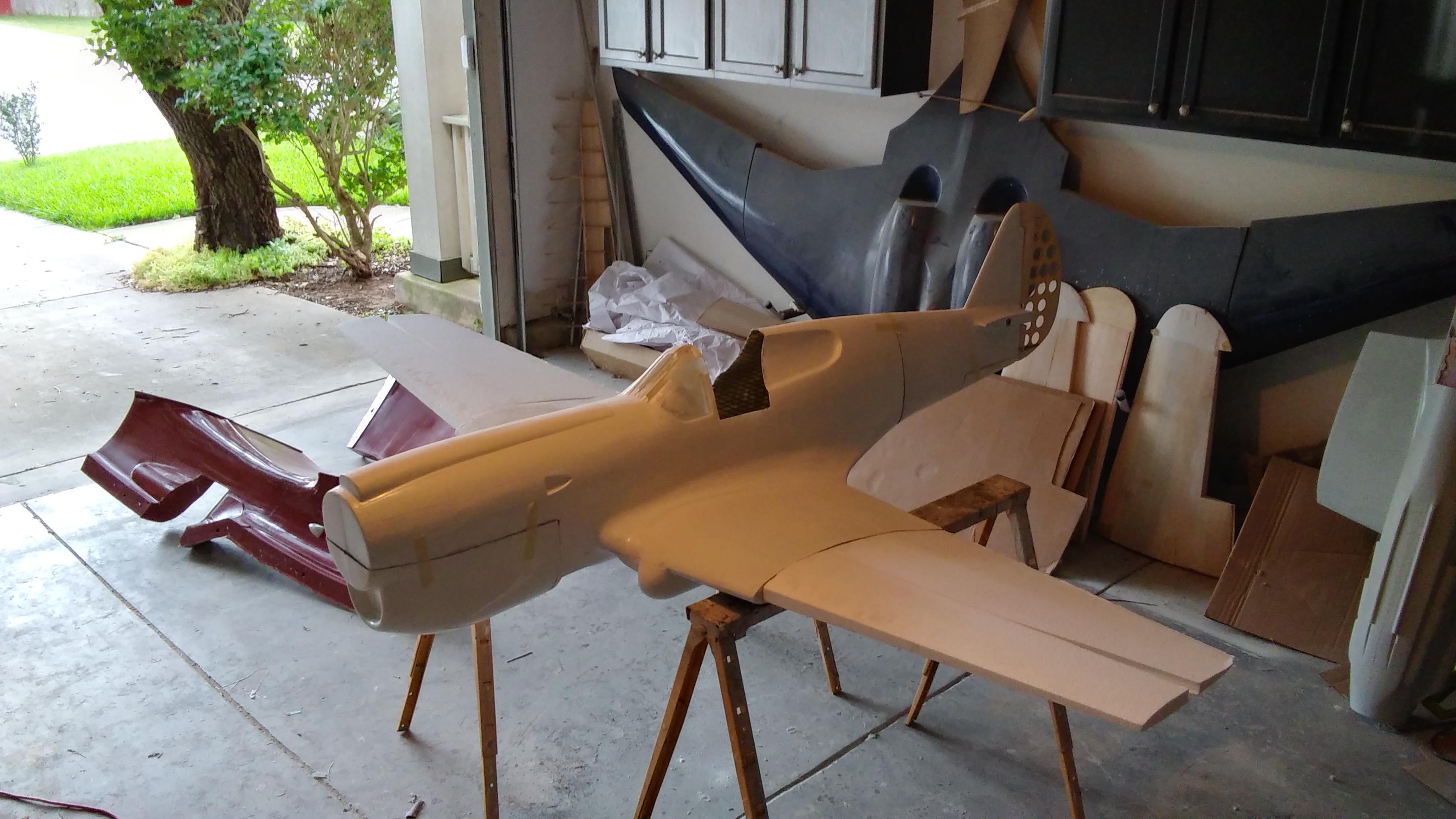

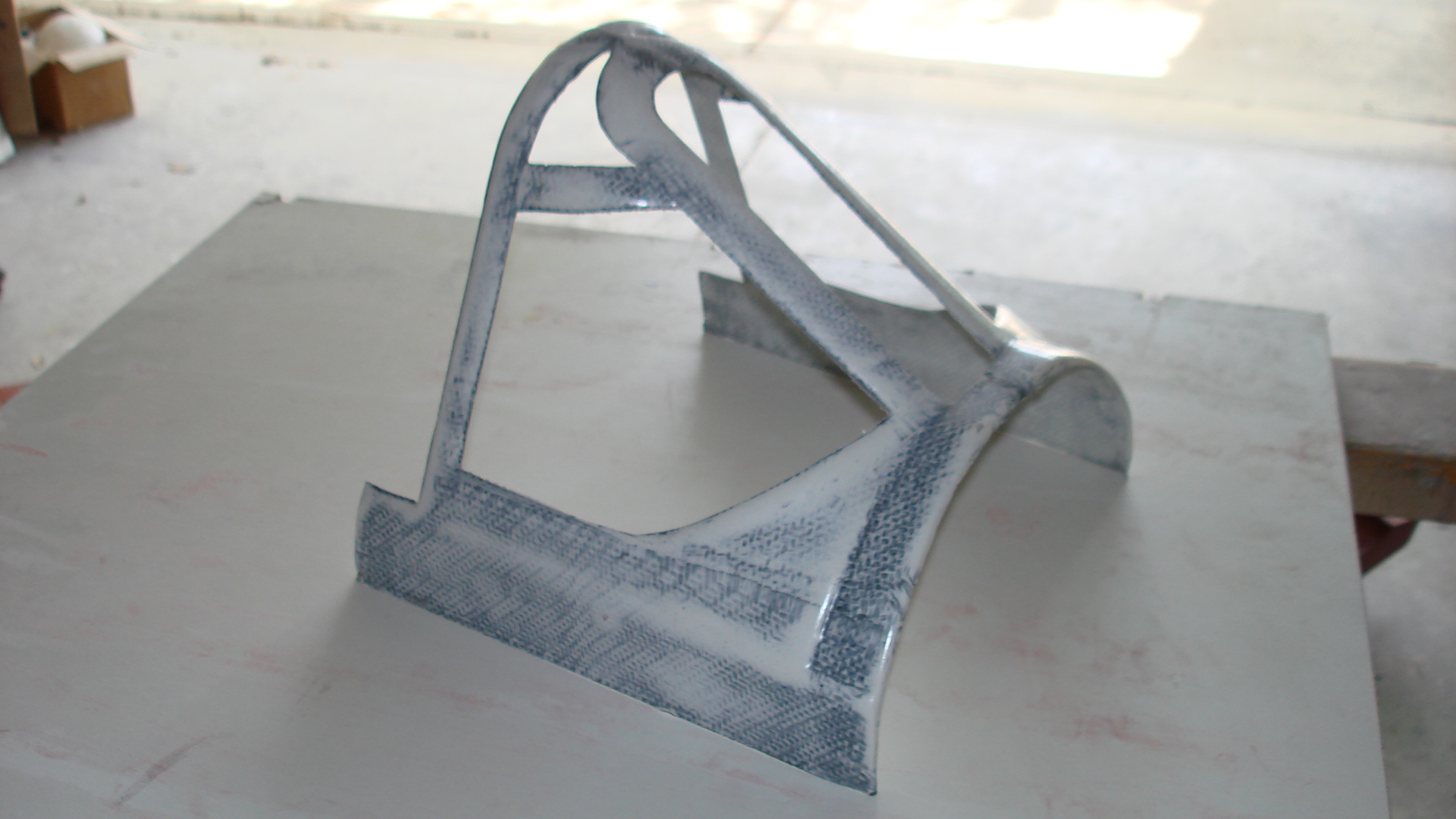

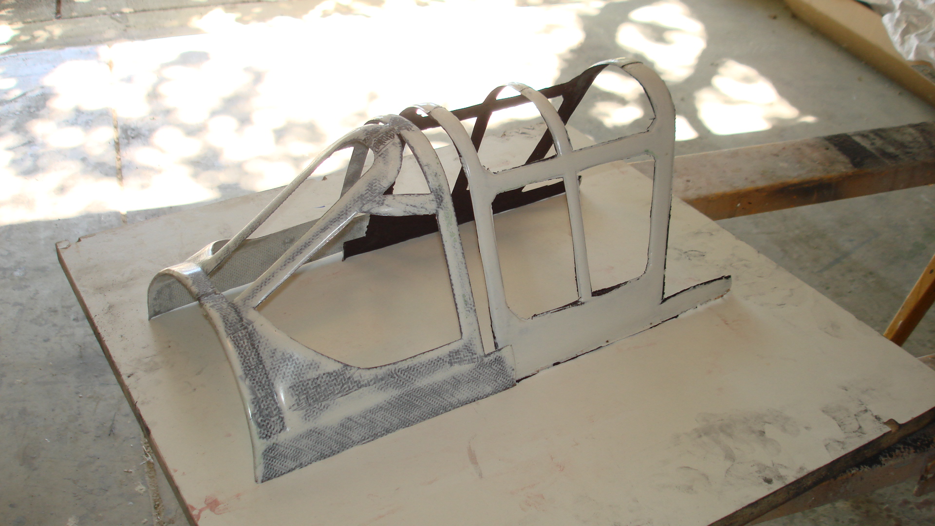

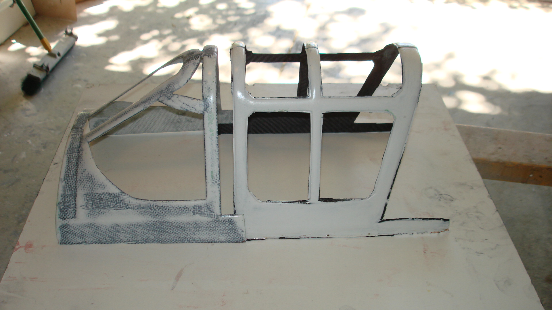

While I am building kits for customers, I sometimes decide to add some upgrades to my planes. So, I decided to make new canopy in carbon fiber. The front section is finished, and I am doing the rear next week. Also adding new building and composite techniques to make a strong but light air frame. I am not afraid to try something new while building. You have to keep improving and there are just so many ways and materials you can choose from when you work with composites, and so many ways of using them. My composite airframes are a lot more than just a bare epoxy hull.

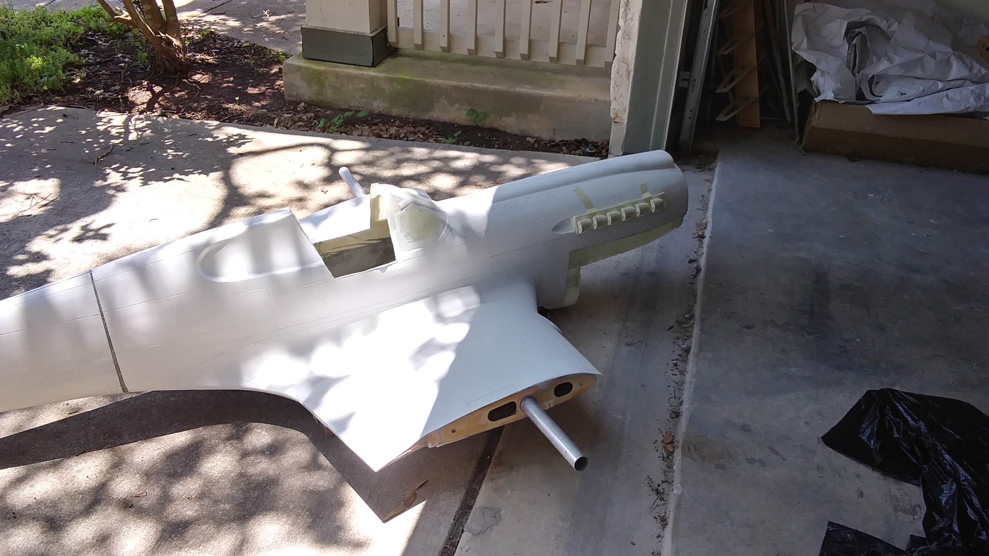

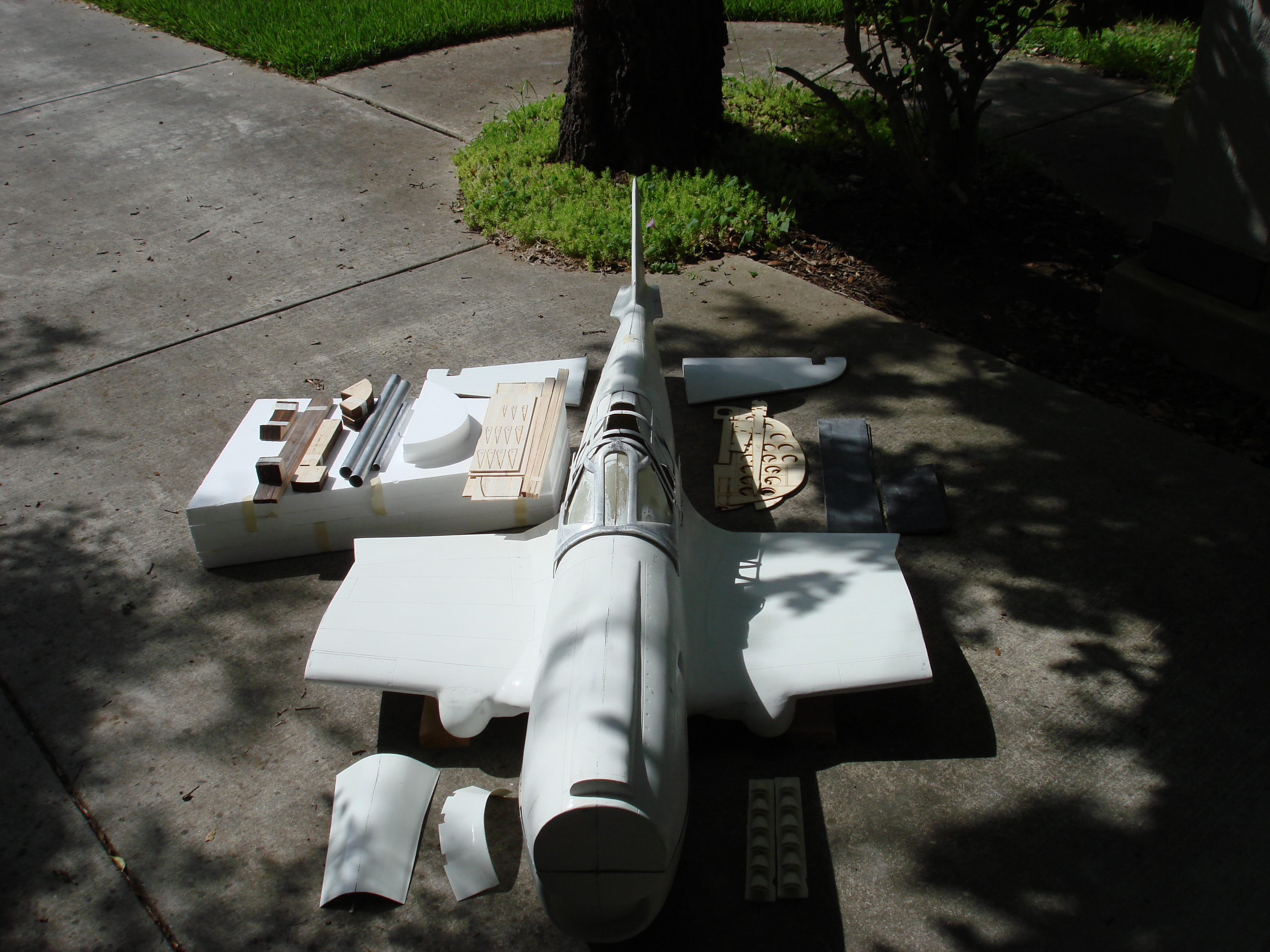

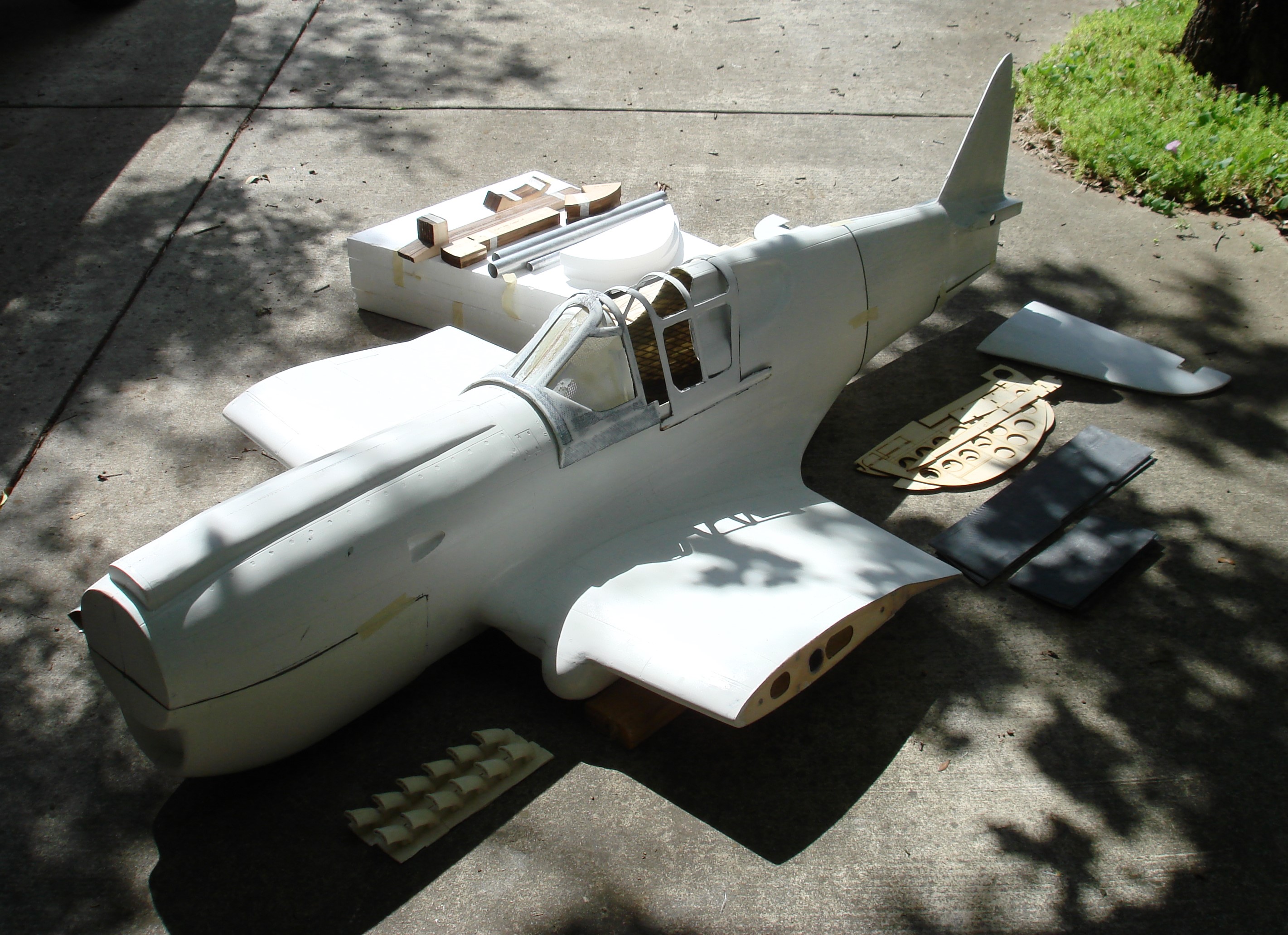

This is the new P40E Warhawk kit. I made a new carbon fiber canopy kit (see previous post) to replace the one on the fuselage. I am fabricating the horizontal stabs, and sometime next week will post a picture showing the complete kit.

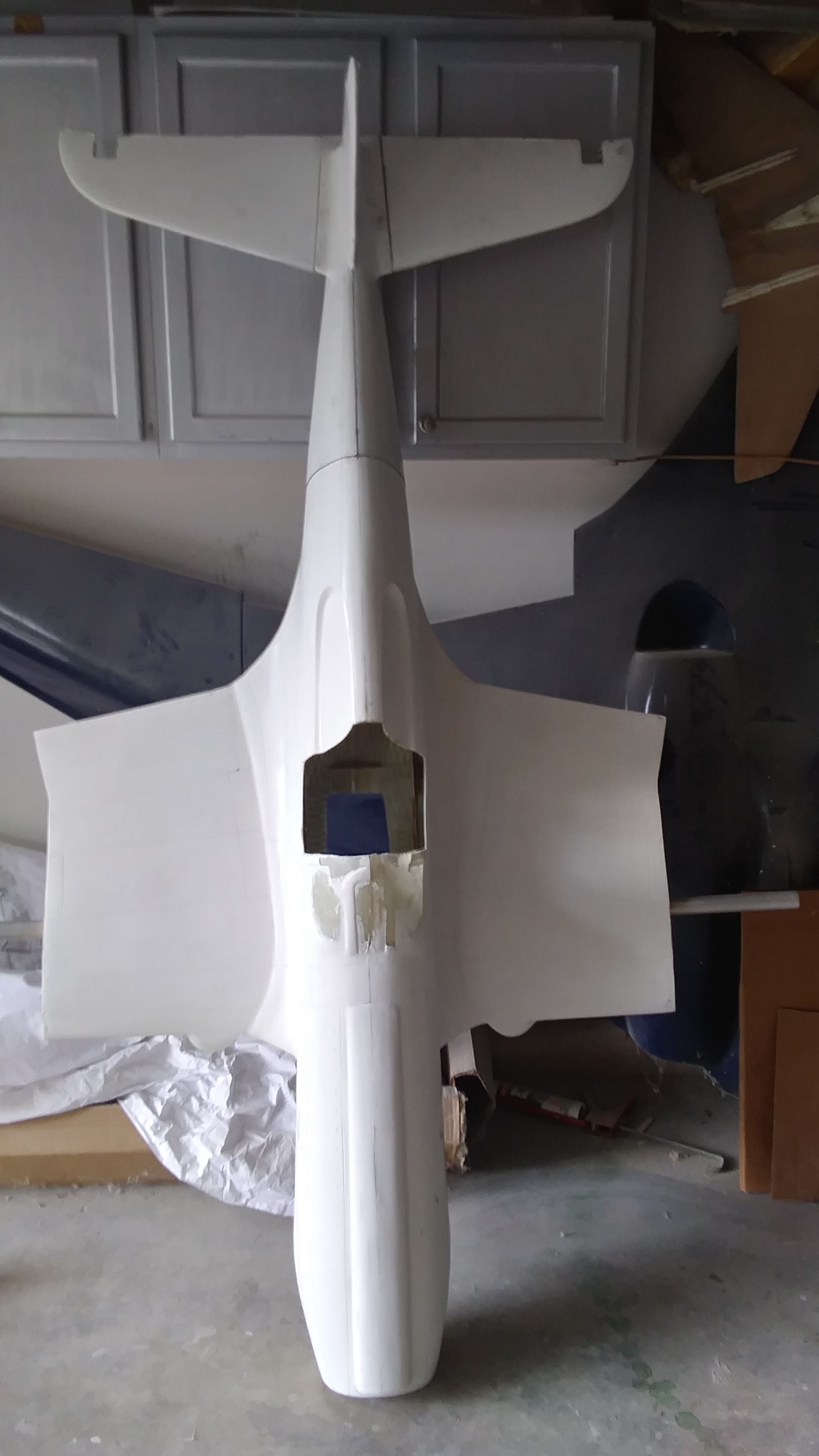

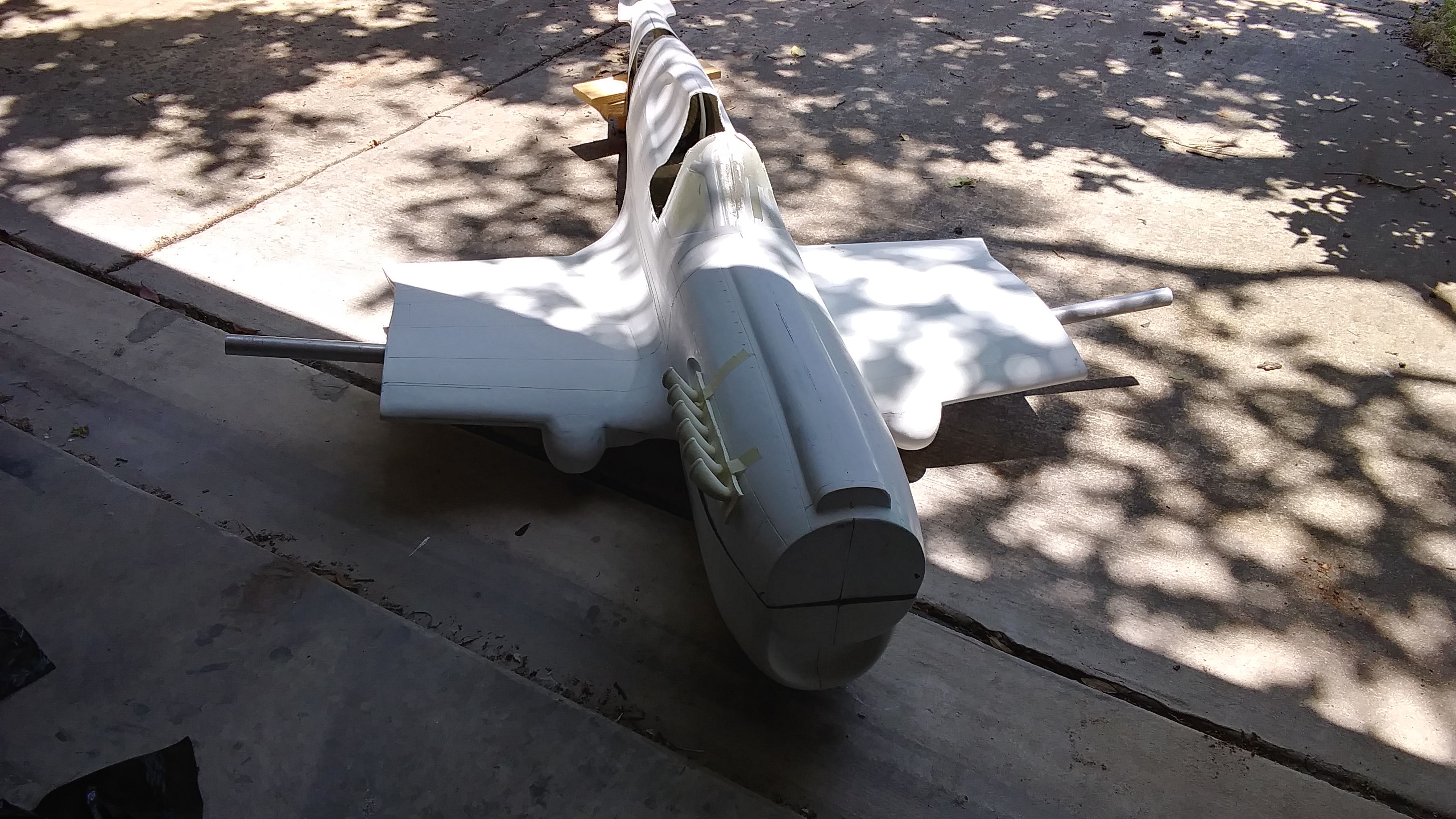

Blazing Wings

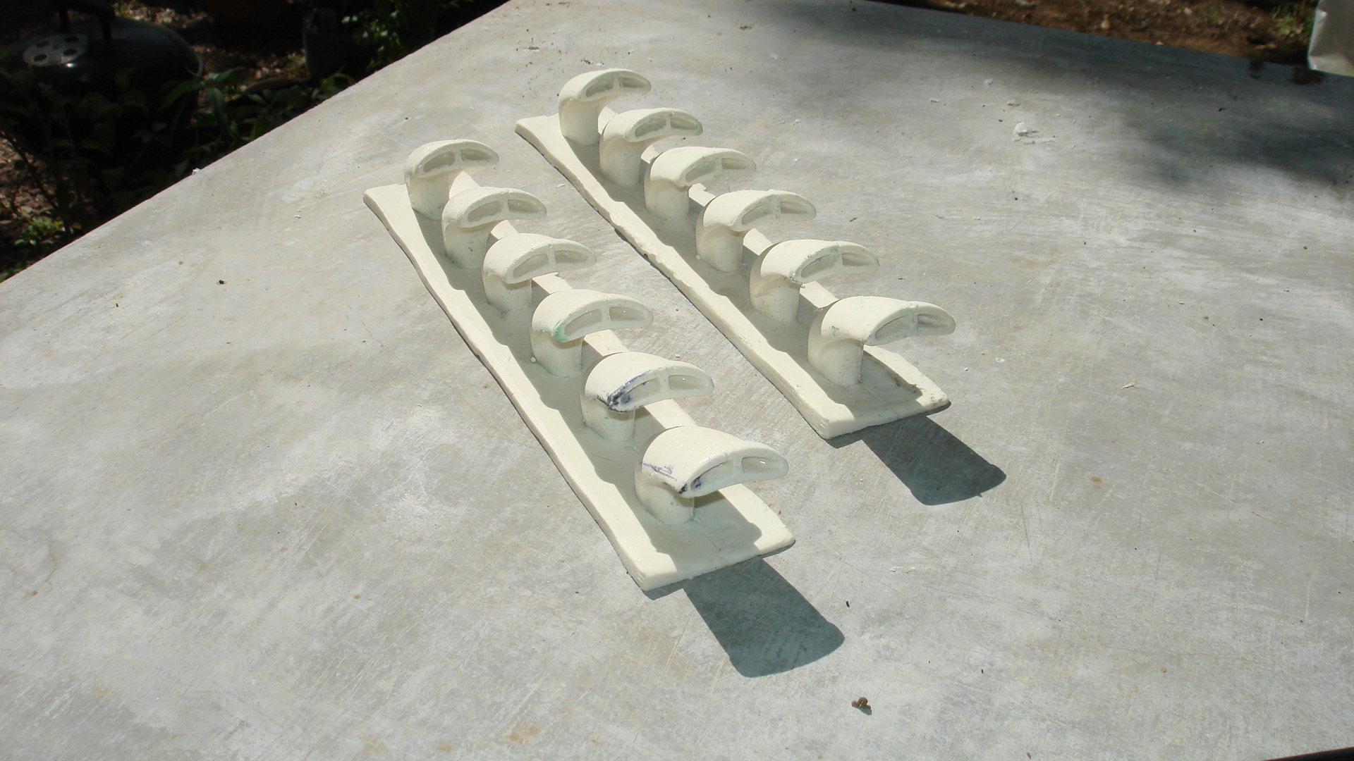

I had to see if my exhaust stacks look good on the plane. I think it does. It will all come together once painted and on its legs.
Note: The stacks will be attached from the inside of the fuse of course. This is just for show.

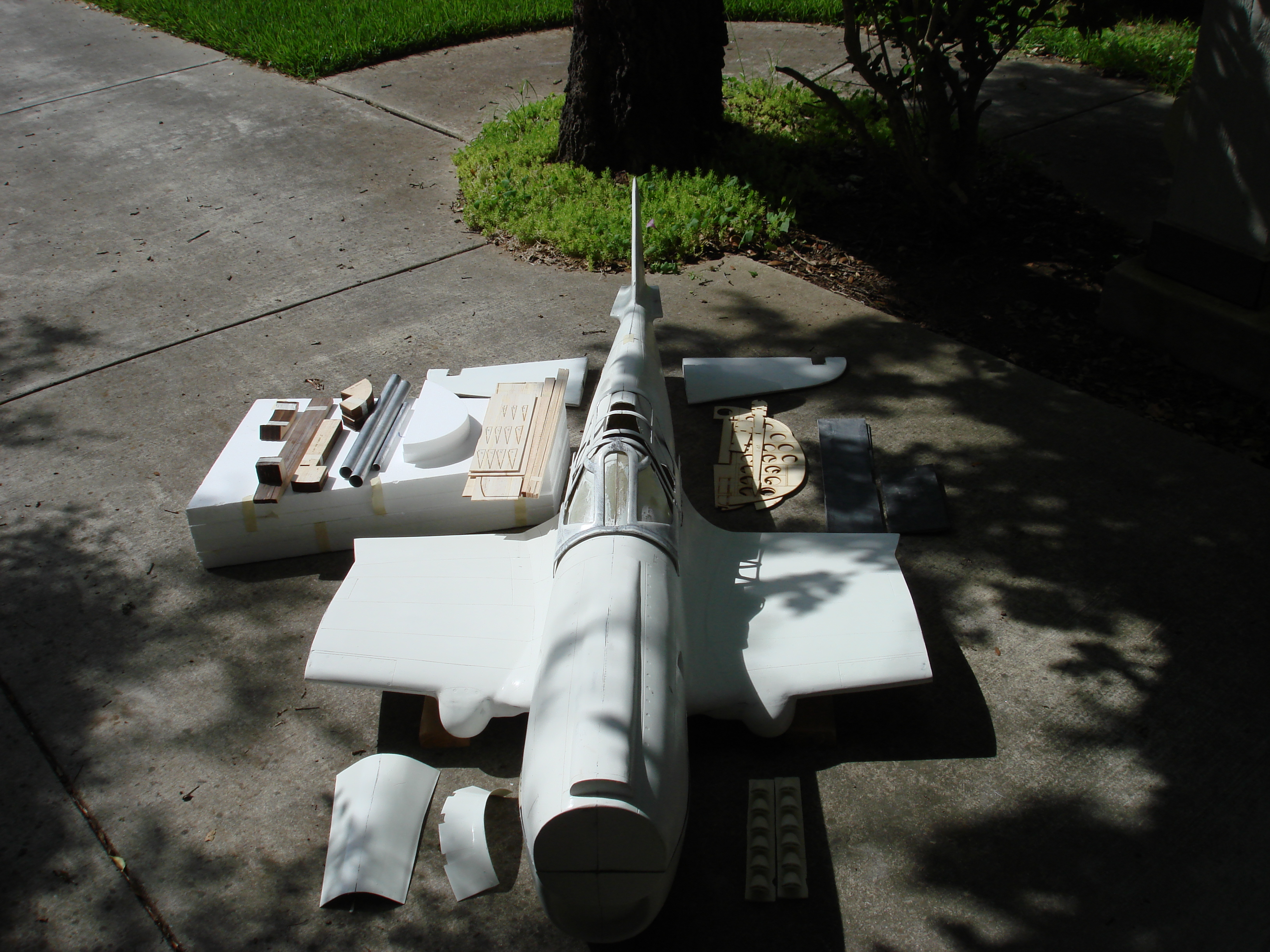

So here is a picture of the complete kit and what is included. The carbon fiber main spar is already glued into place. as well included are ailerons, elevator and rudder and wood to complete building those parts. Foam core wings and tips. Exhaust stacks, belly pan, cowl, removable horizontal stabilizer, wing tubes and stab tubes, carbon fiber composite flaps, carbon fiber canopy.
