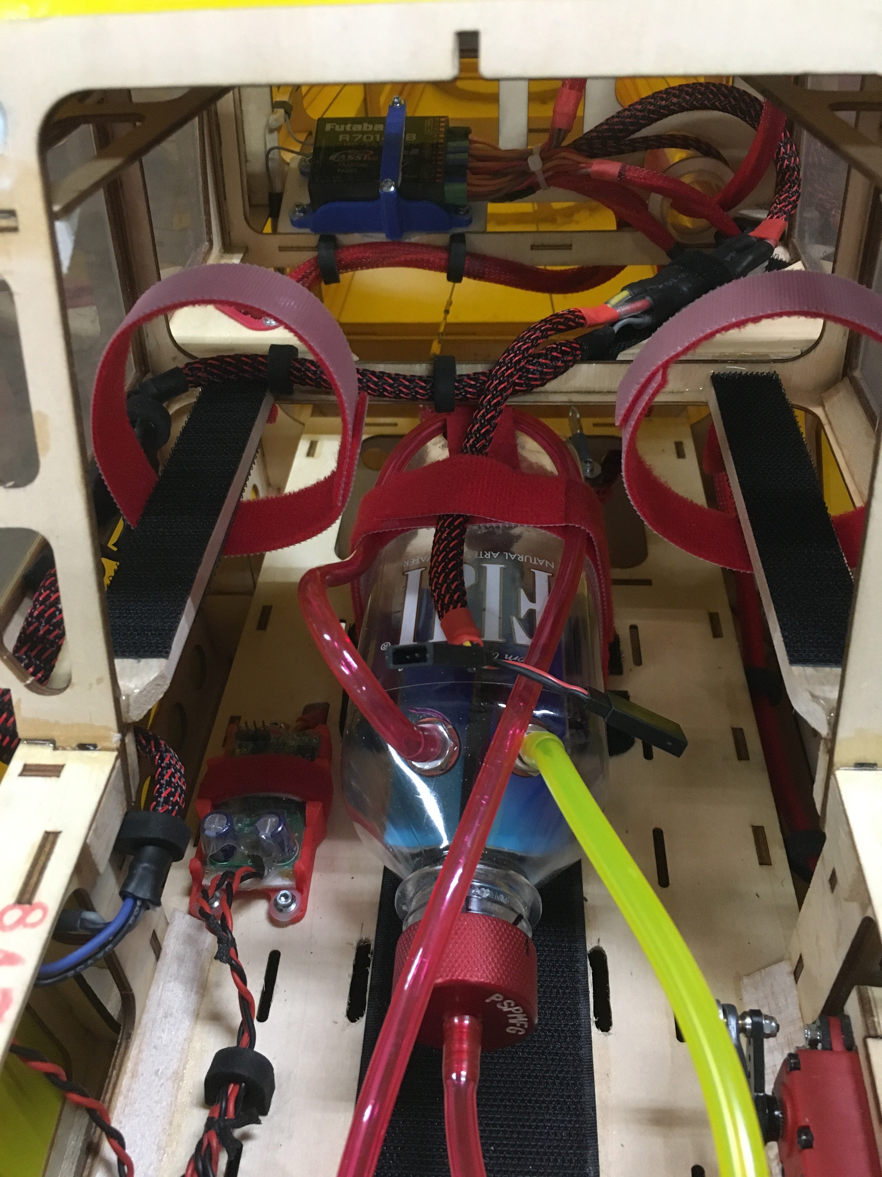

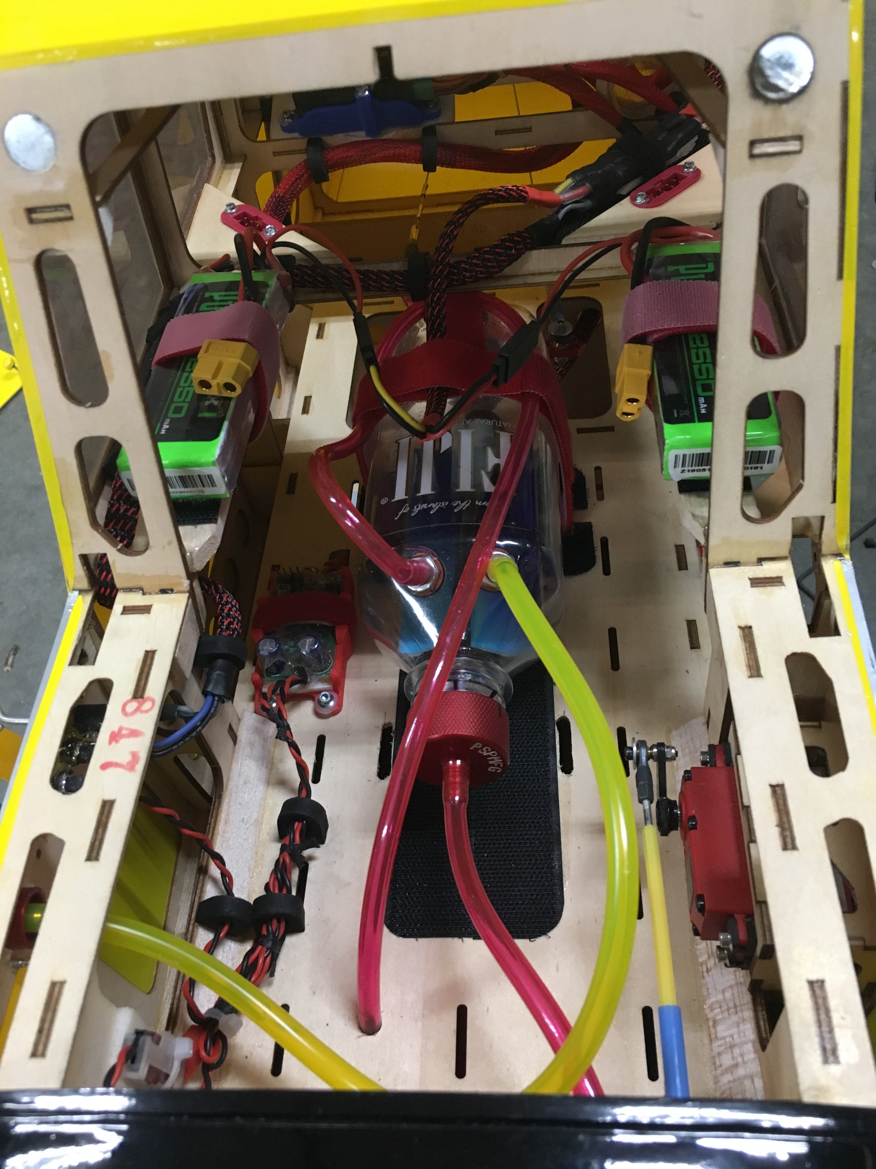

Airborne it was nose heavy, nine clicks of up elevator. I later added 1.5oz of sticky weights in the tail and lowered it to seven clicks of up elevator. I'm thinking of moving the fuel tank aft to where the batteries are and maybe put the batteries next to the tank sides. With a half a tank and the sticky weights it's balancing level the aft side of the wing tube. I think shooting for 1/4" behind the wing tube would be ideal.

2x Pulse 2250 2S batteries w/TechAero direct via Booma pin flag switch... After four ten minute flights both batteries were at 7.8V roughly 60% capacity left. I think that equated to a little less than 400mAh per flight. A lot like my 35cc 3D birds.
