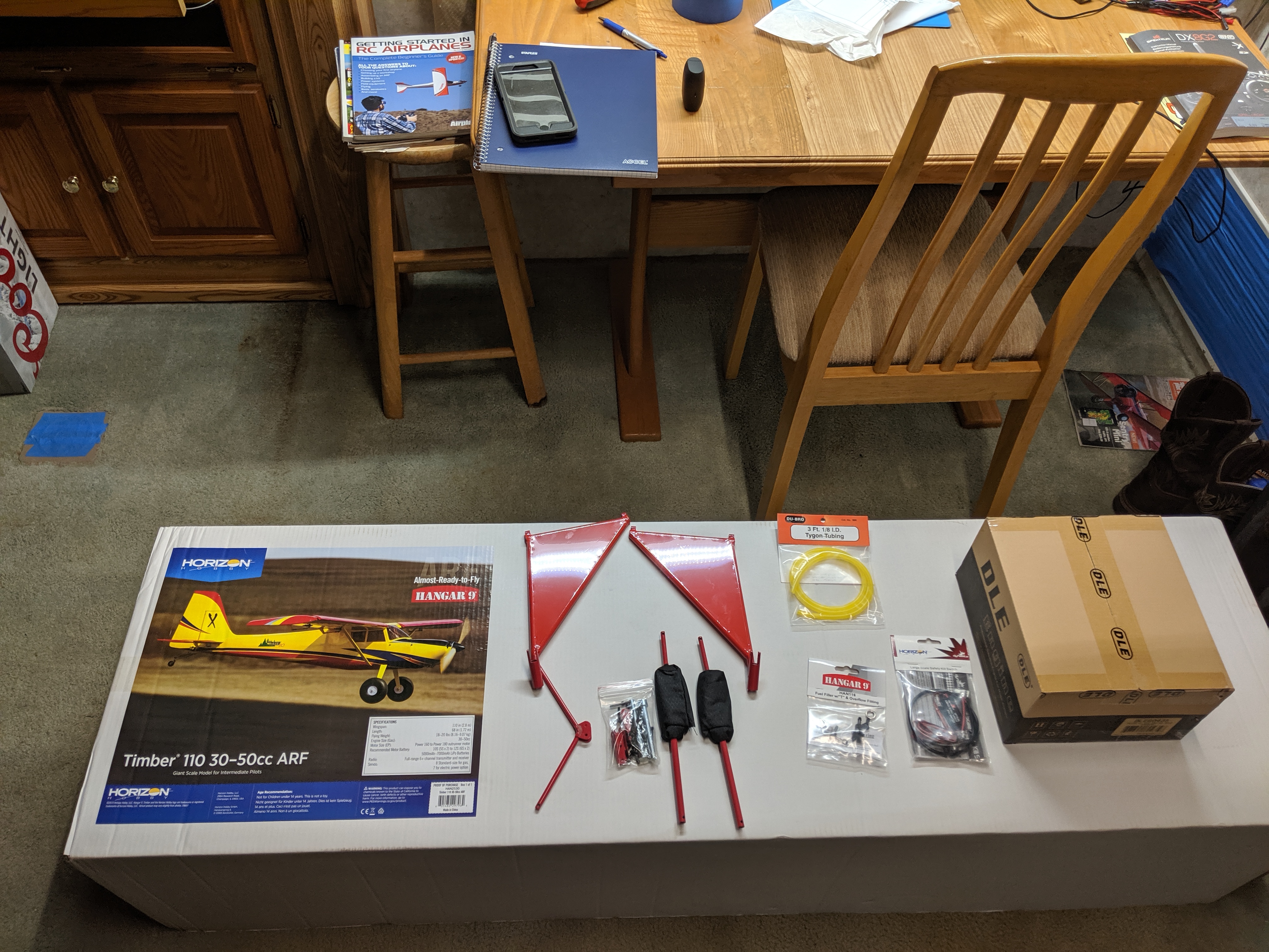

We'll gent's, it's here! Went through and looked at everything. Looks really good, no canopy crack, foam on bottom of fuselage isn't broke. Definitely going to go through it with some CA and ensure joints are glued. I've got a few really loose joints, 1/8th inch gap at least! Gonna do some mitigation and add some braces. Sent my sprung main off to the sand blaster, will paint it when I get it back. Hardly a single wrinkle in the covering, pleasantly surprised.

Glad to hear it survived shipment!
Note there is a bunch of tristock included with the plane for the electric motor mount to use for bracing the gas engine.
