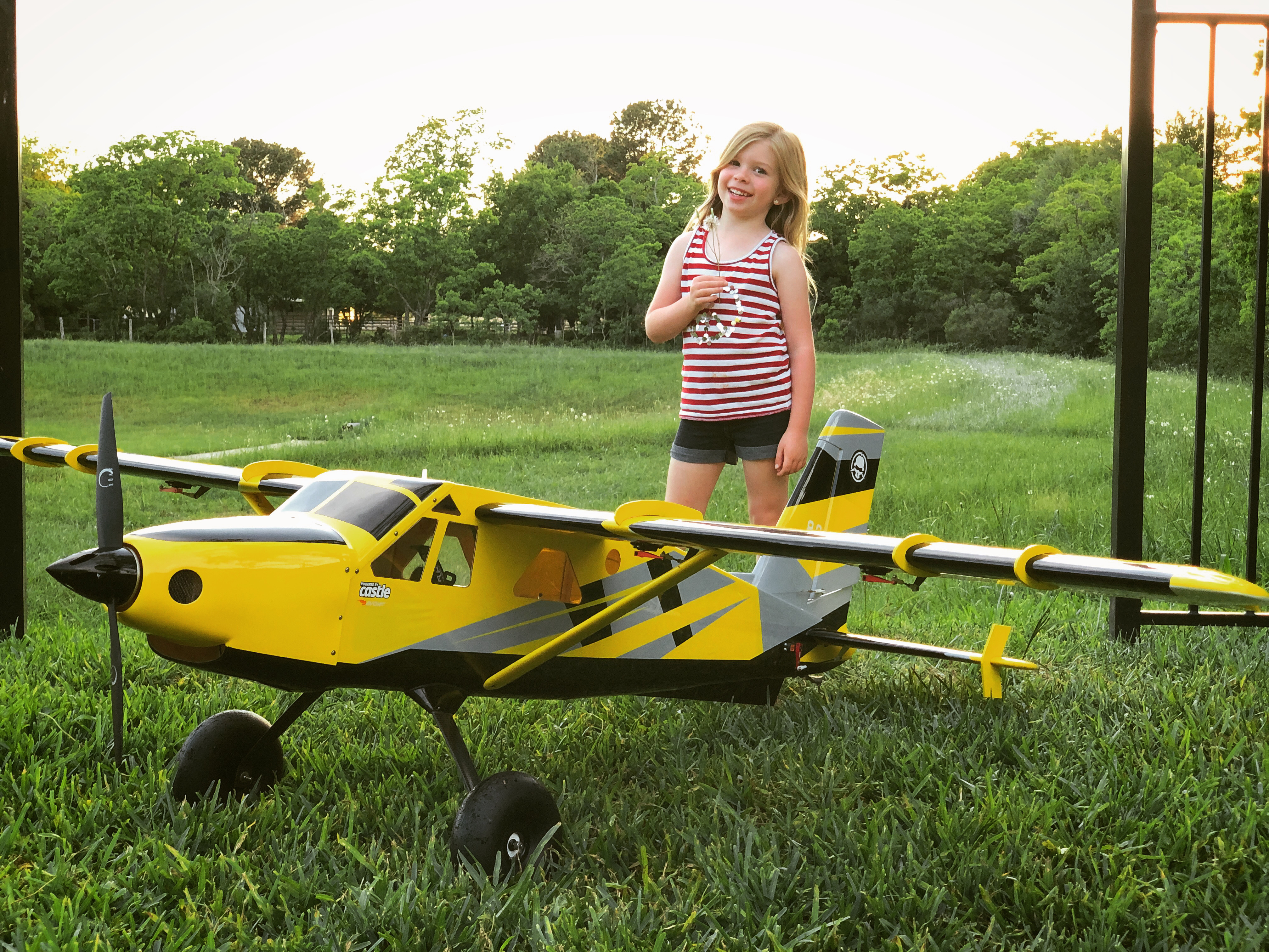

New here, guys! I just finished getting to the end of this entire thread. Read it front to back in order to not miss anything. I have ordered my Timber and hopefully she will arrive at the LHS end of this week. I am probably going to go Electric, as this is what i know from all my other planes (8). This one will be my biggest, but my latest plane (had her a year now) is the 84" Turbo Bushmaster which is my baby! It flies SO GOOD and I have it setup with bush wheels since i fly out of a detention pond behind my back yard. It seems like the Timber 110" is built and flies much like the TBM does, but I am interested in the larger wing and ability to put articulating gear (I have the Xcub gear ready to go) and also I ordered the 7" Airtop wheels to slap on them. I love flying 3d, but also LOVE bush/STOL style flying as well, so the Timber seemed a good addition to my TBM. I will need yall's help I am sure thought out the build.
AKNick, I have watched your videos many times of the Timber and didn't know it was you until I got on this forum! Good stuff man! I am planning to use the Xpwr 40cc and the CC120HV ESC. Question, with my TBM I have the CC Talon 90, running the Savox SV-1250mg HV servos directly from the ESC with built in BEC to a Crossfire diversity RX running at 8 volts. Is it possible to just power the servos on the Timber from the CC 120HV ESC as well?
Just for fun here is my current baby I am flying, before the Timber arrives.
Cheers, guys!
-Clint

Thanks for the kind words! I also have both planes. The 110 Timber flies and floats great... especially with those huge flaps! I'll be putting on my LE slats this summer as it sounds like it alleviates the wing tip stall I've seen with mine and will mush the tip stall. With the plane so heavy like mine, I believe it will only be a bush plane. I don't trust the wood for violent 3D based on some reports I've seen.
@Snoopy1 went electric as I'm sure you saw. I dont think most speed controls over the Talon 90 have an onboard BEC, you would have to use a ext rx battery like that of a gasser.
Ahh, ok. Gotcha! thanks for the info. So since you have both planes, which would you say is your favorite of the two to fly?
@Snoopy1 been following your build. I think i am also going with the Xpwr 40cc motor on mine. I will be VERY interested to see what you think about it and how much power it gives for certain 3D type flying with it. What BEC did you go with to power your RX and Servos? and what size lipo did you use with it as well?
Thanks!
Cheers!
-Clint
