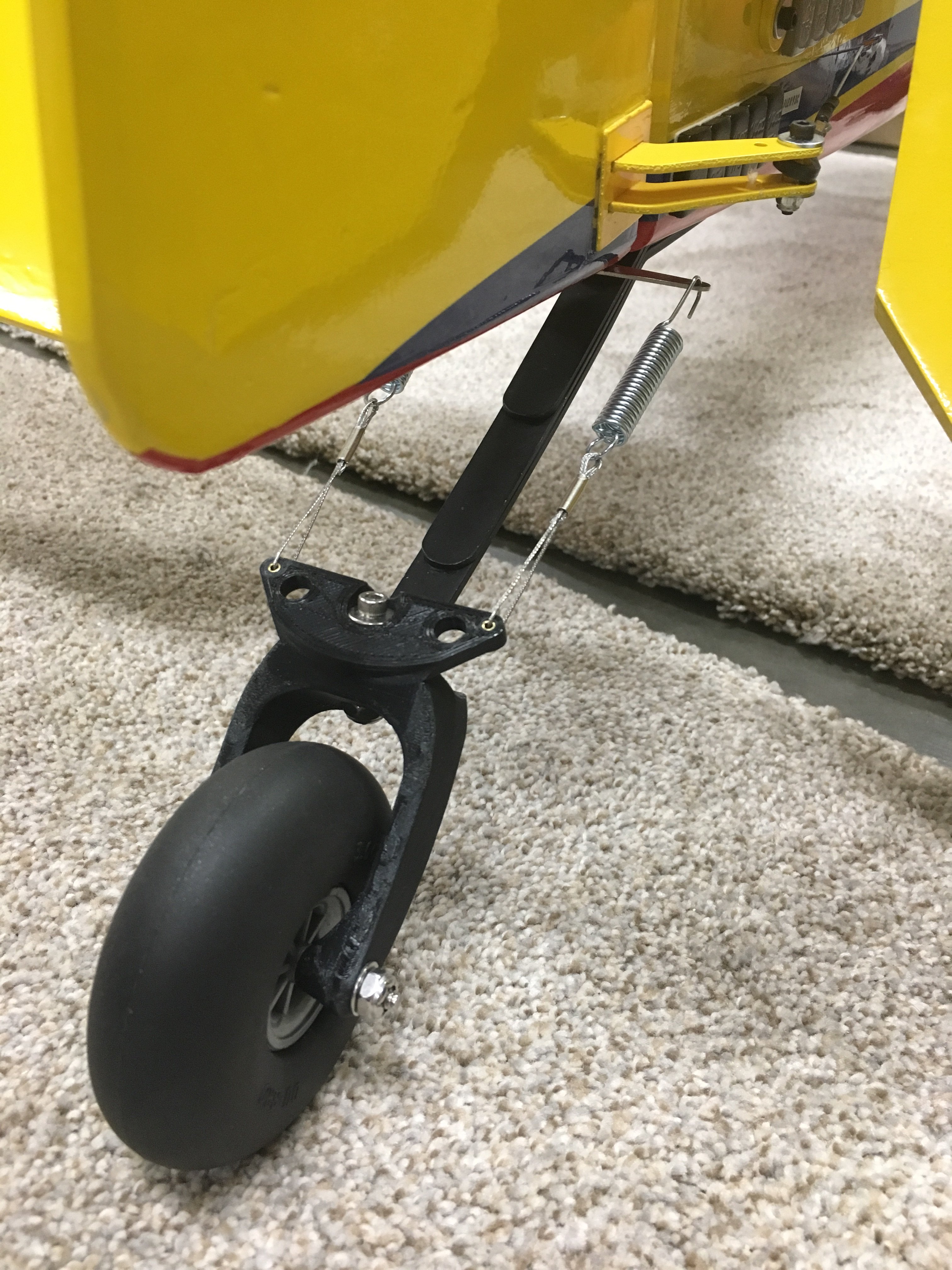

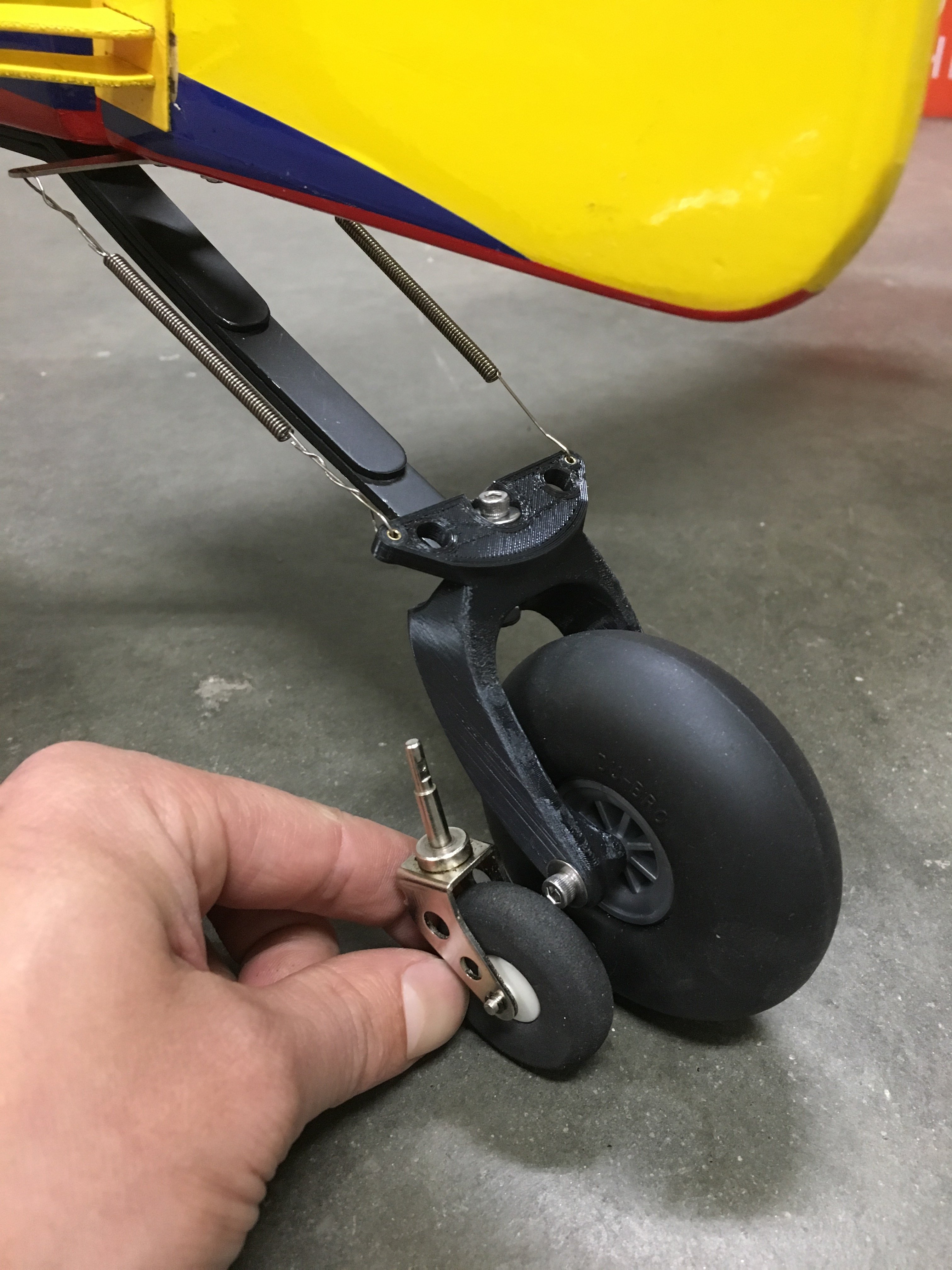

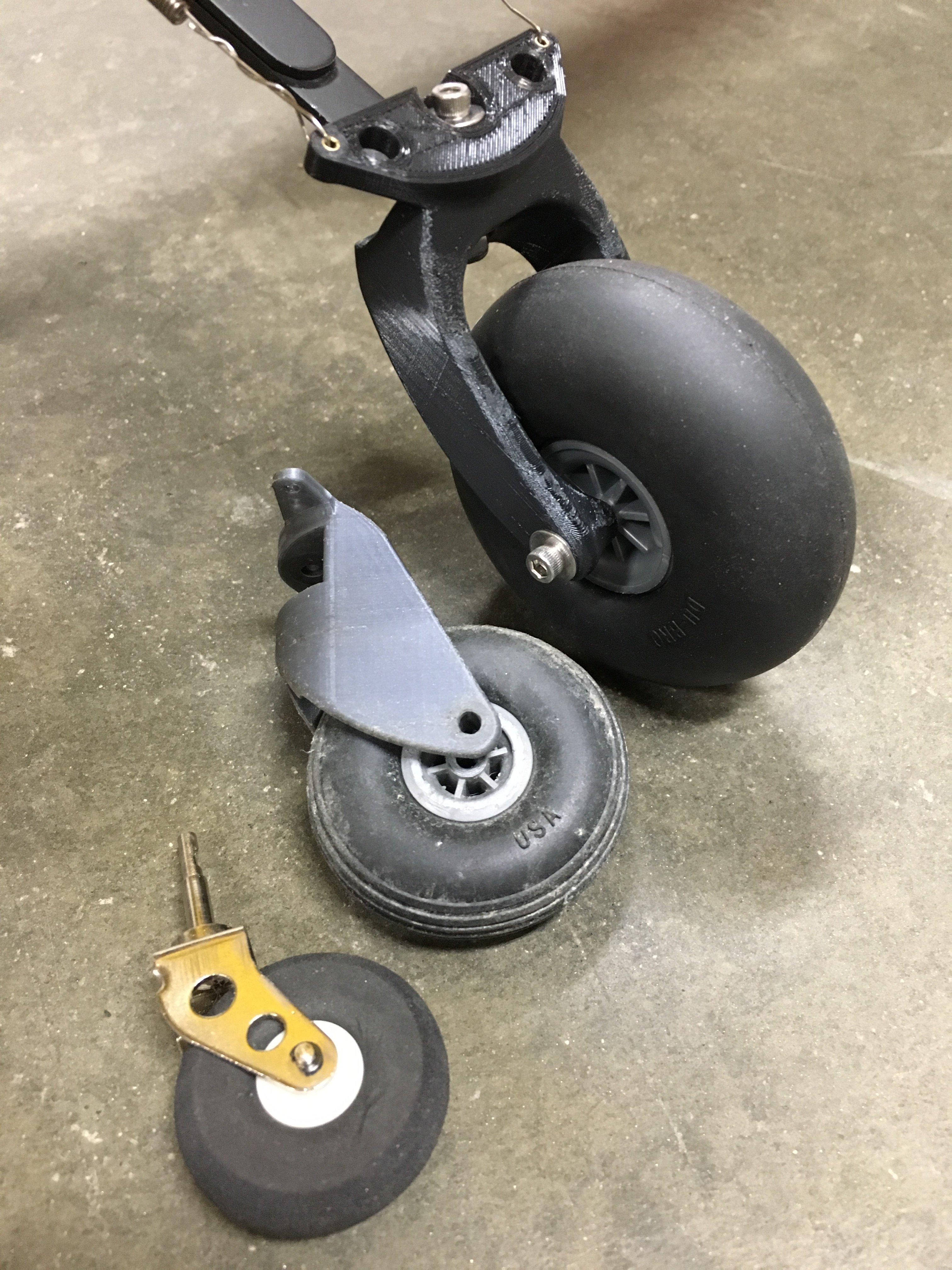

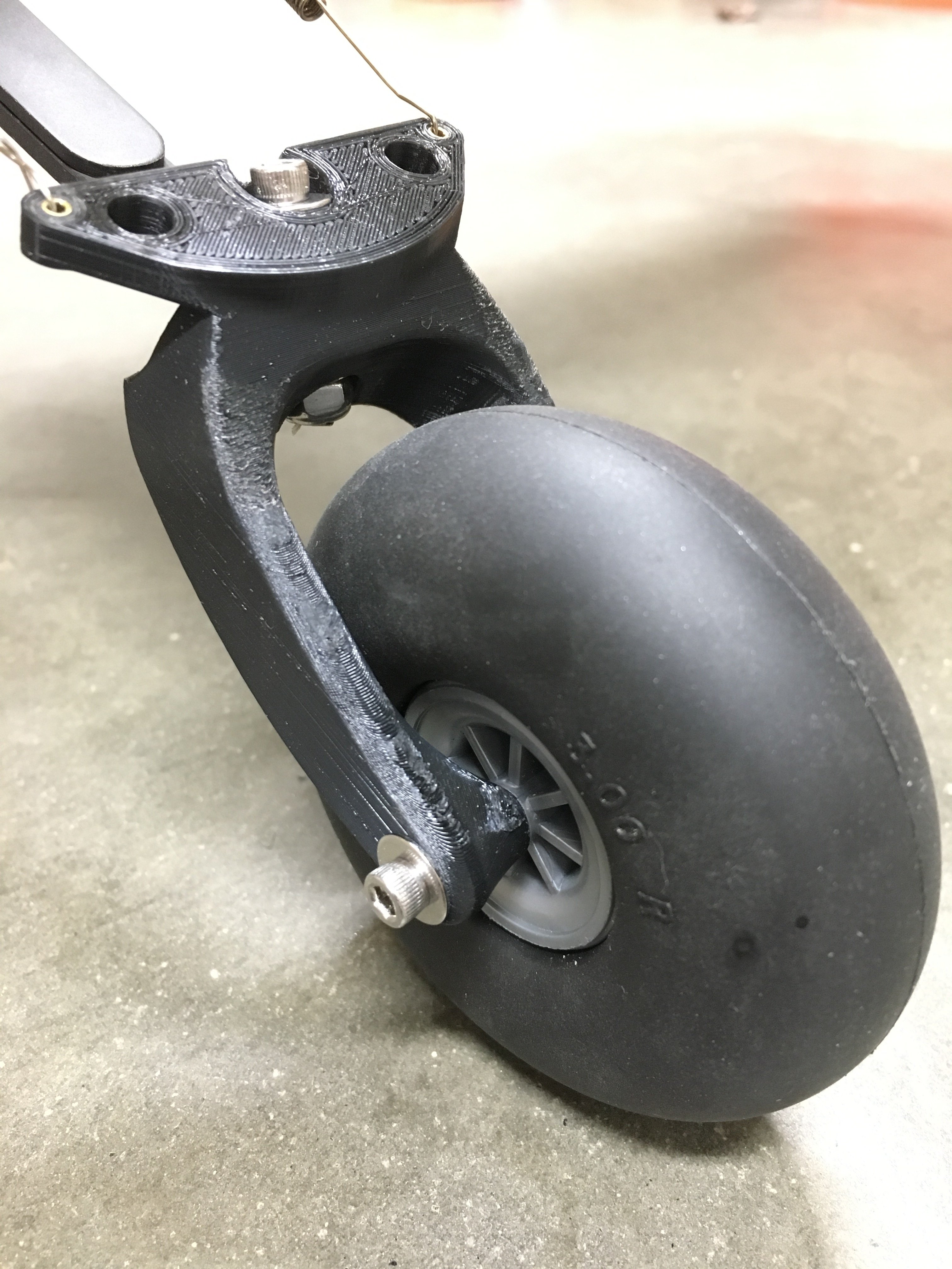

Got my tail wheel fully mounted. Except I’ve bent the spring so many times it broke. I’ll need to replace it. I think the moment of the tire in relation to the pivot point decreased its rotation. May need to change that. Other than that I like it a lot.
2.5oz more than my other design overall. The original tire looks pewnie.

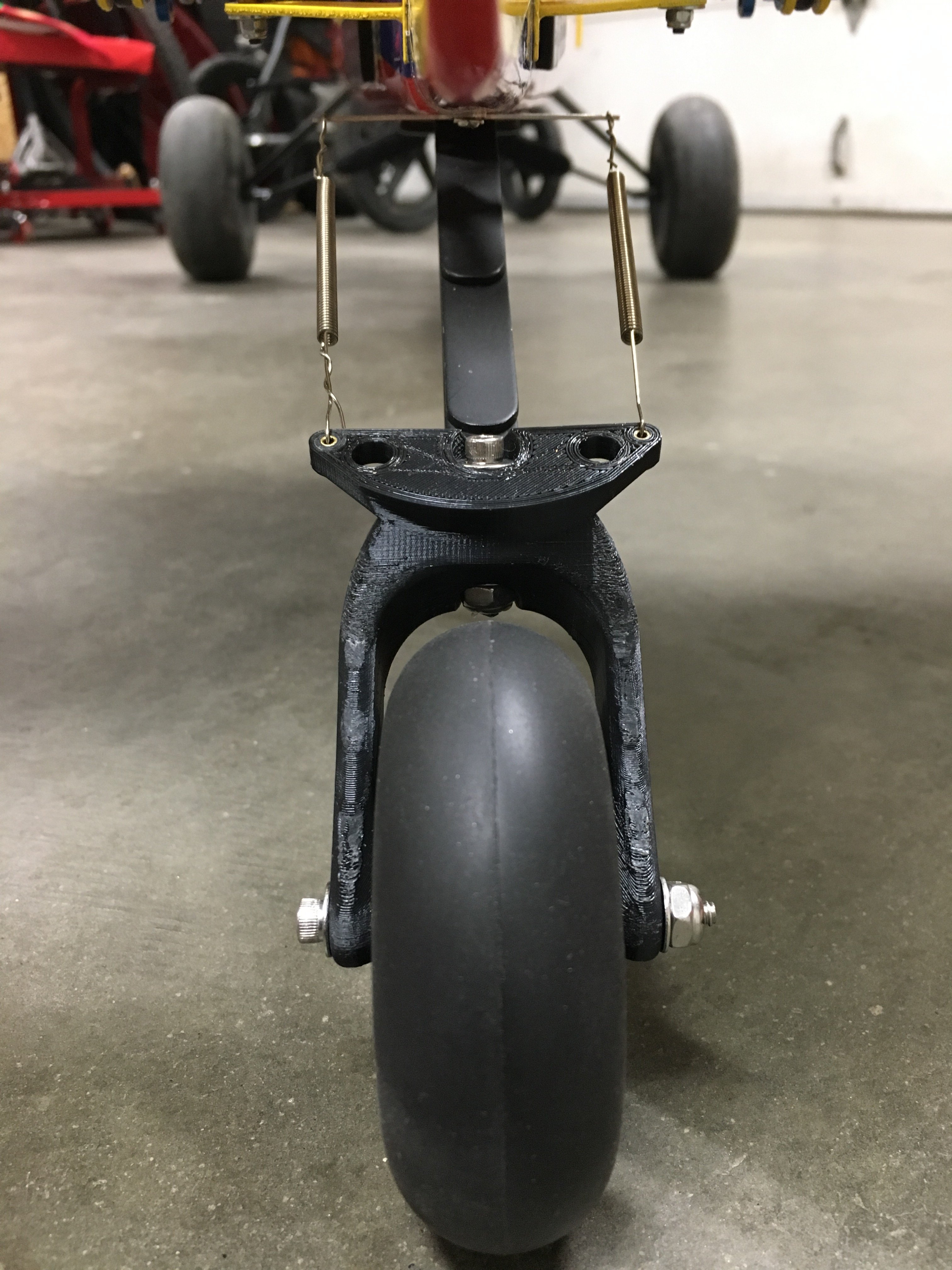

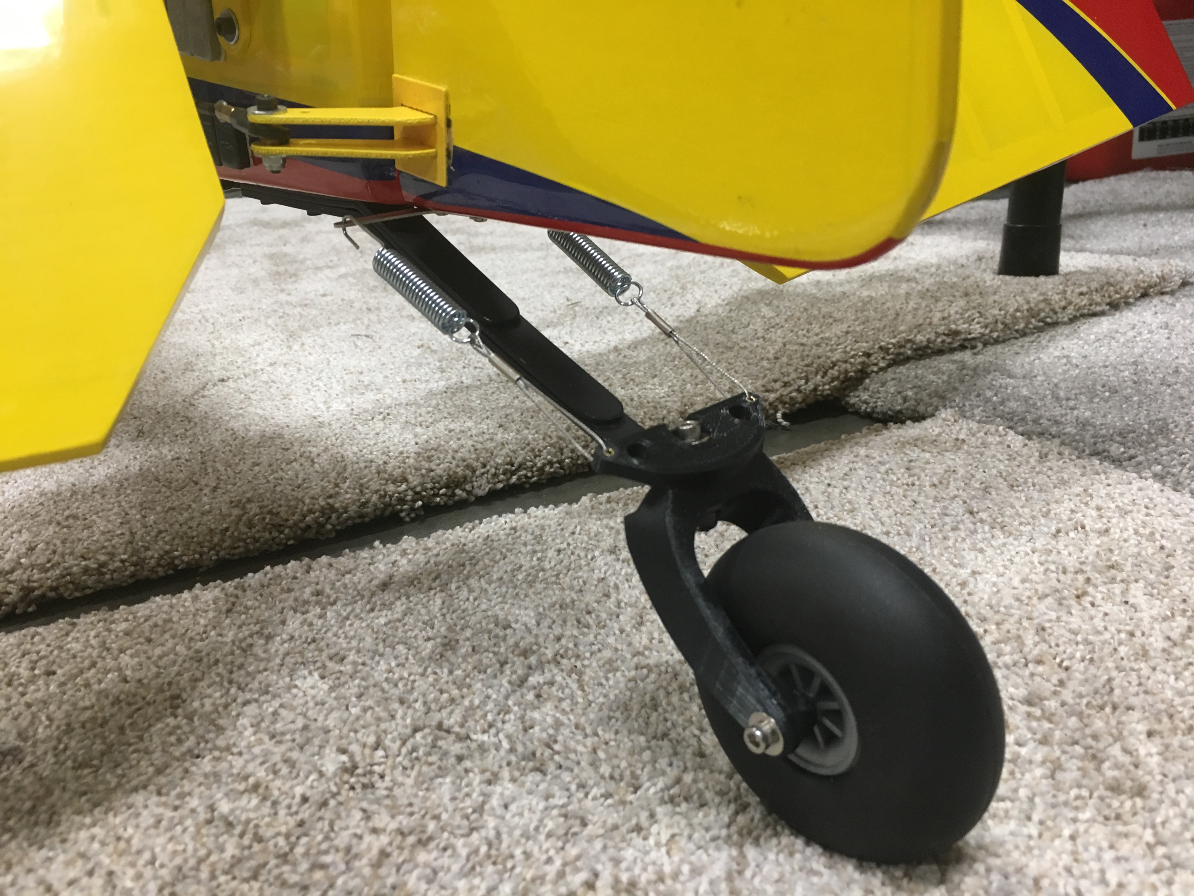

@AKNick have a question just received my new Tailwheel from HH and again they sent me Tailwheel only 2 spring leafs and the one on the plane is only two leafs. Yours shows three, do you think I need three leafs.
AKNick
Sounds like you have four now ha ha ha.
If your going to plop it down like I do, maybe so.
I don’t think you are going to flatten it out with just two. I like the extra rigidity.
If it only comes with two I will try it, but it looks really soft. Time will tell, just have to wait for spring.
