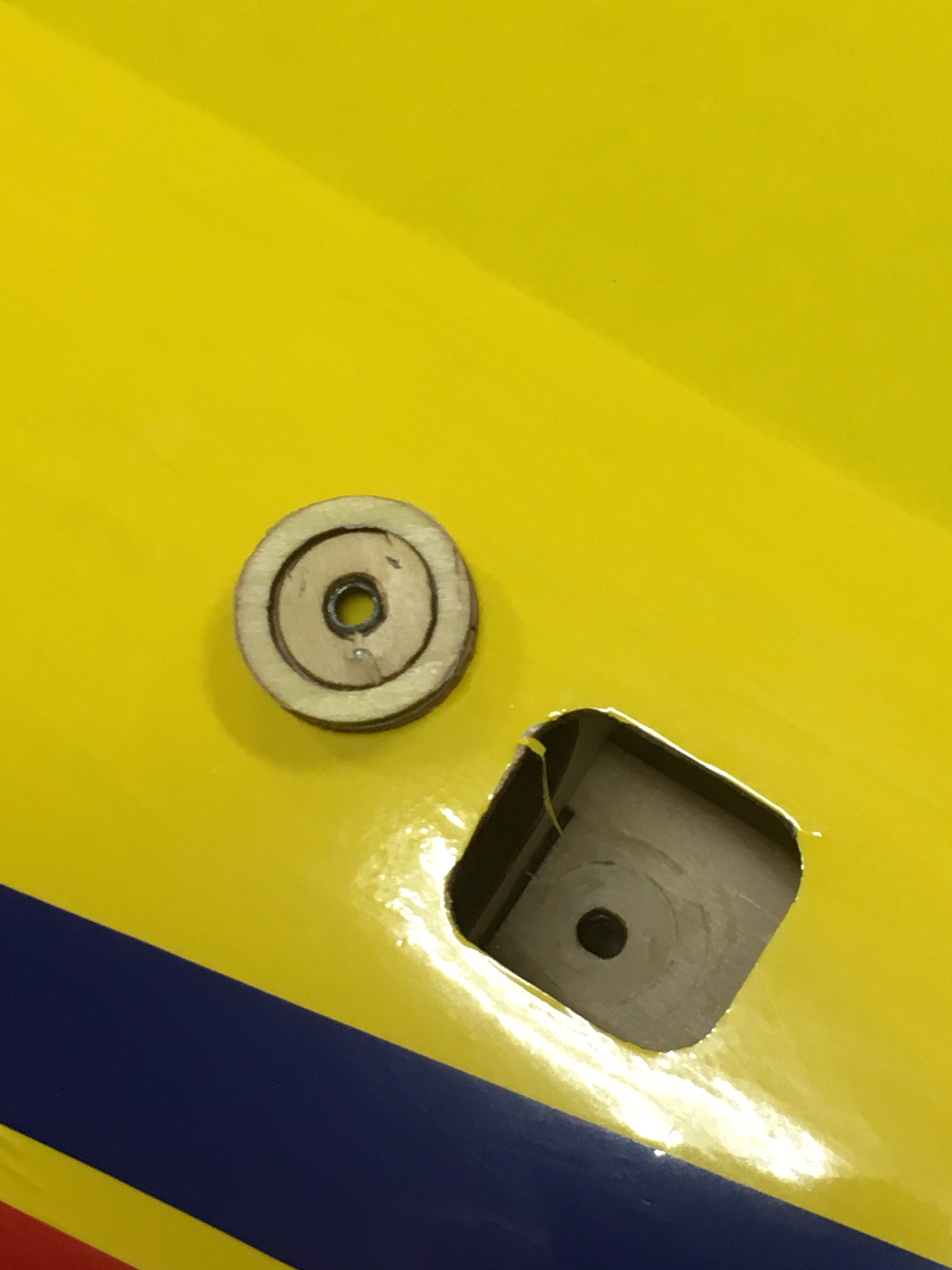

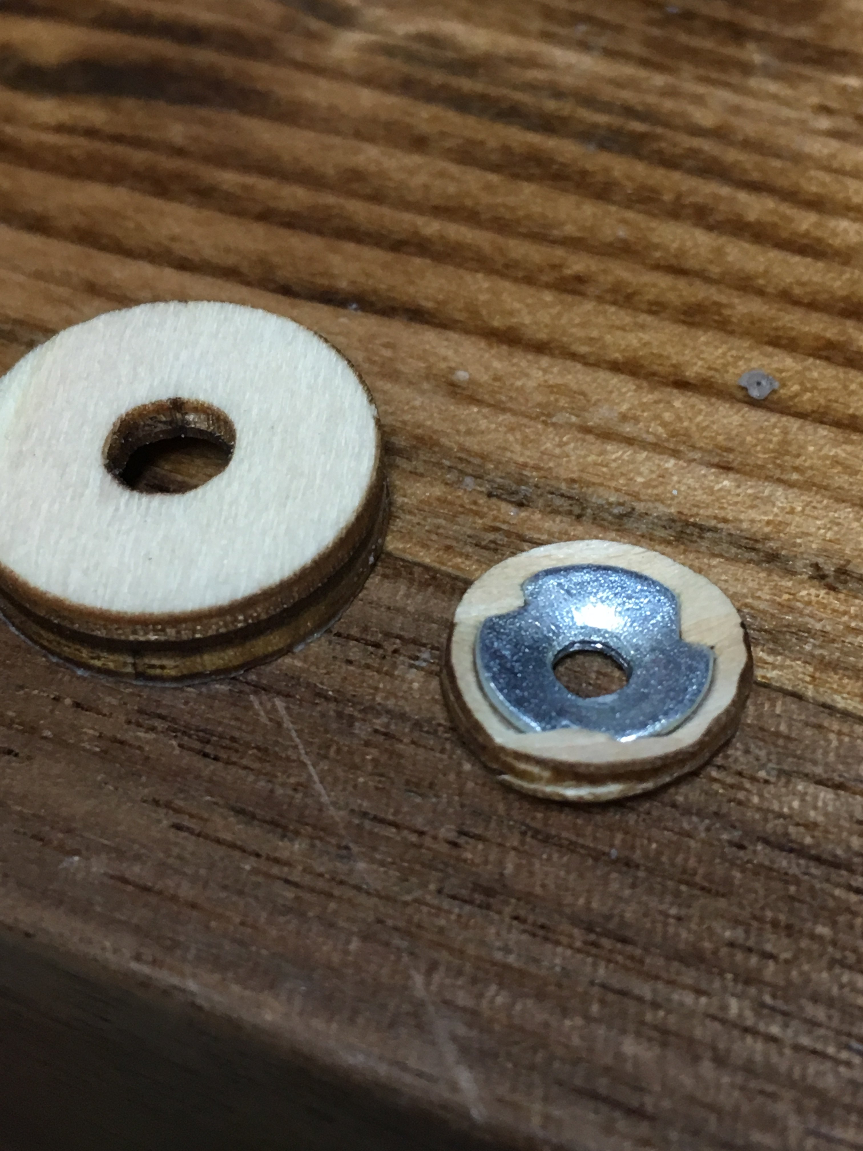

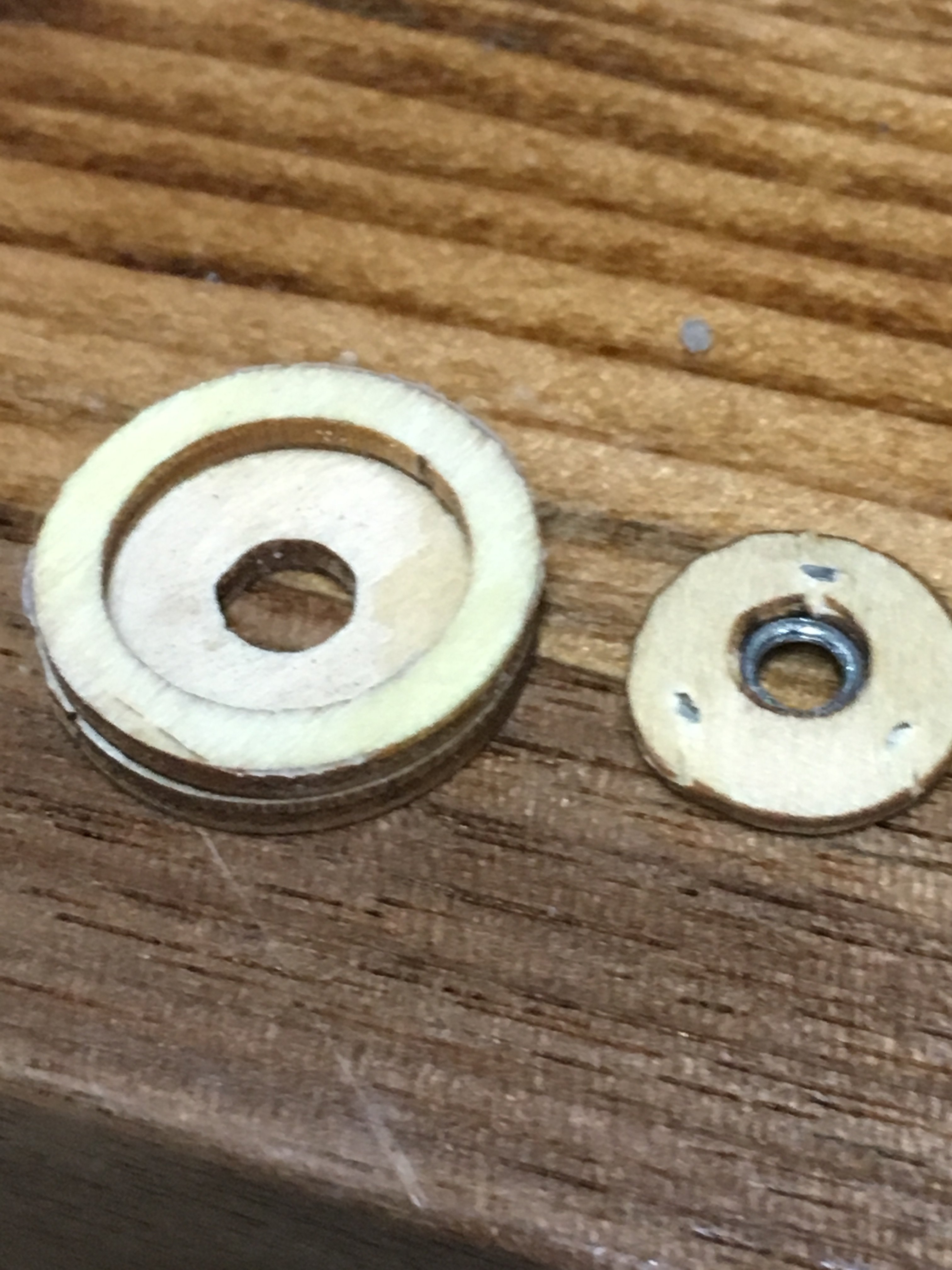

Here is why the wing strut blind nuts fail in the wing. Mine sheared. And there appears to be about zero glue.
