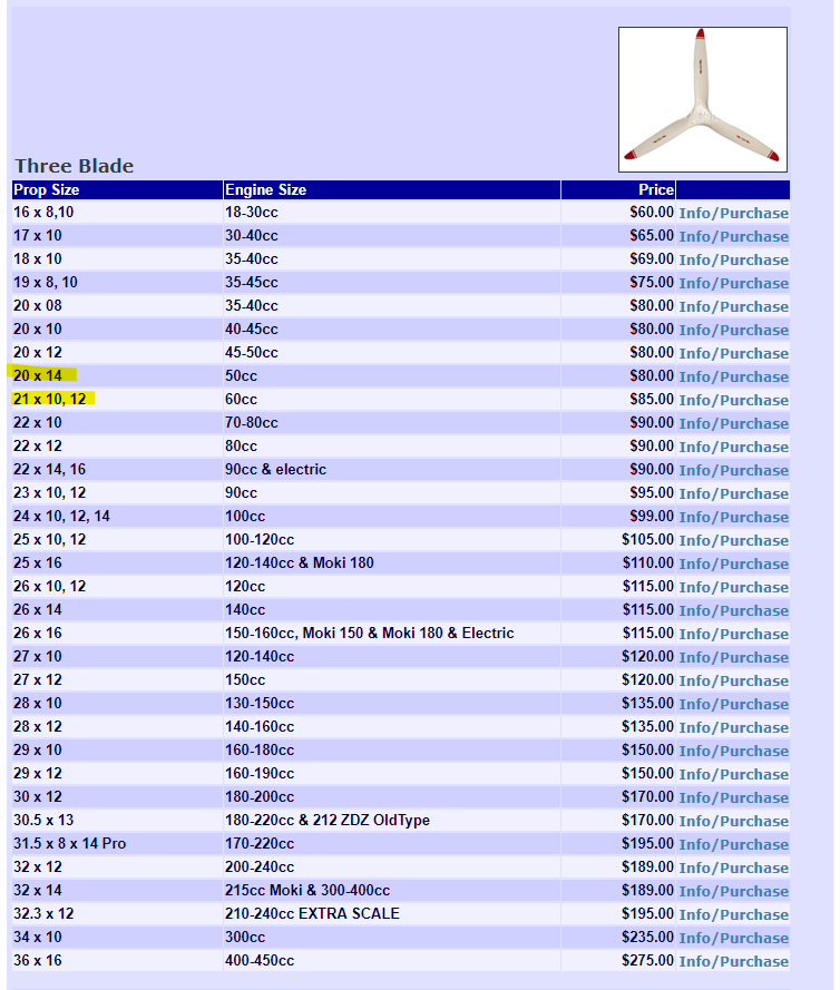

Maybe this is a little on the crazy side, but I am tempted to give these a shot... 20x14 seems to be nice to go STOL, but 21x10 may be an conservative start?
(FYI: I'll use a 2-blade 22X8 while getting used to the aircraft... this is the recommended break-in propeller as well.)

What I have found when switching form a 2 blade to a three bladed prop, to achieve some where close to the same in rpm and torq, go down one in pitch and one in diameter
Wild man,
Good point, seems like all 3-blade props got a pitch at -10 or -12? if I spin a 22x8 now, the logic choose would be 21x7 right or am I mistaken here?
Wild man
When I was messing with props for my EME 60 cc I ended up changing from a 22x10 to a 12x8 three blade You can equate diameter as torque and pitch as speed you are right. Every pilot likes different values when choosing props. When doing 3D I do not use the same prop as in doing precision aerobatics, or racing
