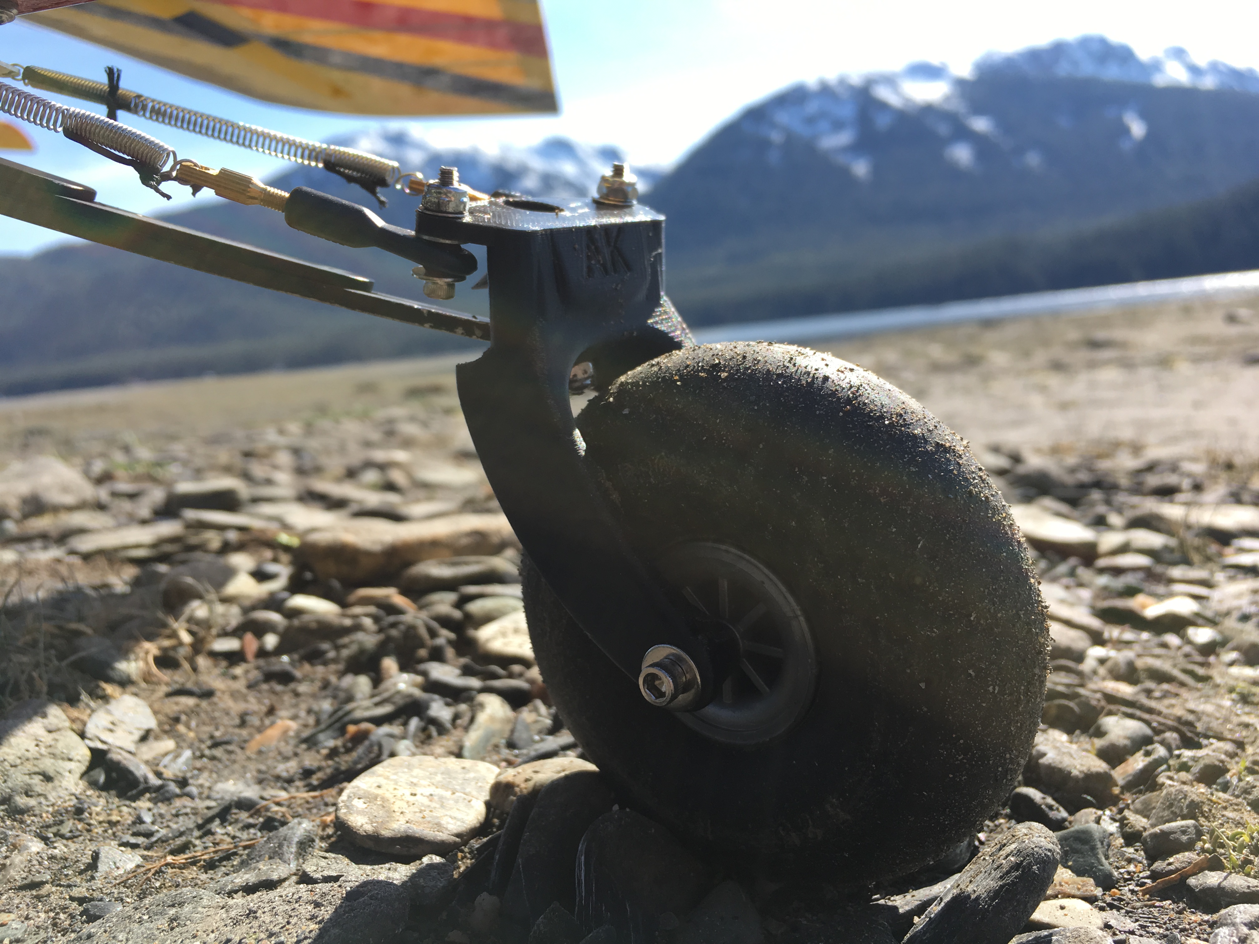

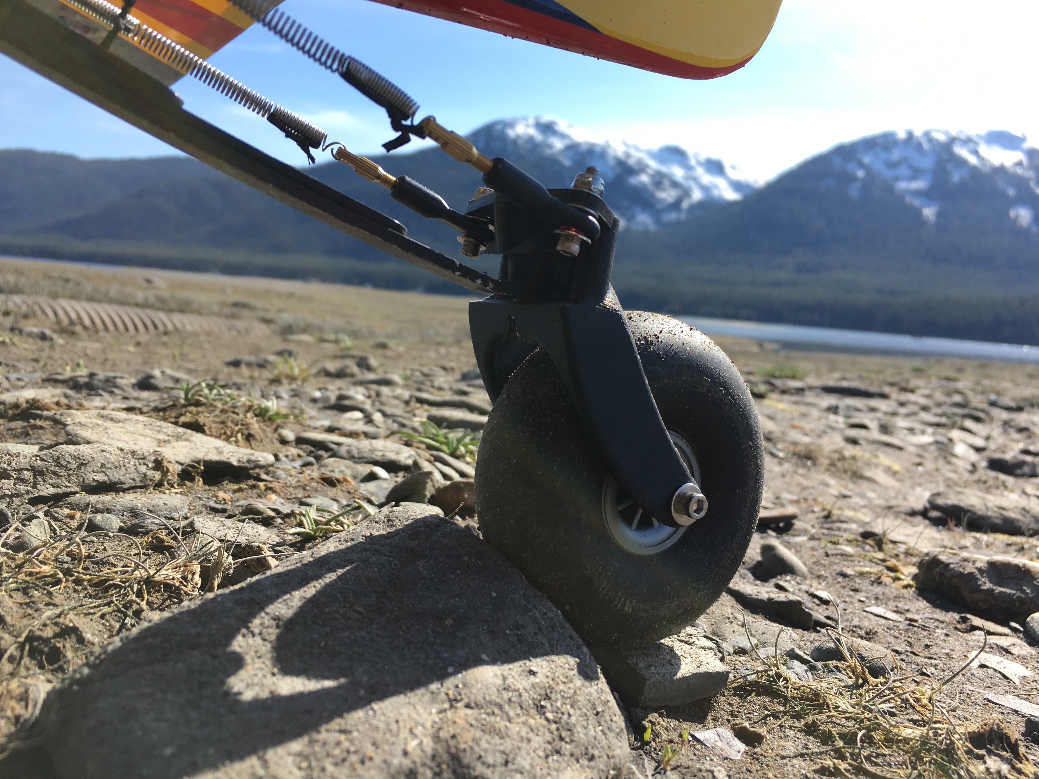

Thanks for that info. You aren't running the Xcub landing gear and the upgraded bush wheels either, right?
