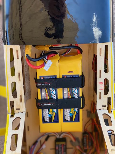

Snoop..haven't weighed it. Today was a day of firsts! First model with span greater than to70" or heavier than 8 pounds. First 12s setup (8s max prior). So much fun! Hard to get a final number on flight time, but with touch and go's I was over 10 minutes. I use capacity alarms instead of time.
Only a couple clicks of elevator trim needed. Zero aileron or rudder! Manual was very close to amount of elevator compensation needed. My only gripe is the stock gear. I made a few plunker landings, but nothing I would call 'bad' and they are already bent. I have the sprung xcub gear -- so it is going it. I may try to see if I can make the stock tires fit on them temporarily. I'll probably go with either 6" Dubro or 6" Airtops...still need to figure out what is going to fit on the xcub axles.
Max amps was 73 today. Motor and batts stayed nothing more than warm, and it is 100 degrees here today. Very windy today, so the first flight was sporty -- but then I turned my gyro on and it does it's magic! Very room in the cabin...these are Zippy 6s 6200 Mah.View attachment 115195
