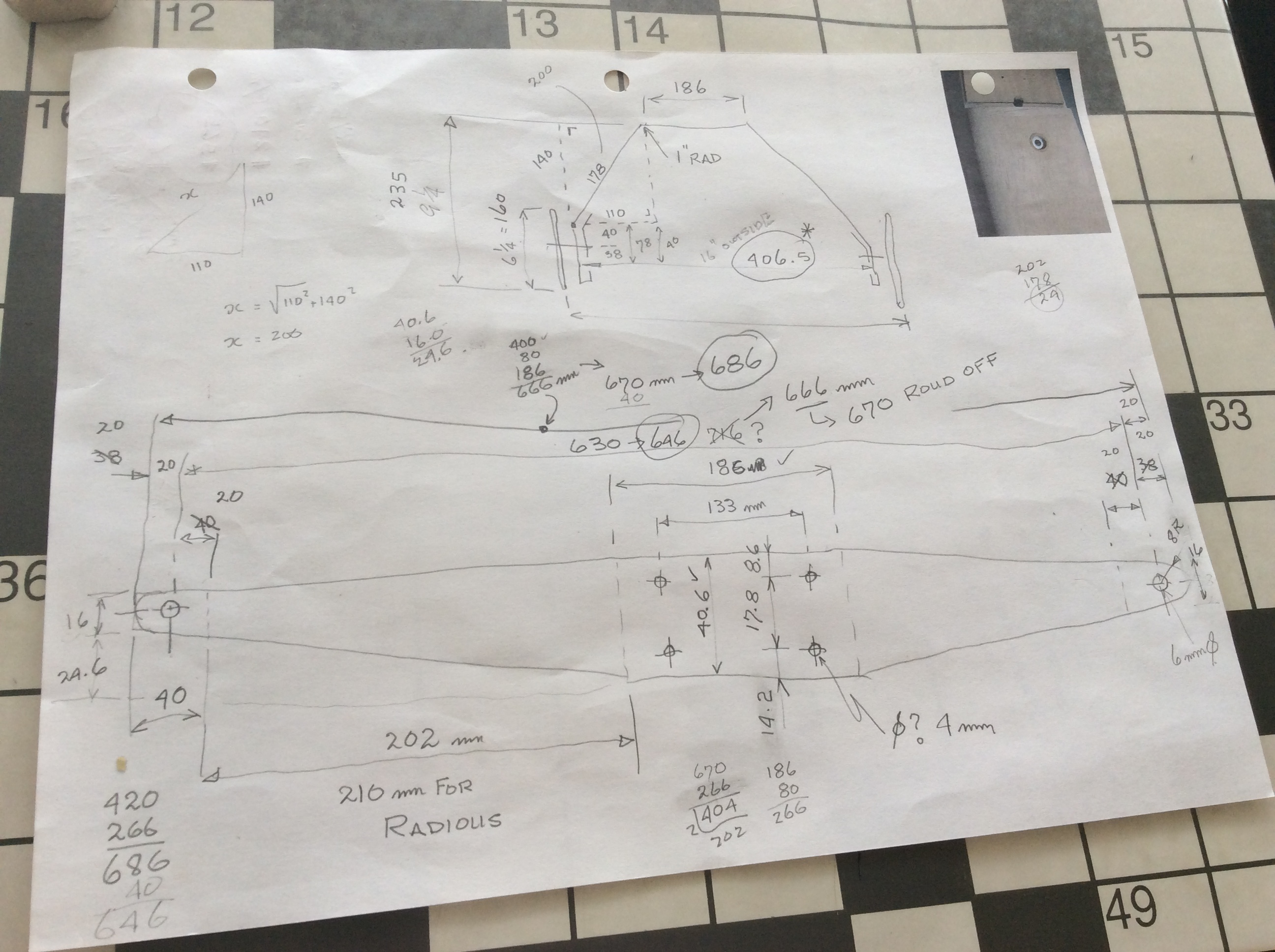

Thanks to @RC80AK the planning of the new gear for the Timber is almost done. Just a need a couple of dimensions and need to do cad drawing for the bend radius and then all the planning will be done. Then all I have to do is wait for the aluminum to show up and make it.
Please note most of the dimensions will change as the bending radius’s are added in.

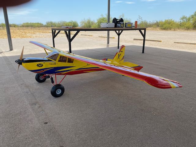

Maiden-day!! 25min of flying... 10 smoooth landings with and without full flaps!! Amazing aircraft. Flies like a trainer and no issues with the RCGF56cc motor (actually impressed with how smooth it runs!!) --absolutely love this aircraft!!

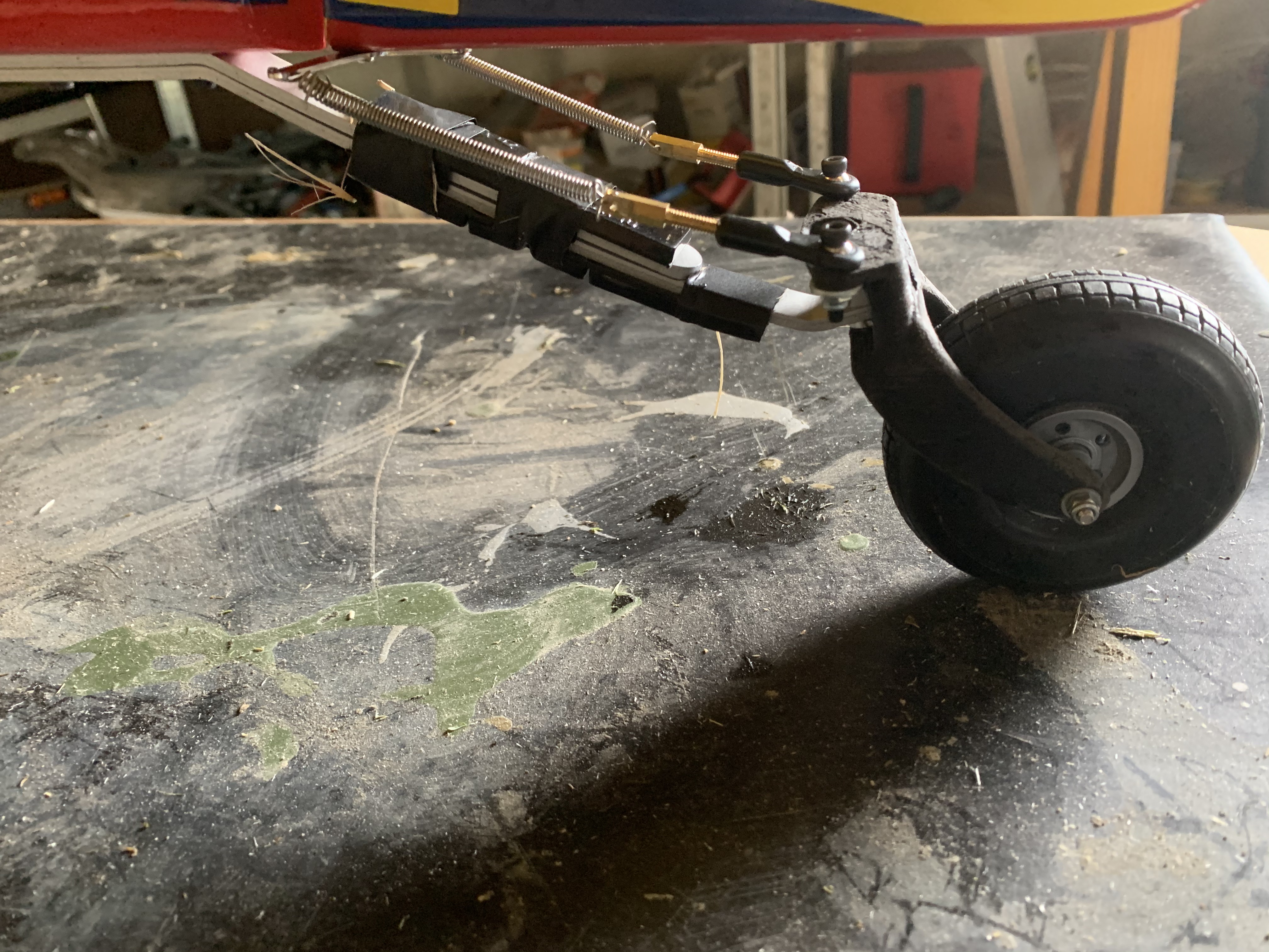

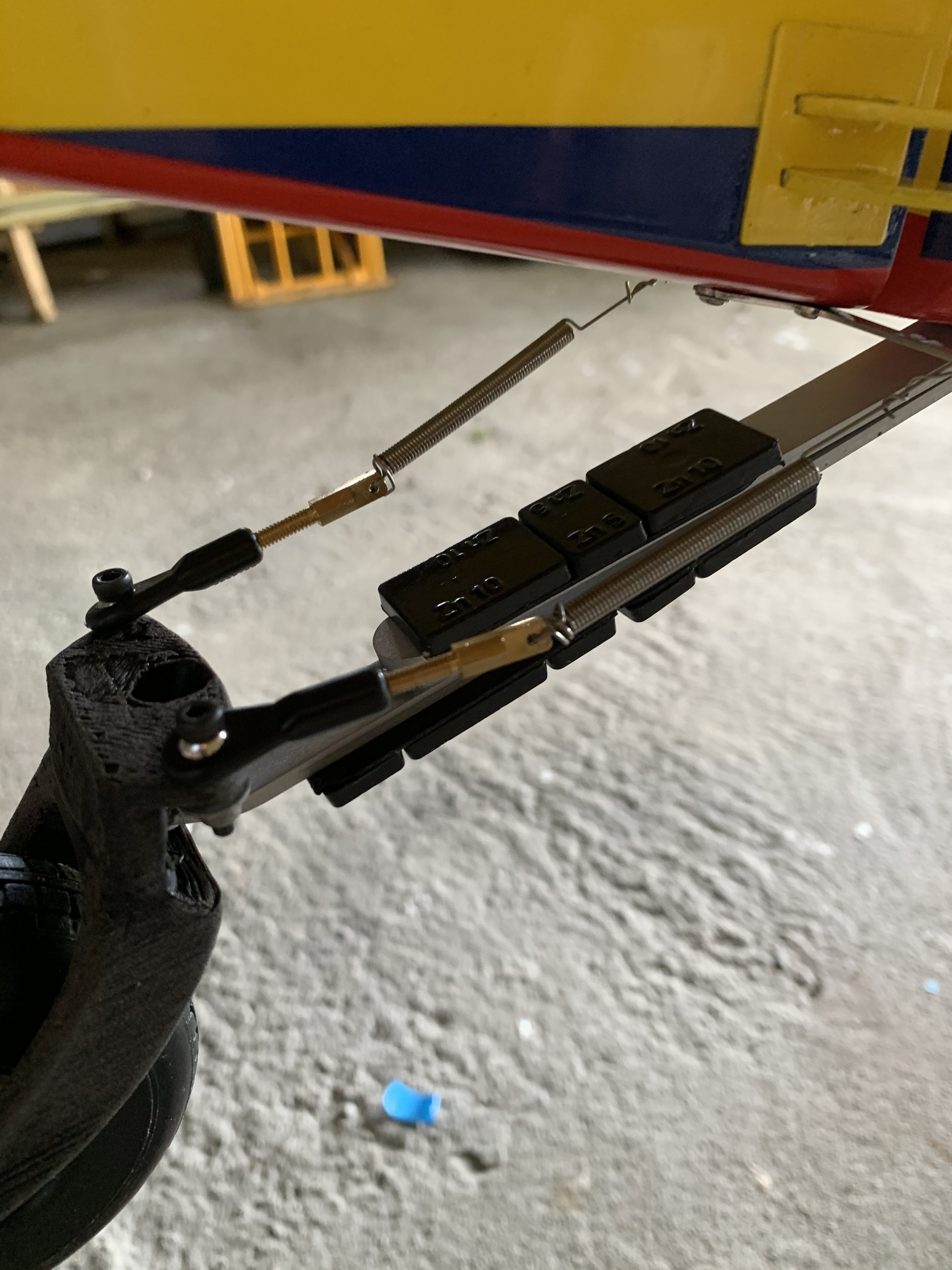

awesome! What tail wheel is that? I need to come up with something that has better response than the stock one with the springs. One broke and I replaced them with some from the hardware store, but my steering on the ground is delayed.
The make is unknown.. found it in the “box”. The holder is a AKNick’s design. Works great!
(note that I had to add weight to it to balance the 56cc out)

Ya I need to find a better setup. They sell the xcub tailwheel for this plane also, but haven't heard about it. My stock tire slips off the hub on occasion, and my inputs to keep it straight after landing are significantly delayed because of the springs. Maybe I can go stronger springs. Can you replace the springs with music wire, or will that not work?

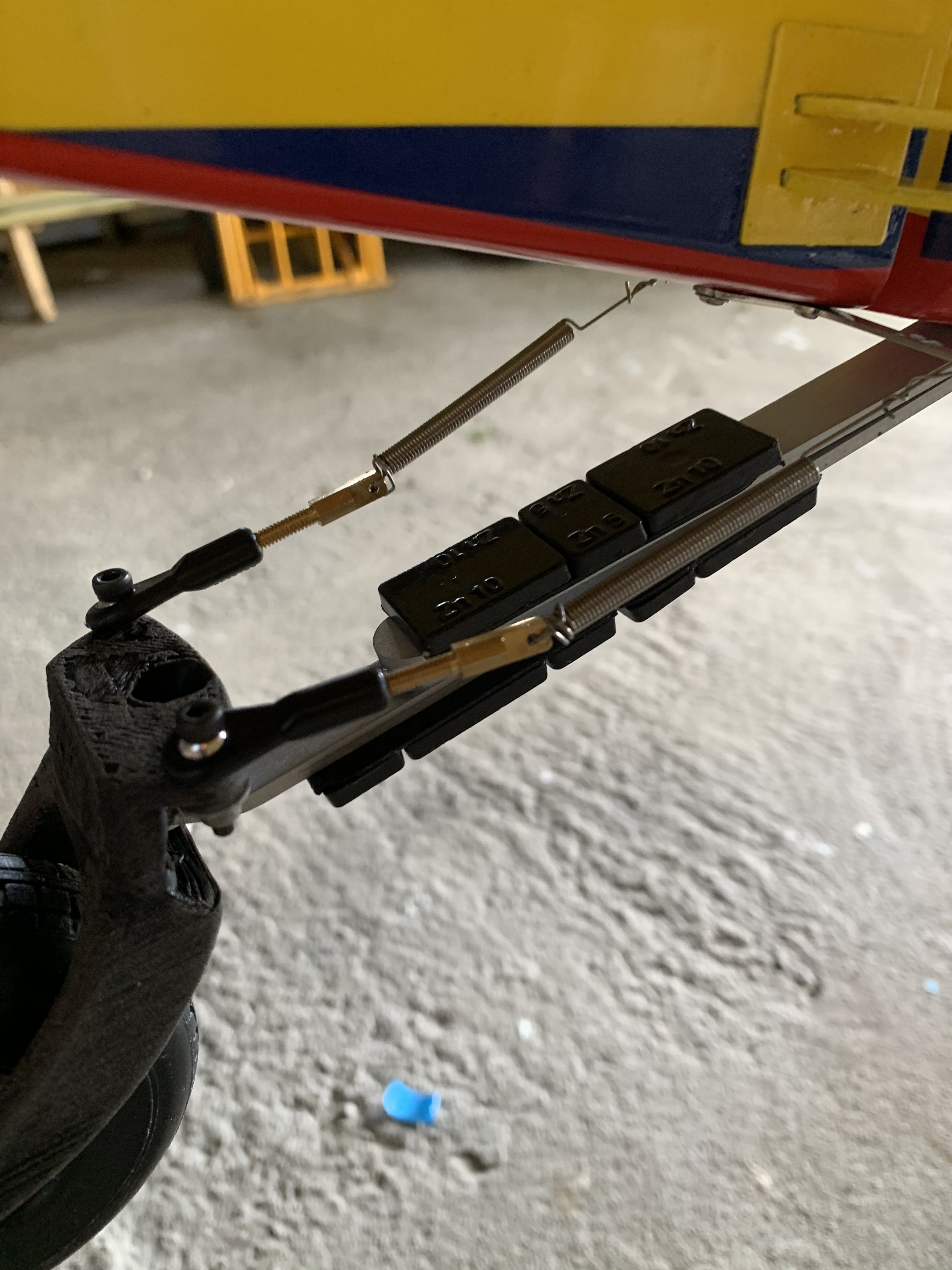

Glad it works for you! FWIW the ball links below the top plate gave me a little better breaking torque.
Those leaf springs move back and forth on each other, I foresee that tape giving up eventually. Also the flex in the aluminum will probably pop them off as well. My weights are under the Horizontal on each side.
Music wire would be too stiff. You could try the silicone fuel tubing method.
