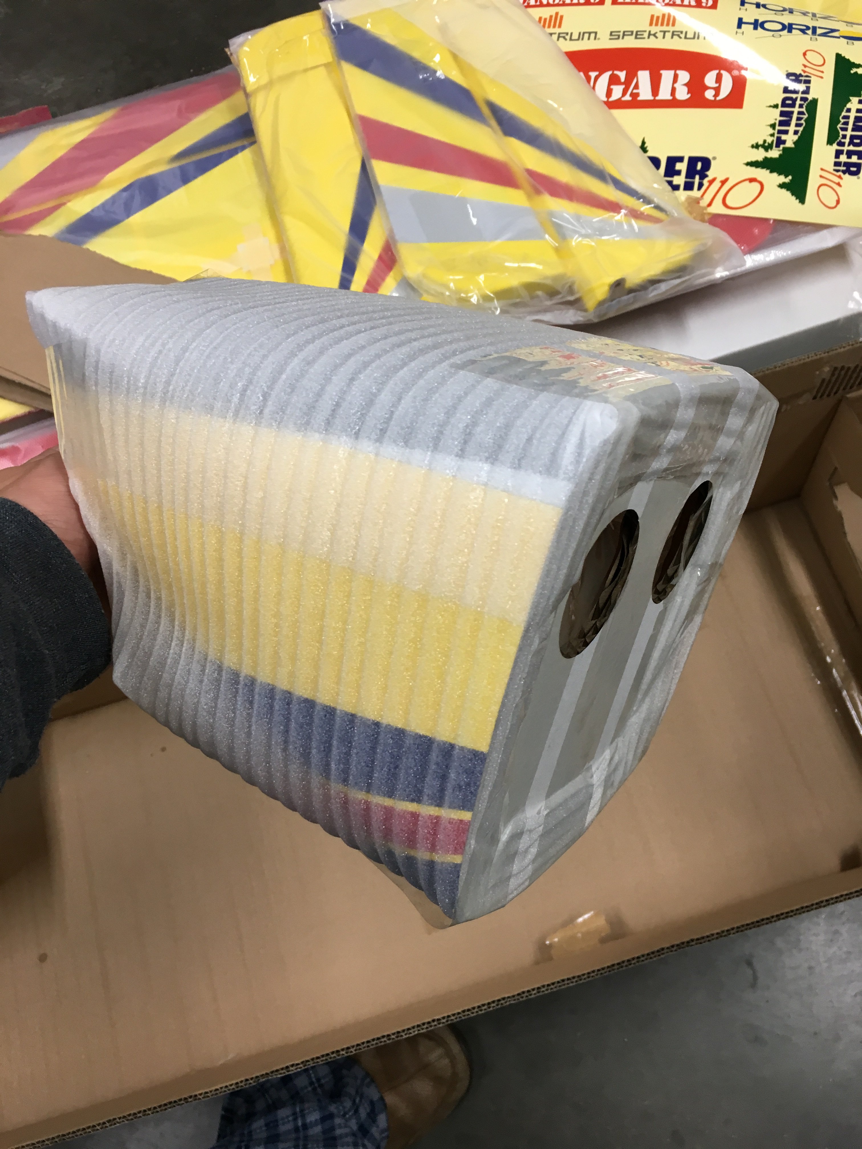

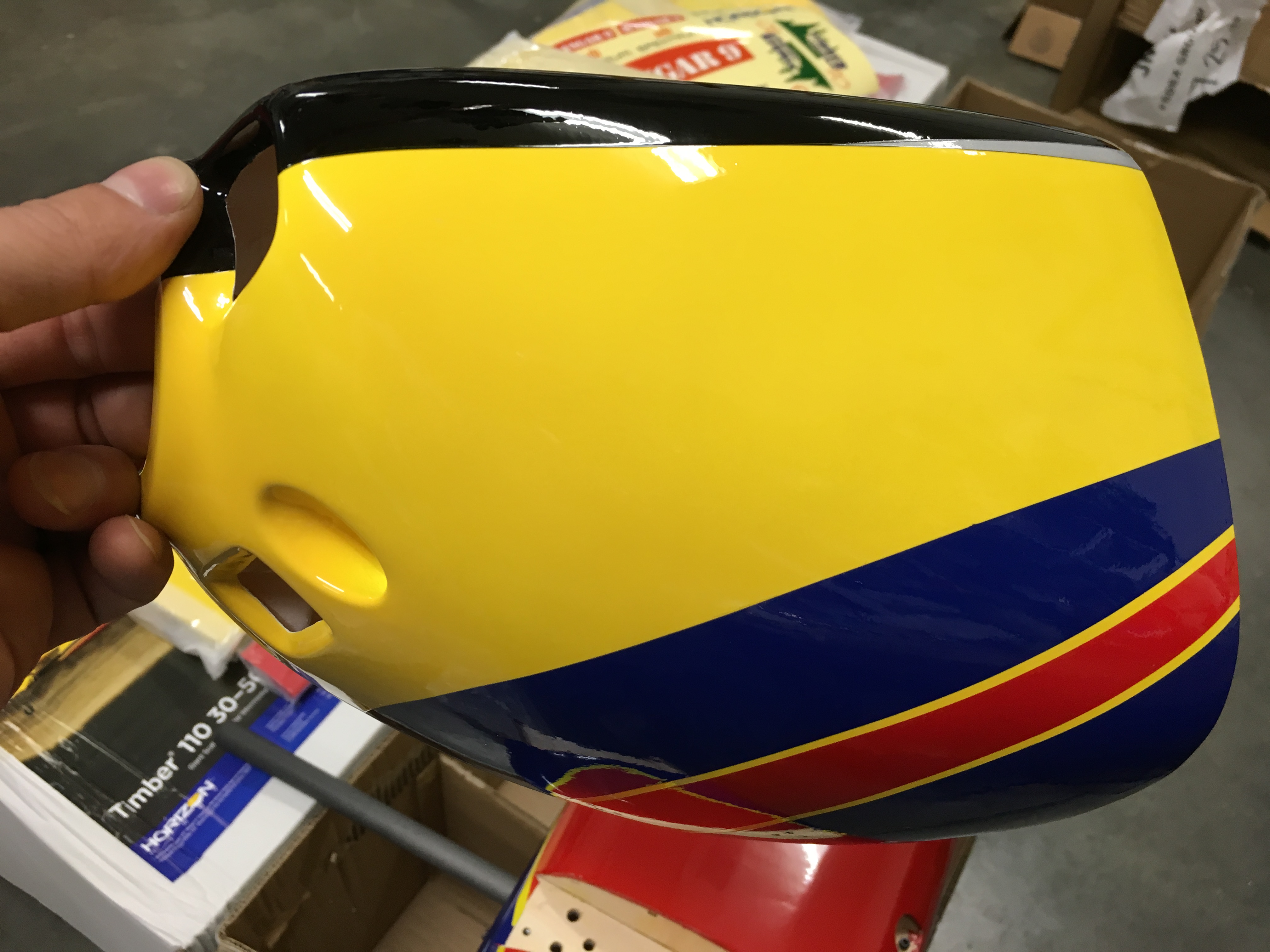

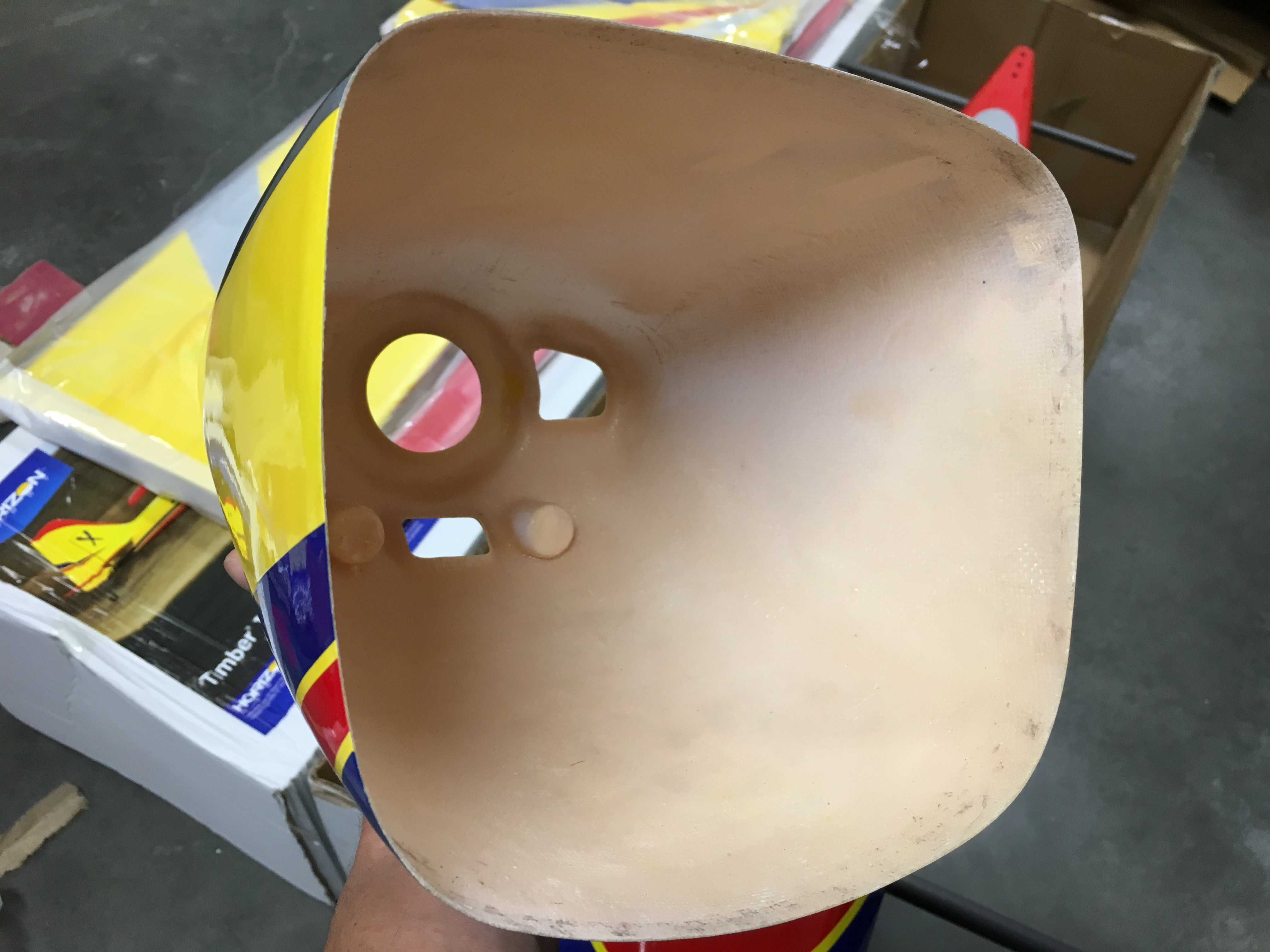

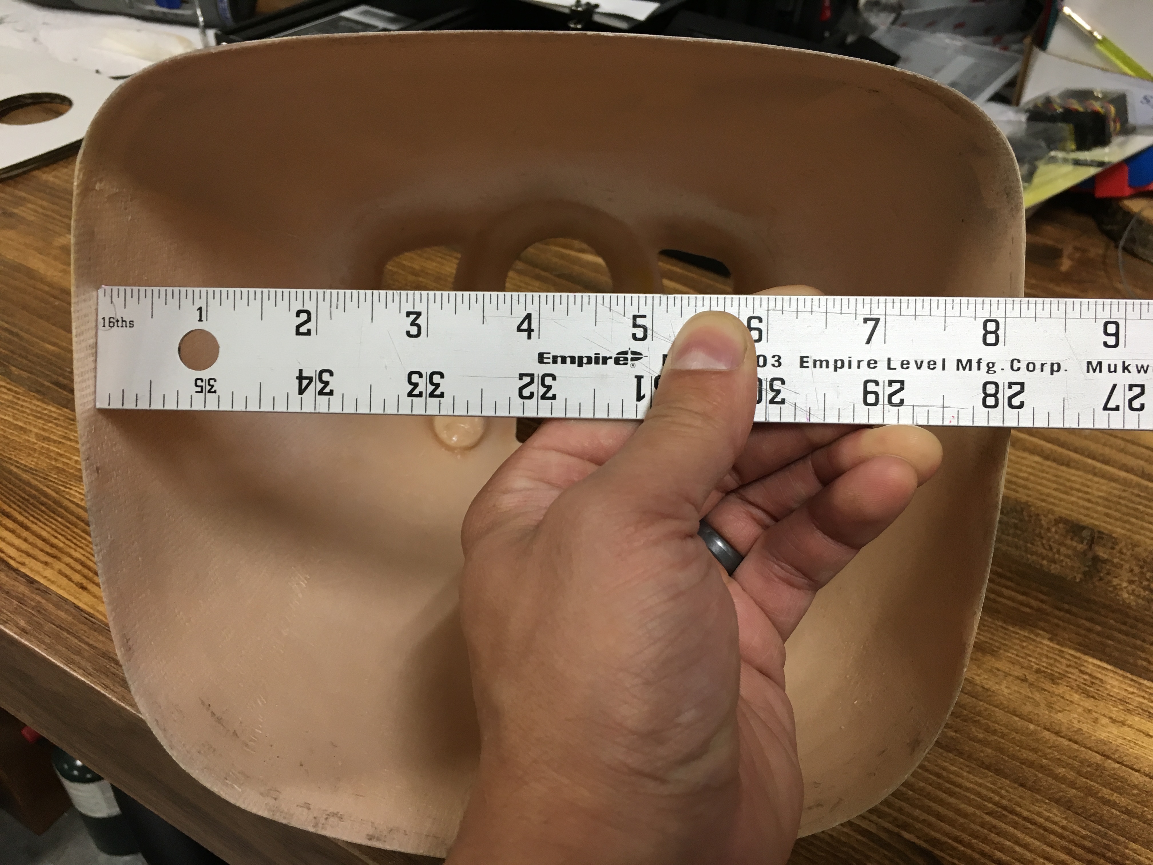

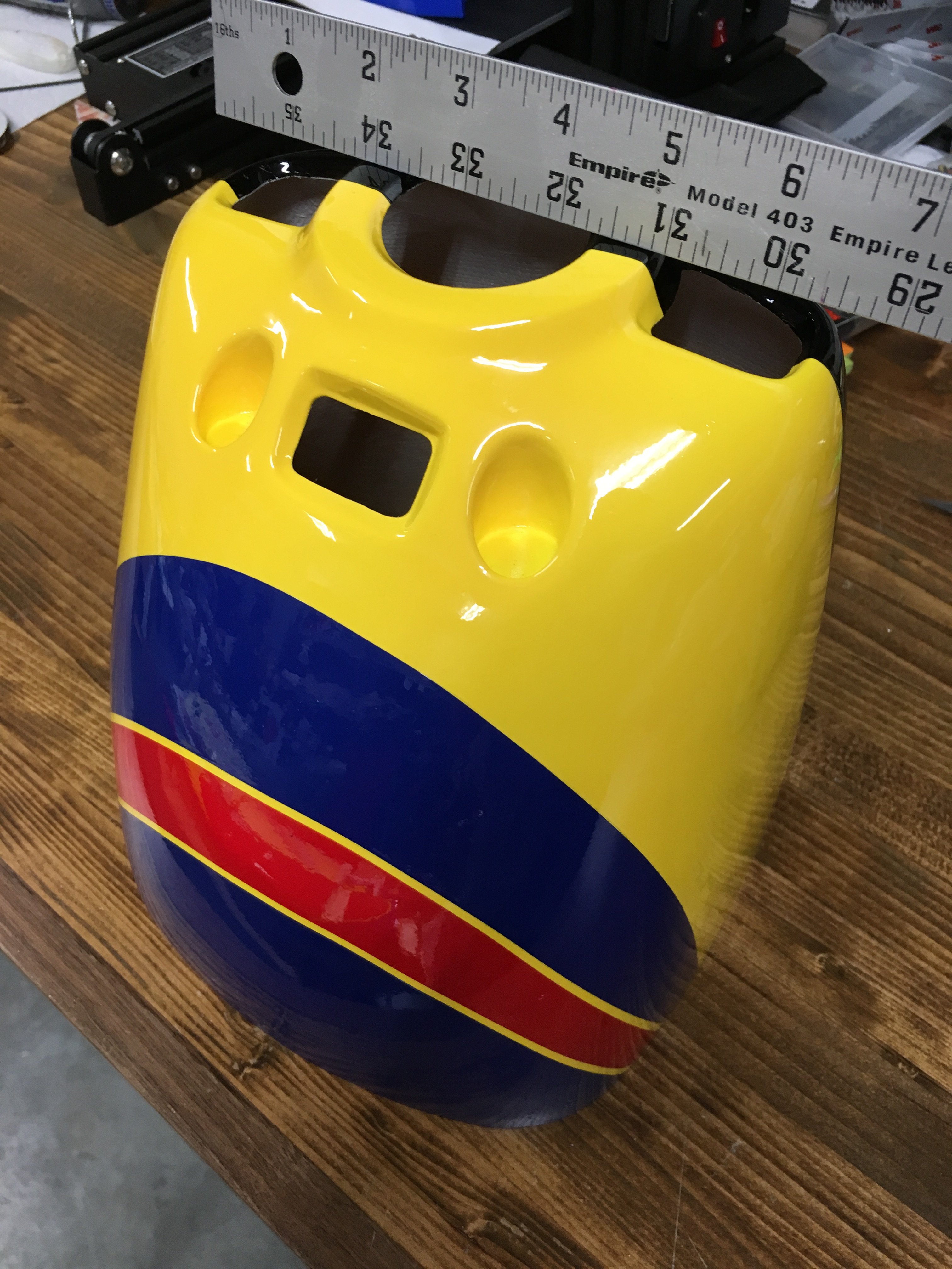

View attachment 110826 The cowling is top notch. Painted very well. At the back it’s roughly 8” across by 7.5” high and tapers forward to 6.5” across up to the 3” spinner
View attachment 110827 View attachment 110828 View attachment 110829 View attachment 110830
I measured the cowl on post #33 on page 4. FWIW the VVRC 40cc twin is 8" across cap to cap (angled plugs) and still 7" head to head. The Timber is 8" across at the back of the cowl and tapers forward to about 6.5" in the front. If I do some rude calculations 3" back from the top of the cowl measures 7.25" so could the VVRC actually fit.... boy it's close... will the plug caps stick out the side... Big YES.
