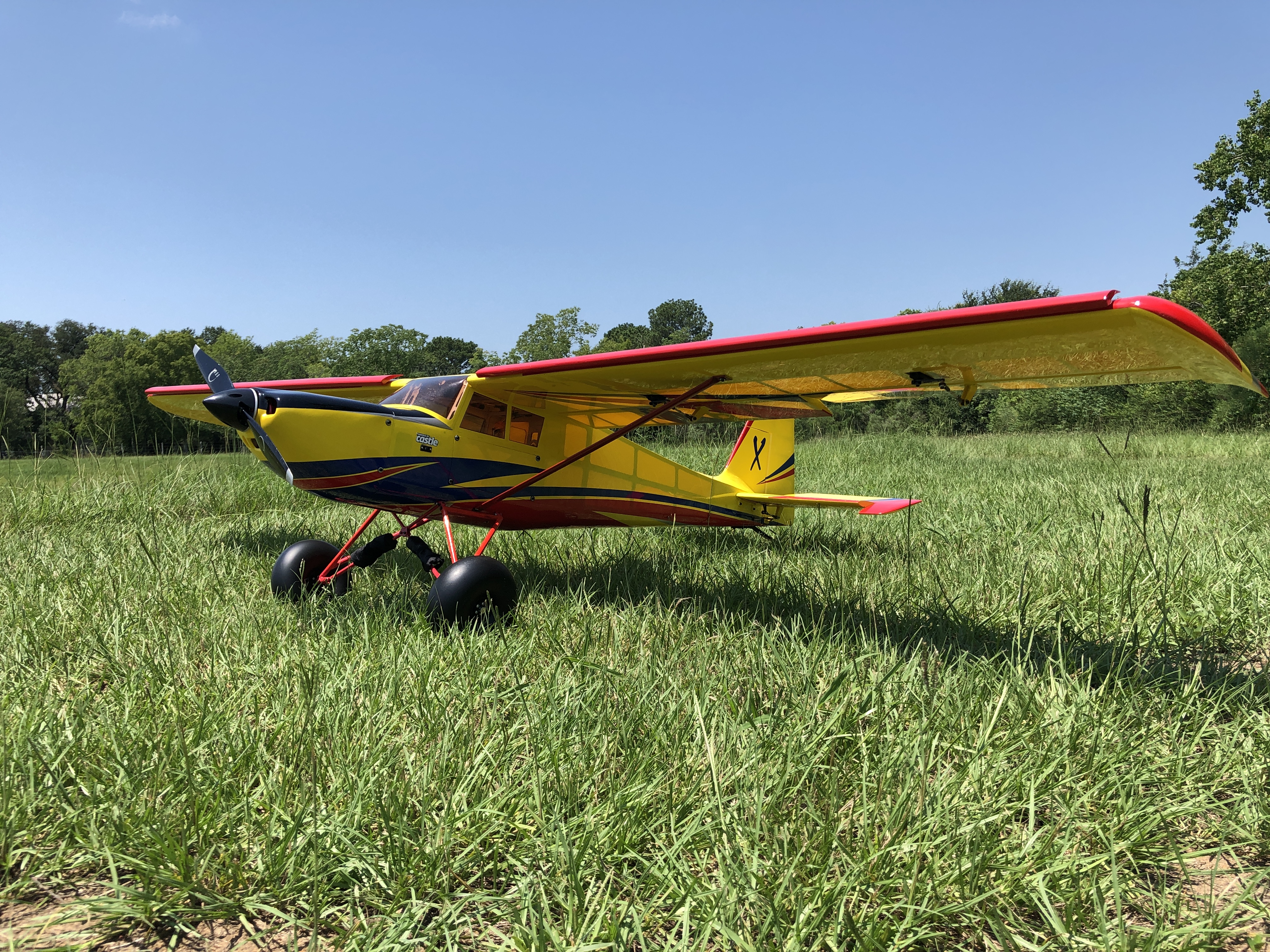

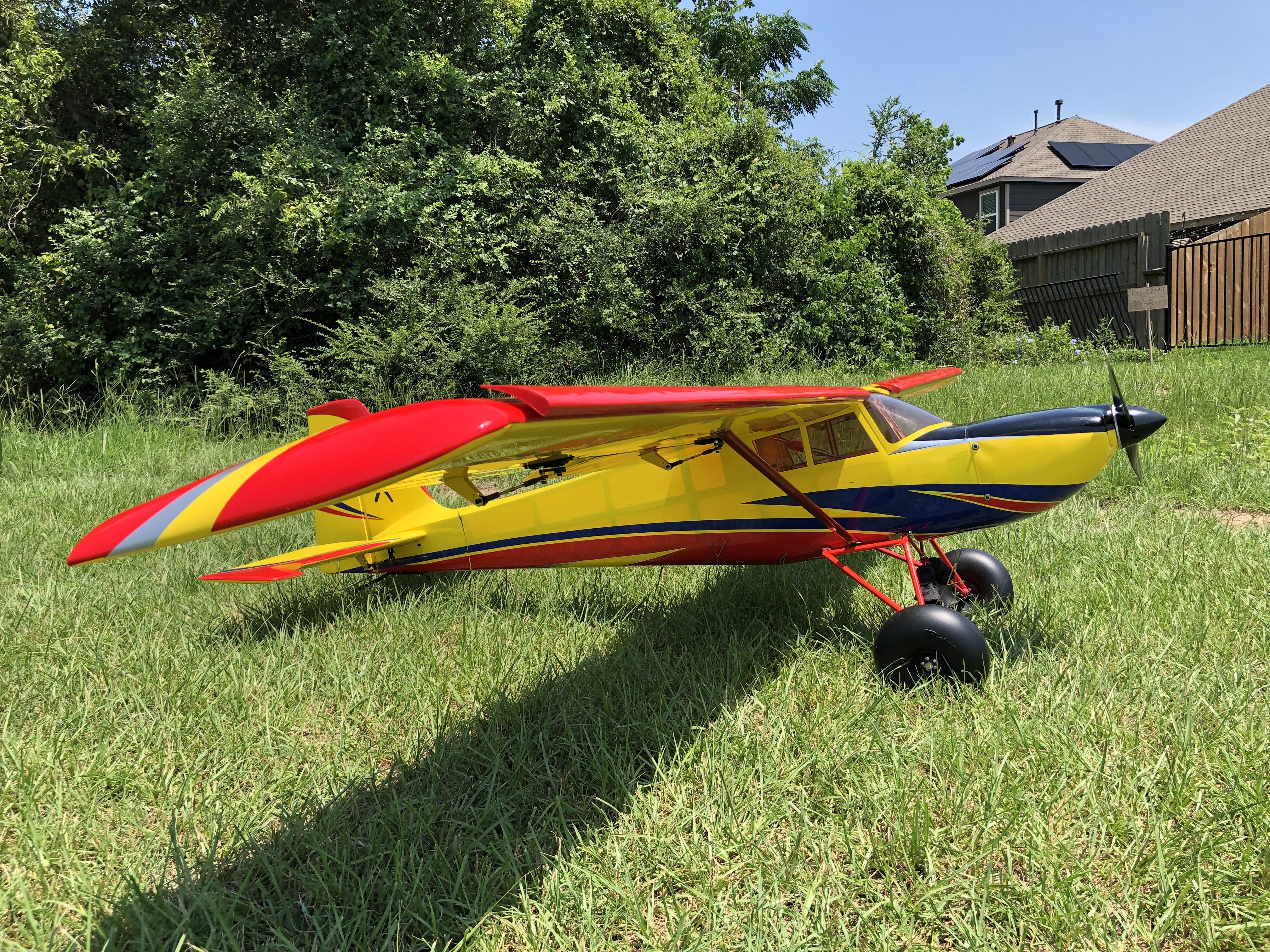

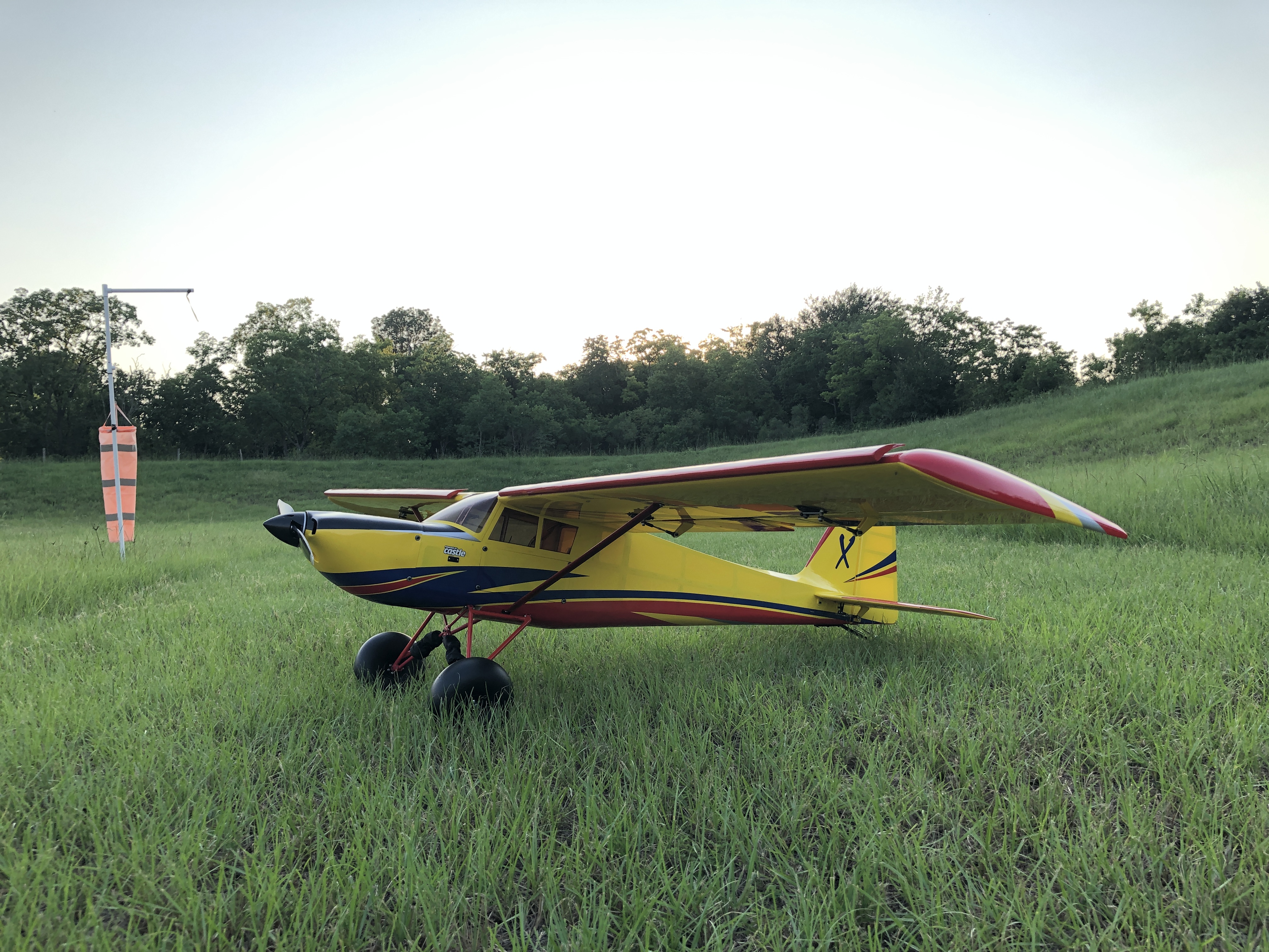

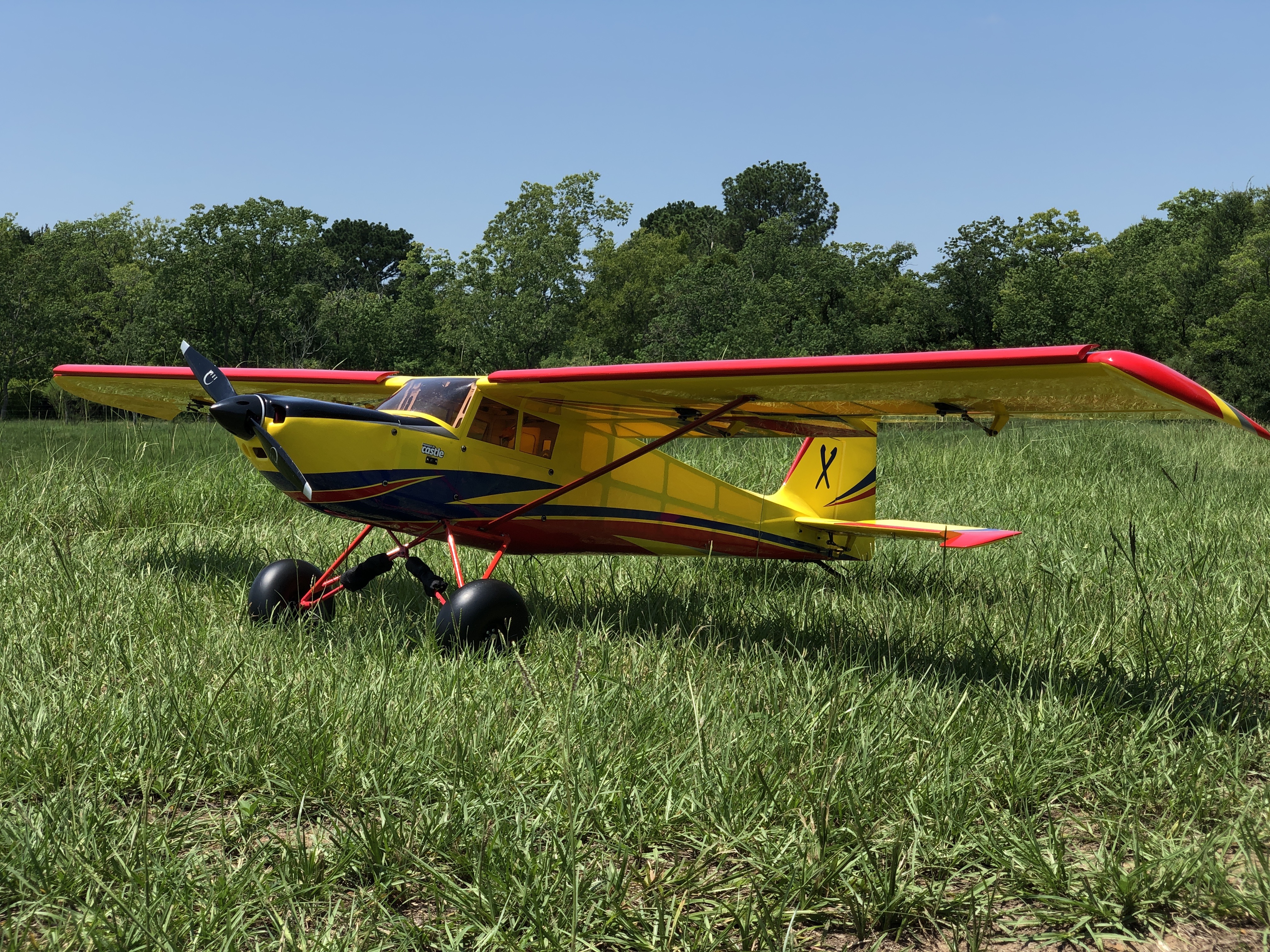

And for those of you wanting pics of the LE slats, here are some updated photos from my backyard runway with how the plane currently looks!
