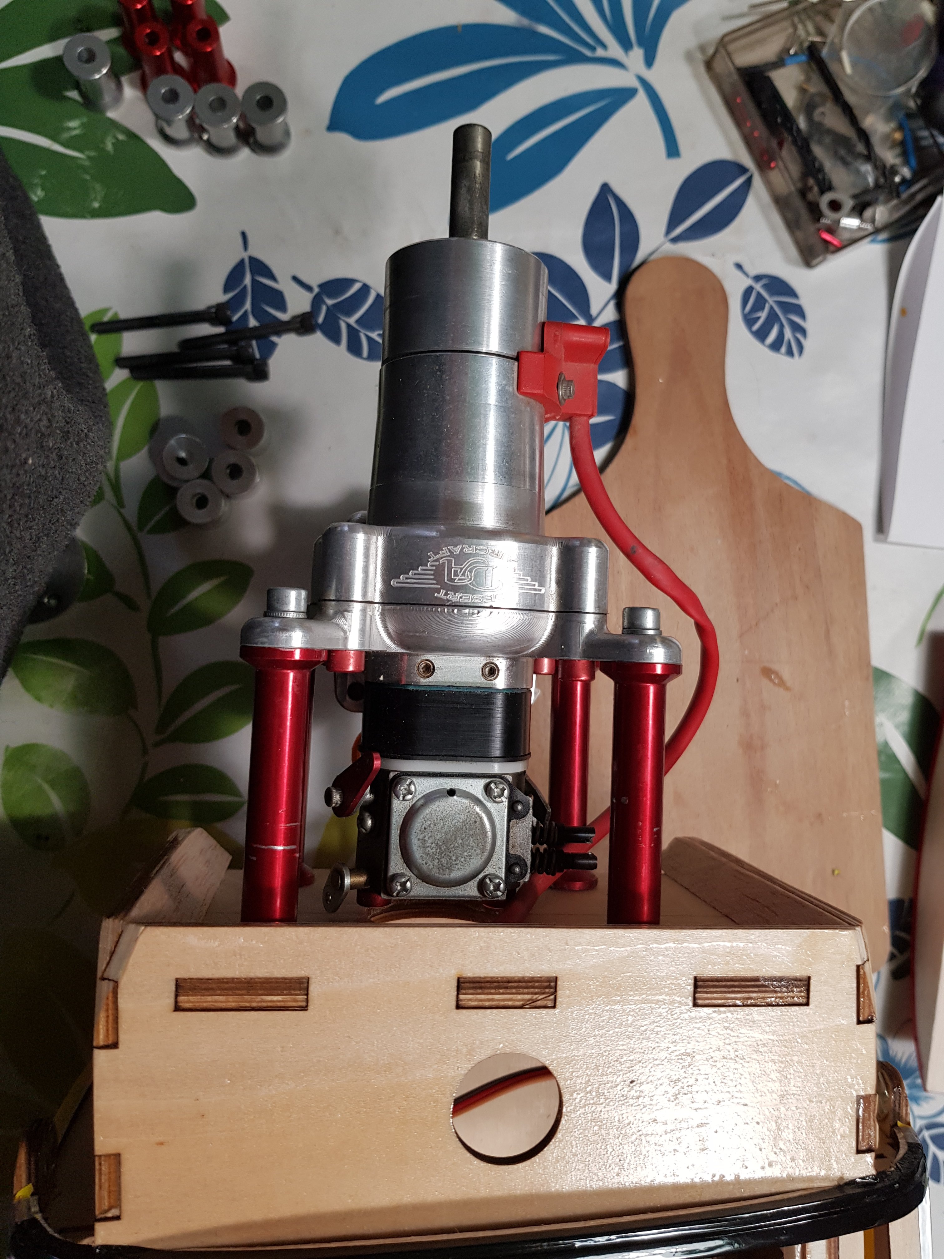

Fredfab
30cc

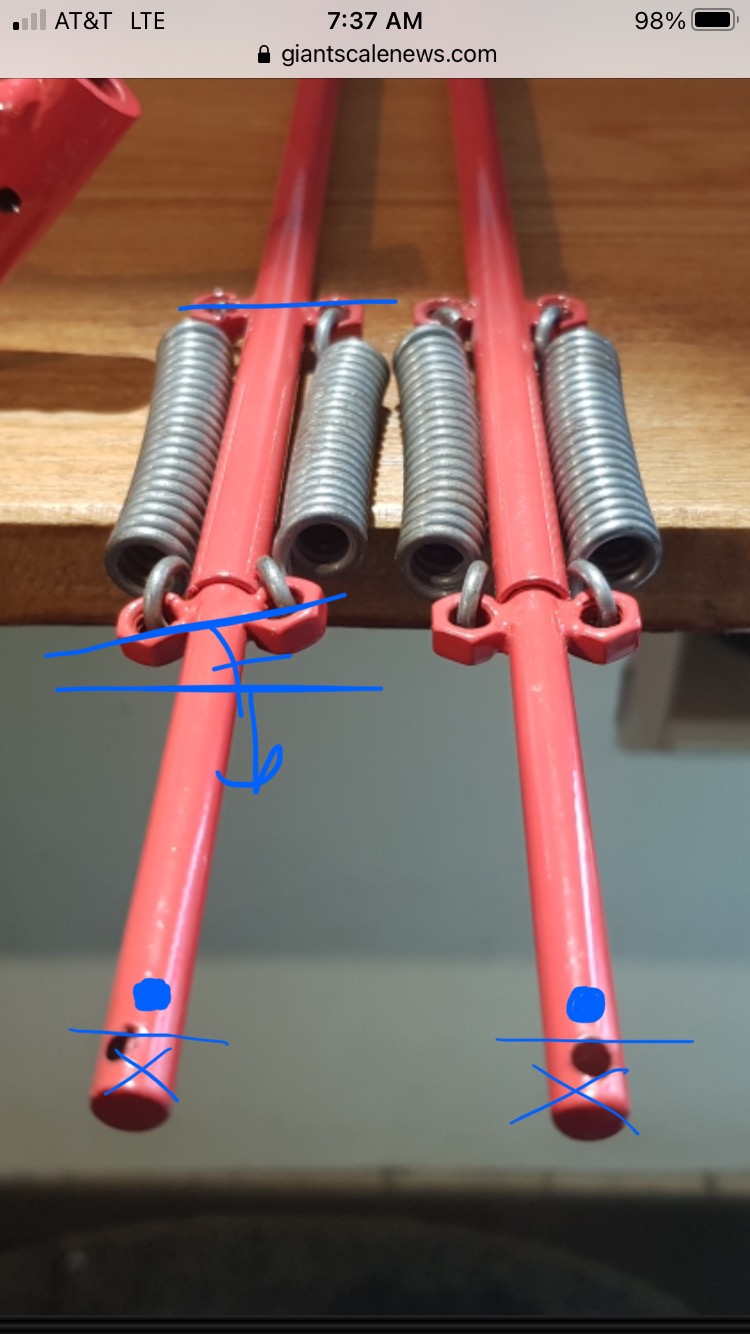

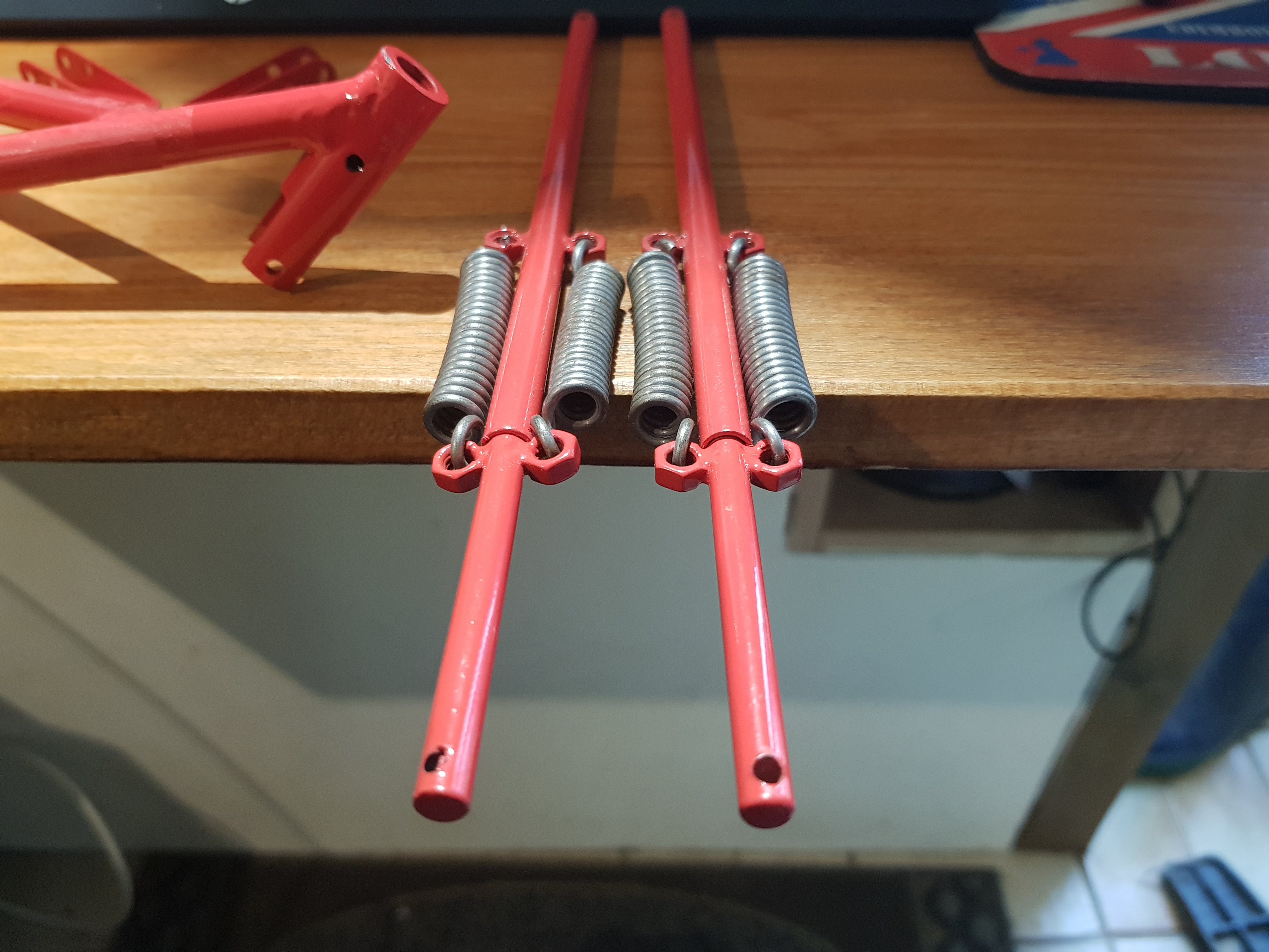

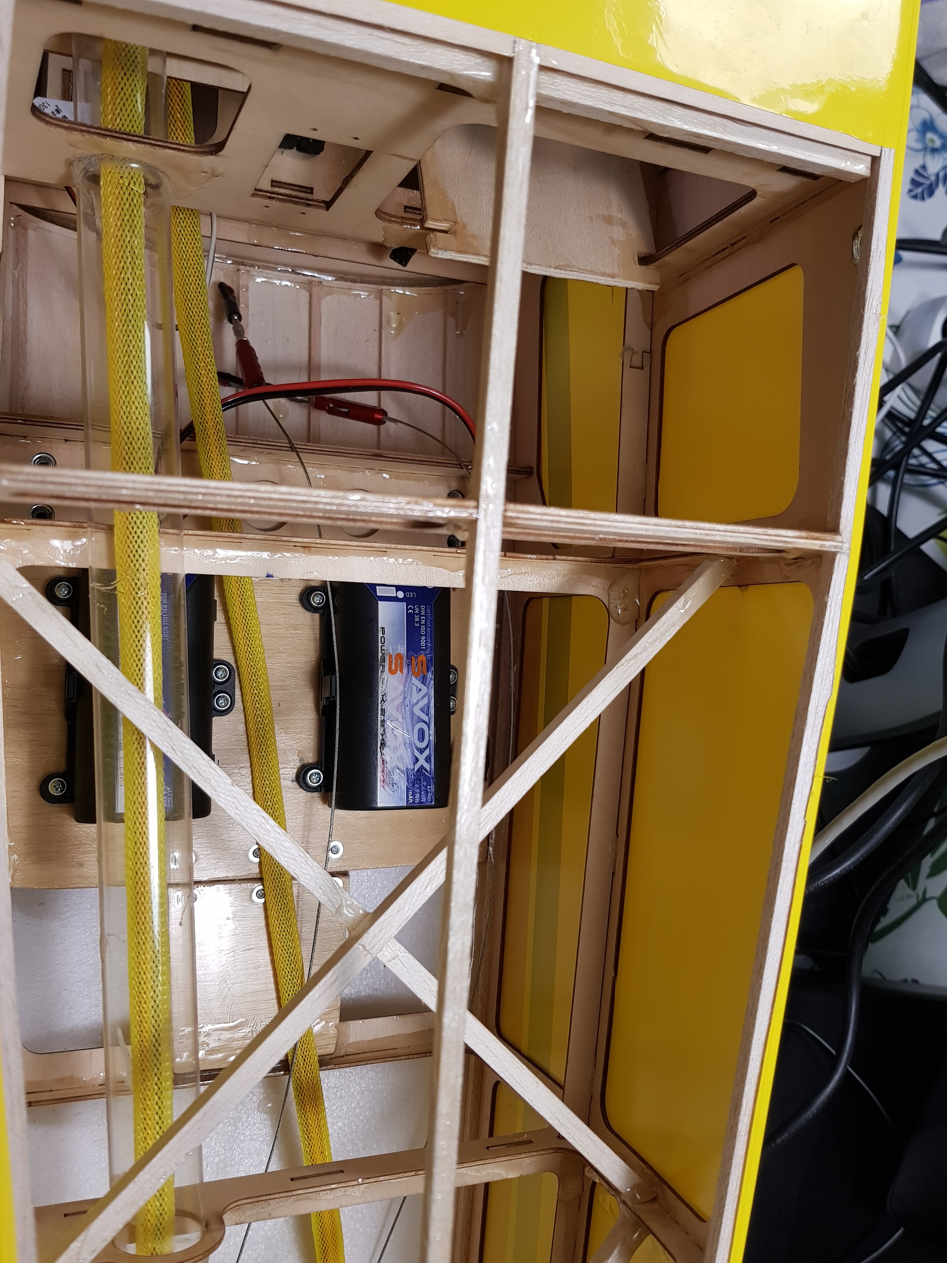

the original holes are not in the axis

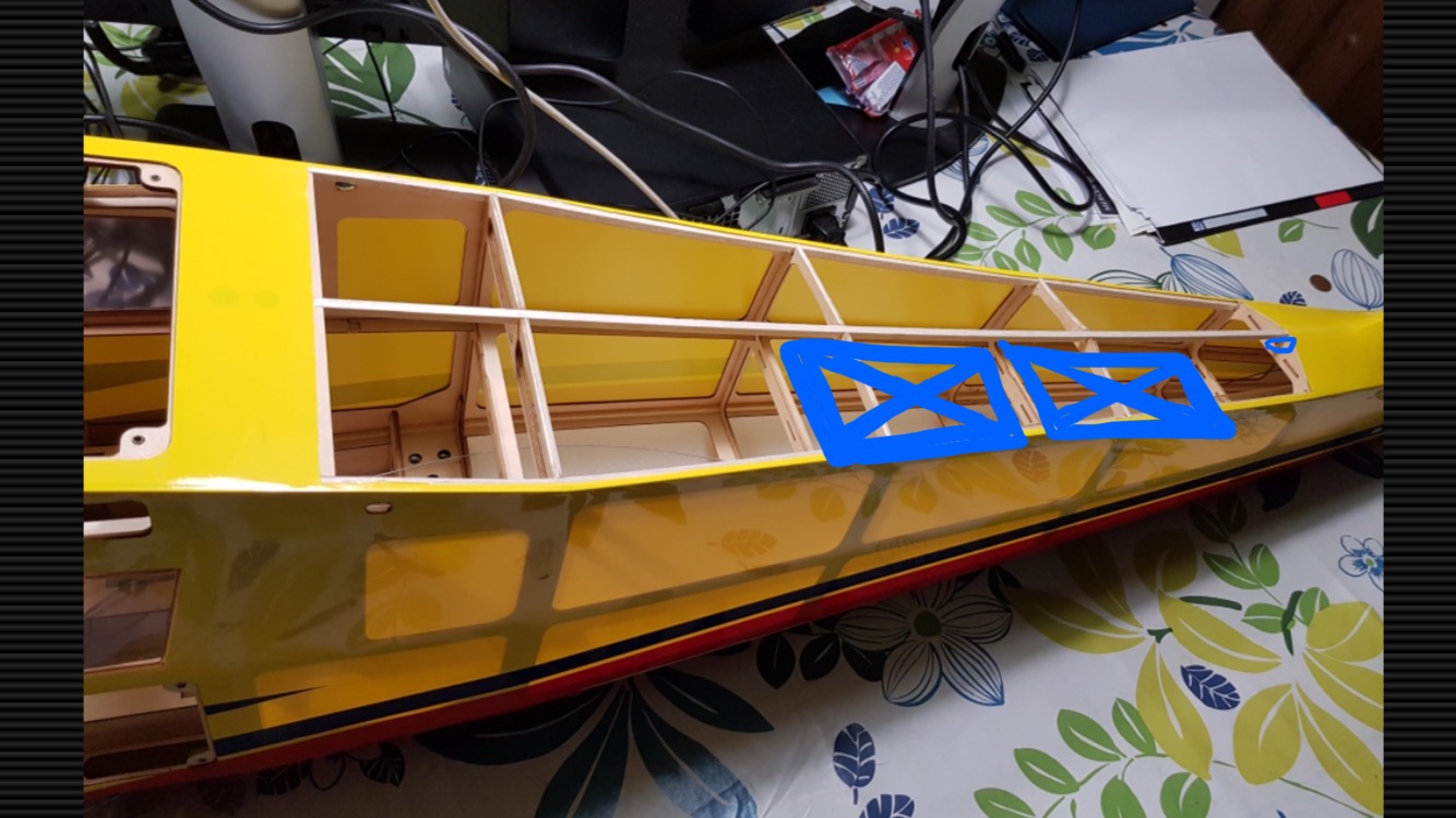

AKNick
Some of your photos did not upload correctly.
the center struts appear to be aligned ok. I would cut them and drill new holes. This will give you a little more ground clearance and some positive camber.

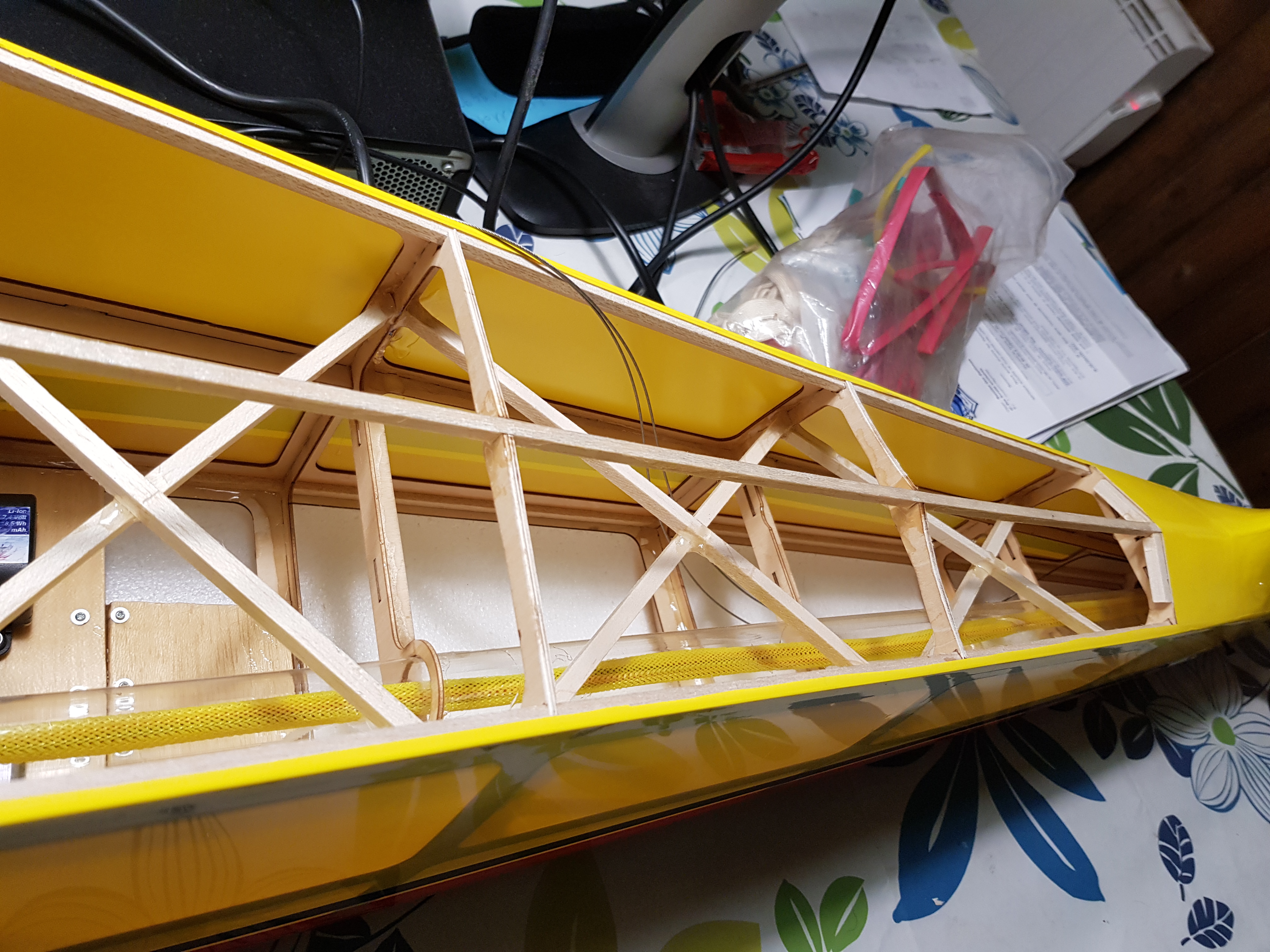

For strengthening the empennage, I saw someone use thin ply with lightening holes that make an x pattern in the ply.
add a little chunk of wood to support the top stringer as is attaches to the former.
Fredfab
30cc
thank you for your reply aKnick,
For the photos, I saw the problem but I can not correct
for the landing gear I have already shifted the hole by 7 millimeters as on the previous posts
not against, I did not move the fixing of the spring...
for the reinforcement, I did not know quite how to do it,
I make do as you said. do you think that will be enough?
many thanks !!!

AKNick
many thanks !!!
Looks Good! After you upload the photo, there is a little tab that says insert photo as a "thumbnail" or "Full Image" I choose Thumbnail. Sometimes the web page needs to be refreshed before adding photos in a reply, otherwise It will fail.
A large amount of the empennage twisting is resolved by just the covering. If you look back to find how I did it, it's still holding up for me. I think there are many ways to achieve the same result. I played around with mine quite a bit and added braces to eliminate the twisting. It wasn't very methodical other than trial and error. Just keep in mind that the plane can use the added weight in the tail so there is no need to use sparingly. I even considered at a later date adding a baggage compartment in the tail. If you did this, you can put the batteries back there. With my batteries forward - I have about 6oz of ballast in the tail.
Hope that helps

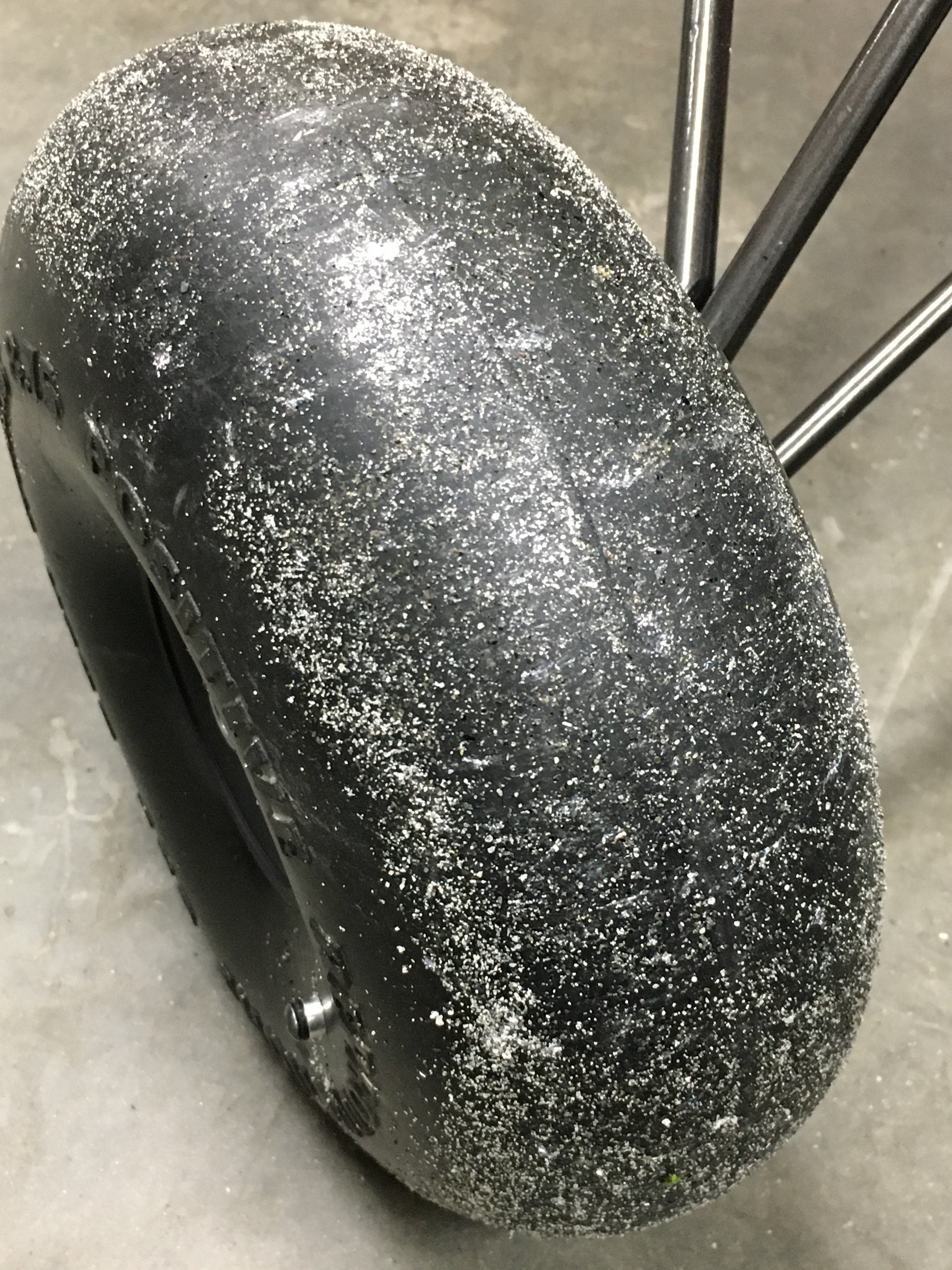

Took the Timber out for a couple flights. It’s dark here around 4pm... so it’s hard to find good beach time with the 16ft tide swing every six hours, lack of daylight, and then have the weather cooperate... I got rained on during my second flight. My GoPro decided it didn’t want to record my first flight. But managed to get one lowlight video in. I’ll make something out of it. I even tried to make a video talking about the plane... turns out I’m not very good at improv... I missed a lot and stumbled over my words.
Still had a fun time, and some spectators aimlessly walking along the beach (made it hard to shoot approches) but they liked my flying so no complaints! After I got home I noticed my tires were shiny. I think it’s the salt water crystalizing - looks neat.

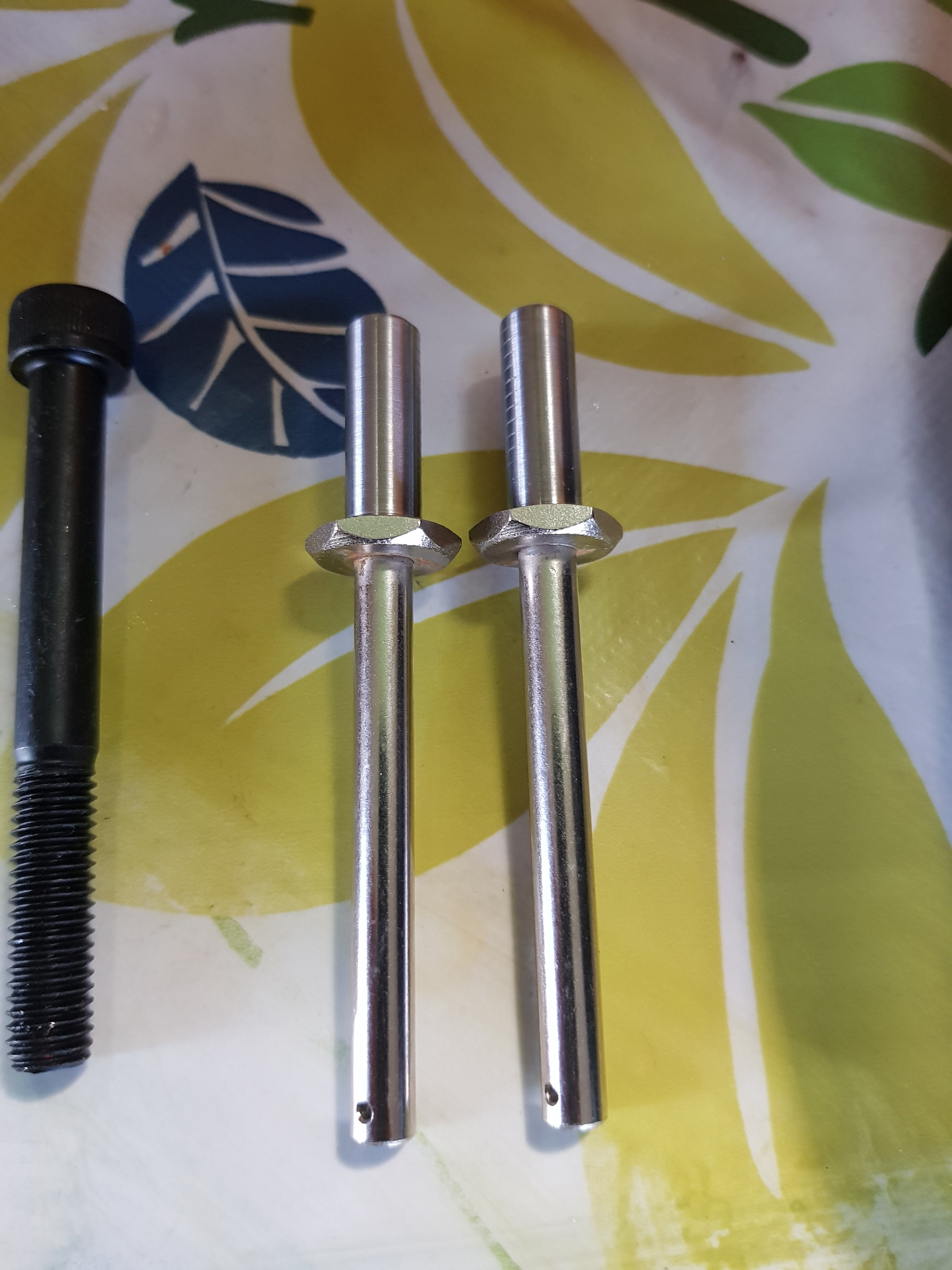

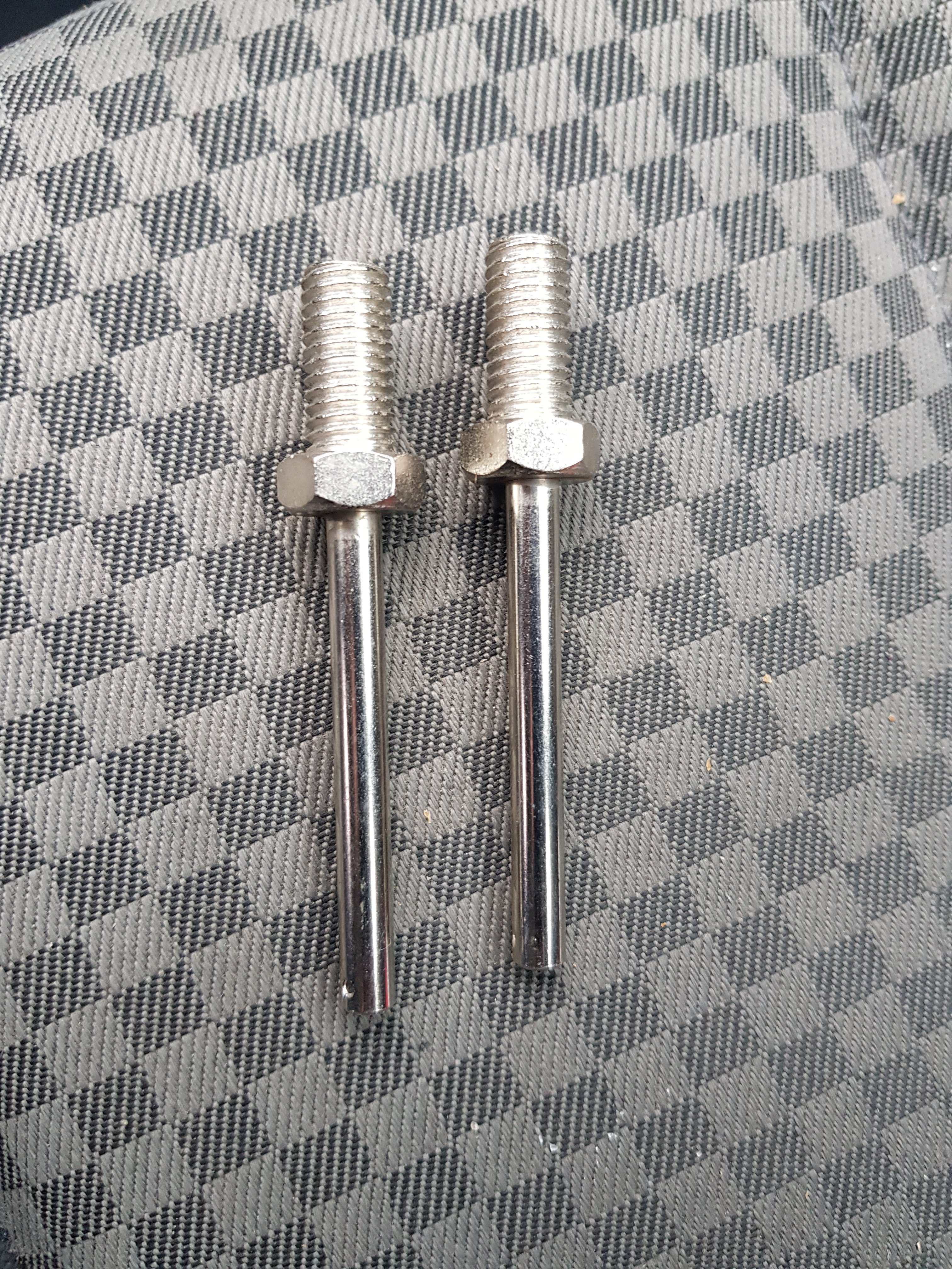

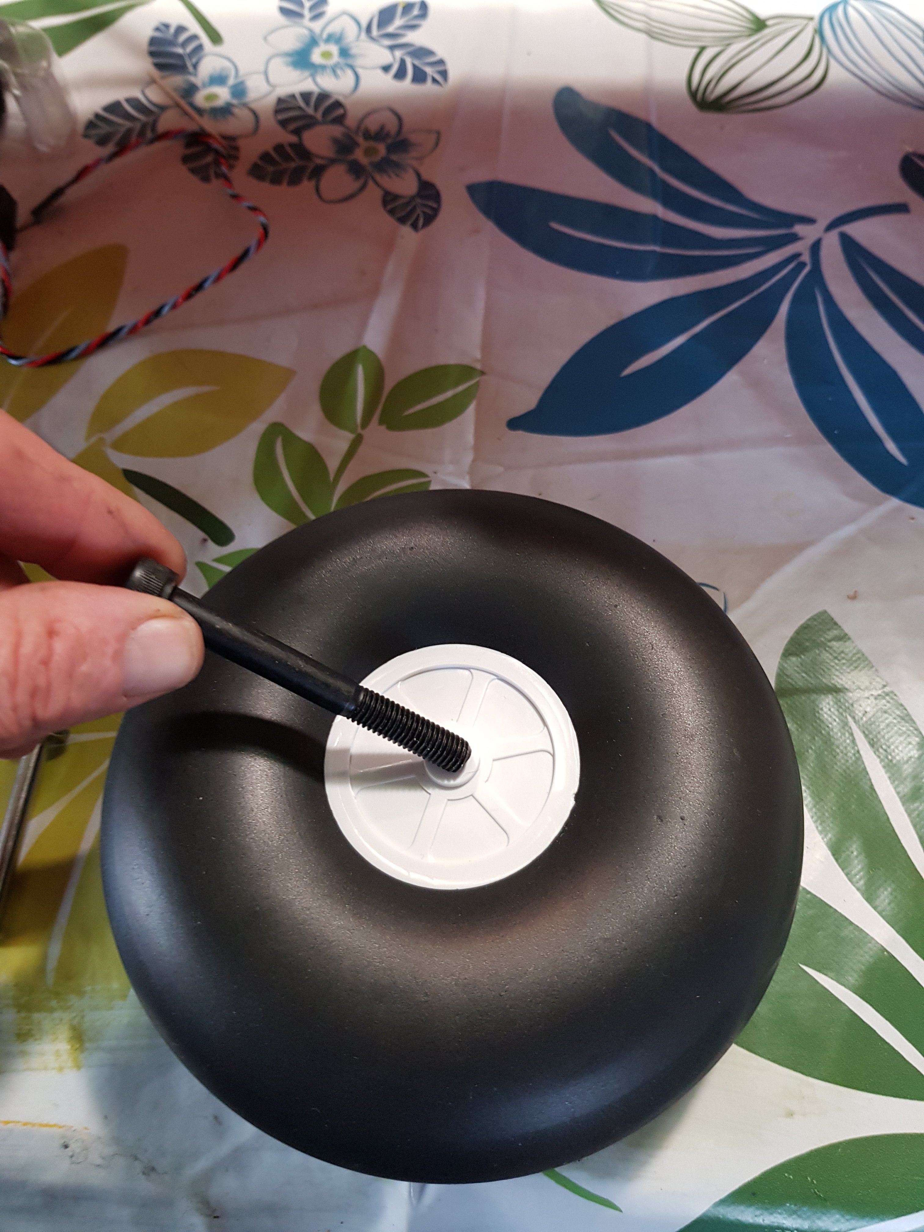

I modify the original axles to the diameter of 8 minutes, to mount the wheels
it's better without this horrible screw !!!

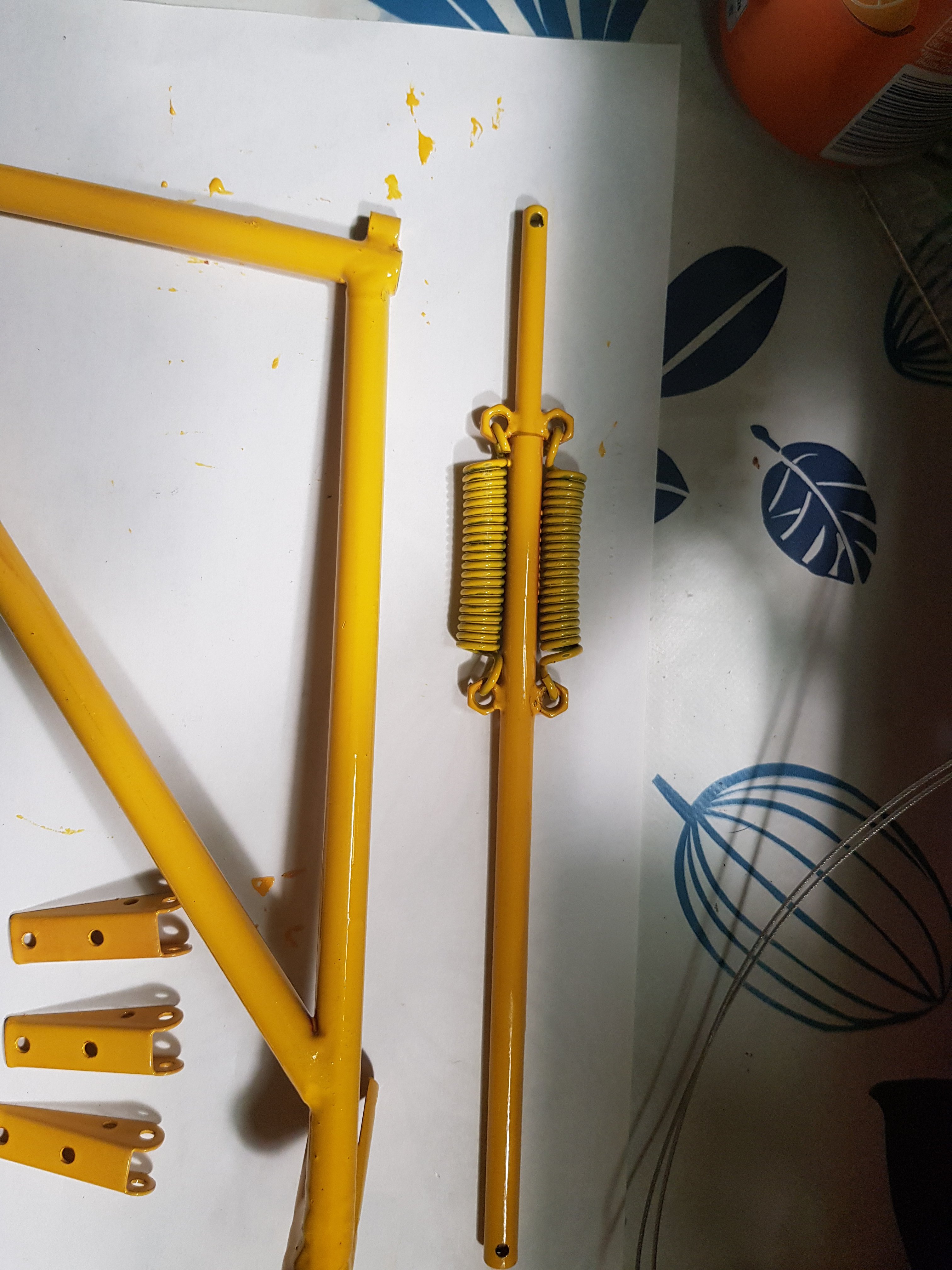

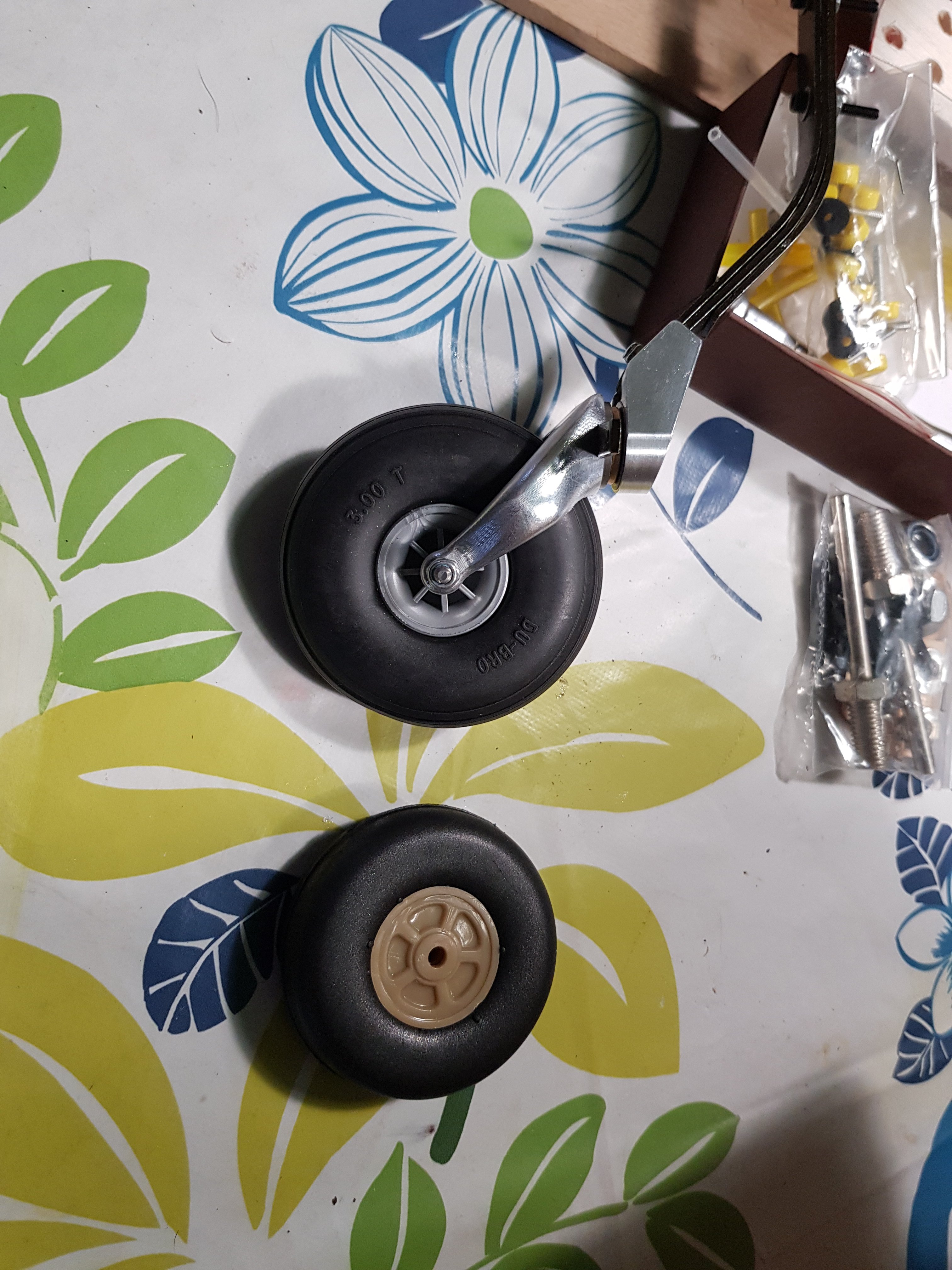

I modified the rear xcub with a 3 inch wheel
