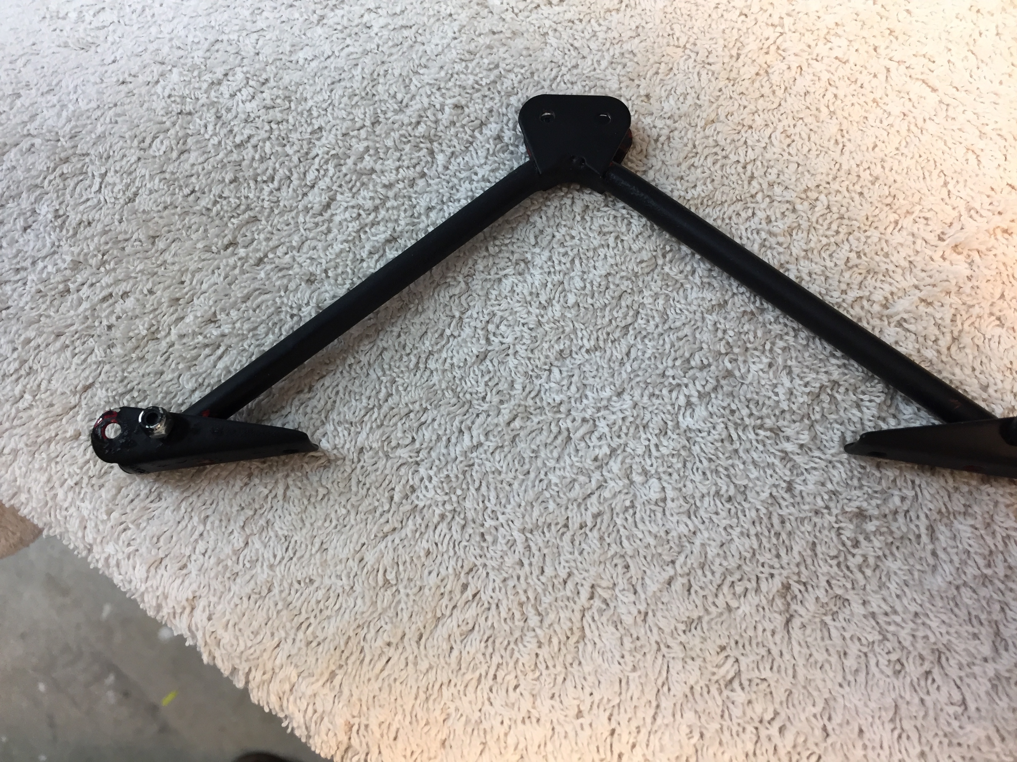

What is the trick to getting the Xcub landing gear to fit. I have wrestled with it for a couple days and scratched my head raw.

Seems like there are a few ways. For me, I had to elongate some of the holes in on the attaching brackets to the fuselage. It takes a lot of fiddling. I even had to bend my forward cross struts a bit to nestle into the center bracket. It worked for me... but yeah, you just gotta dive into it.
Tell me this, how are you attaching the inboard sides of fore part? I'm thinking about heating and bending the legs on the part in the attachment to fit. Do you think that will work?
I bent the piece that goes into that center section a bit. I don't remember it being that hard to bend.
