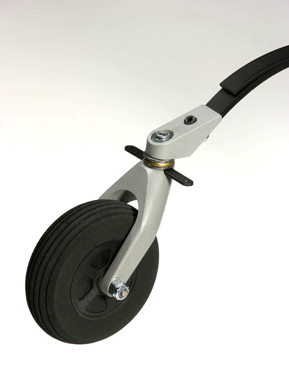

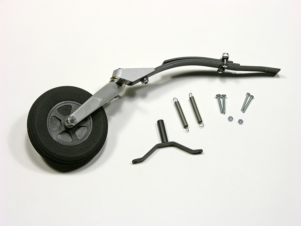

speaking of tailwheels, I have not acted yet, (waiting to see if I need tail weight or the CG point) But Ohio Superstars makes an unbreakable unbendable 1/3 scale unit including a 2 7/8" wheel, spring steel leaf springs, 6061 T6 casters, ball bearing, weighs 5 3/4 oz, has anyone weighed the stock gear? I don't have a scale. The holes don't line up, but he is willing to drill a hole for me before he tempers the steel because afterwards it would be nearly impossible with normal drill bits. I used to use his products exclusively on my 120cc 30 pound towplanes and never had a failure, bullet proof. Interestingly although a different layout the over all length and height are almost identical to the stock gear. 80 bucks. Note the clamp on the springs is just a keeper for shipping, there is a bolt hole there.
View attachment 117900 View attachment 117901
Looks nice! I wouldn't worry about weight in the tail. I have 6oz of weight in the tail as it is.

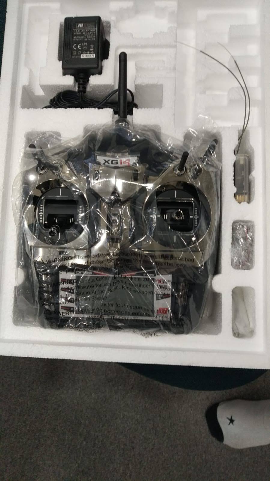

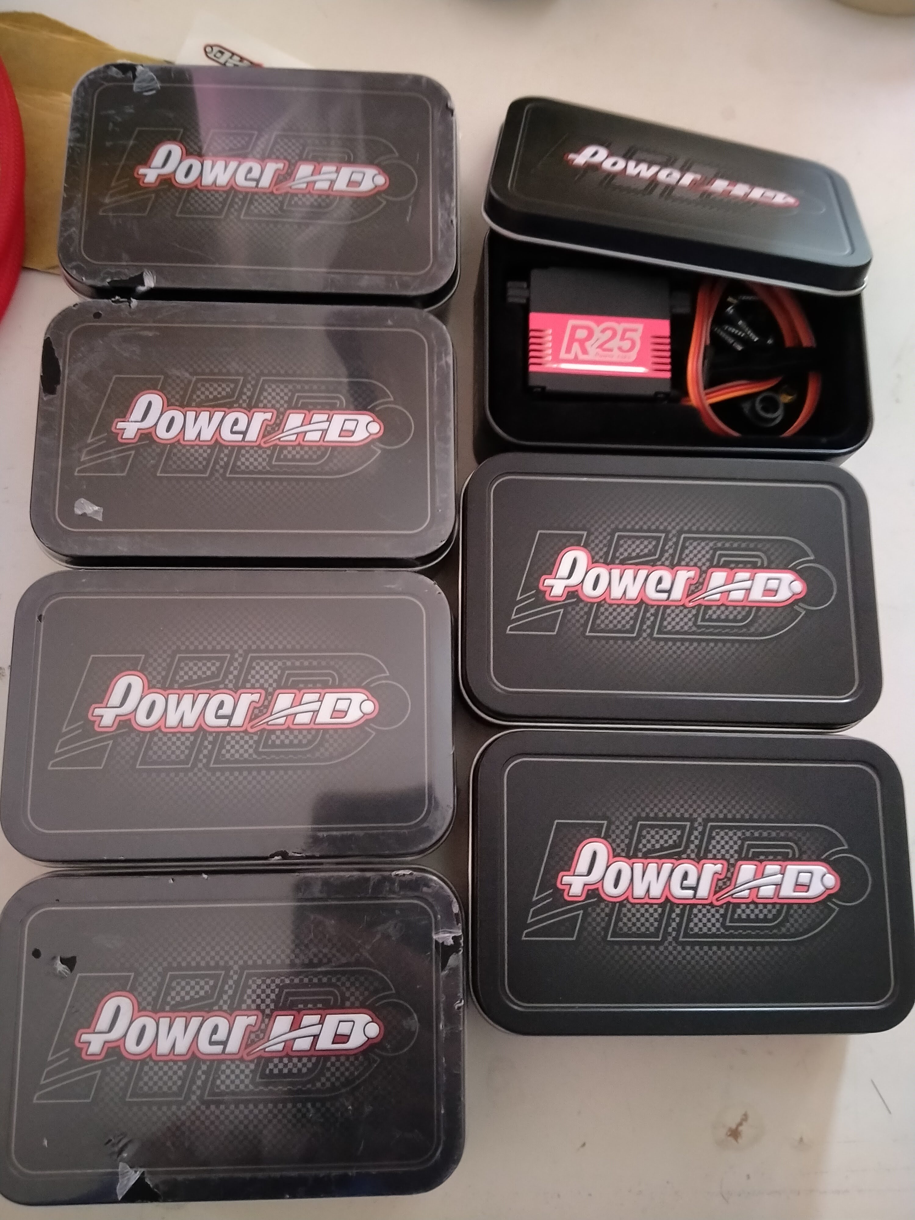

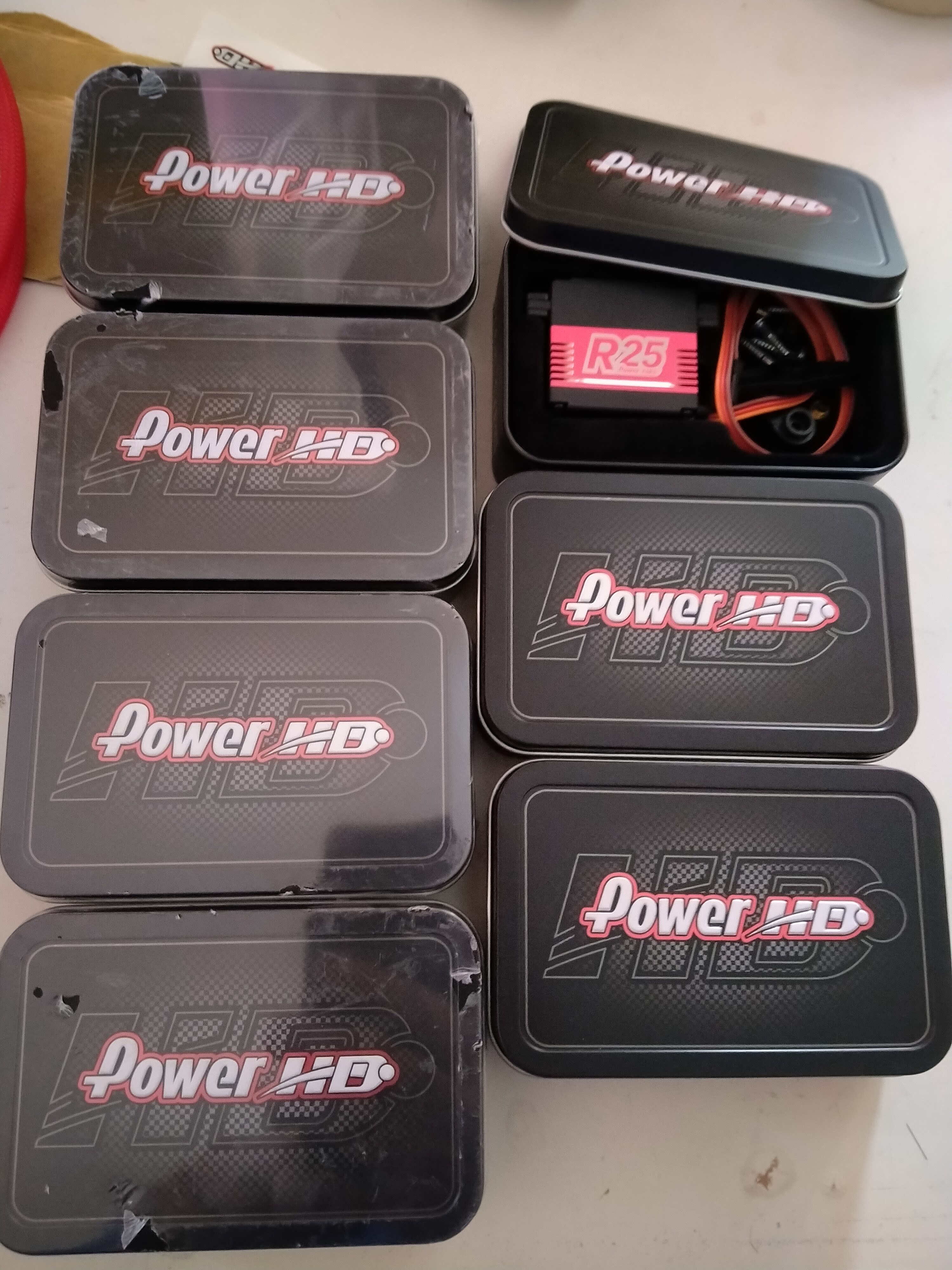

servos arrived, I cheaped out and went with a Chinese brand. A lot of guys in Australia seem to be using them even on 30/40% aerobatic ships, hope they are ok. I won't be flogging this plane and it won't be getting a lot of air time so I think they suit my needs well. 50 bucks each Titanium and aluminum gears ,coreless motor, 2 bearings etc. Radio pictured is shipped today from Singapore should be in by weeks end. NoW I have some work to do Yeah!
I'll post a review of the servos after I test them on the plane for centering etc.

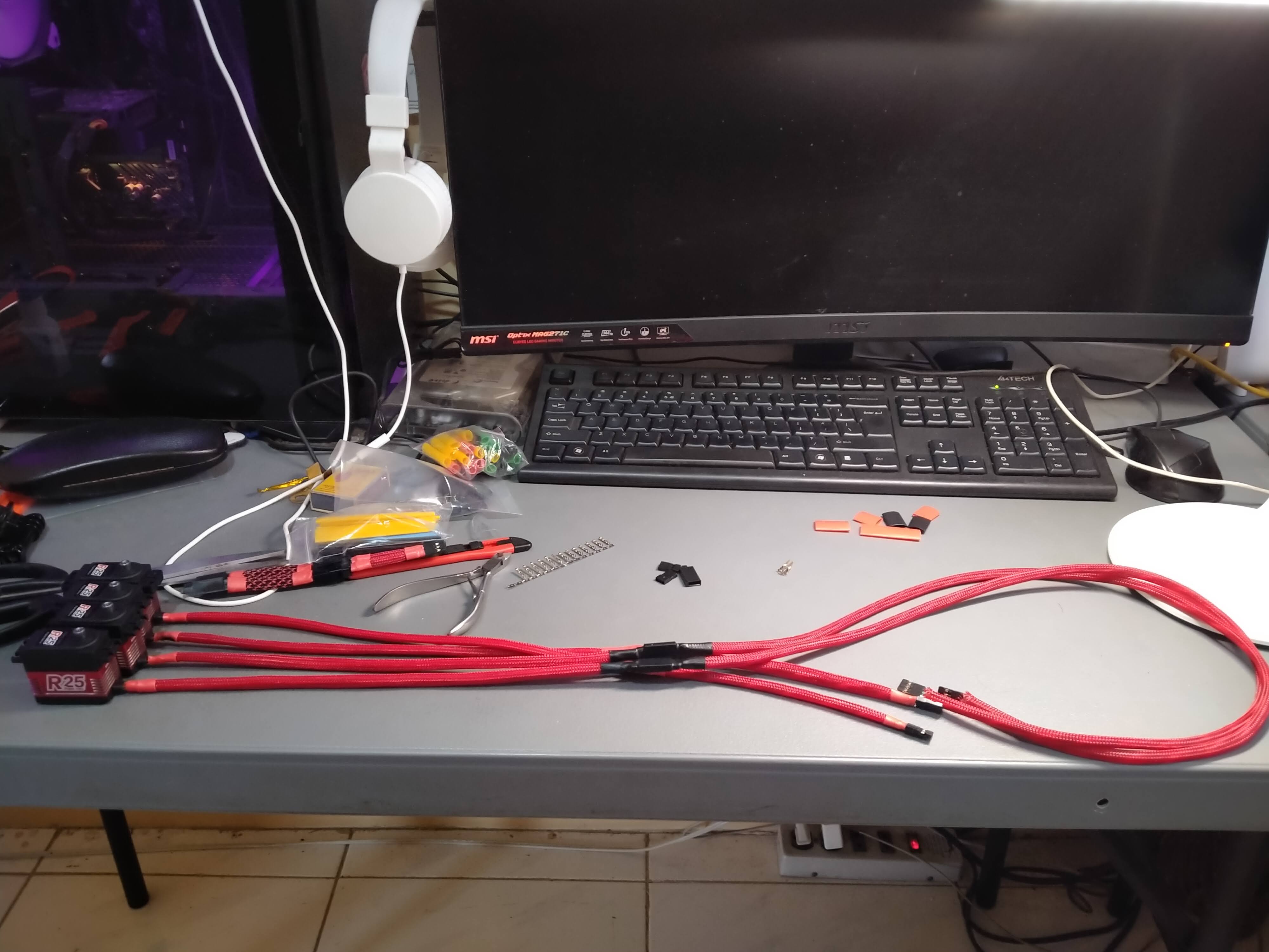

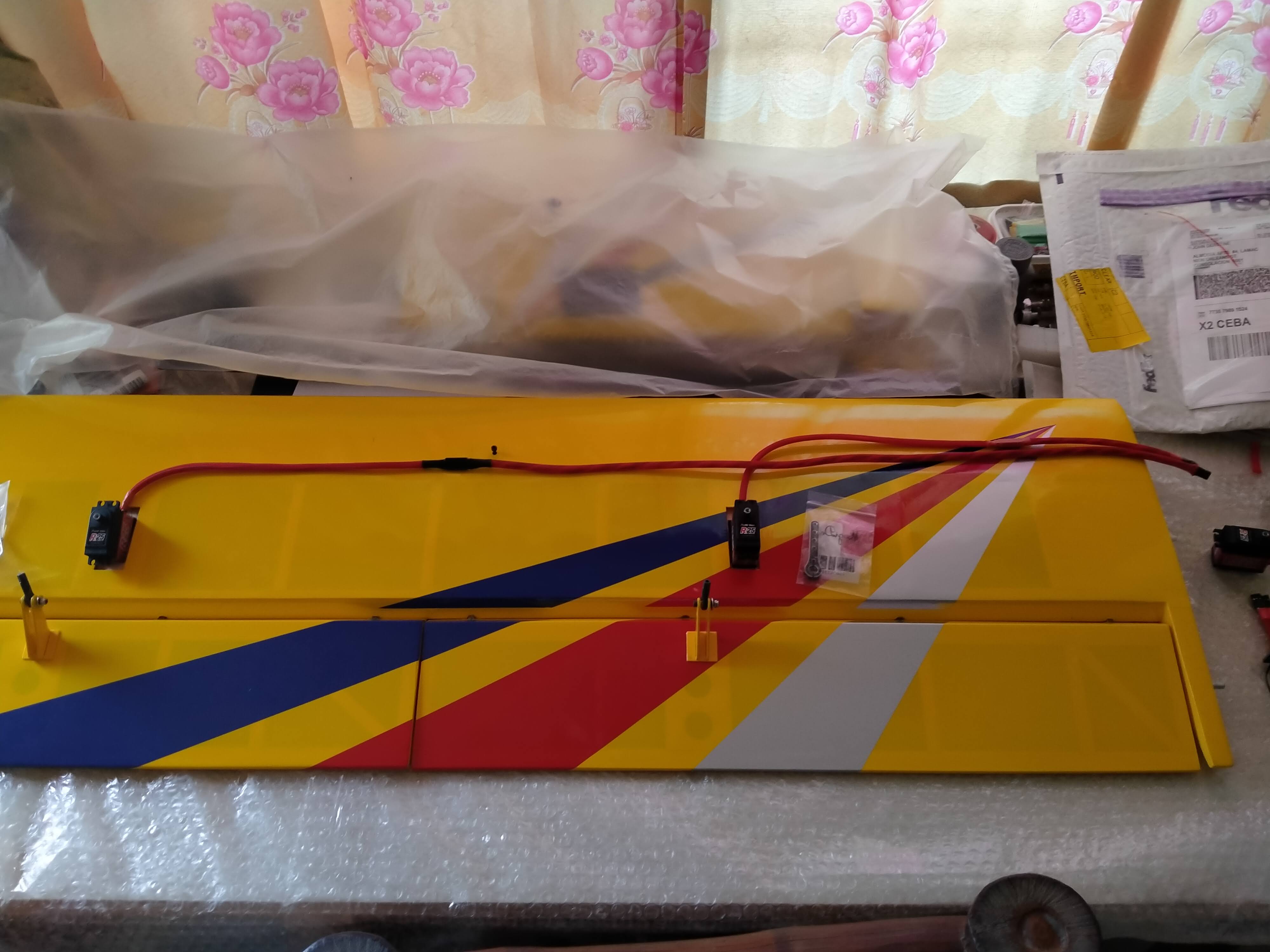

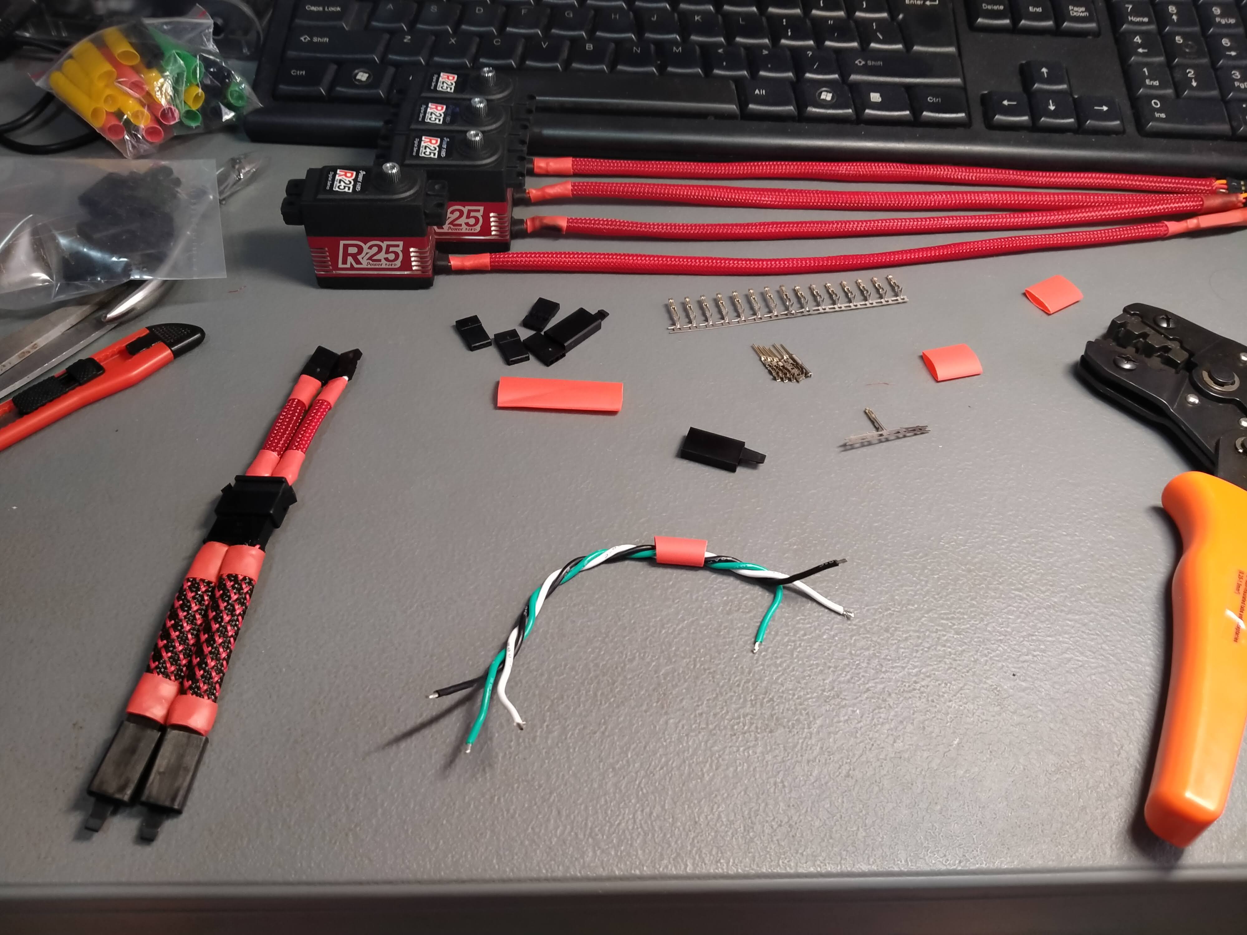

fun with wires today, got the wing harnesses fabricated, actually installed two wing servos without radio to see the geometry. using top hole in horn and a 1 3/4" spacing on a 2" arm seems to give 98% max throw or so. not sure how the geometry will work, I think that is ok, correct me if I'm not remembering correctly. seems the alignment is off so I'm splitting differences, won't know until I plug it in, detach the servo arm and get endpoints.
