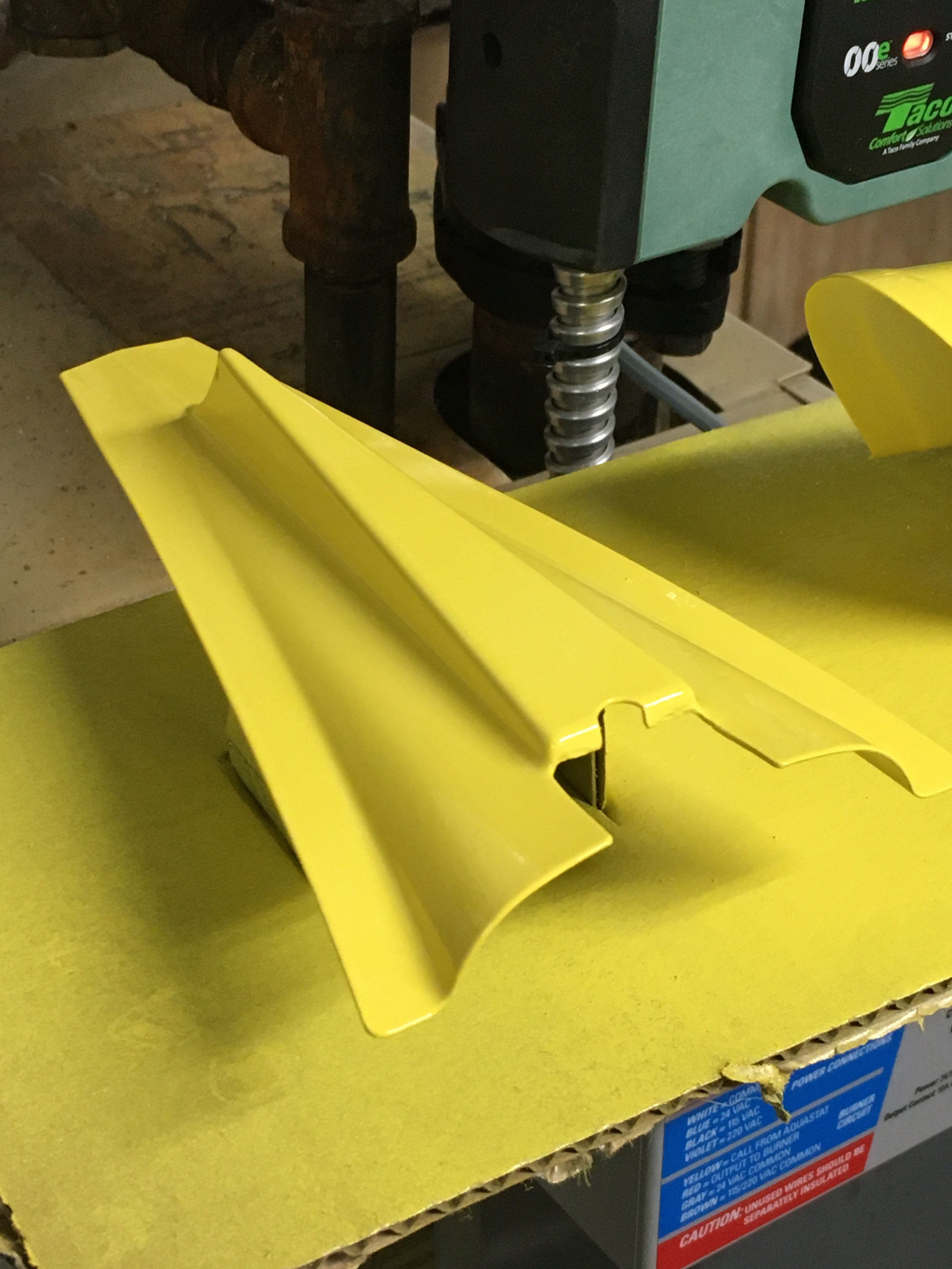

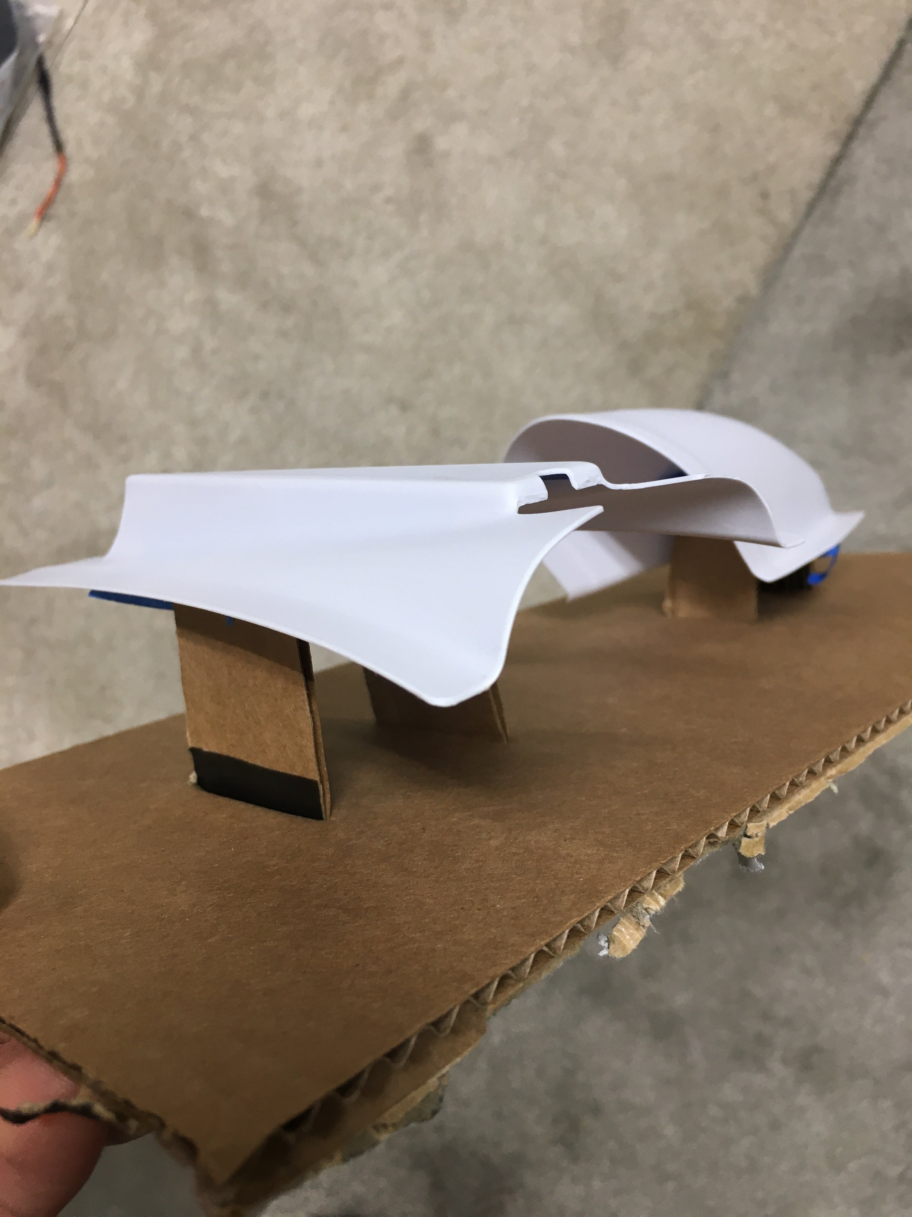

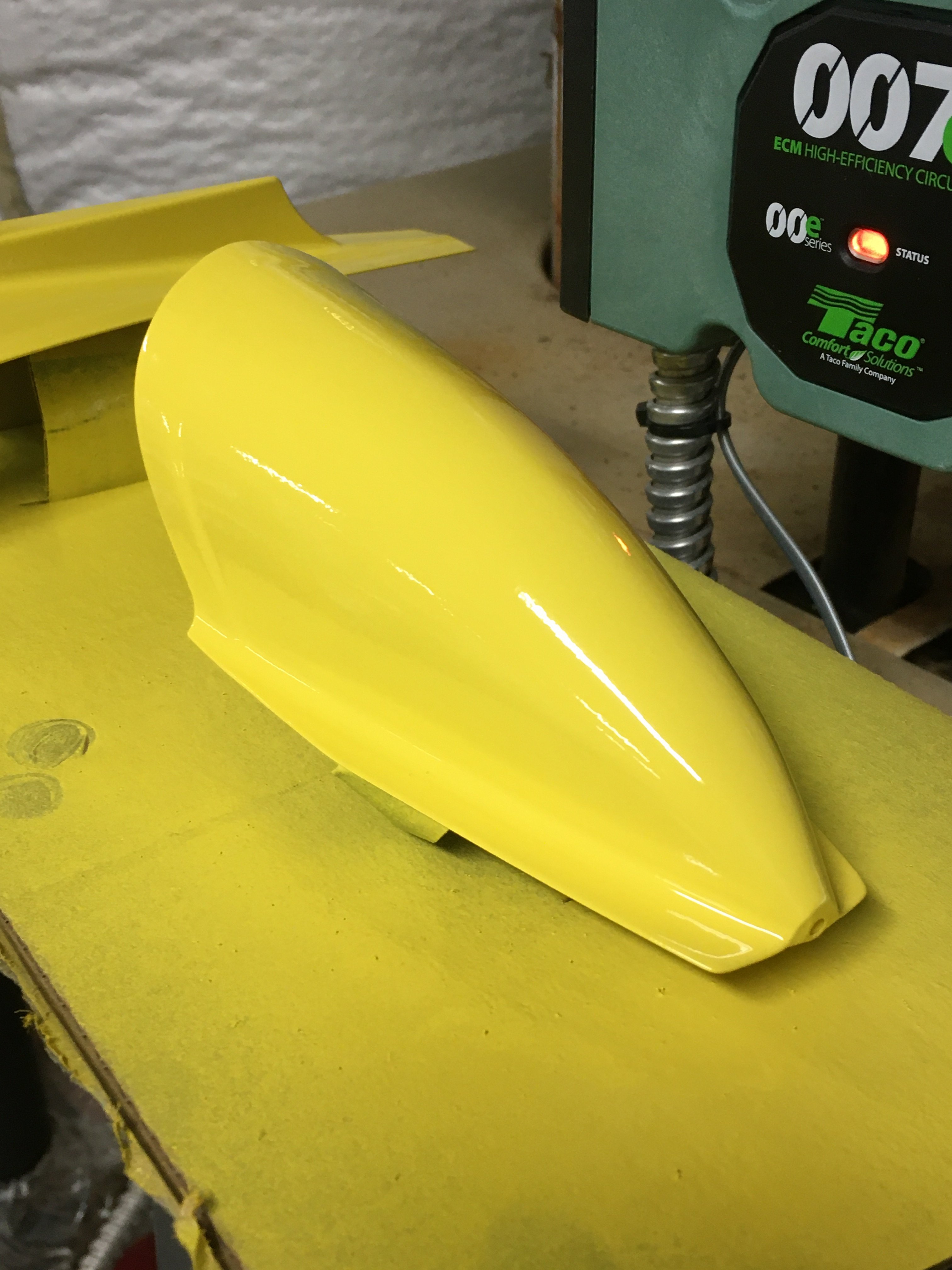

Painted the tail cone with 3 coats of sun yellow enamel. Going to let it sit for a few days and then add a blue stripe.

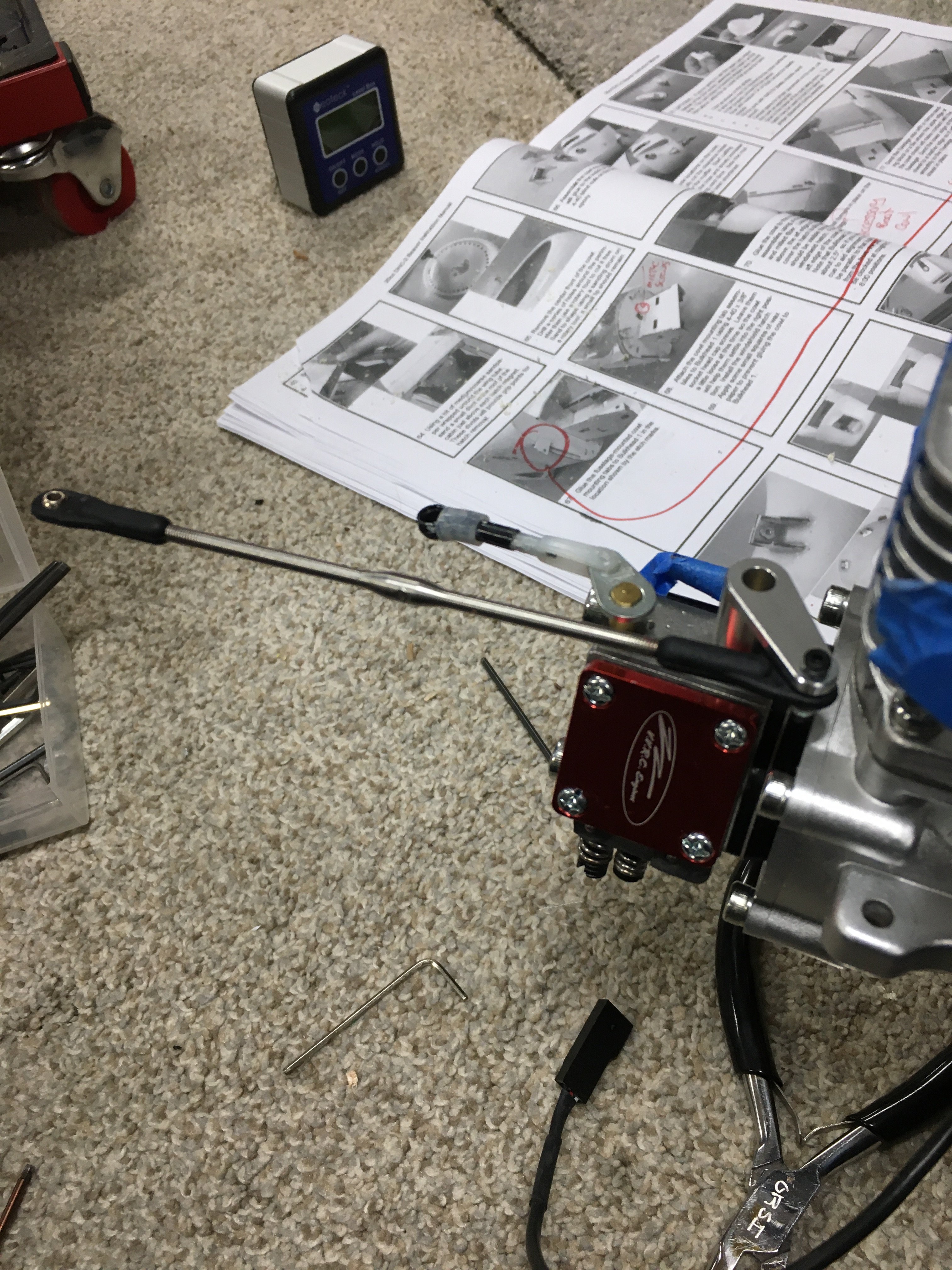

Finally reached a point in the build where I felt it was time to install the engine!

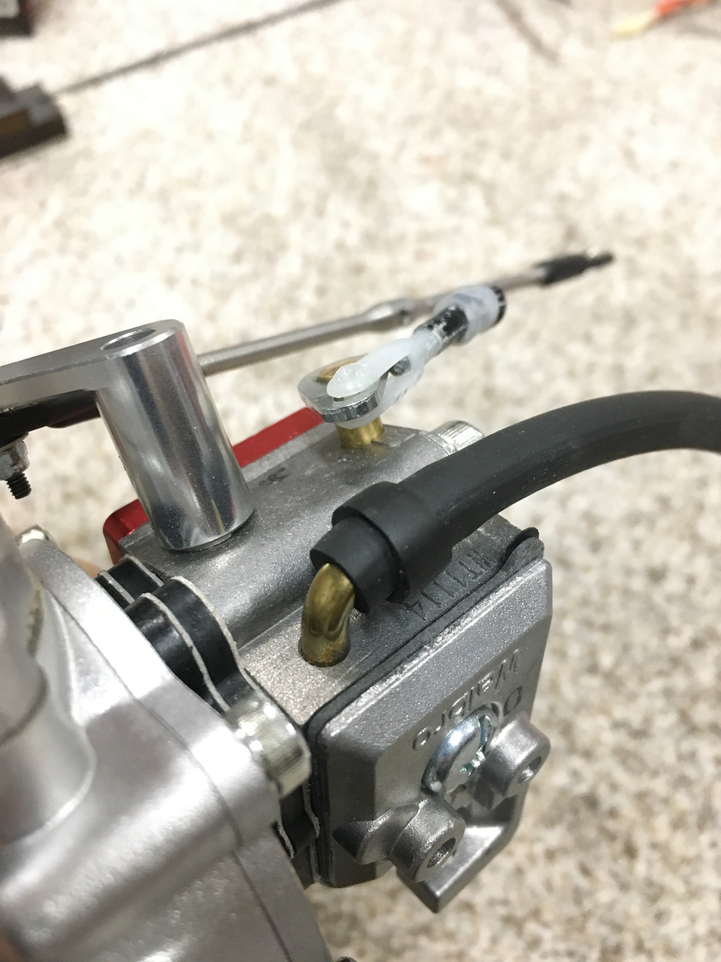

Used a nylon clevis and a ball link for the choke.
throttle arm was from stuff I had lying around with 2mm ball links. VVRC extended throttle carb arm.
Put a piece of Viton fuel tubing on.

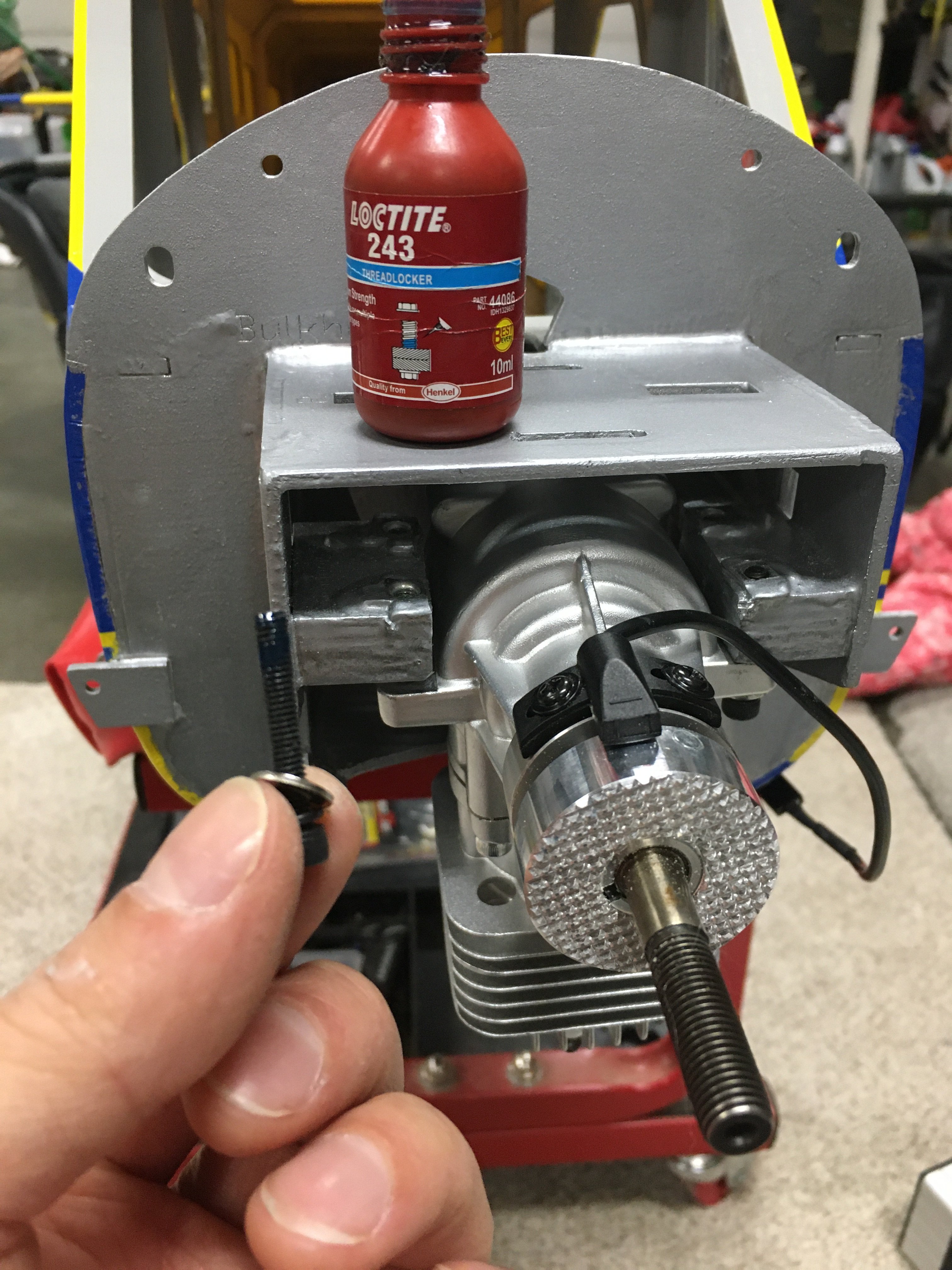

then with a dab of locktite, put the engine on wit the supplied bolts

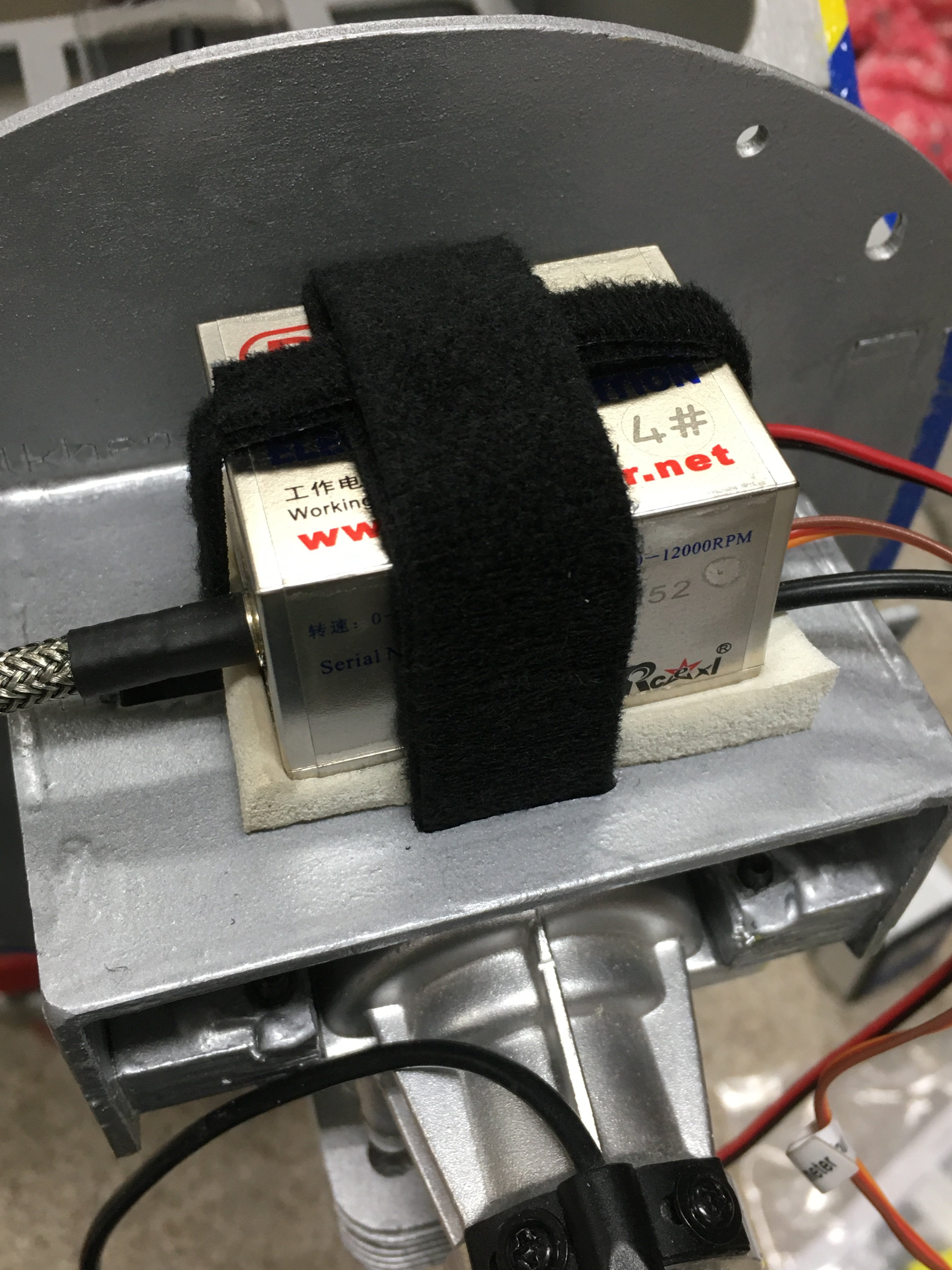

AKNick

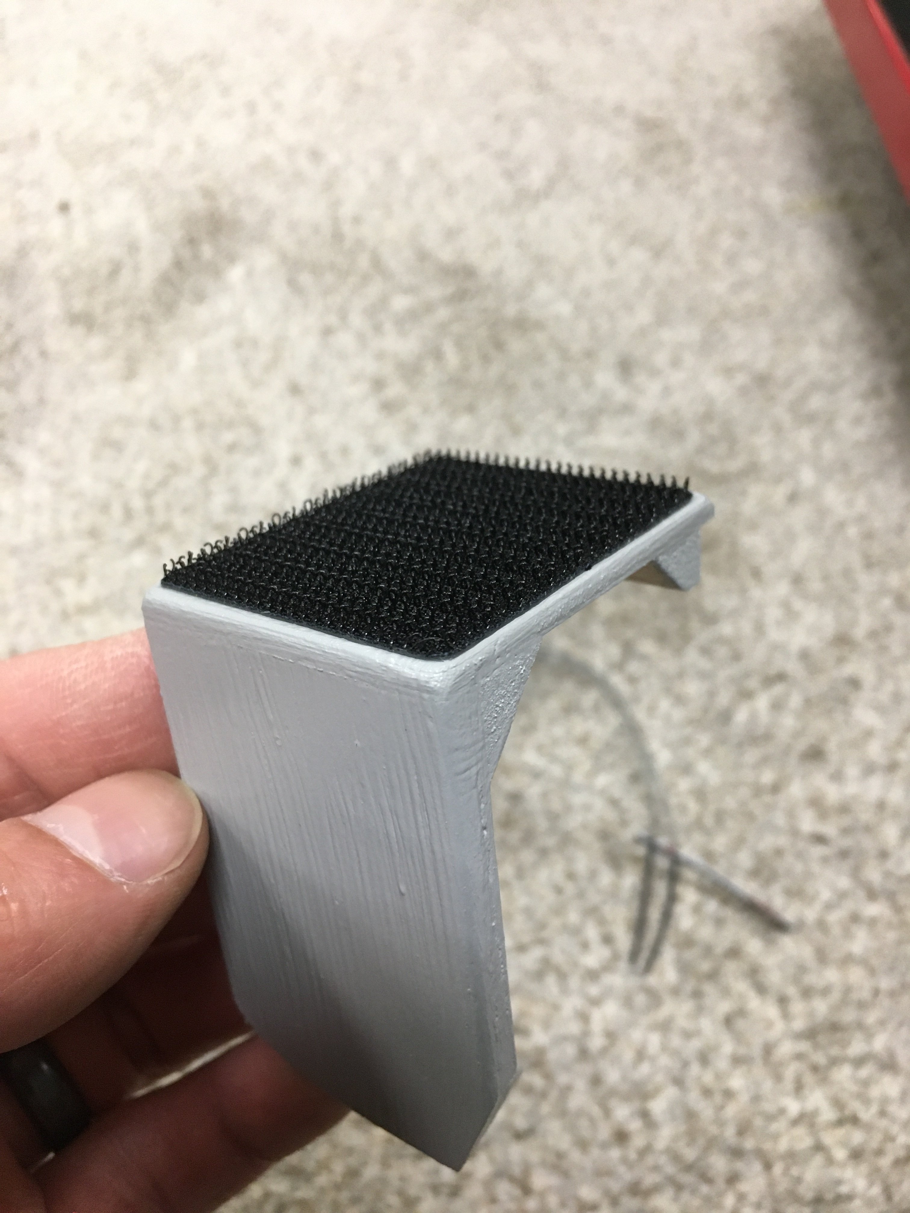

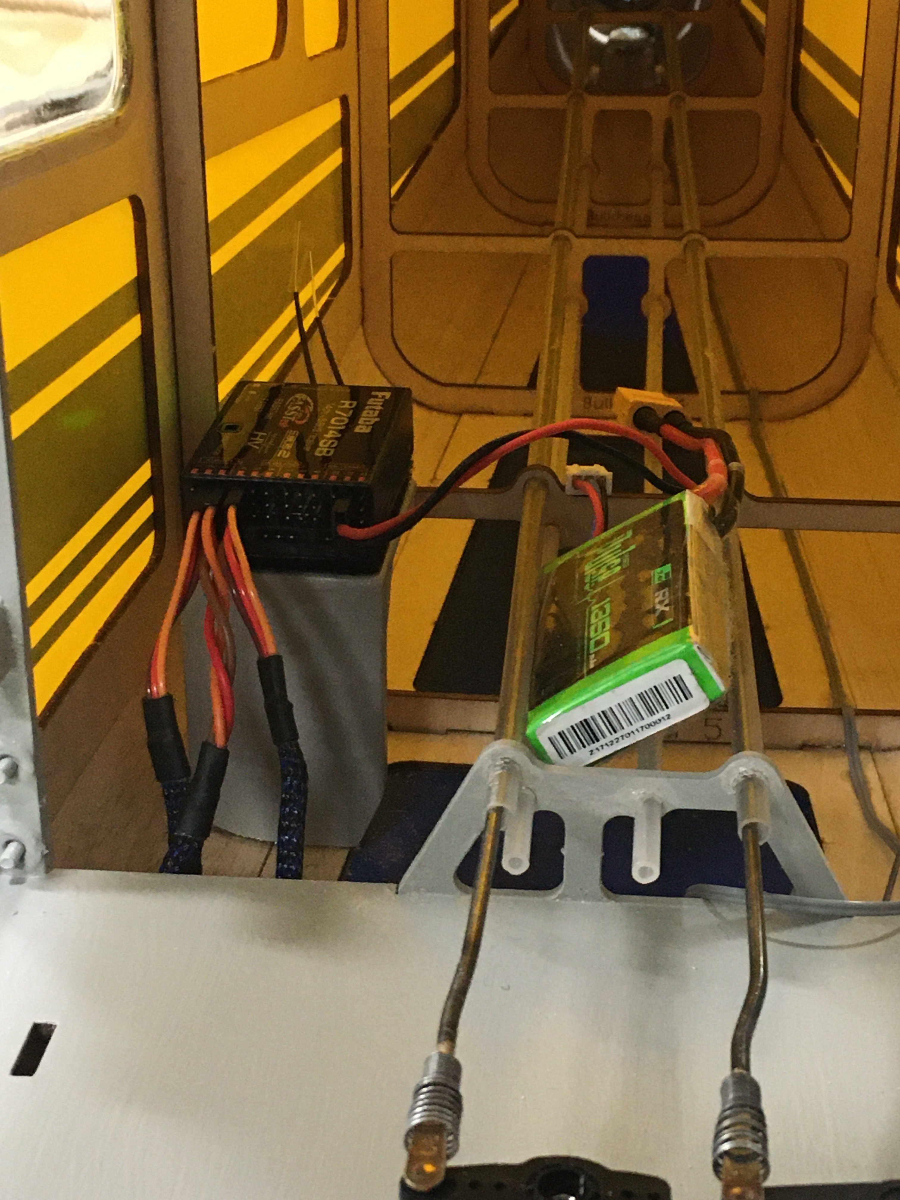

mounted the ignition module with dubro foam and velcro.

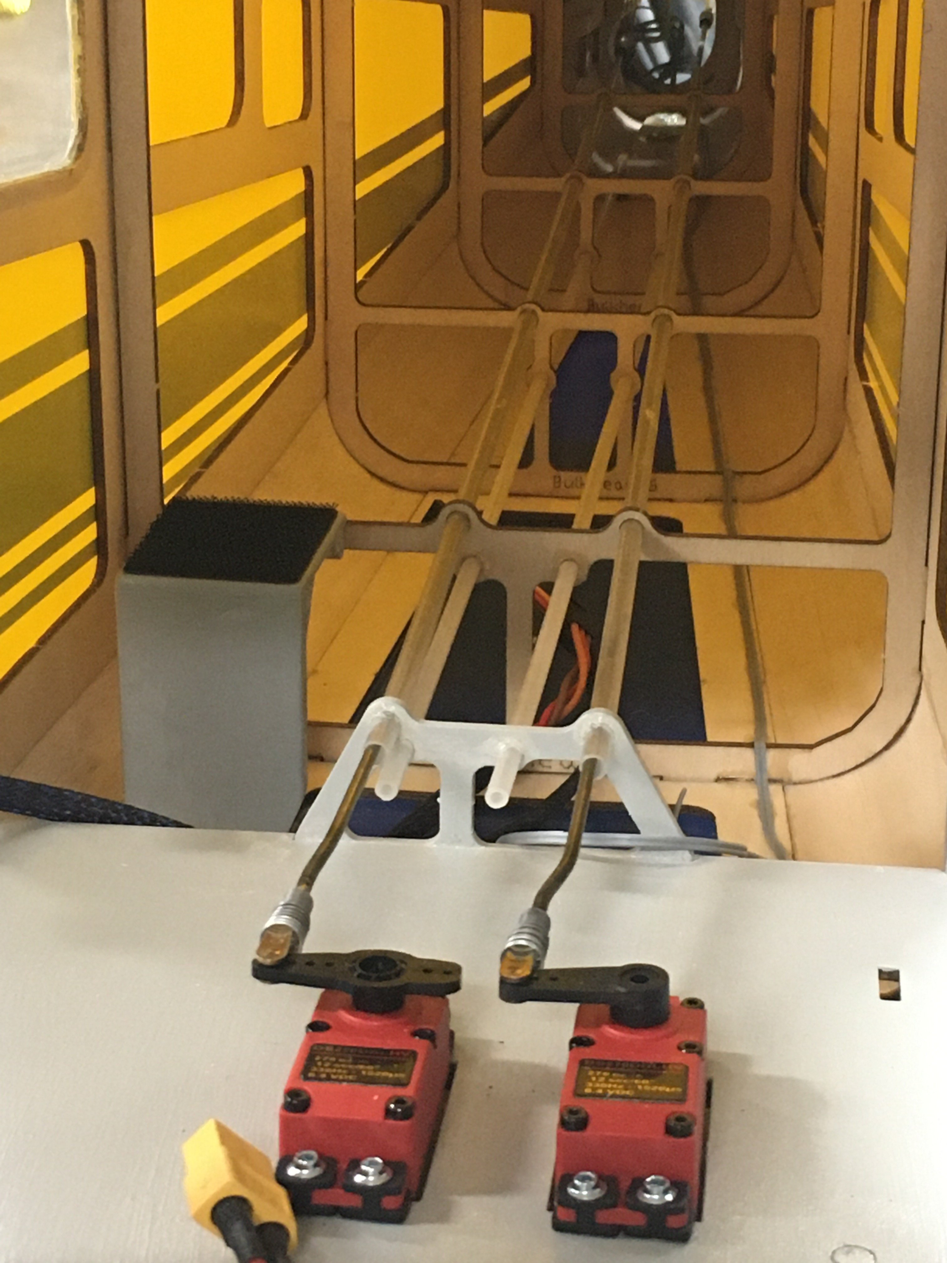

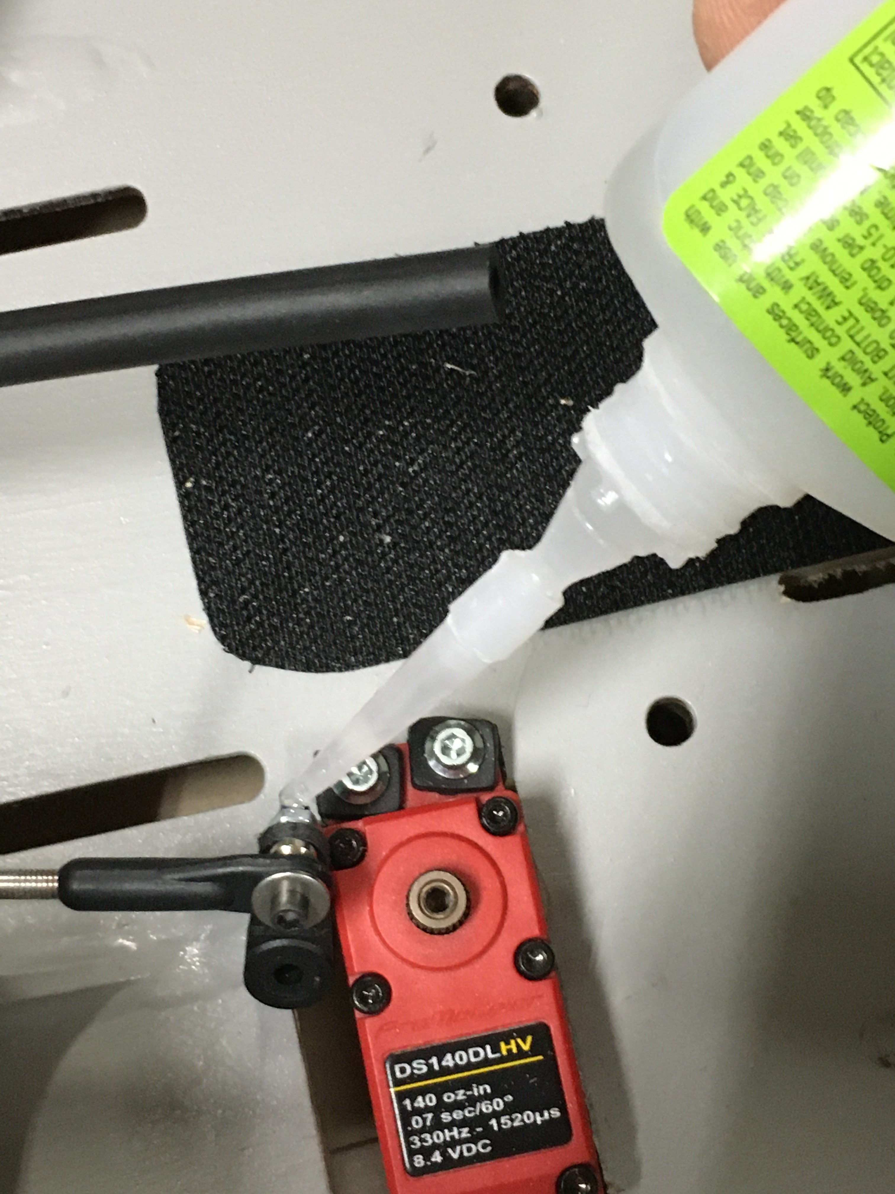

Got the throttle linkage on. Note a dab of medium CA on the nut.

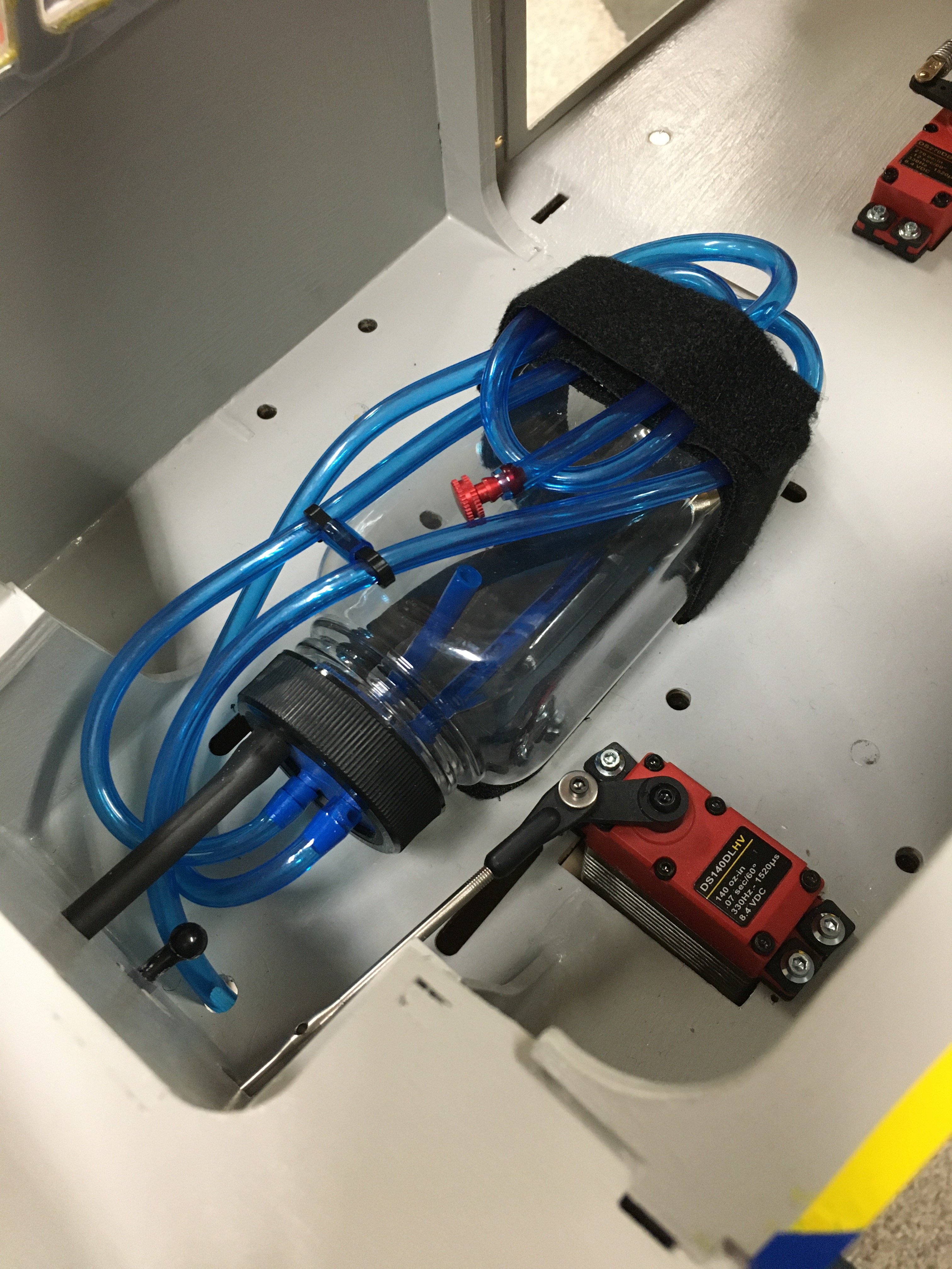

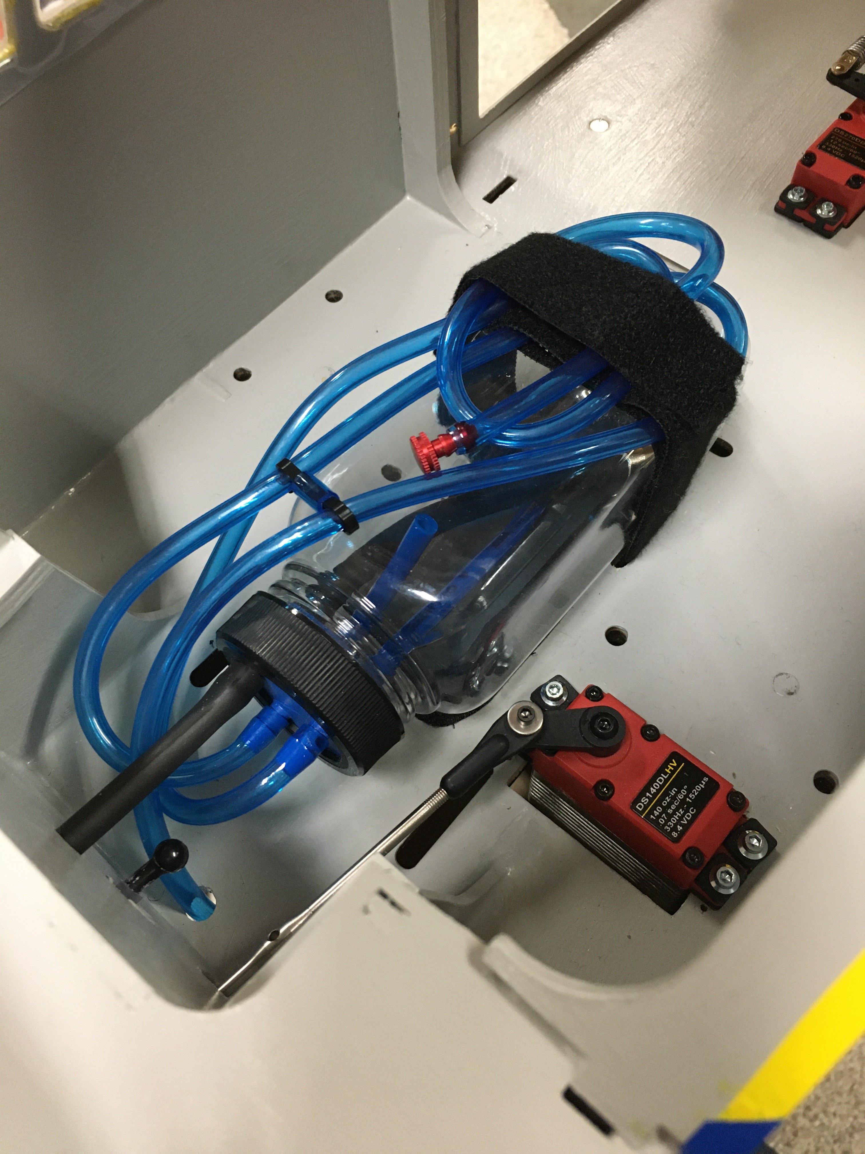

Put the fuel tank in. Using a 8oz V2 fortitude tank. Not quite sure where my fill line will go, so I just coiled it up for now.

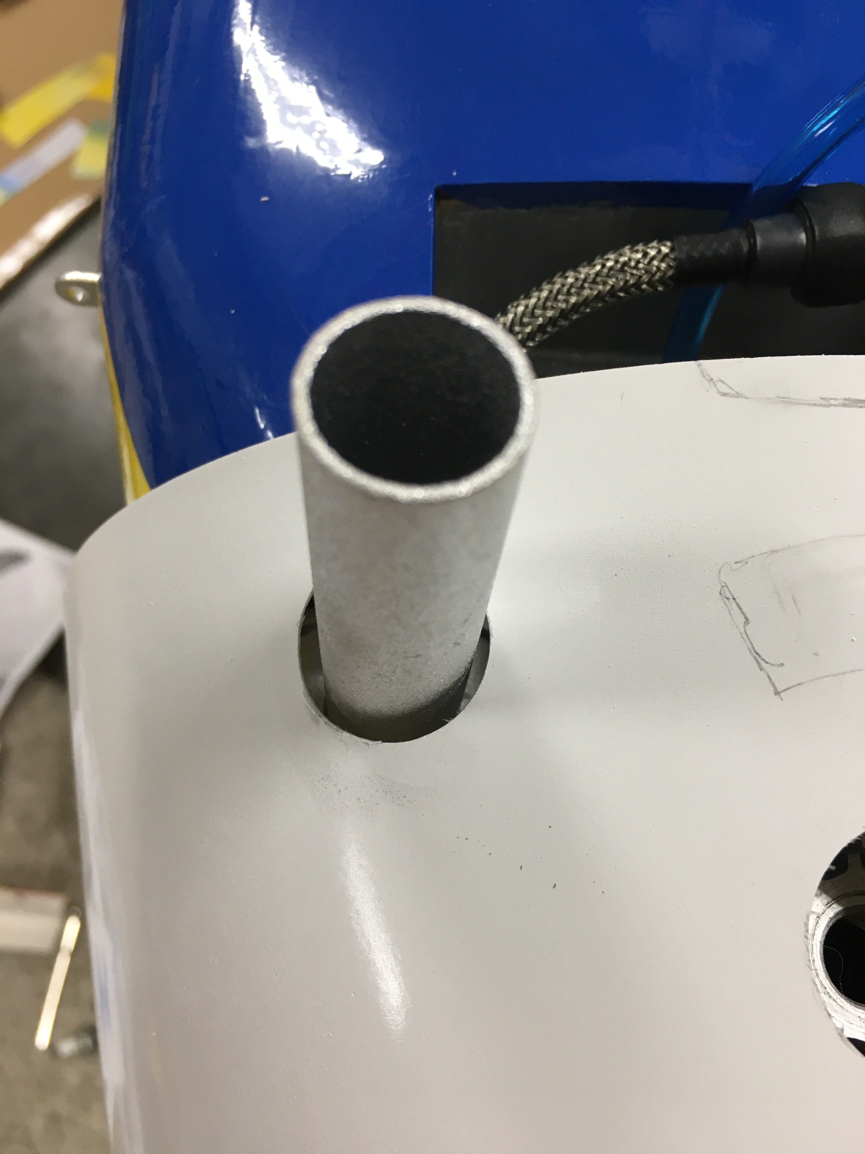

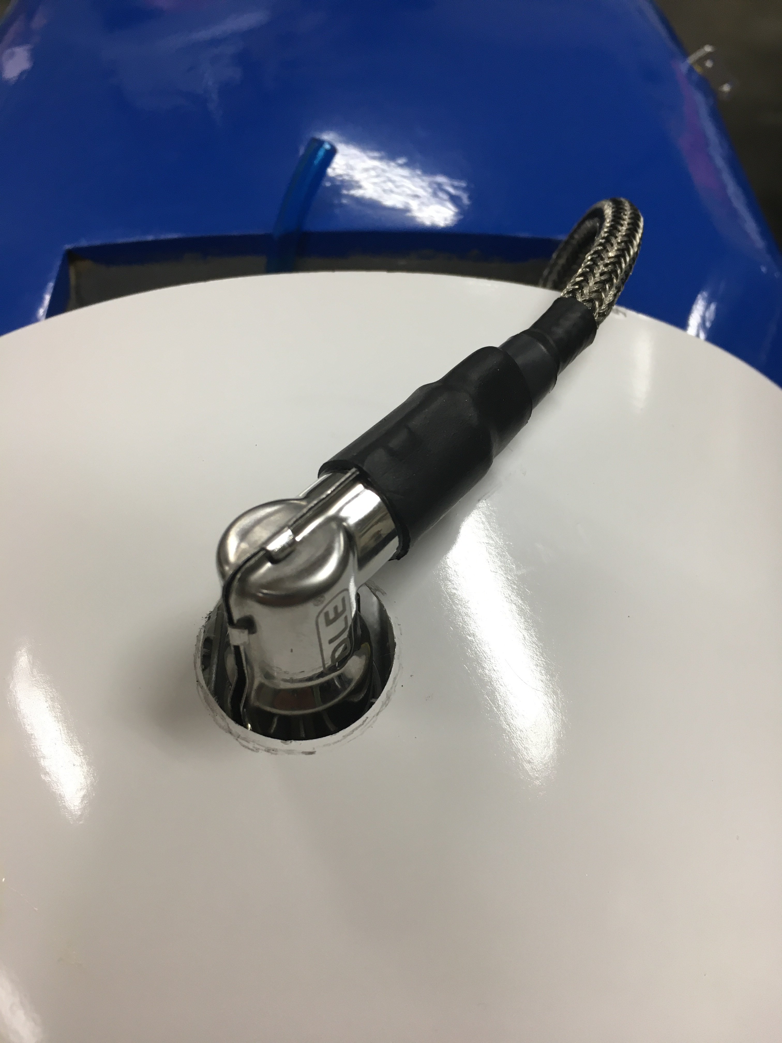

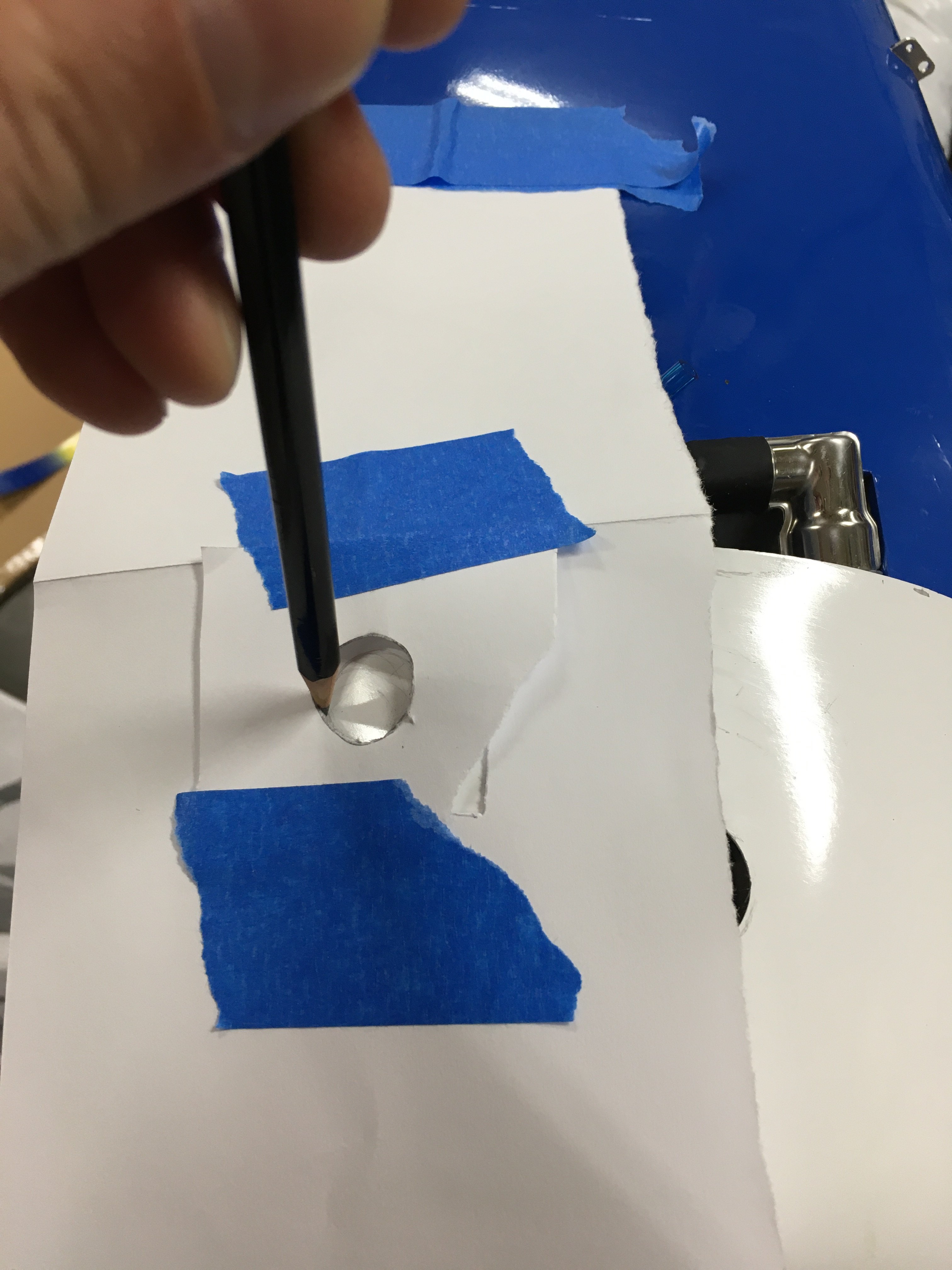

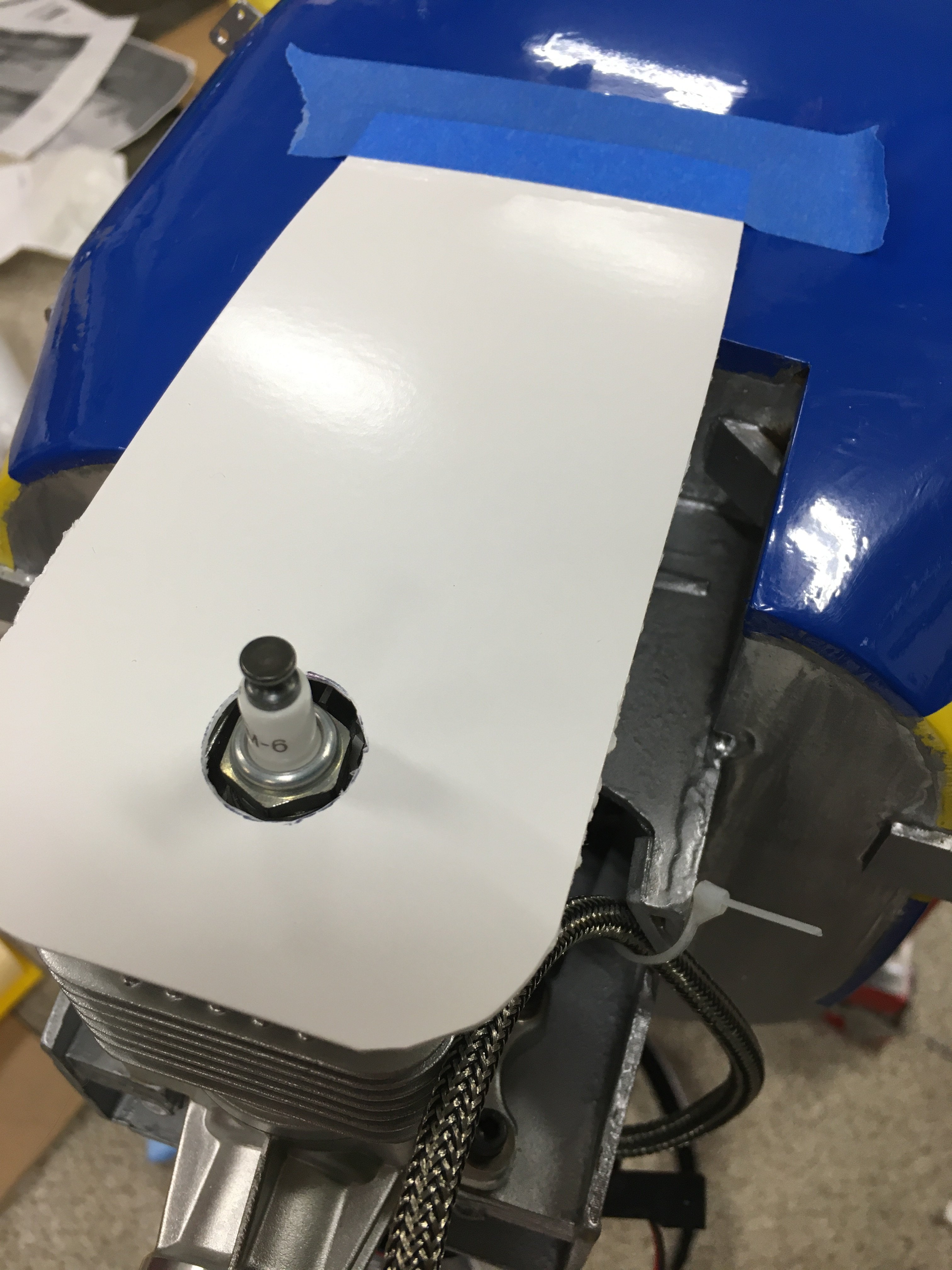

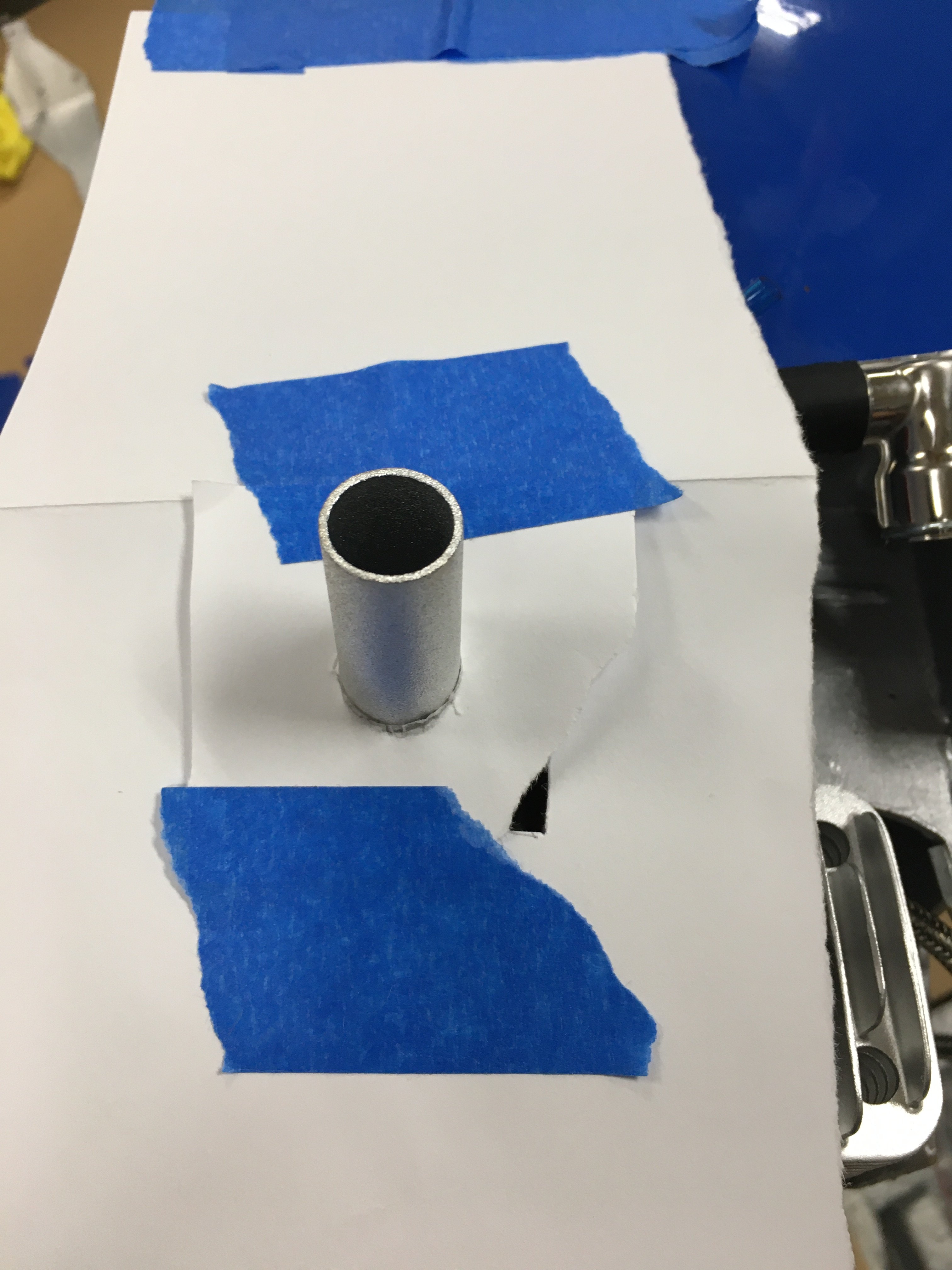

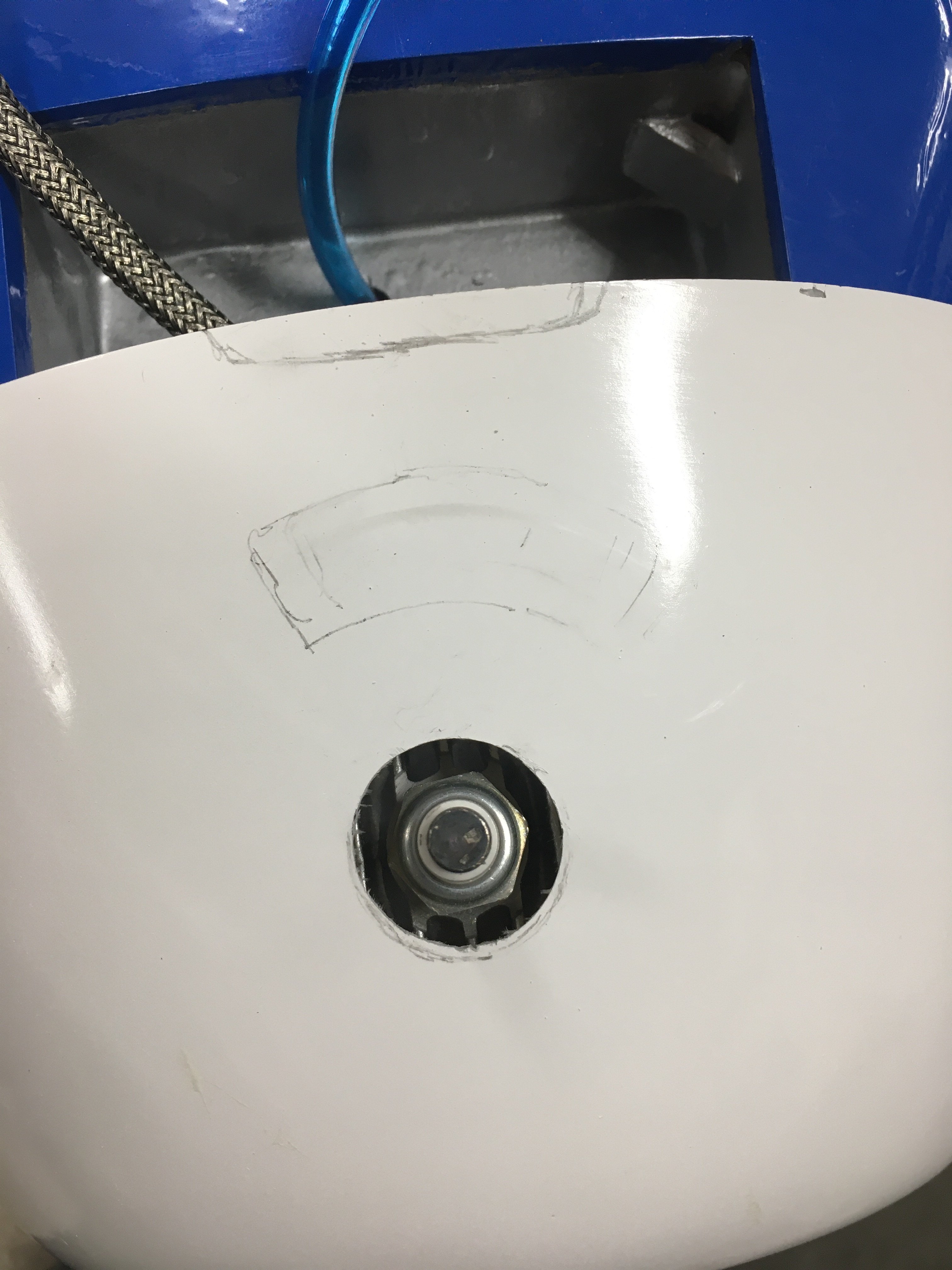

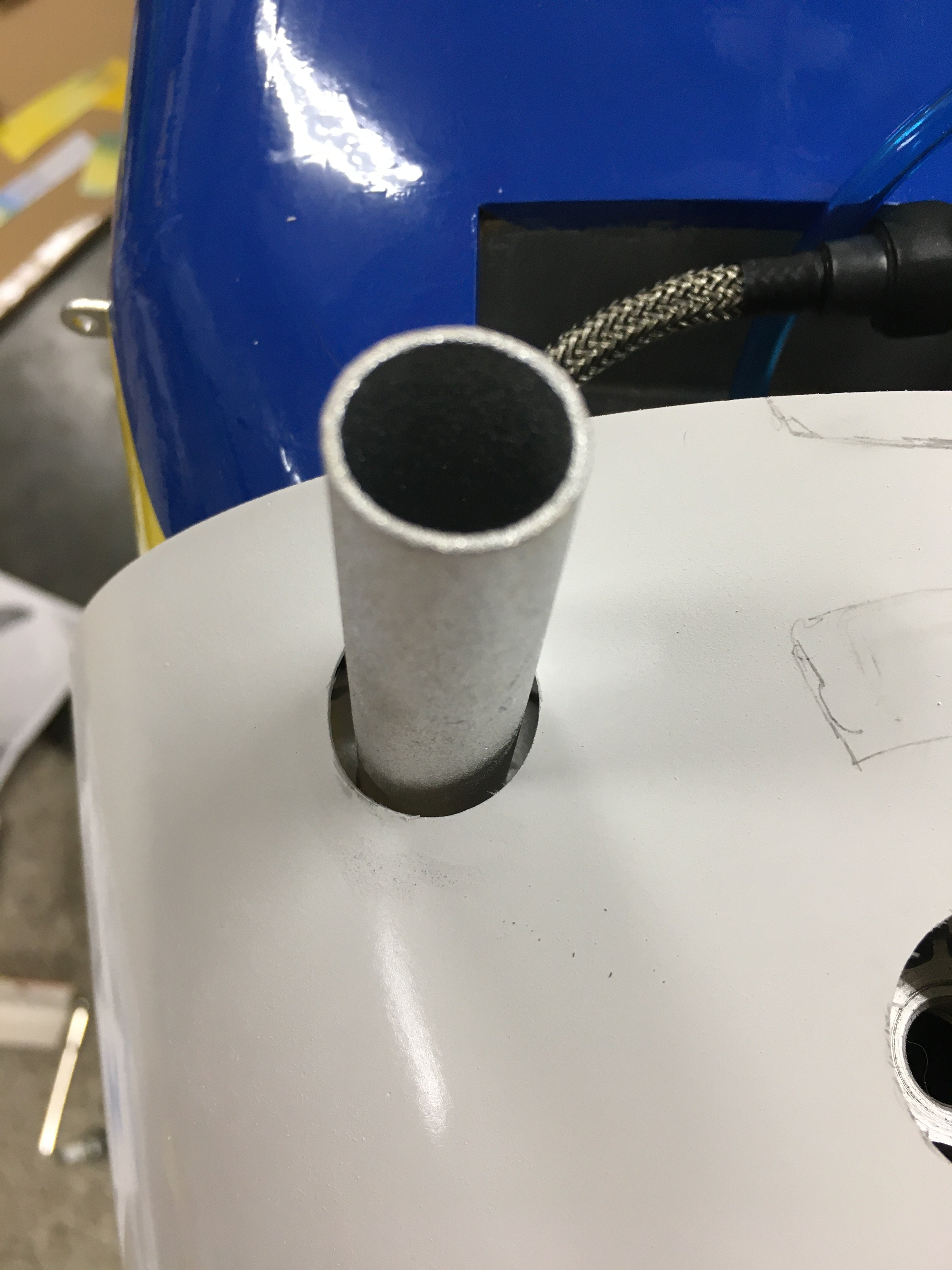

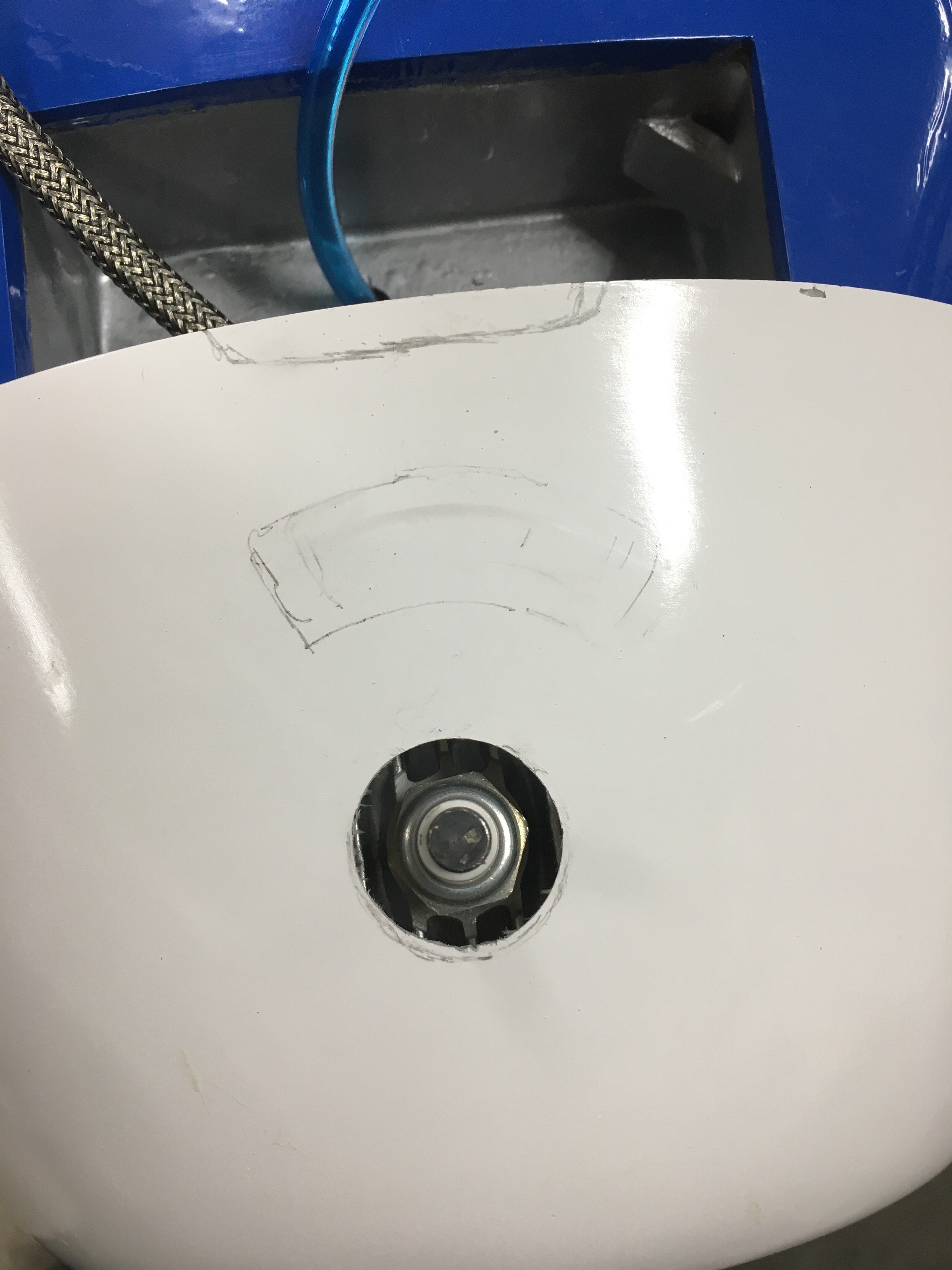

Trimming the cowl up with the DLE20. Nothing too exciting here, made a nice cutout for the plug and marked where the cap rubs. If I secure the ignition lead off to the side I don’t have to cut anything. Not quite sure which way I want to go.
