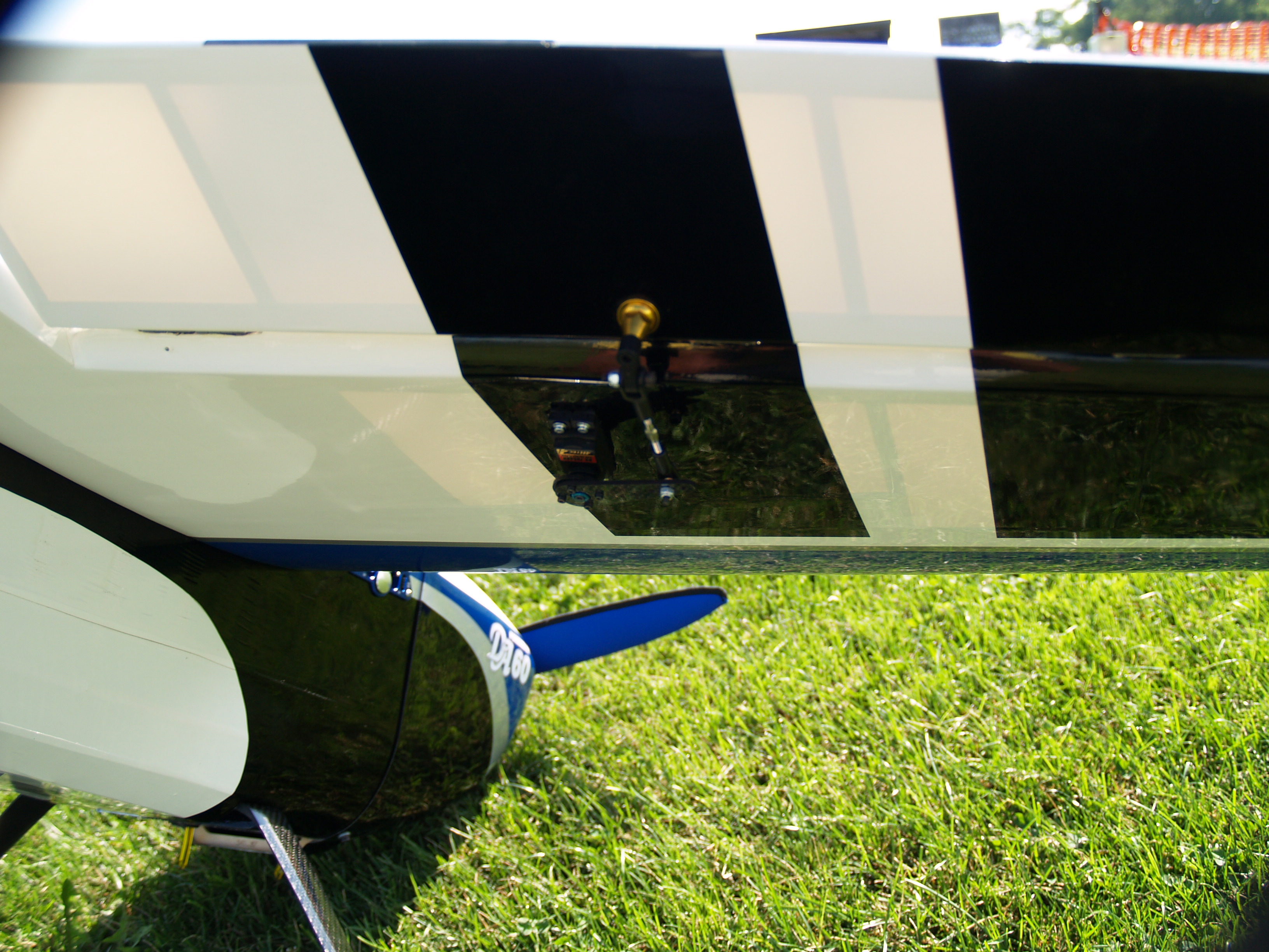

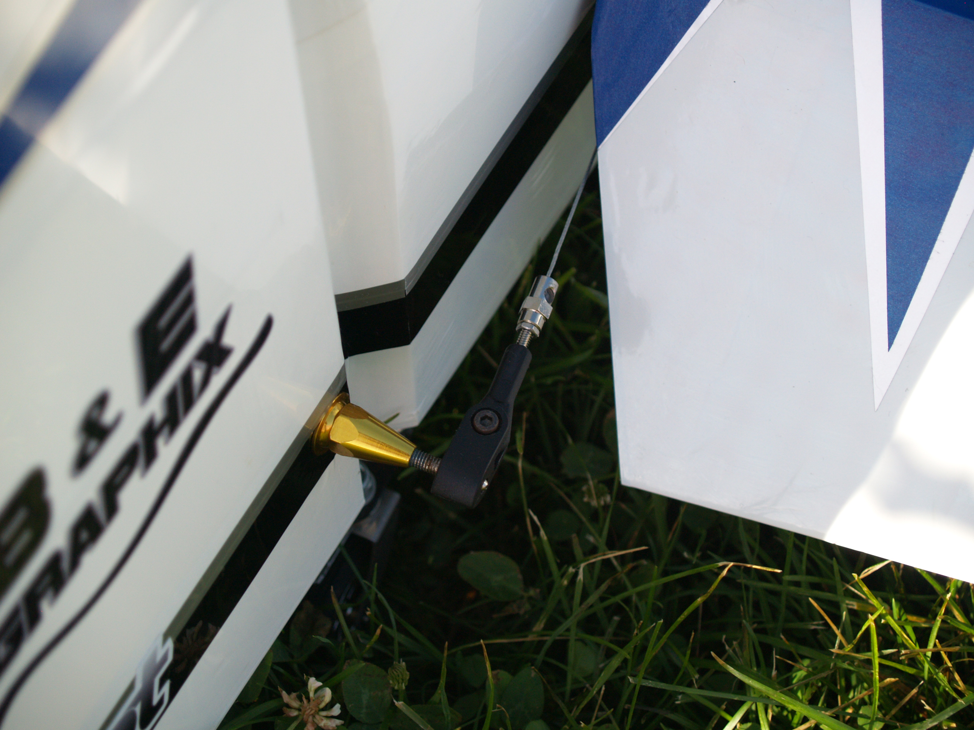

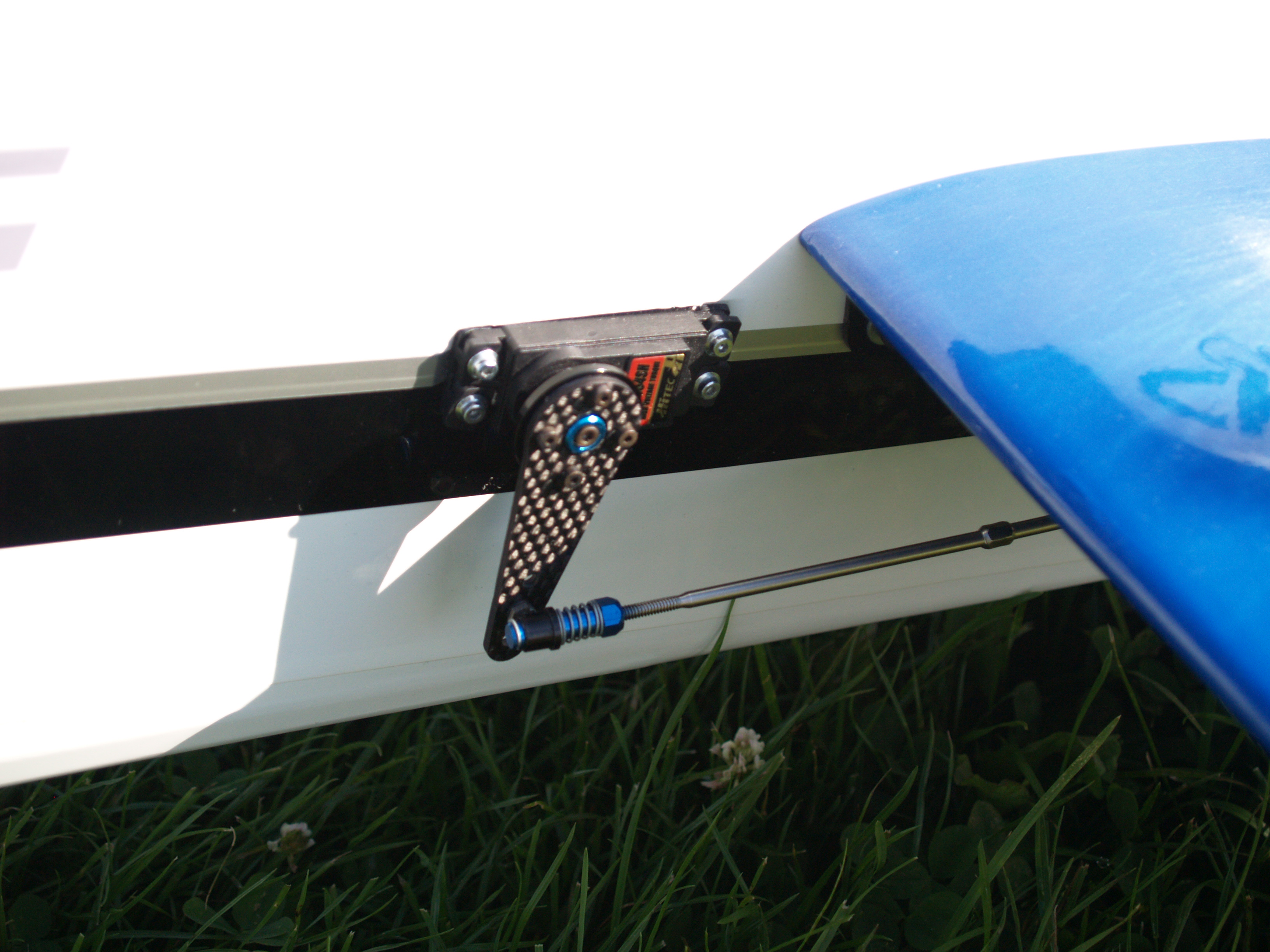

O.K., a couple cold one's down, time to build some more. You have seen most of the fuselage mods, now let's move on to control surfaces. The Carbon EDGE is using Hitec HS-7954SH servos on all control surfaces. The carbon fiber control arms are mounted to aluminum servo spools, both the arms and spools were bought from [MENTION=2470]RedwingRC[/MENTION]. I went a different route for the control surface mounting and used adjustable servo horns on all surfaces instead of the stock horns, except the rudder pull pull which we already covered. On the elevators, I used Sullivan spring loaded servo arm linkage mounts on the servo arm attachment end so it is easy to remove the elevator assembly for transportation. What a time saver!!! The controls rods are the stock Pilot rods. They are threaded at both ends (4-40) and have a hex in the center for adjustment. I think this combination of components worked really well for the control surfaces on the Carbon EDGE. Servos have more than enough speed, torque and travel for the 50cc size surfaces, the linkage set up seems to perform really well in terms of response, throw, ease of adjustment and field assembly. I also used the [MENTION=2470]RedwingRC[/MENTION] cam lock wing locking system instead of standard wing bolts. Pilot 50cc and up size planes use two wing bolts per wing, just so you know what to expect. I can literally have this plane ready to fly at the field in less than 15 minutes.
