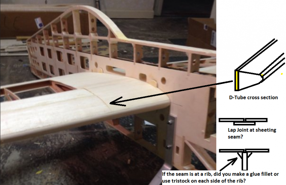

Here's a pic of the wing area I am describing.
daman691003
Yes I did the 3rd. And it was because of a mistake I made. I had to cut sheeting out to fix a bad glue joint. The doubler for the wing wasn't sitting square. My fault.
