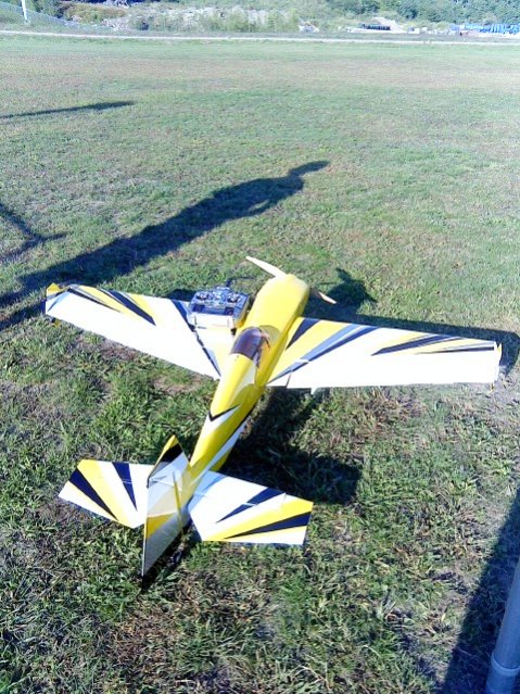

Boring :sadface: 58 edge.jpg

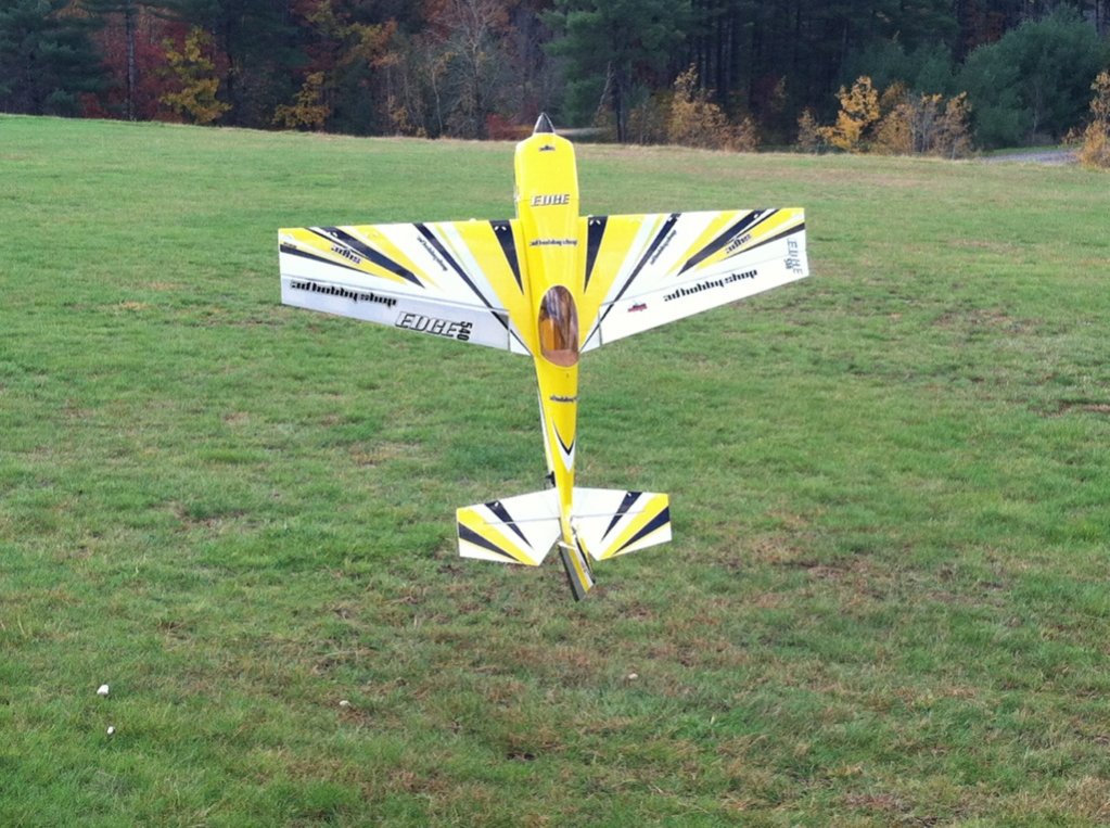

FUN!!! :peace:58 edge 2.jpg

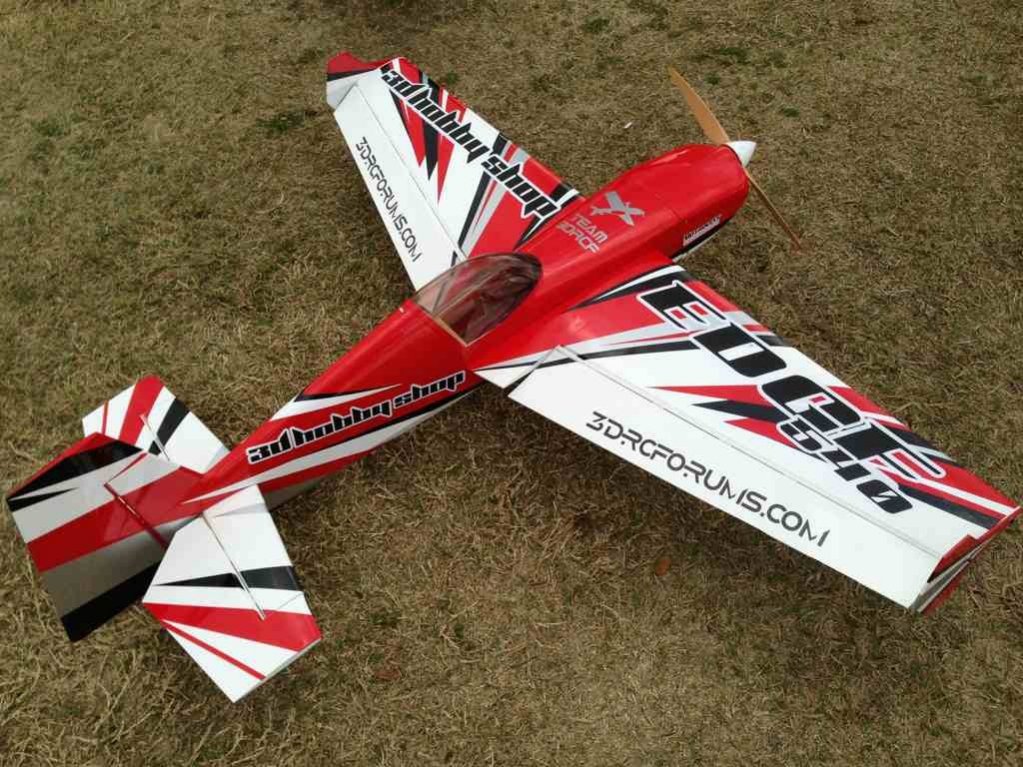

My beloved 58" Only one i have left right now. Powered by motrolfly and CC ice lite 100 running 4s 4000. I did the LG mod what a difference when taxing on grass. Can you tell The fuse has been snapped in half? If you look where the wings meet the fuse theres black ultracote, I ran out of red. P.s The canopy isn't fully latched in the pic.
The LG mod is just making a shim for the LG to give it a forward angle. I made a about 1/8 inch shim. Ever notice the prop likes to eat dust when taxing or landing. This helps alot. The 55" had the same problem. Heres a quick pic. dont mind the electrical tape, I have a stress fracture. also running 4s, I can afford the weight. lol
Also I added a carbon fiber braces after i snapped the fuse. works great and more ridged.
