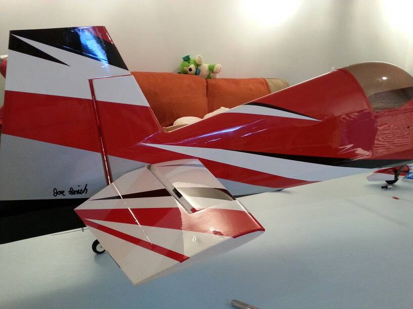

If I can get off this friggin Conf call for work I'm gonna start my build. Got everything for 42 slick and everything minus batteries for the 58 edge!
That motrofly 4315-480 is impressive just from its look and feel. Can't wait to fly it!!
On 6s what prop?
On 6s what prop?
On the 58" Edge I'd run the 15x8.
joshgluck
Getting there
Quick question
Is this plane supposed to include motor standoffs? I can't find them nor any with the 42 slick...
I don't remember this plane coming with any, but I'm not positive. I usually get my stand offs at Home Depot. They sell them in the hardware section, in little drawers next to the screws.
joshgluck
Any pics of the install with the motrofly? Head to lowest now
