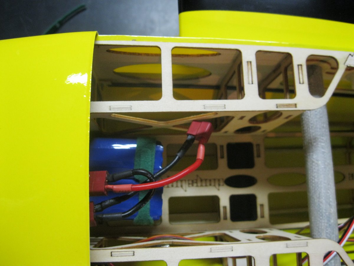

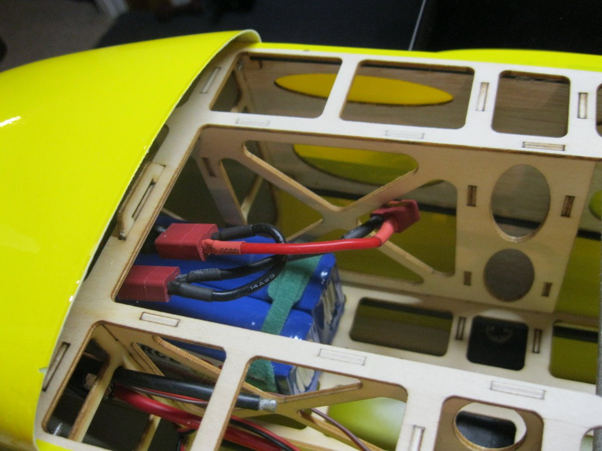

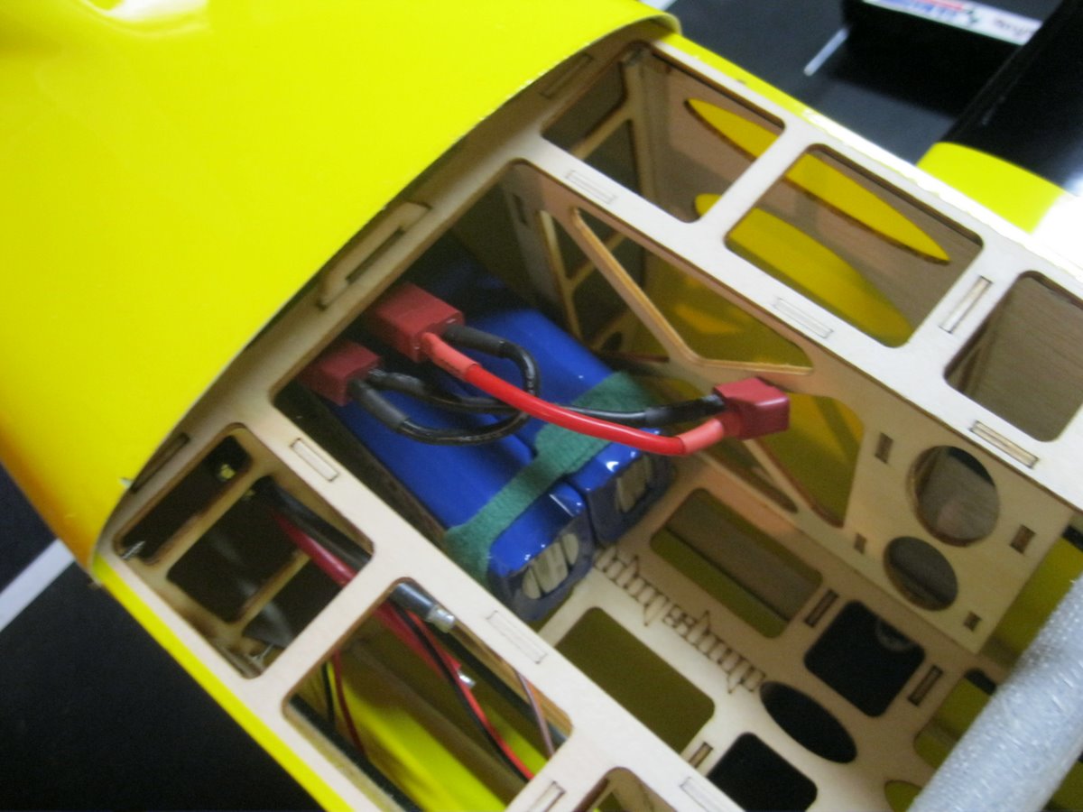

So can anyone with 6s help with battery placement, restraints and maybe a pic?
I've got a few pics of my 6s setup....

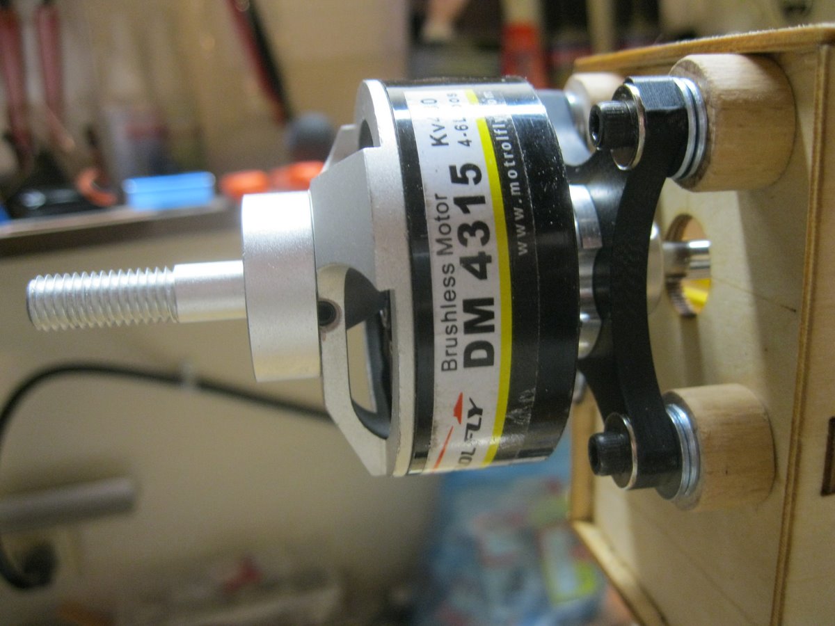

and one of the engine mounting for good measure ;)
I should say that since these photos were taken, the stock velcro has been replaced with super heavy duty 2" wide velcro for added security.
Also, there is a loop of HD velcro under the cowl that the battery "slides into" so the battery has a strap at the front and the back.

Thanks SnowDog! Pics are really helpful - Quick question: Did you add those washers on the motor mount to add more than the stock thrust angle or do you have the same number all around? Also on the battery mount, I'll post pics of mine later.. did you put a velcro strip along the bottom too or are you just using the straps? I'm using 1 6s 3300 bat so I ran velcro the entire length up and then straps around them too.. It might just be that my straps need to be replaced with better ones.
Thanks!
Josh,
The washers are equal all around and were done to get the spinner gap correct...since the nylon spacers that I bought from the hardware store were a little shorter than what I needed, I decided to add a few washers to each spacer instead of buying longer spacers and sanding them down.
The battery tray does have a velcro strip down the middle and the battery pack has velcro as well. I would suggest to upgrade your velcro straps...the ones that come with the plane are really not strong enough IMHO. I found 2" HD Velcro from Home Depot and that is what I'm using on all my planes now for battery straps.
