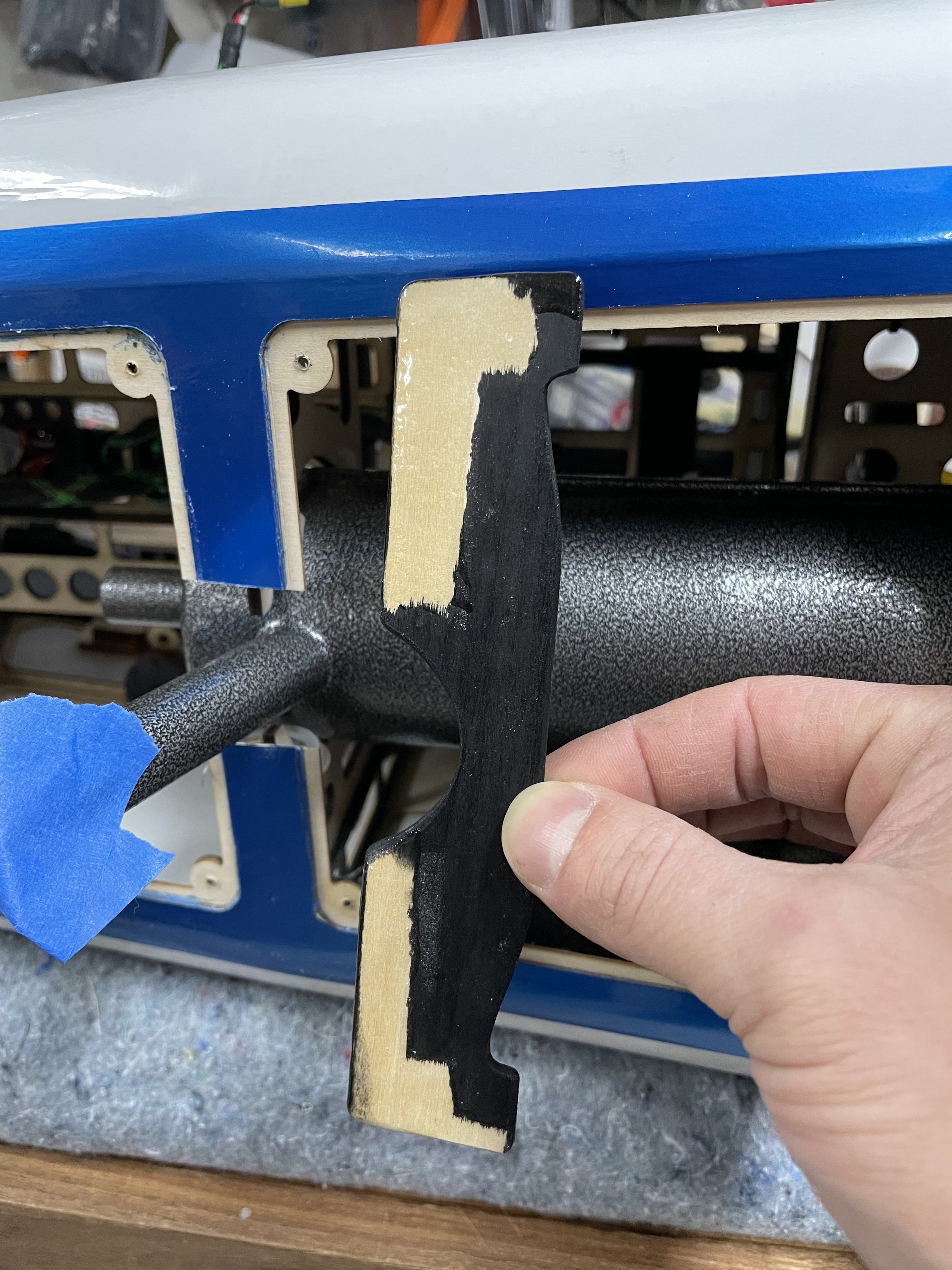

I'm getting some exhaust residue inside the empennage through the tunnel covers. Thinking I need to block it off. I cannot think of any reason to have air go back there anyways. Dirty air at that.

I prefer rear exhaust canisters for that reason, I want the exhaust to exit to a spot where I don't have to worry about oils/heat entering the fuse.
