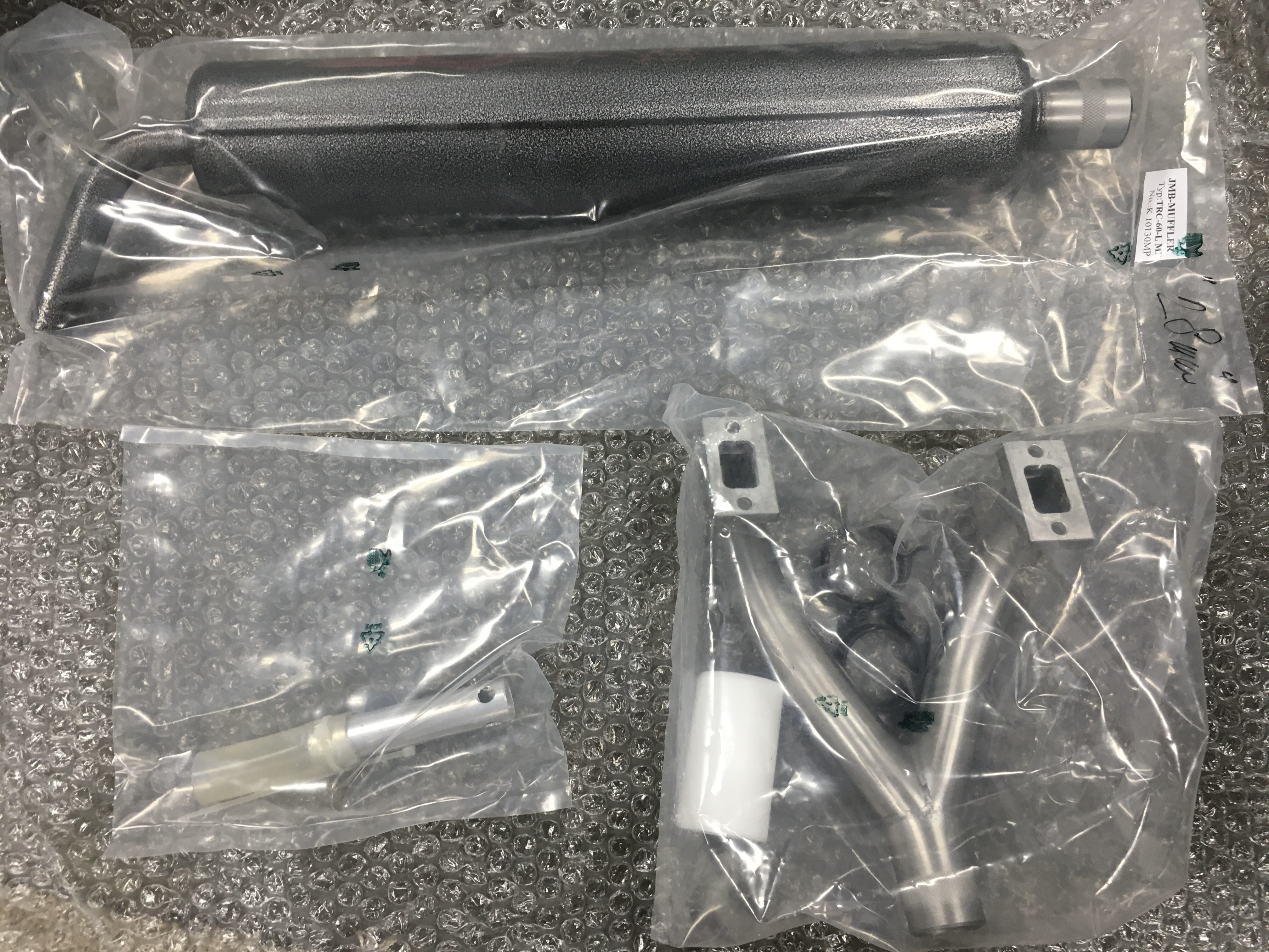

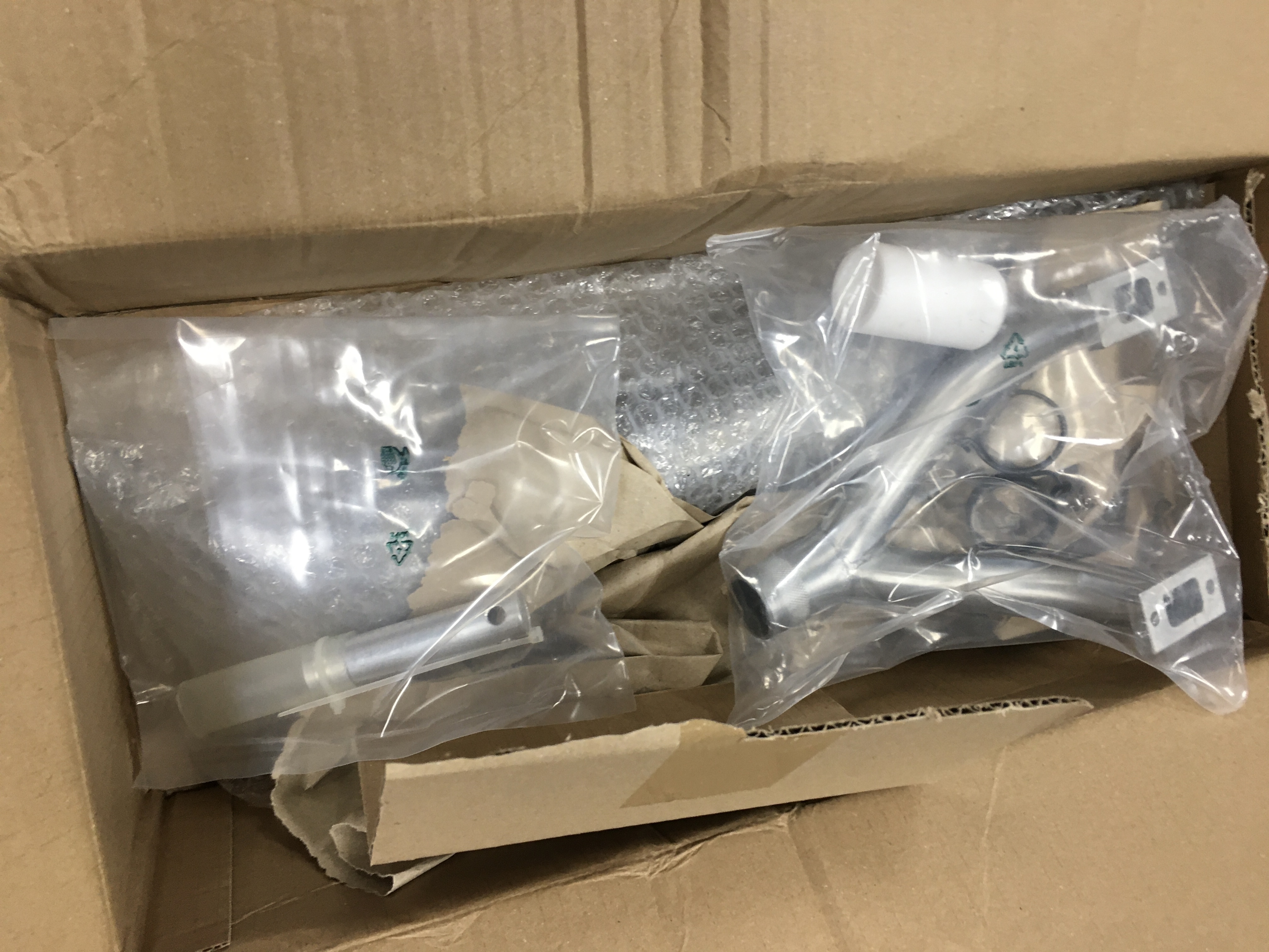

The wait has ended! Well sorta, I had to go to work. But was able to get a couple photos of the new JMB custom exhaust.
everything looks good at first glance and the canister resting on a paper towel. I cannot wait to get home and really check it out.

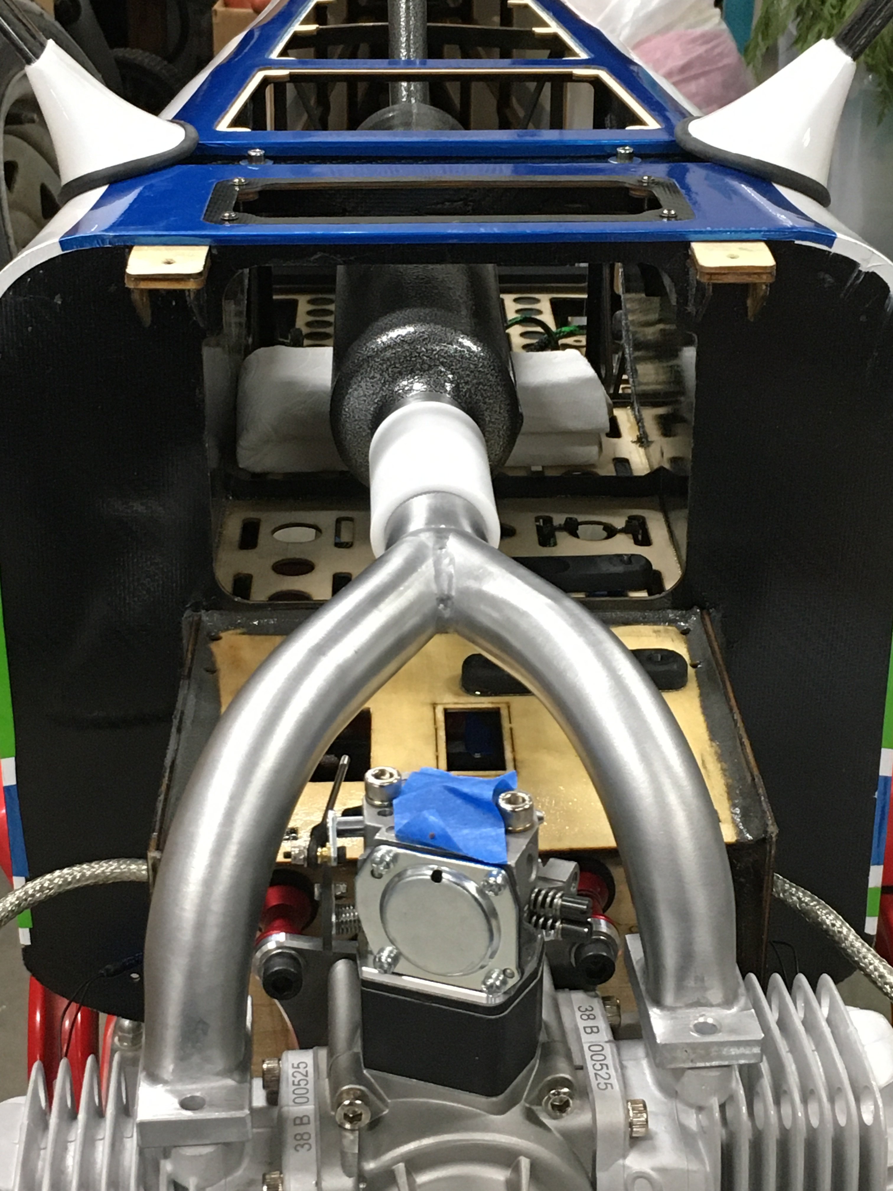

Got home from work, product looks fabulous. One little problem, the bolts don't fit very well... I've fiddled with it all night after my swing shift and cannot seem to make sense of it. Have to squeeze the flanges together 1-2mm to make the bolts spin freely but the cannister is at an angle down the tunnel. If I only bolt the rear flange it lines up just perfect - makes me think the front flange is cantered a bit. This is my first cannister setup so maybe there is more fiddling to it than I anticipated, but at any rate the bolts need to line up freely so I don't crack out the exhaust. Regardless some filing will be involved.... Hmmmm off to bed for a fresh mind in the morning.

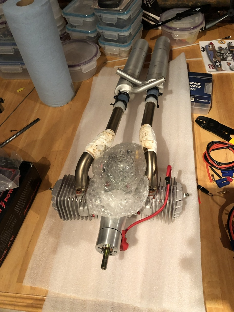

The canister has some movement with the header pipe on my DA100/MTW exhaust.
Looks like an additional piece is included between the header pipe and the canister versus your setup.

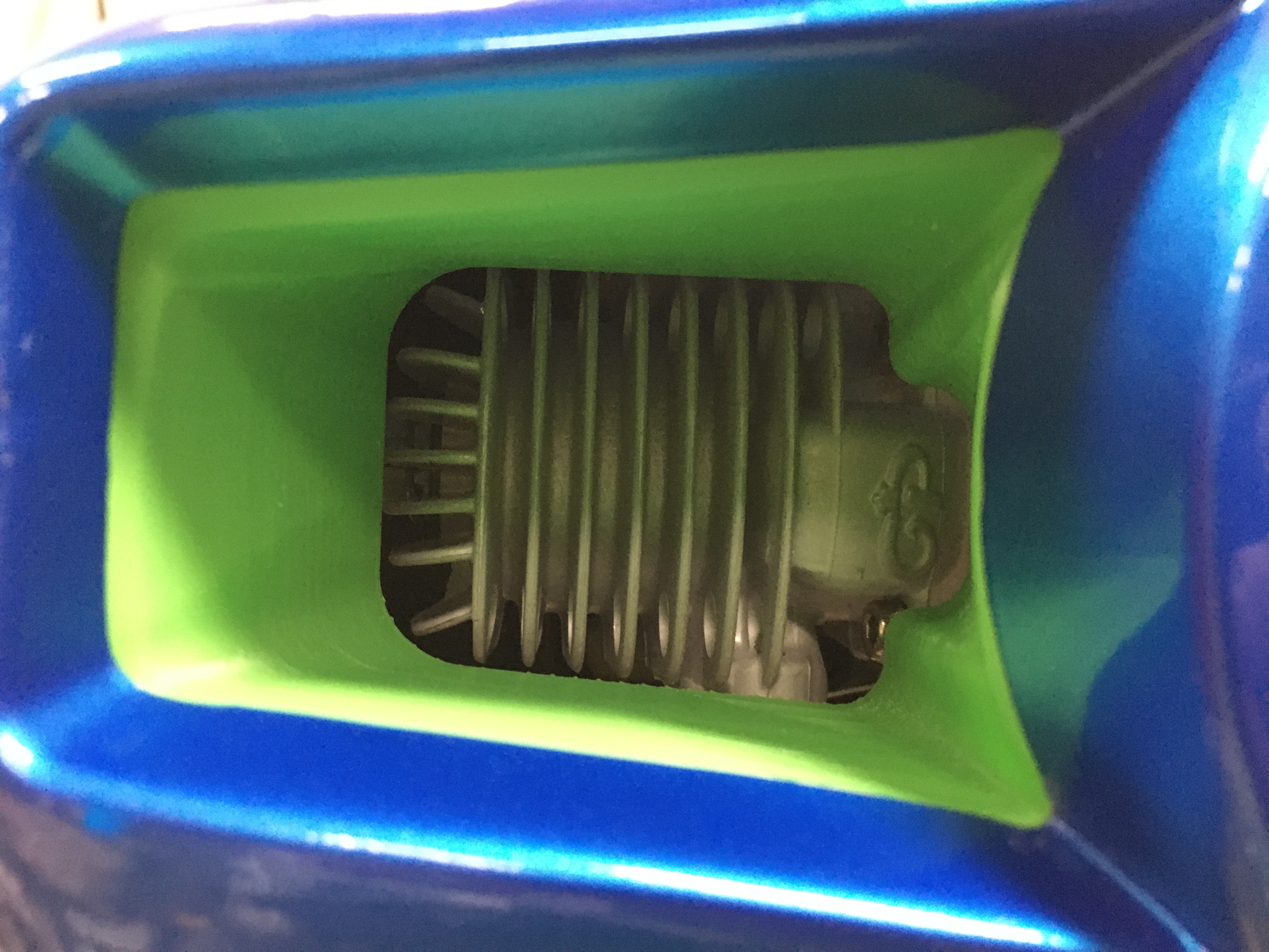

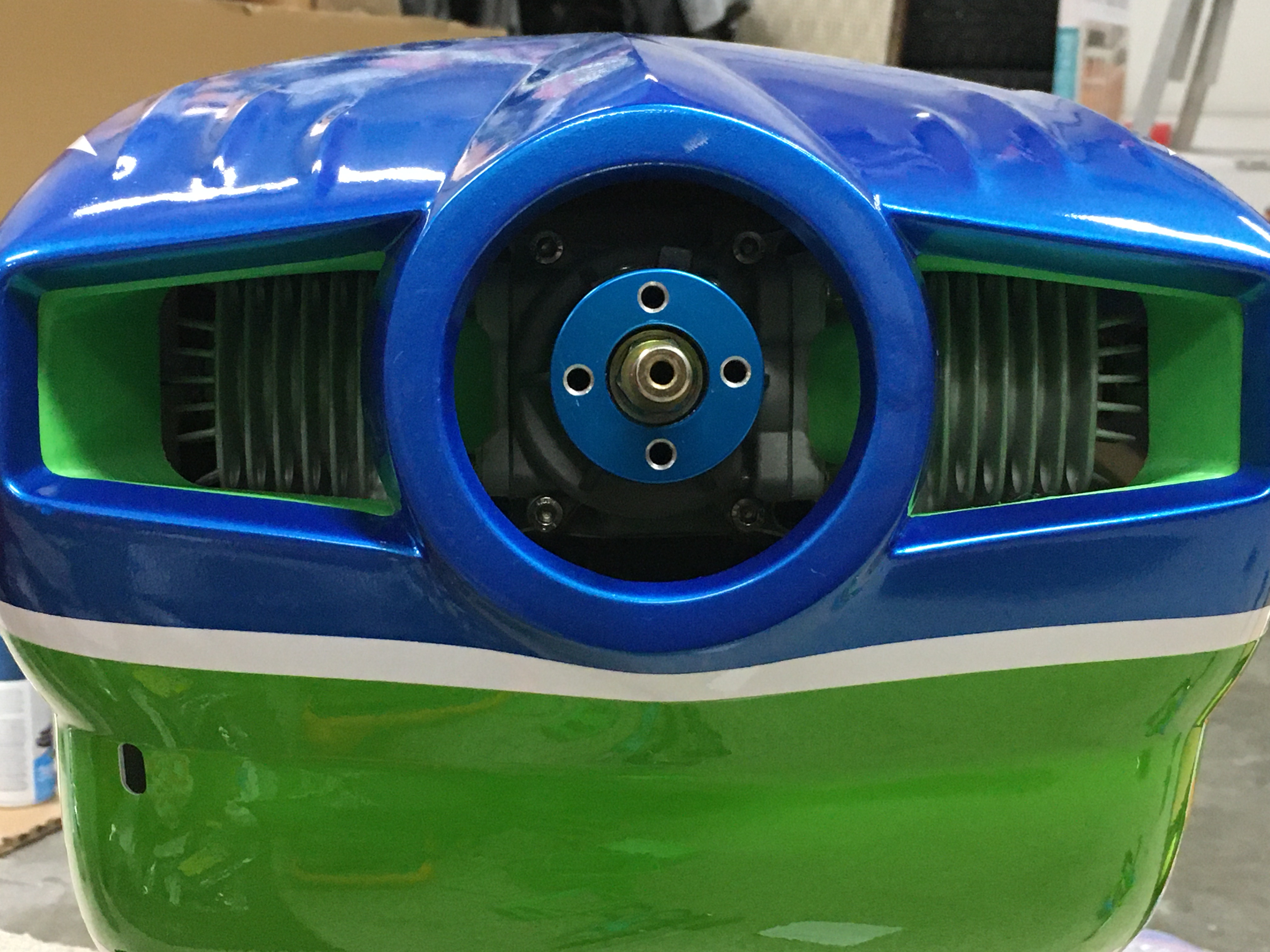

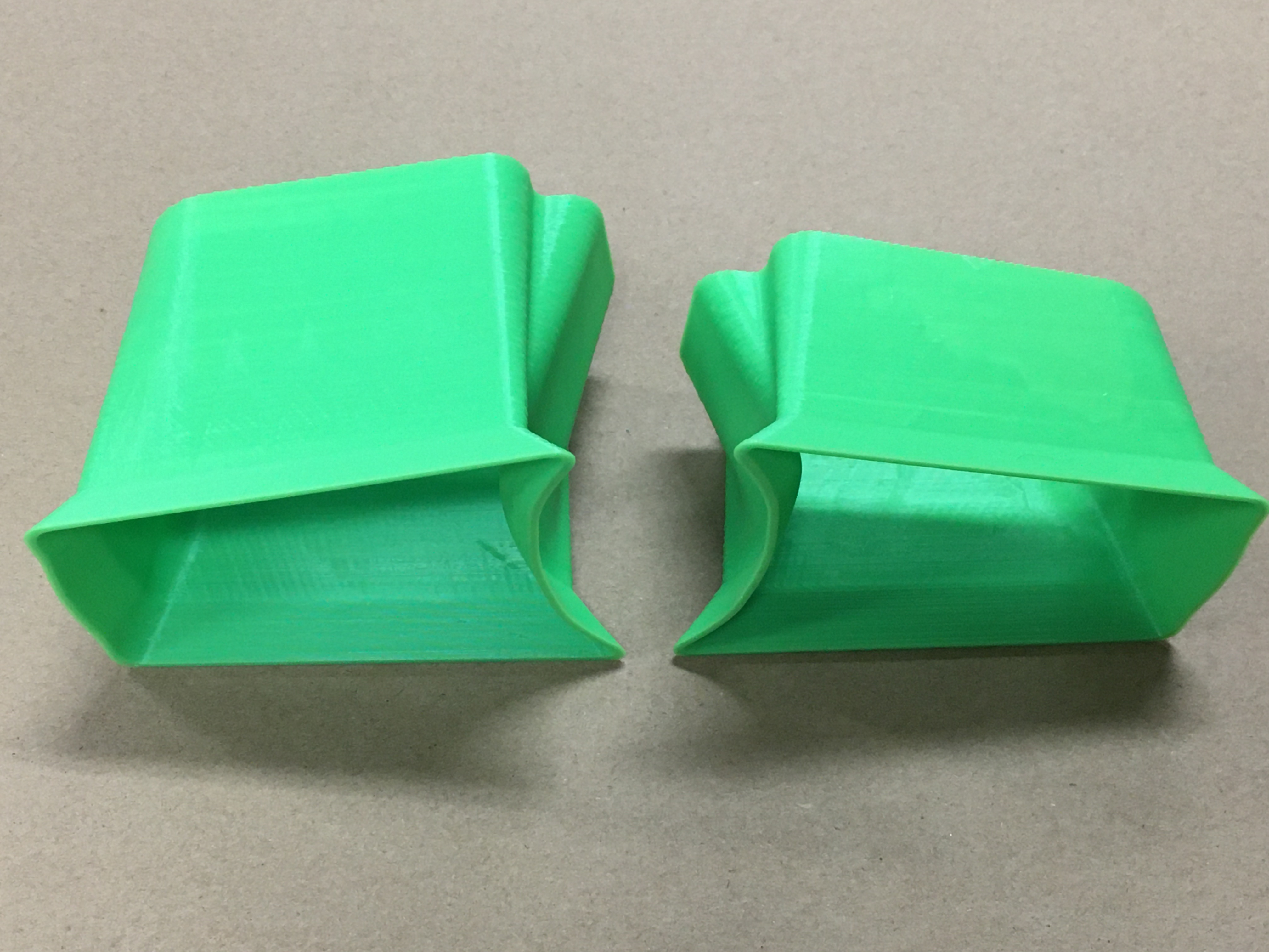

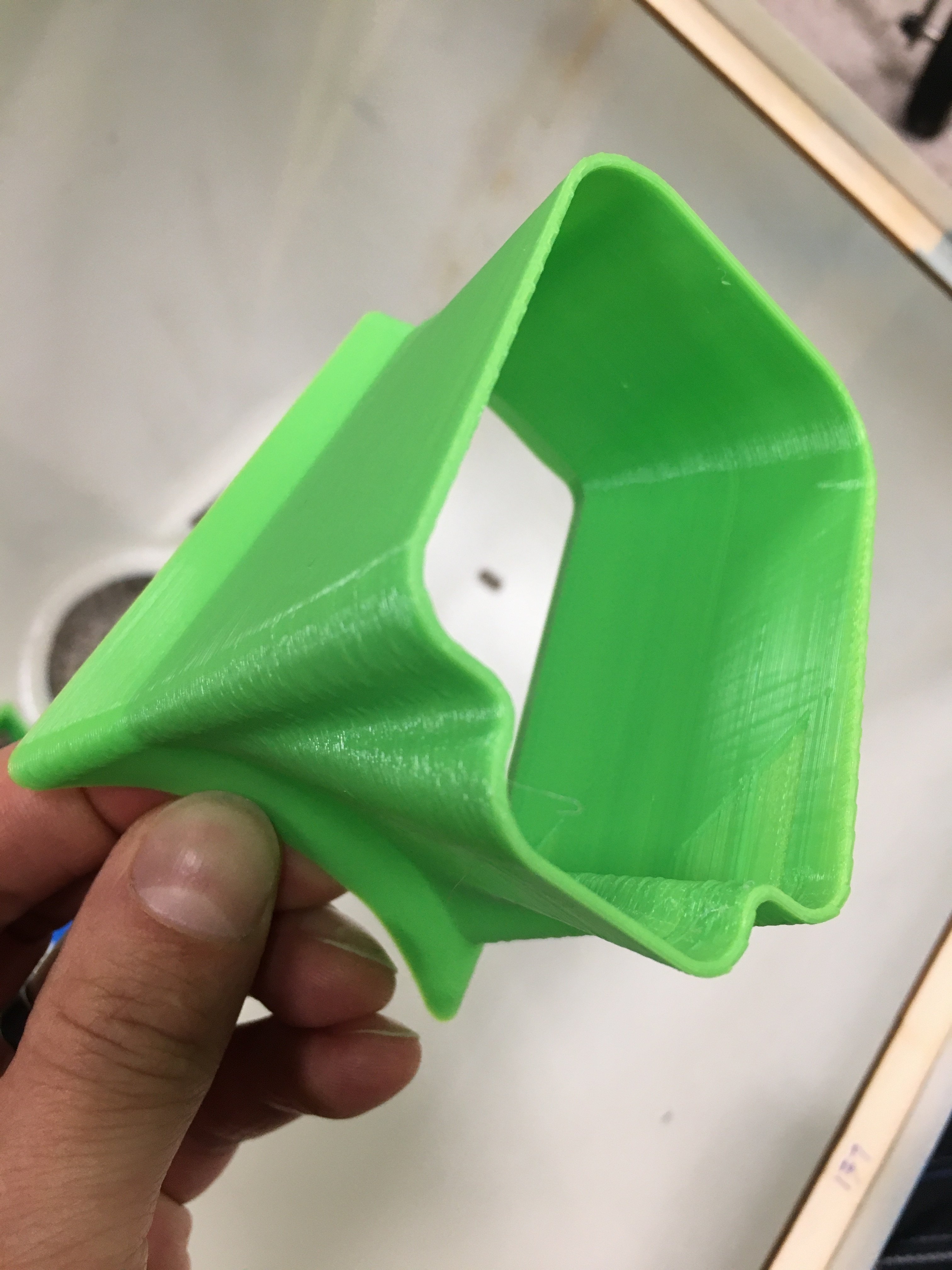

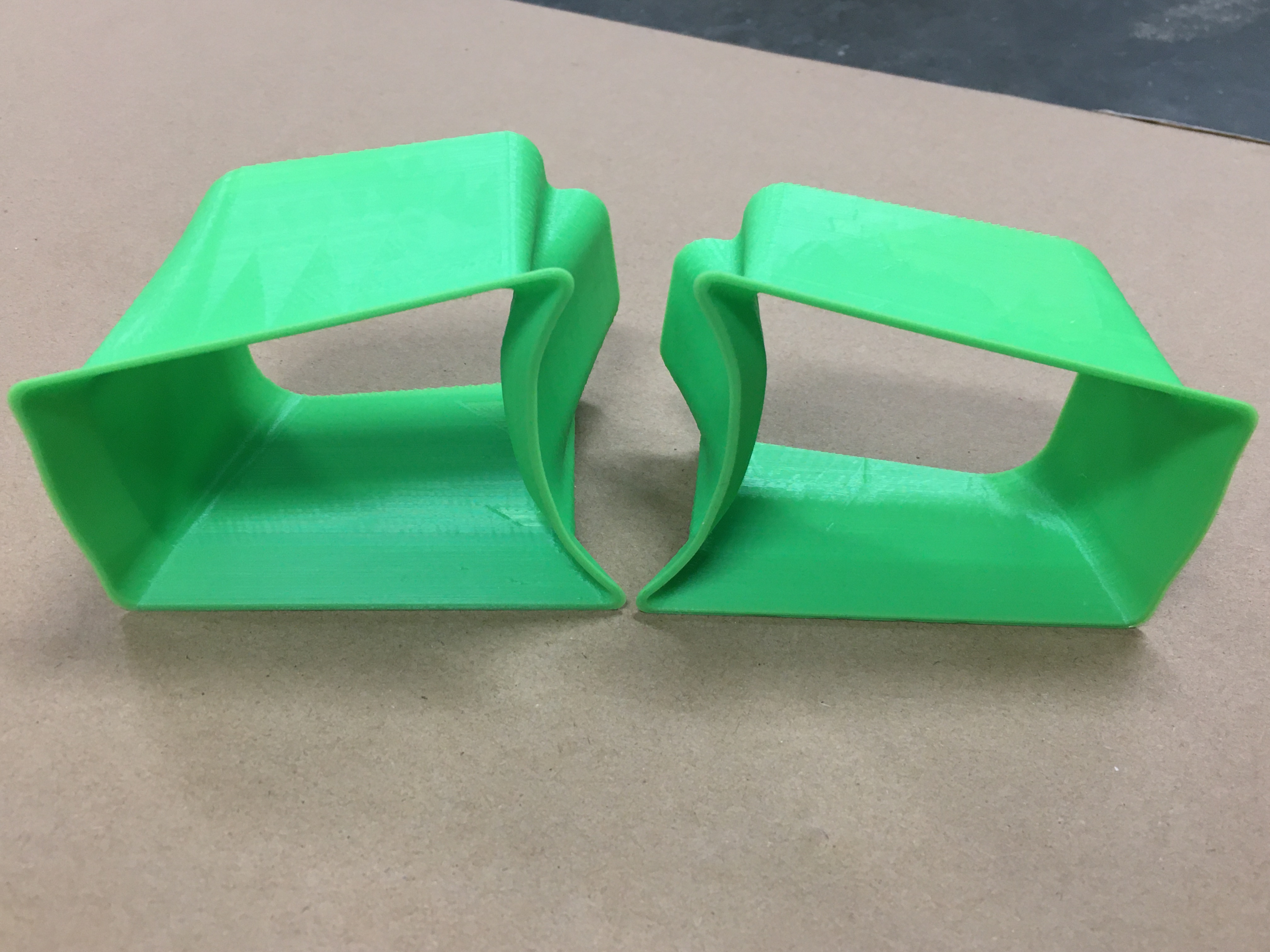

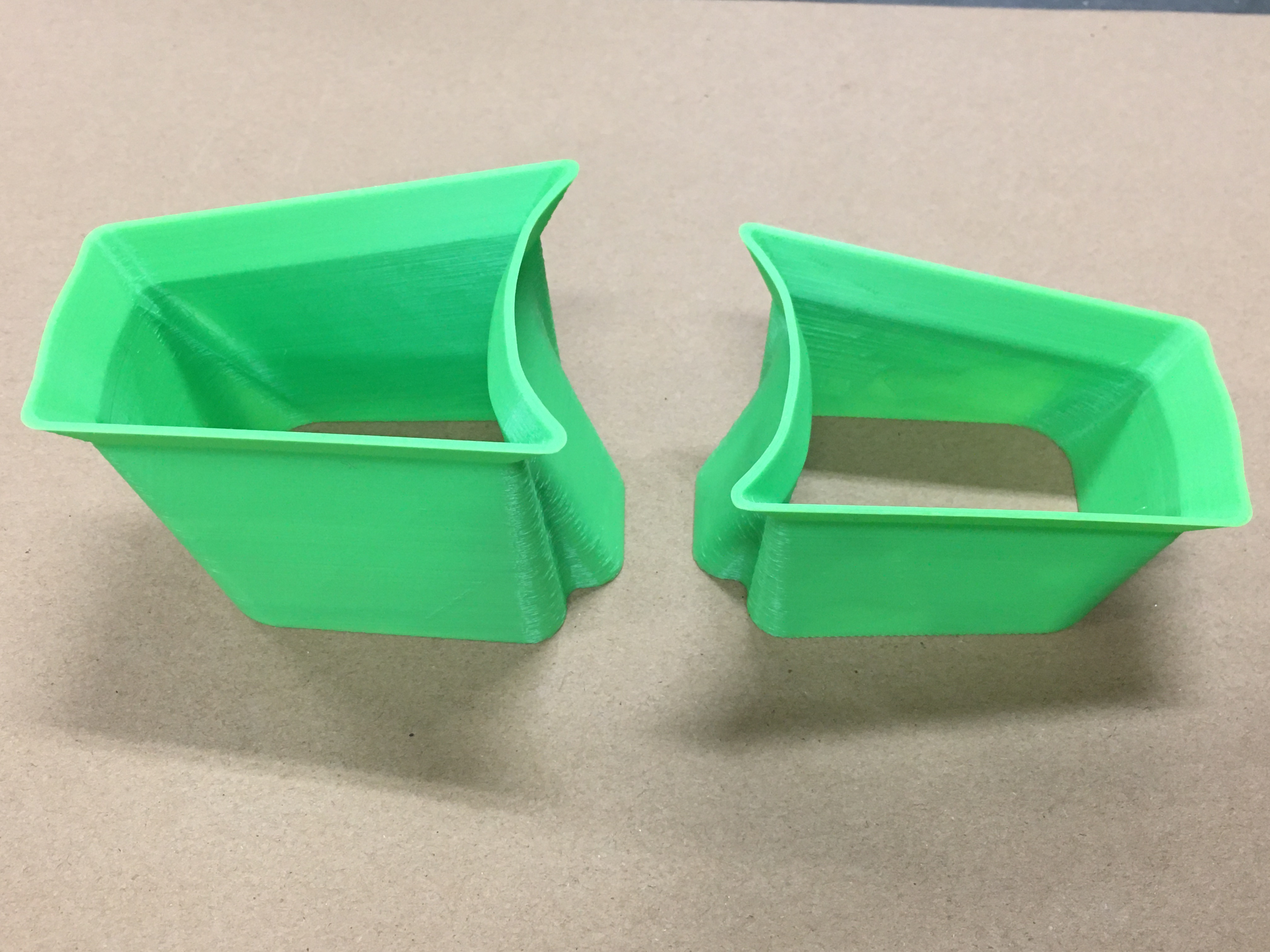

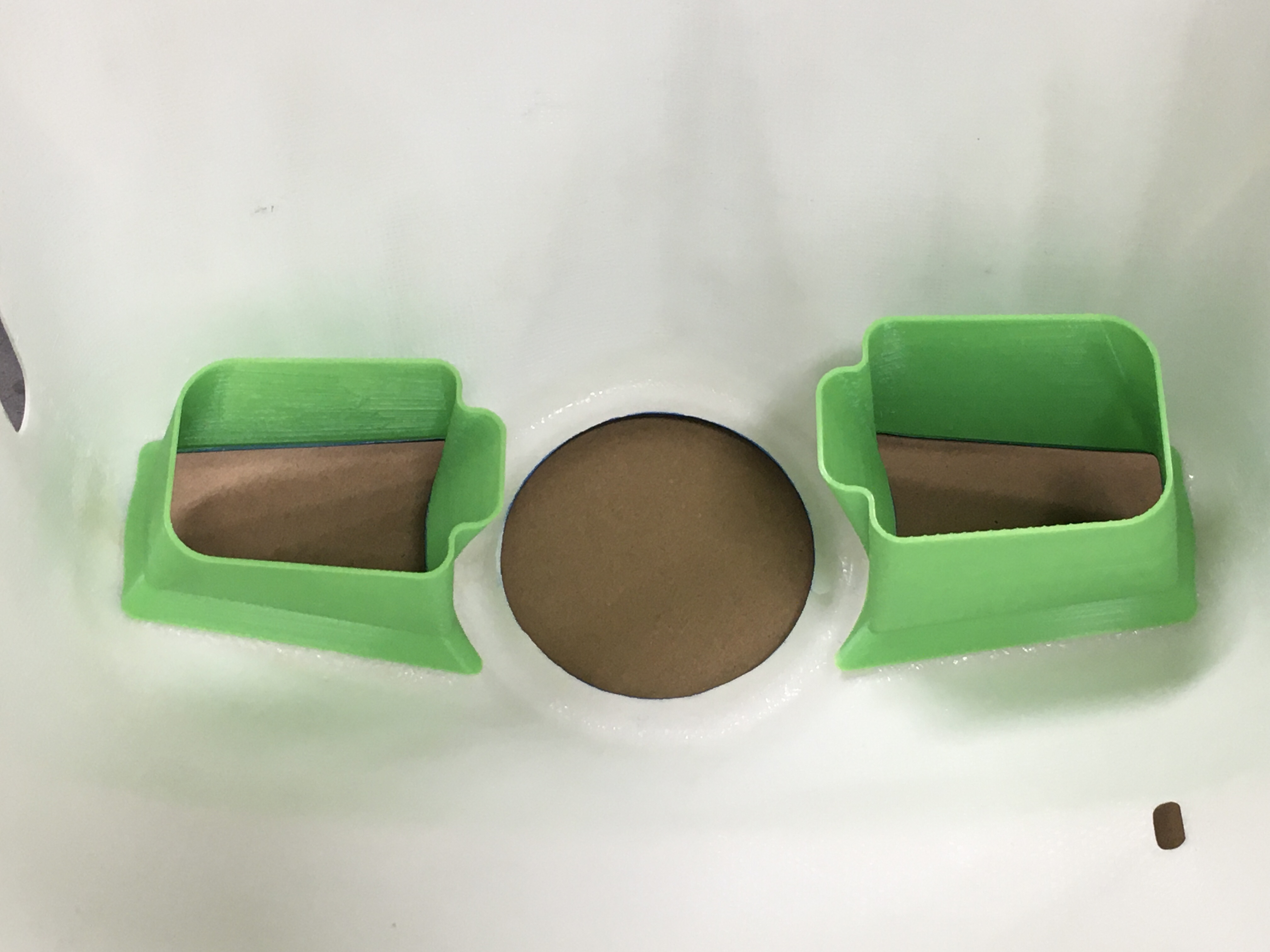

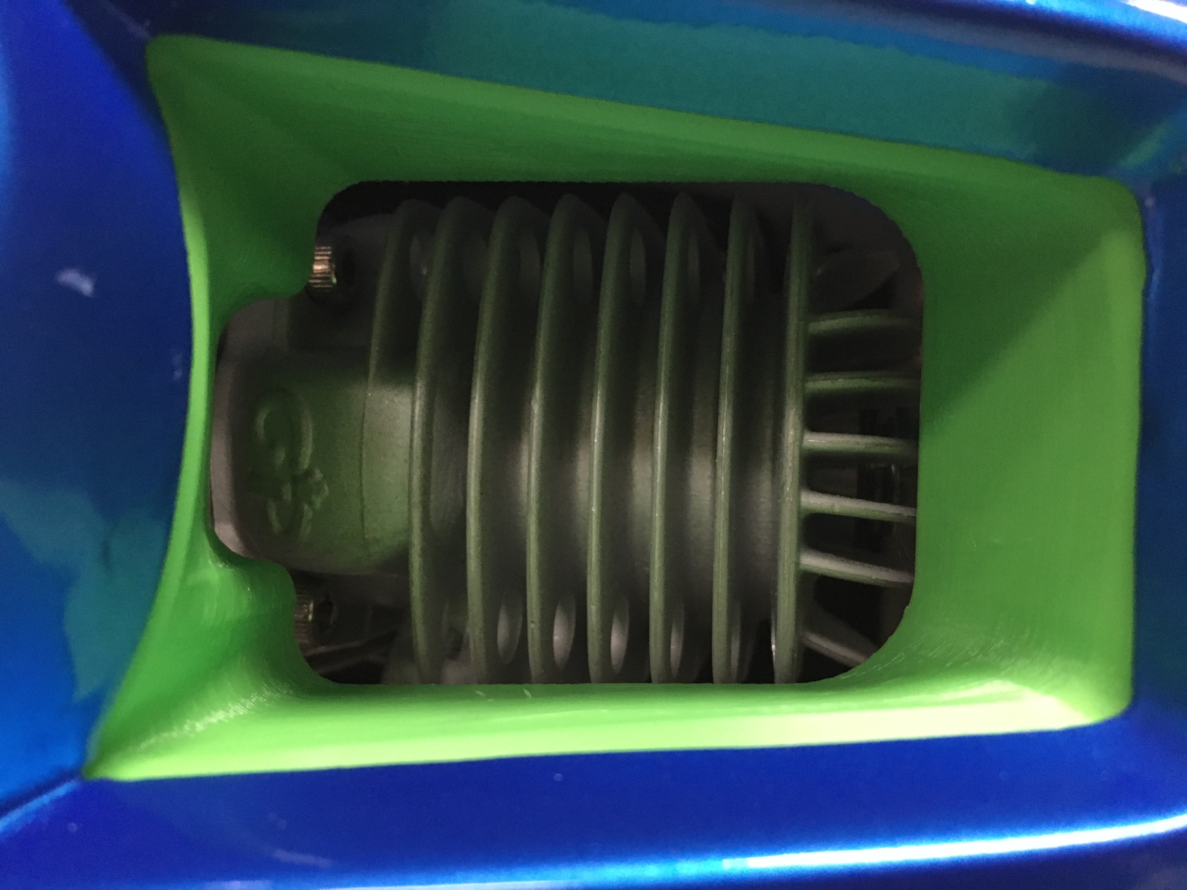

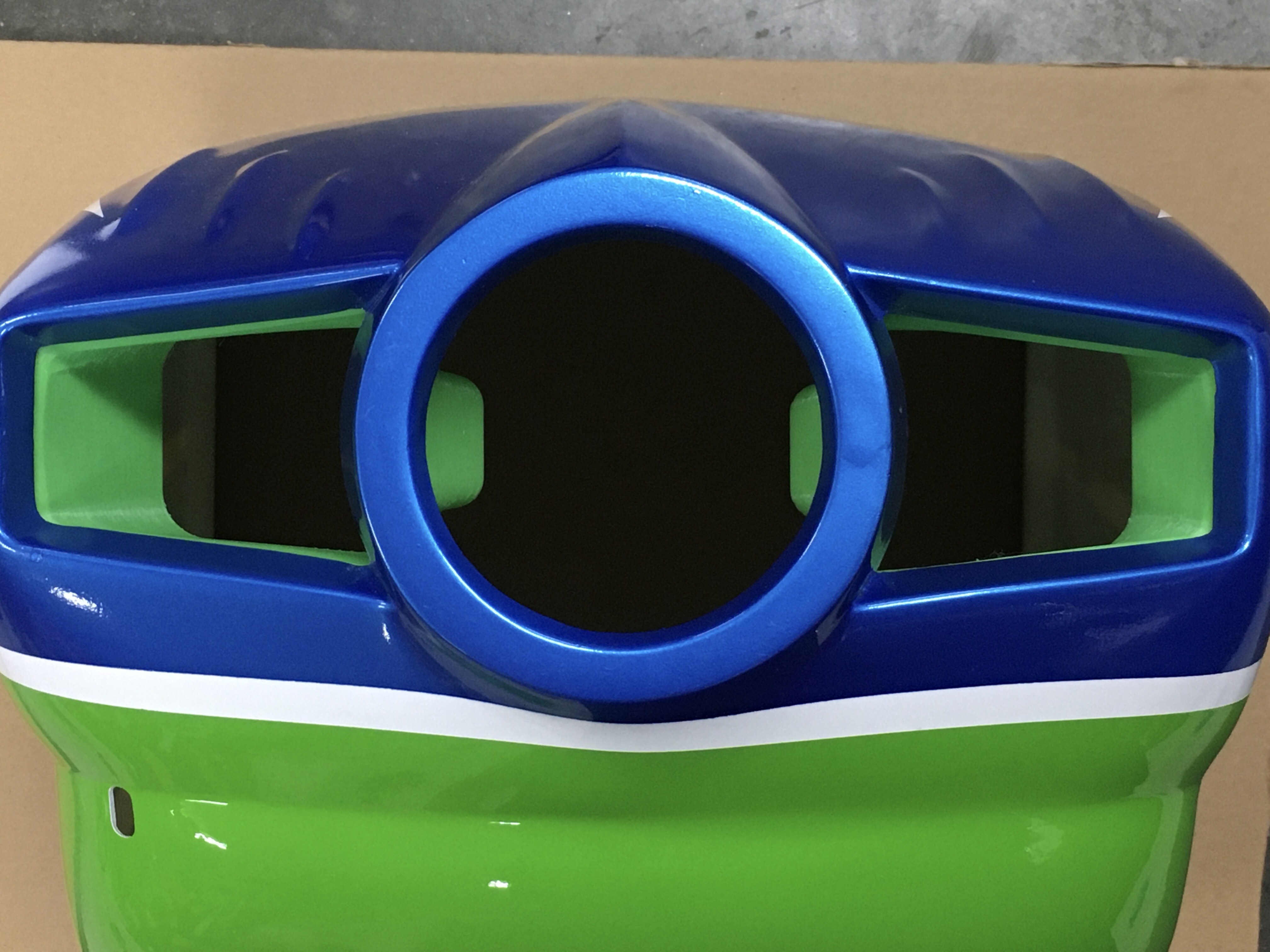

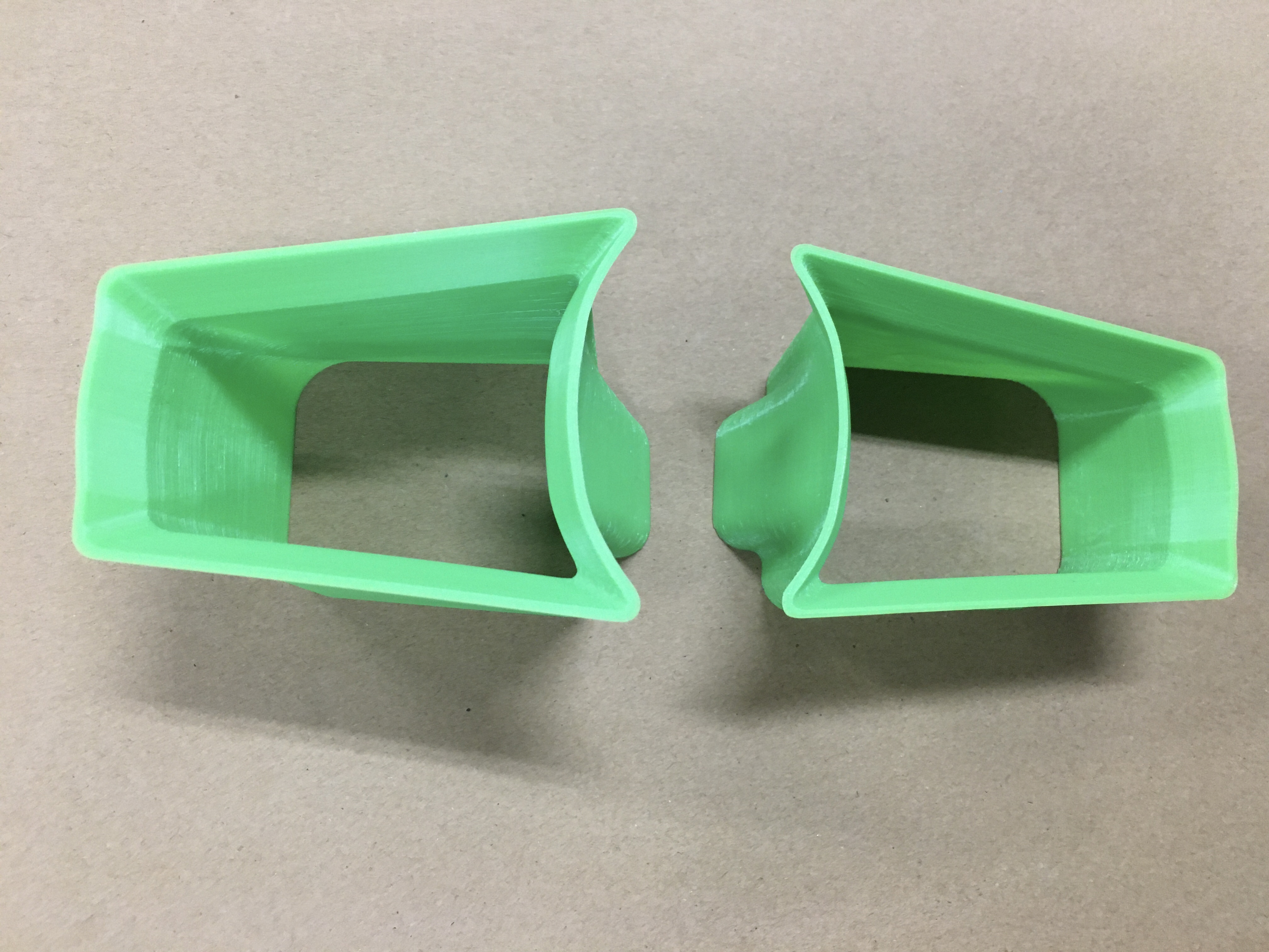

Oh boy! Eight hours of printing and I have a set of baffles custom designed by me that weigh 1.5oz combined. After a few trials I was able to create something that may actually work. I am a little concerned about the PLA plastic getting too close to the cooling fins.
here is a bunch of photos:
View attachment 116314 View attachment 116315 View attachment 116316 View attachment 116317 View attachment 116318 View attachment 116319 View attachment 116320 View attachment 116321 View attachment 116322 View attachment 116323
