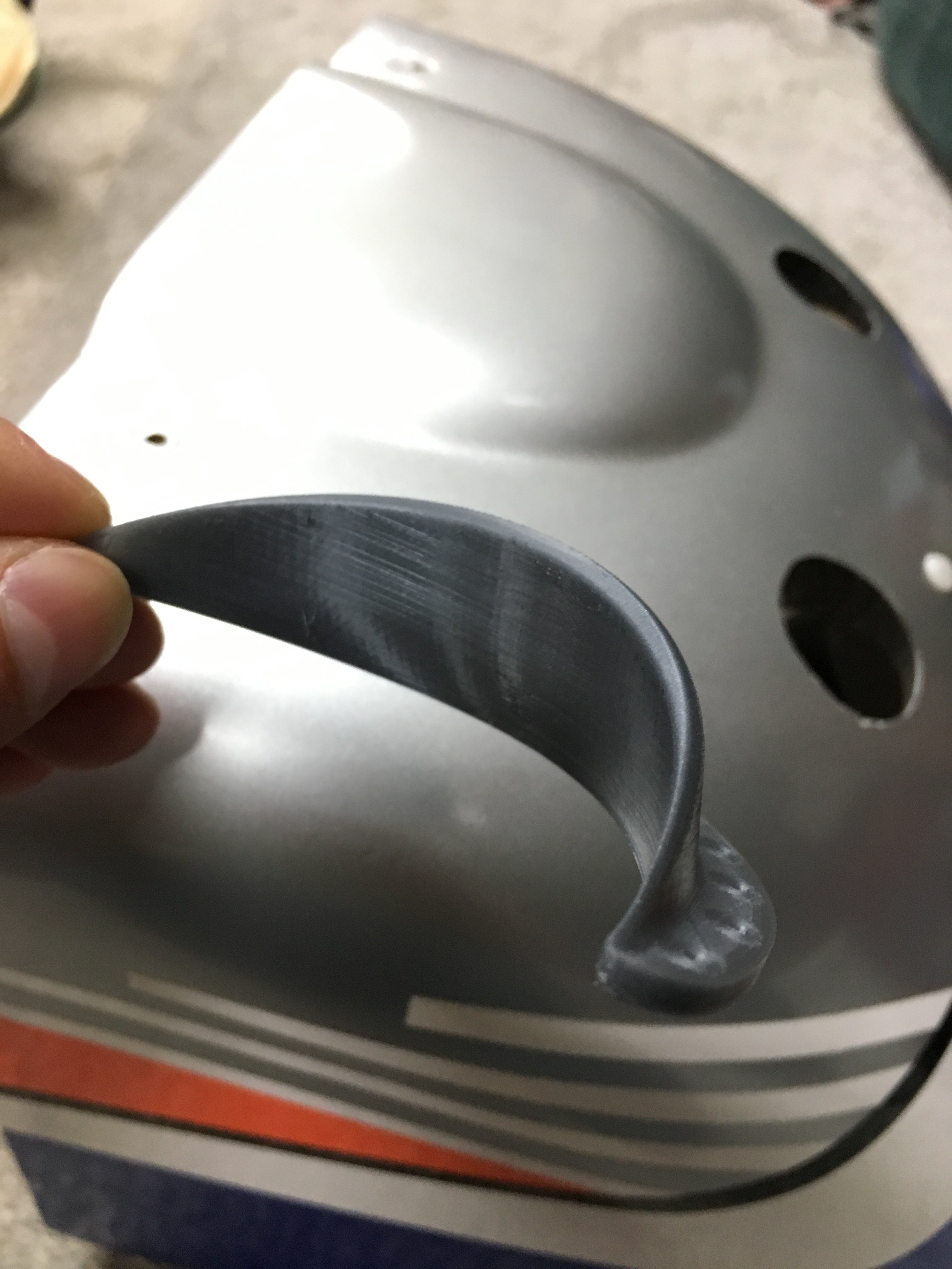

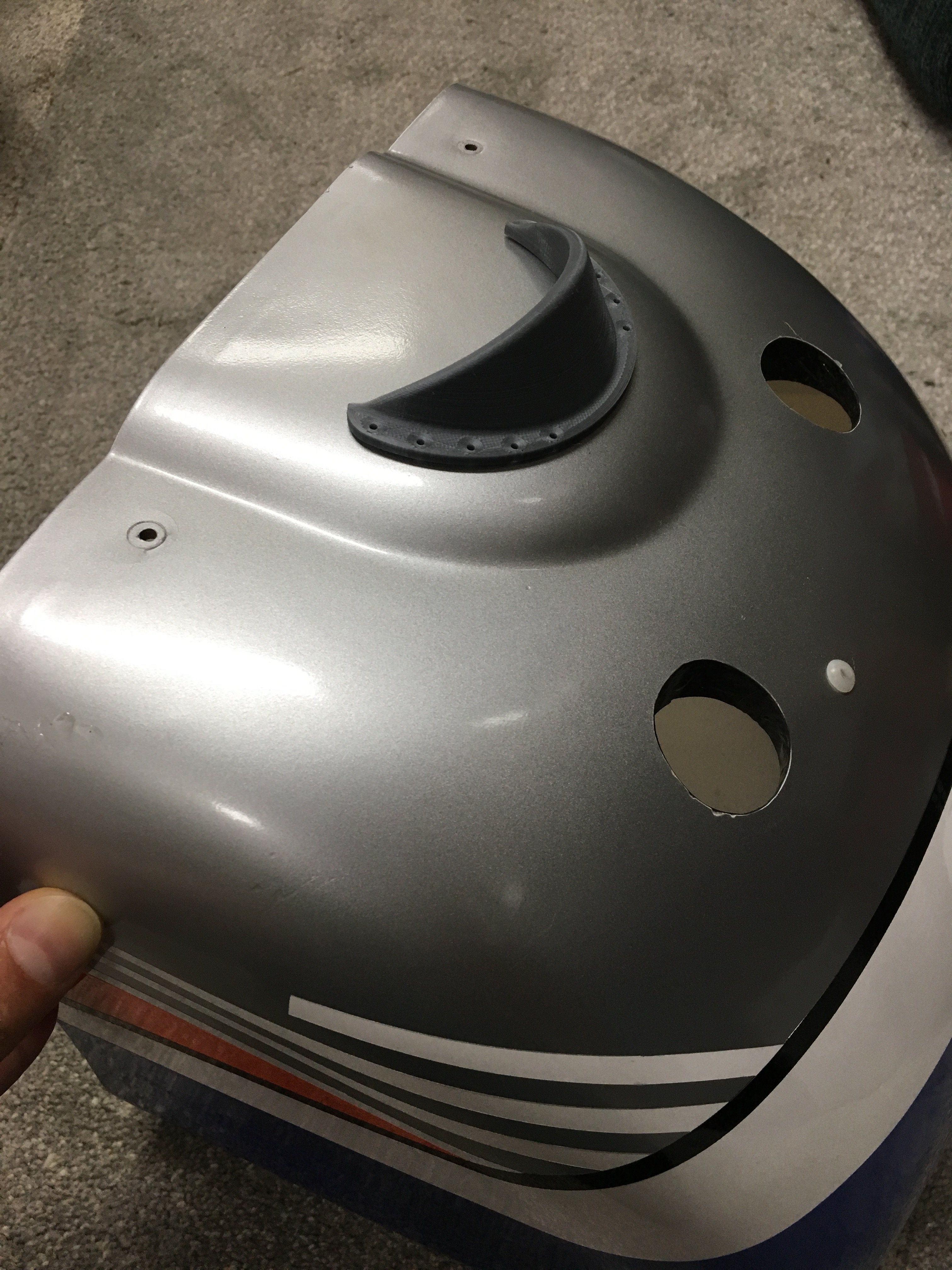

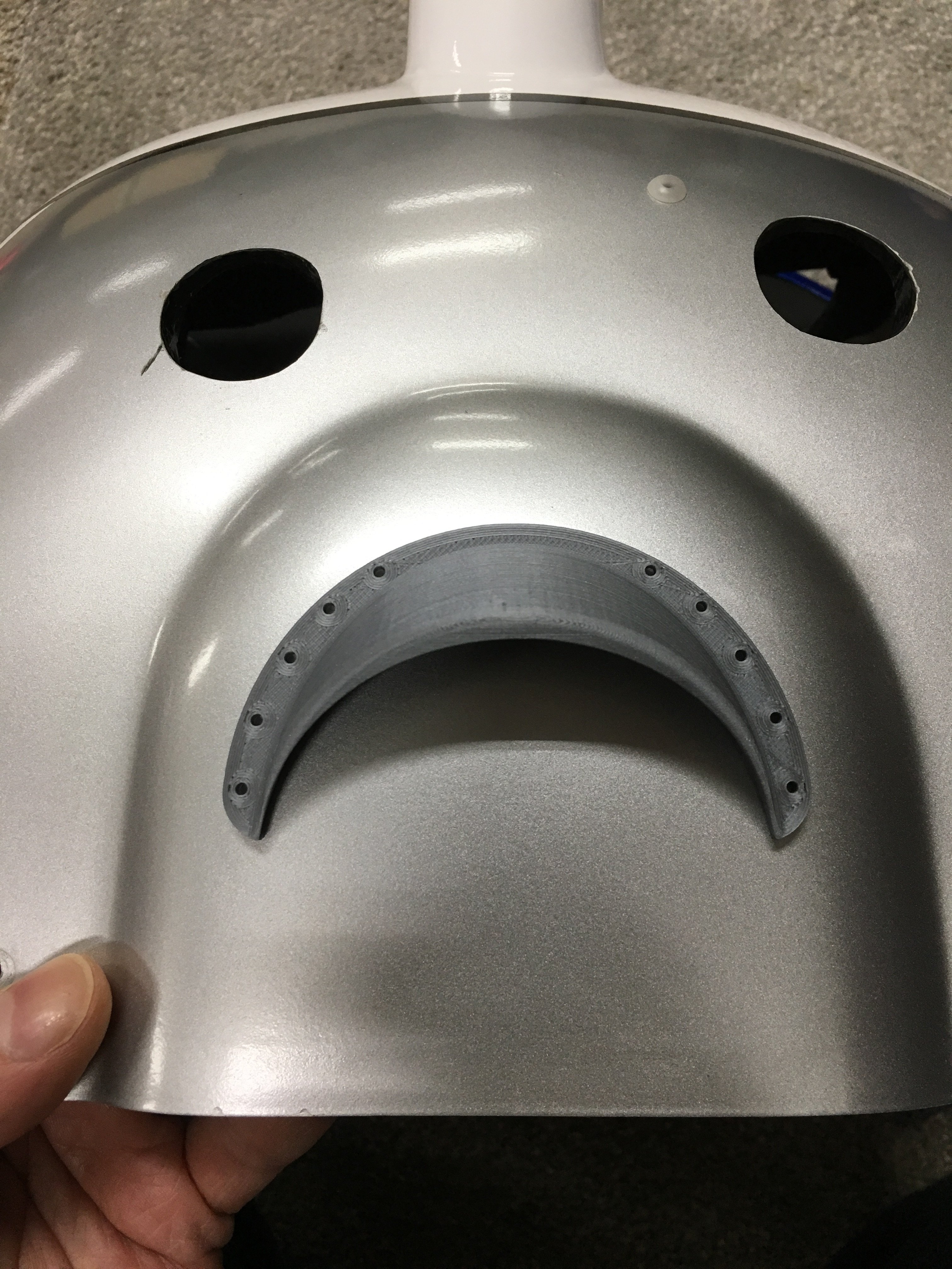

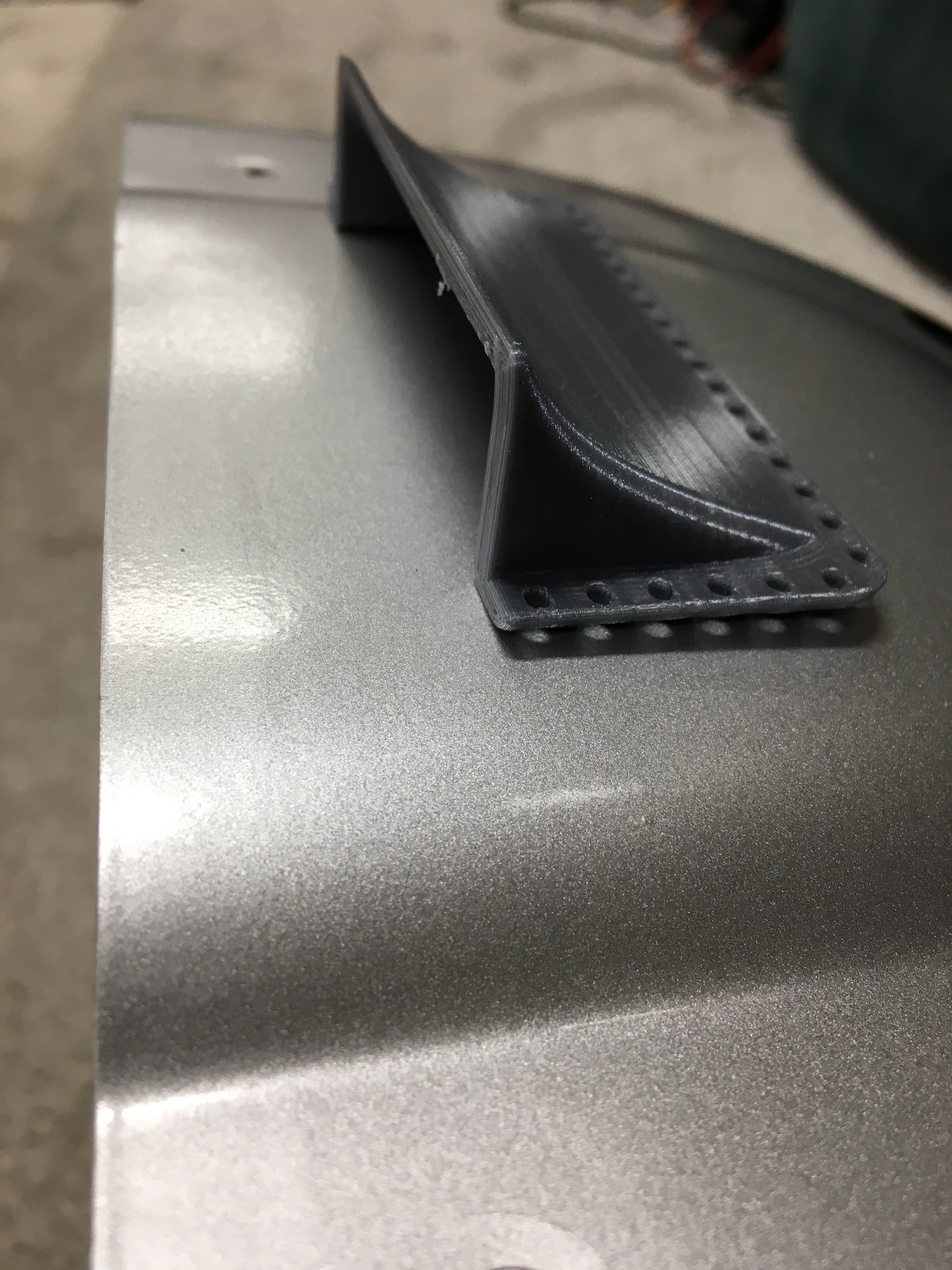

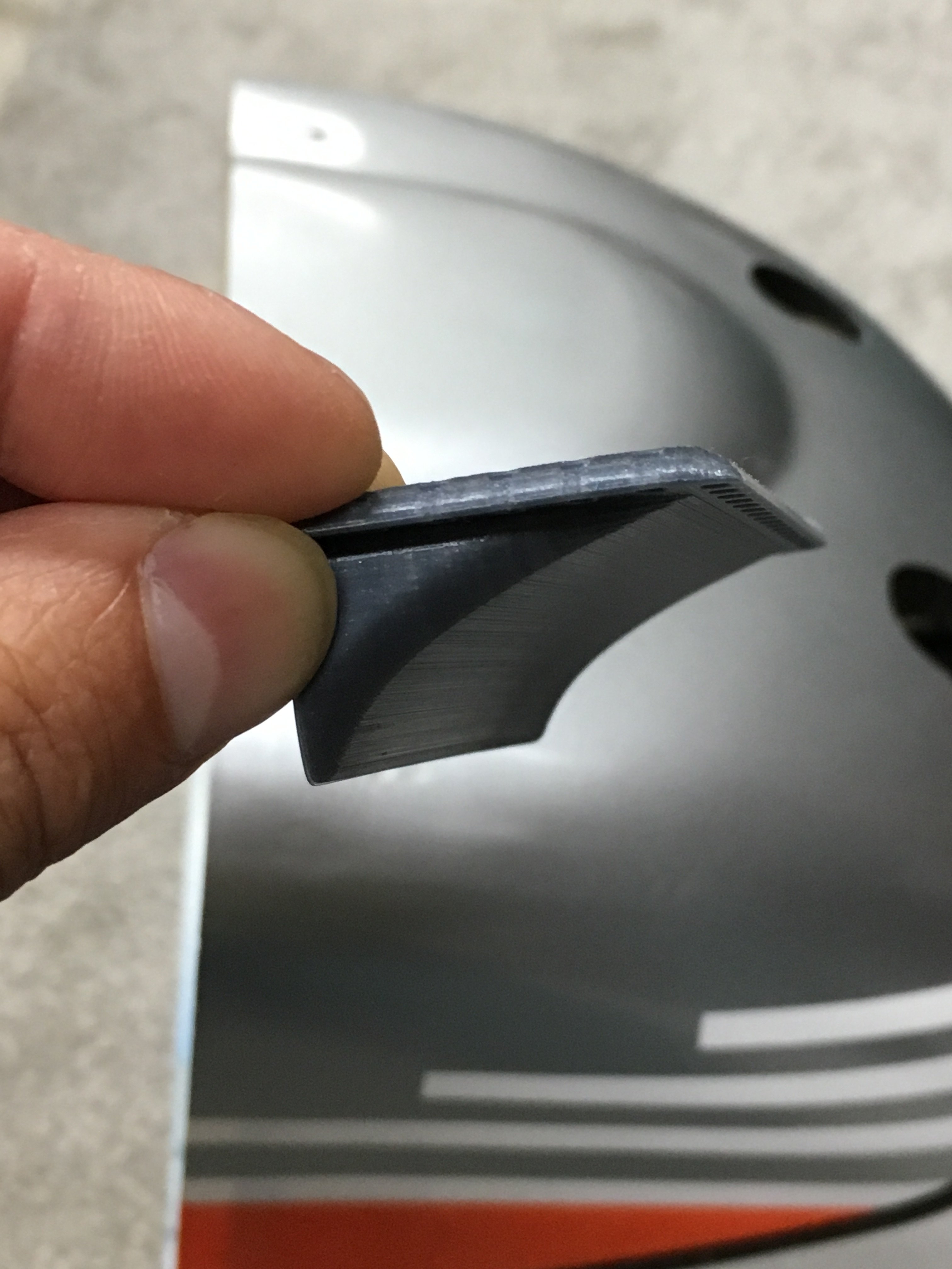

Been plying with some 3DP Air Dam Ideas.
So hot off the bed are two creations. I like the curved one better I think
The though would be to glue the flange on the inside of the cowl.

Love the curved one that will do the trick. I always make them out of balsa. Difficult to do and get the curvature just right and fit the cowl and very susceptible to damage .
AKNick
I’ve made them out of carbon before. Thought about using the 3DP part as a mold of sorts... this one is kinda heavy
Looking at it in your fingers the thickness can cut by half at least and do you really such an elaborate flange. The flange only needs to be 1/8 wide and the bring the deflector up through the bottom of the cowl and glue the flange to the inside of the cowl.

@Snoopy1 yes, The idea was to glue the flange on the inside of the cowl. My CAD skills suck when it comes to complex curves on a free program. The overall thickness and height of the dam needs to be reduced. My initial thought was that it would ramp up and prevent the exhaust residue from entering the exhaust air hole.
I keep debating if I should open up the tunnel and add the air exits provided instead of hacking the cowl. I can add air dams to the front of those exits to compensate. But it may help suck the hot air out of the cabin as well. Crazy, but my research shows that air dams can reduce cylinder head temps 20-30 degrees - that seems like quite a big number to me.
All I can tell you is it made a big difference on my planes but how much I am like you no telemetry. I have done it on all my planes. Look at my Timber cowl I made one for it as well. You will also see that the side are carried backwards that made a big difference, it stops the air from wrapping around the deflector and back into the hole.
